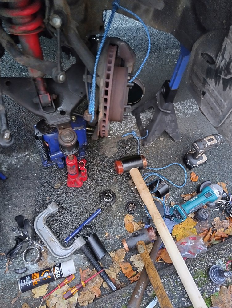

never seen a long handled copper n hide before ,interestingView attachment 471519

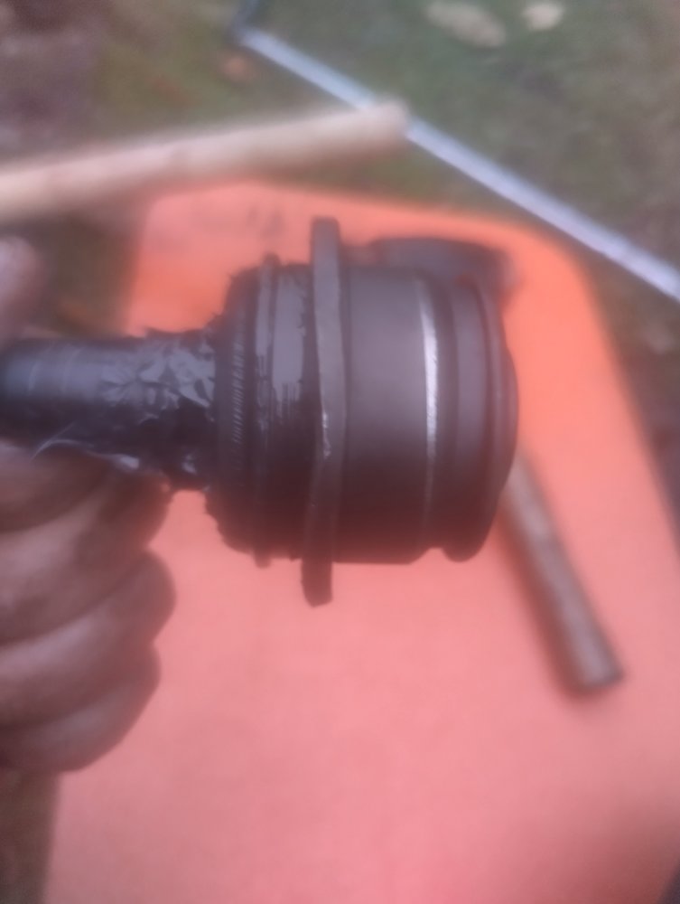

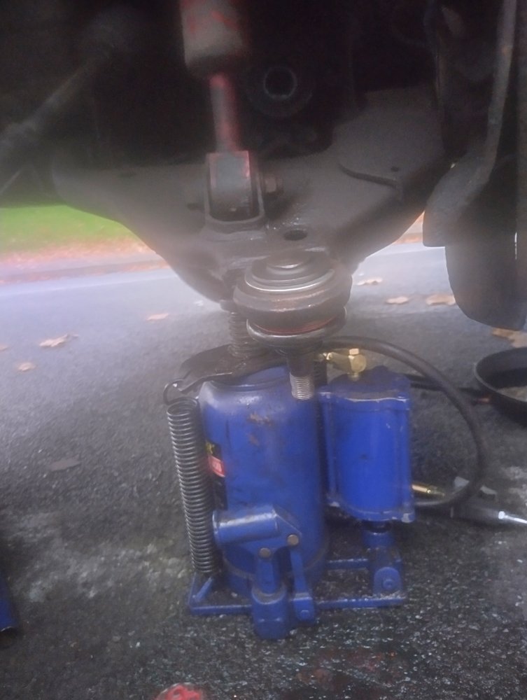

The ball joint press is apparently just a piece of crap, the clamp portion racked, causing the press tool to deform and in turn muller the replacement ball joint.
Fortunately I did have a spare (intended for the other side, which will have to be done next week) so was able to do it the old fashioned way.
I really did need that big thor hammer though.
Just reassembly, and replacing the boots on the other side to go now...
