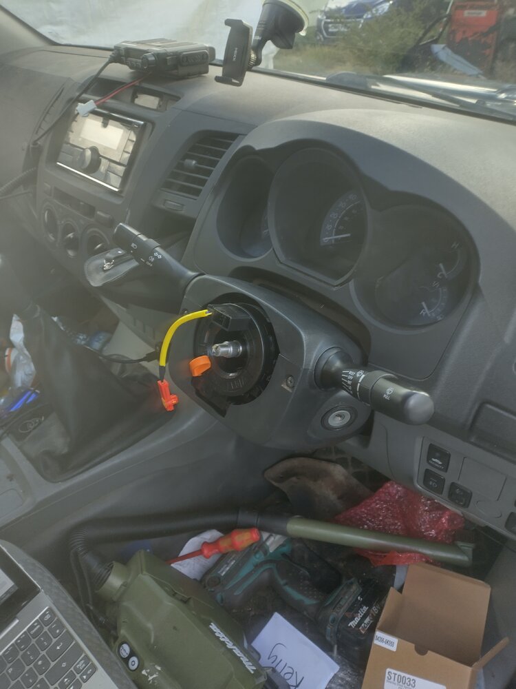

New spiral cable in, airbag light off, horn working, tested with the diagnostic software, happy days.
On disassembly of the old one to understand what went wrong, the ribbon cable inside had shaken loose of the spring loaded clip which holds it to the output connectors. I think me giving the steering wheel a firm yank to free it from the splines may have jiggled it just enough to make it fall out.

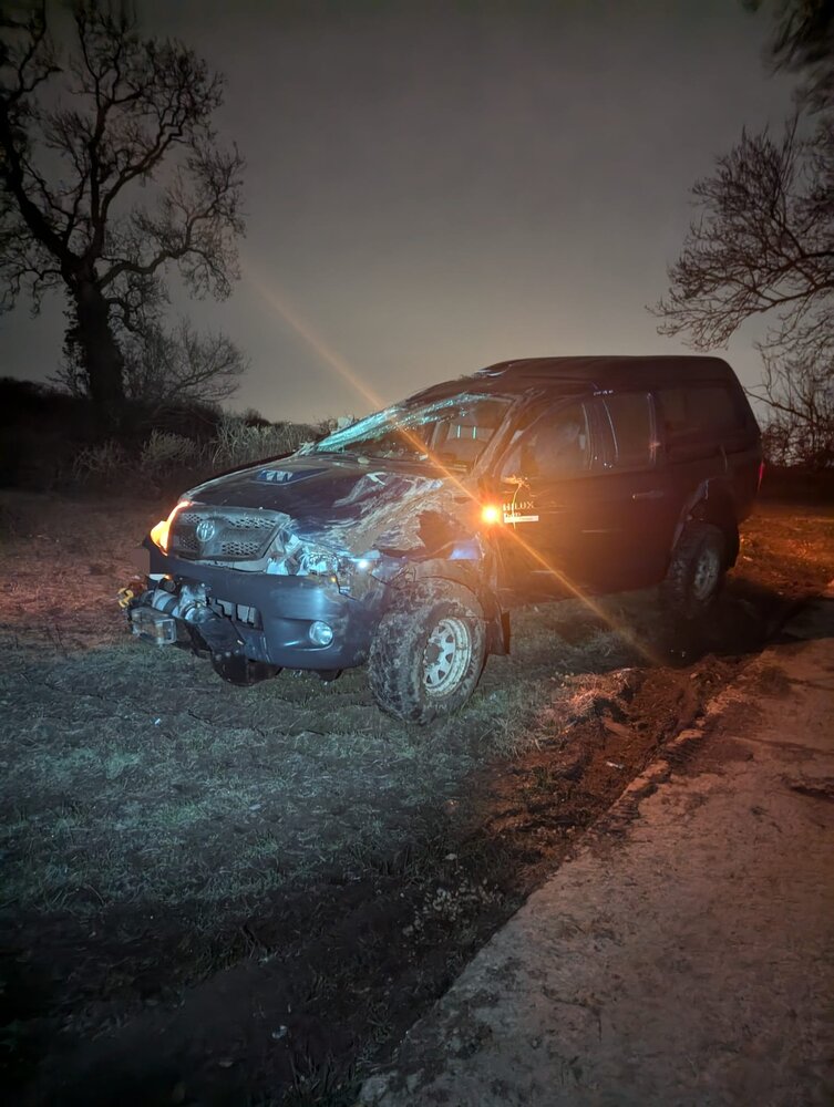

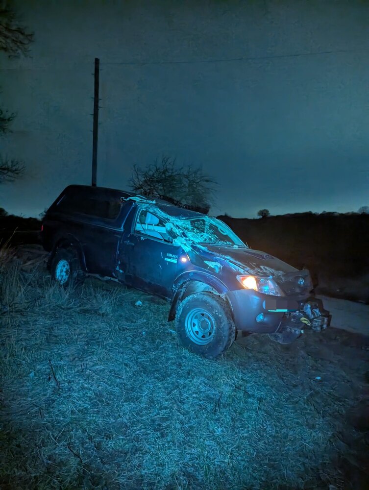

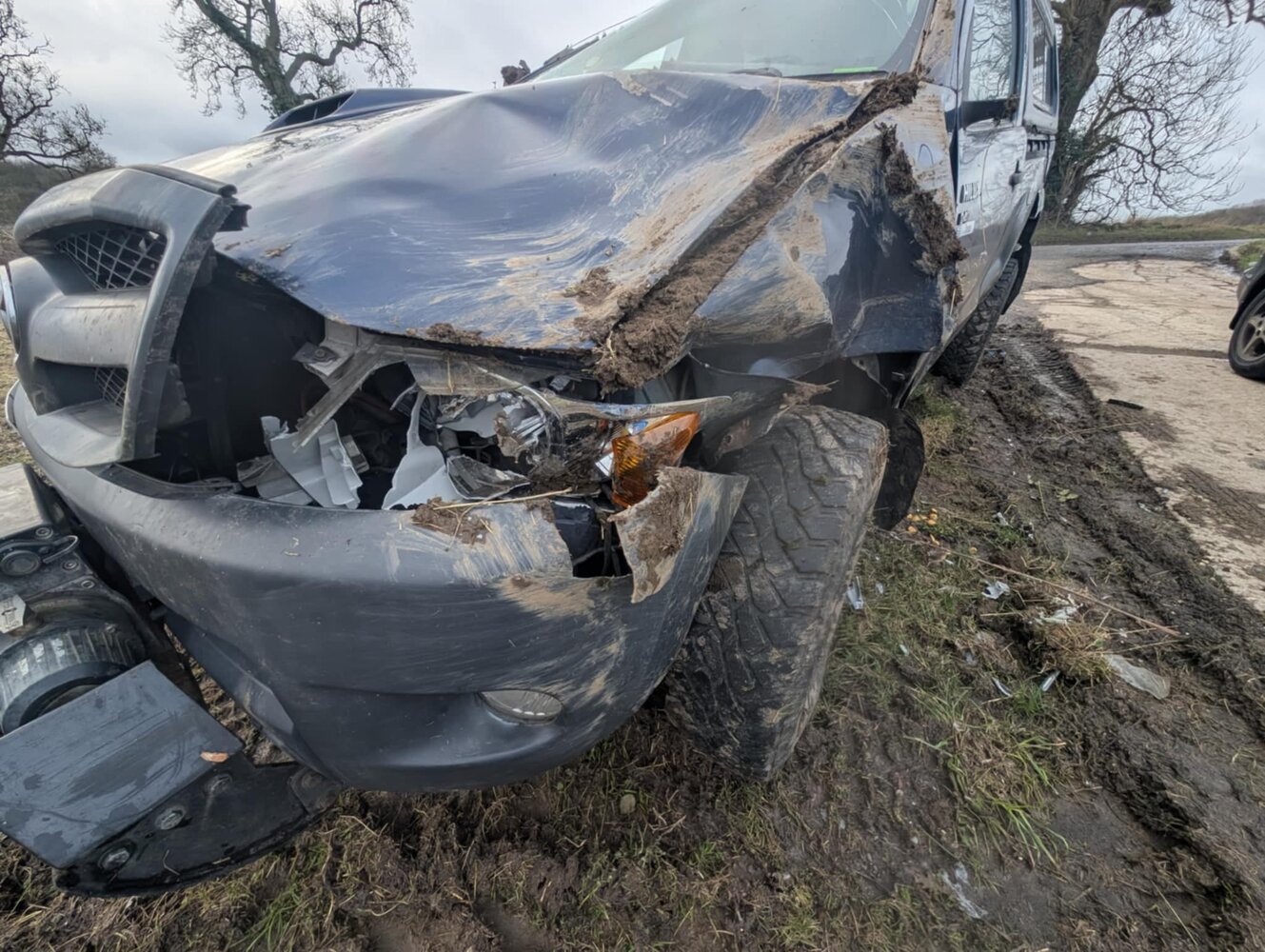

As the photos I have now received show...

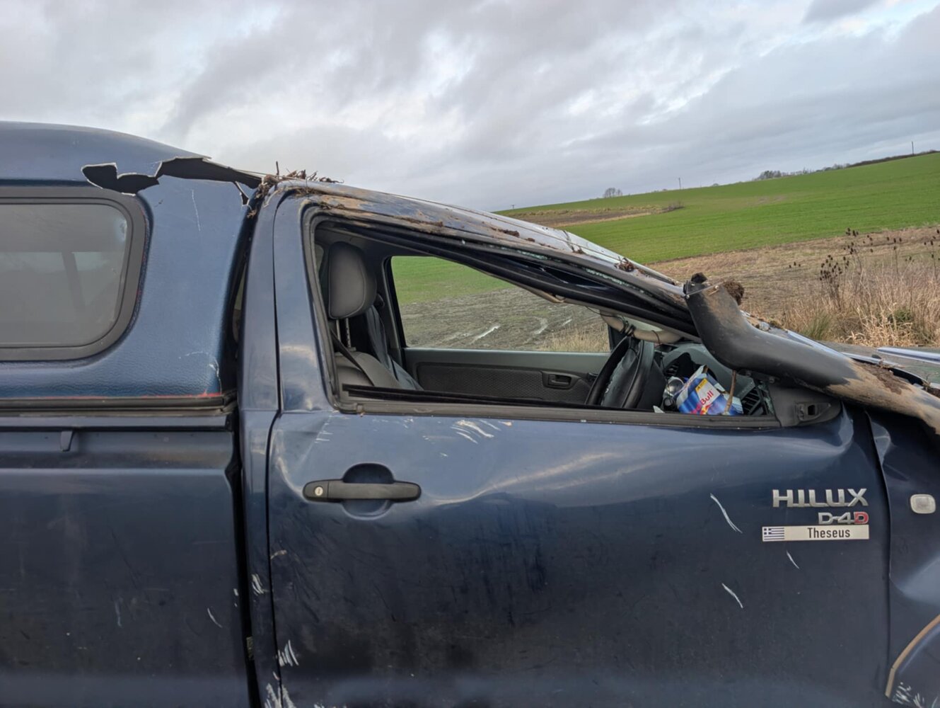

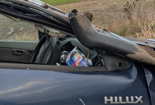

She really did a proper job of her late night Evil Knevil impersonation!!!
That was a hell of a lot of force right where the driver is, scary stuff really and she was lucky to walk away with just minor bruising.

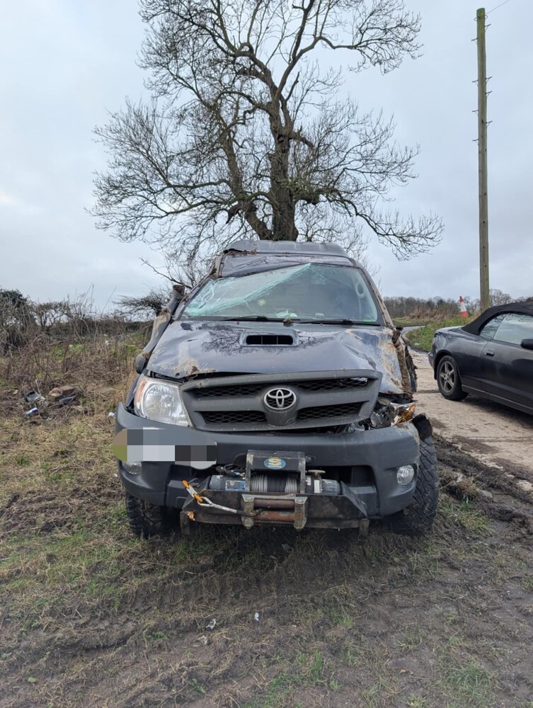

That probably isn't going to buff out, although my mate who went to clear it tells me it runs and drives fine still, no loss of oil or coolant.
There's an option to buy the salvage, but I would need the entire cab off a single or super to make that worth doing I think.
Also I am 18,000km away right now and the truck was my lift home from the airport, so there's some practical issues to going to get it.
Anyone reckon I can count this as "Lightly Soiled" if I list it on Auto-trader?

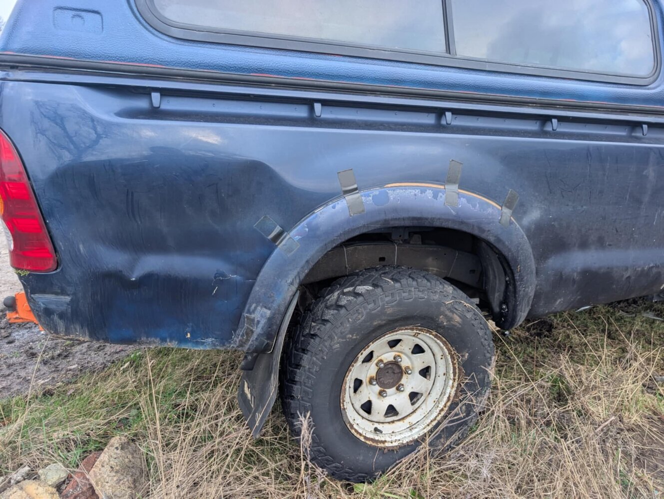

And my extensive panel welding on the tub held up well in an impact, so there's that I guess.
Yeah there's a bit of me that thinks it would be worth buying the salvage just for the winch, but unclear what I would subsequently fit it to.Glad your pals ok, truck can be replaced. That’s a lump of a winch on the front
Yeah I don't think I appreciated how lucky she was or how bad it was until I saw photos.Wow she was very lucky to come out of that unscathed
Its only metal but all that work down the pan and the hassle of finding something else now![]()
I wonder how much being the single cab helped, like with such a short span to support it's inherently much more rigid.The shell held up well, I've seen rally cars with competition cages come off worse.
One we went to on Salisbury plains
