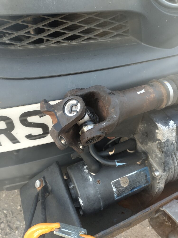

Yeah the very same...14mm / 9/17ths bolts? If so there's a tool sold for Land Rover props which has a very thin edge and is designed in such a way to fit in between the UJ.
If they're the same size bolts it might be a useful addition.
The props and spiders are all Dana-Spicer who (as Salisbury) I believe were also responsible for the rear running gear of the 101, newer Series 3, and Defender.
As is I was able to get in with a deep drive 3/8 impact socket, but it's awkward.
Makes a hell of a difference.![]()
Propshaft bolt removal tool
Britpart DA1119 Propshaft bolt removal tool (usually 14.50GBP)www.paddockspares.com

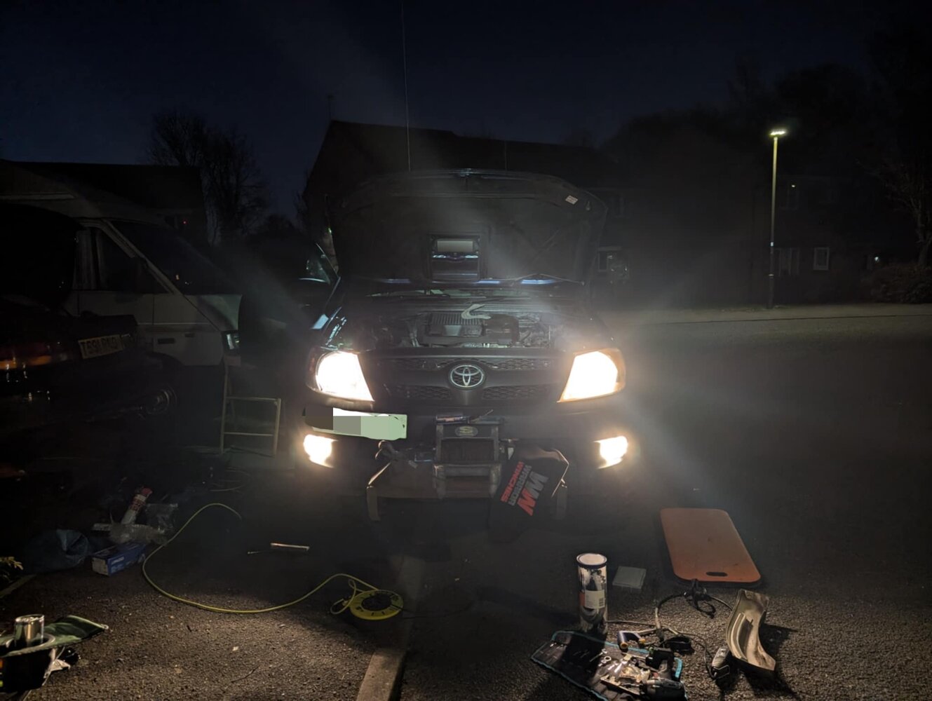

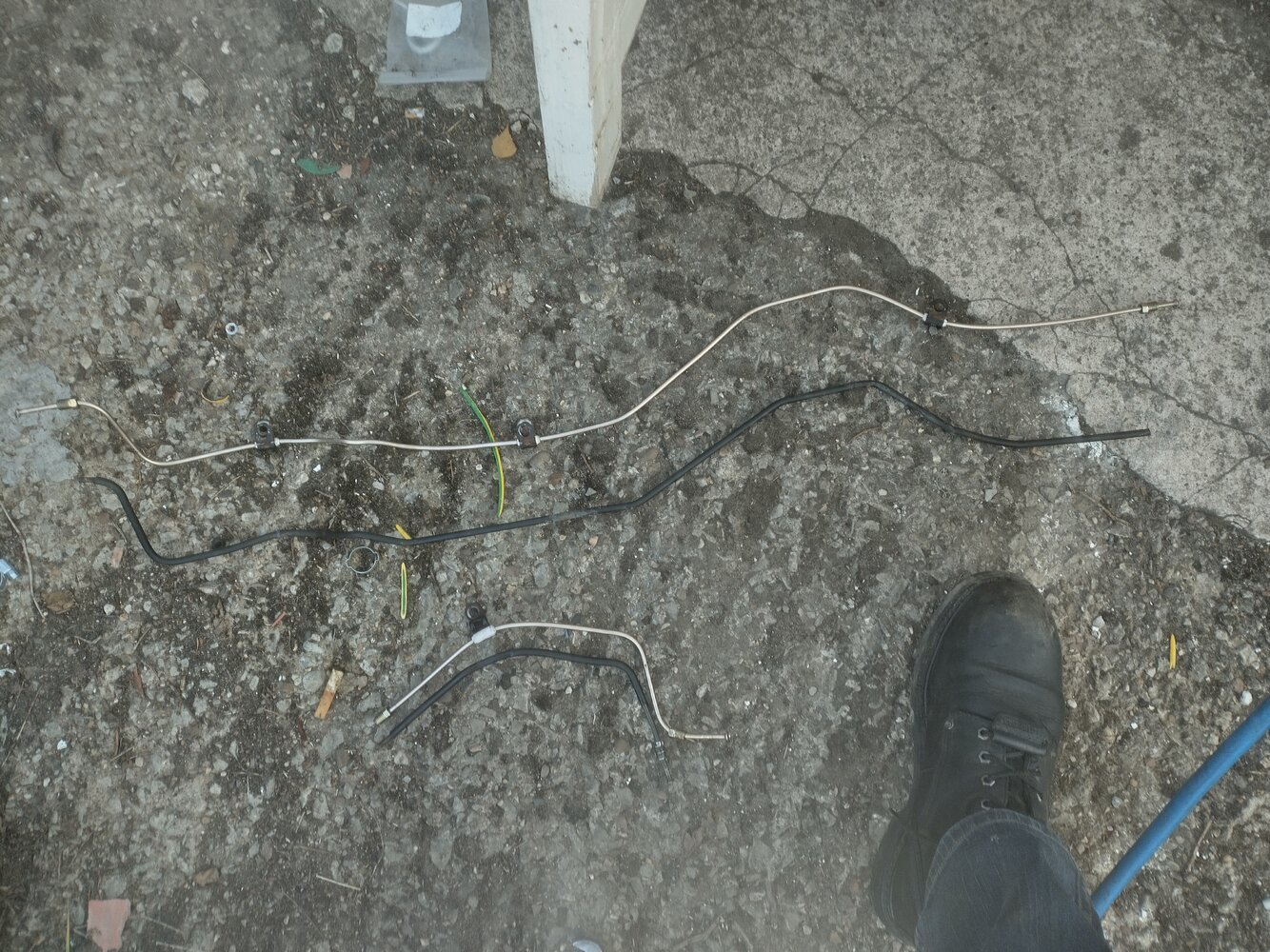

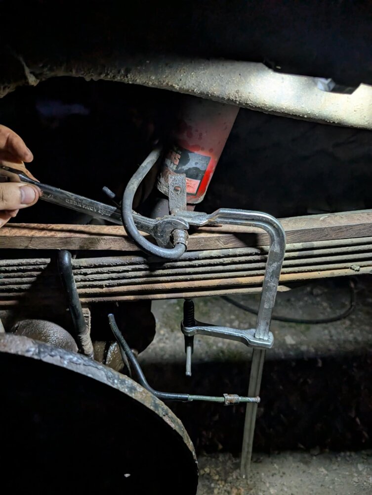

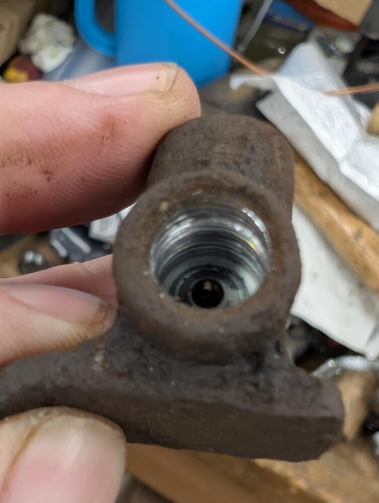

So the welding didn't turn into a huge job, because the brake lines had been re-installed by a gorilla.I hope this is my bad luck done, and the welding doesn't turn into a huge job too.

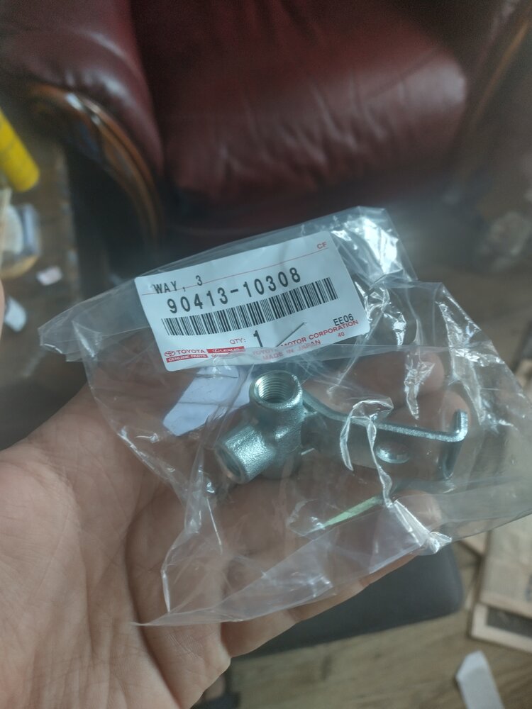

I should be able to re-make it all tomorrow,
but might need to cut that t-piece off and braze it's replacement on to the bracket... I am not waiting a week for a Toyota part, and it looks like it might be hard to get a through-bolt one to align correctly to fit the brake flexi.
Exactly I was a bit surprised looking at the hardware when I finally got it out, but someone blindly forcing a DIN flare over the mating cone for an SAE flare, and accidentally flaring the DIN flare nut into the bargain makesToyota use SAE double flares in their brake pipes. Part of having had affiliations to the US, I guess.
European vehicles use the DIN/ISO bubble flare, American and a lot of Japanese vehicles use SAE. My guess is that someone made DIN flares then overtightened the junctions to stop the inevitable leaks.
Yeah I was thrown by the metric threaded nuts, and SAE flare at first, but mixing standards seems to be a theme on Japanese vehicles.It took me a while to wiek tgat out when redoing the lines to the brake proportioning valve on mine.

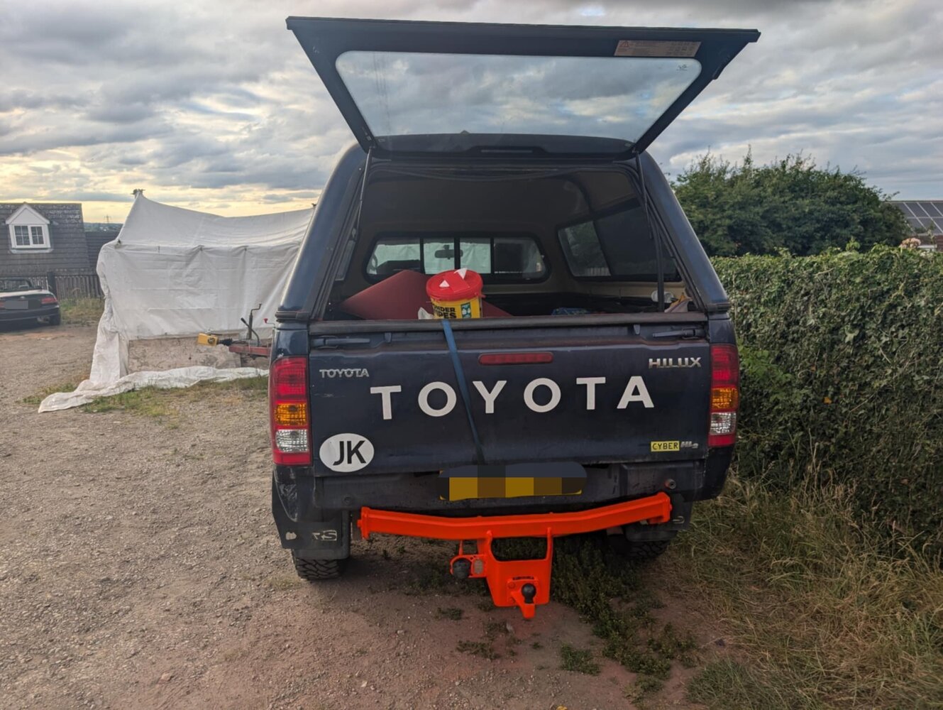

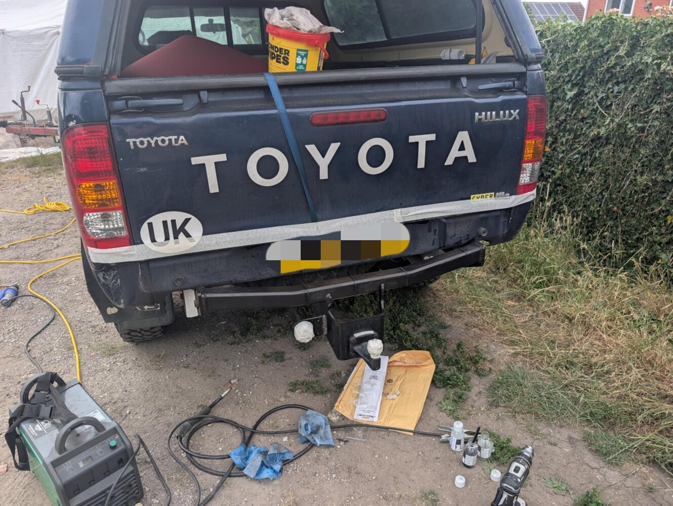

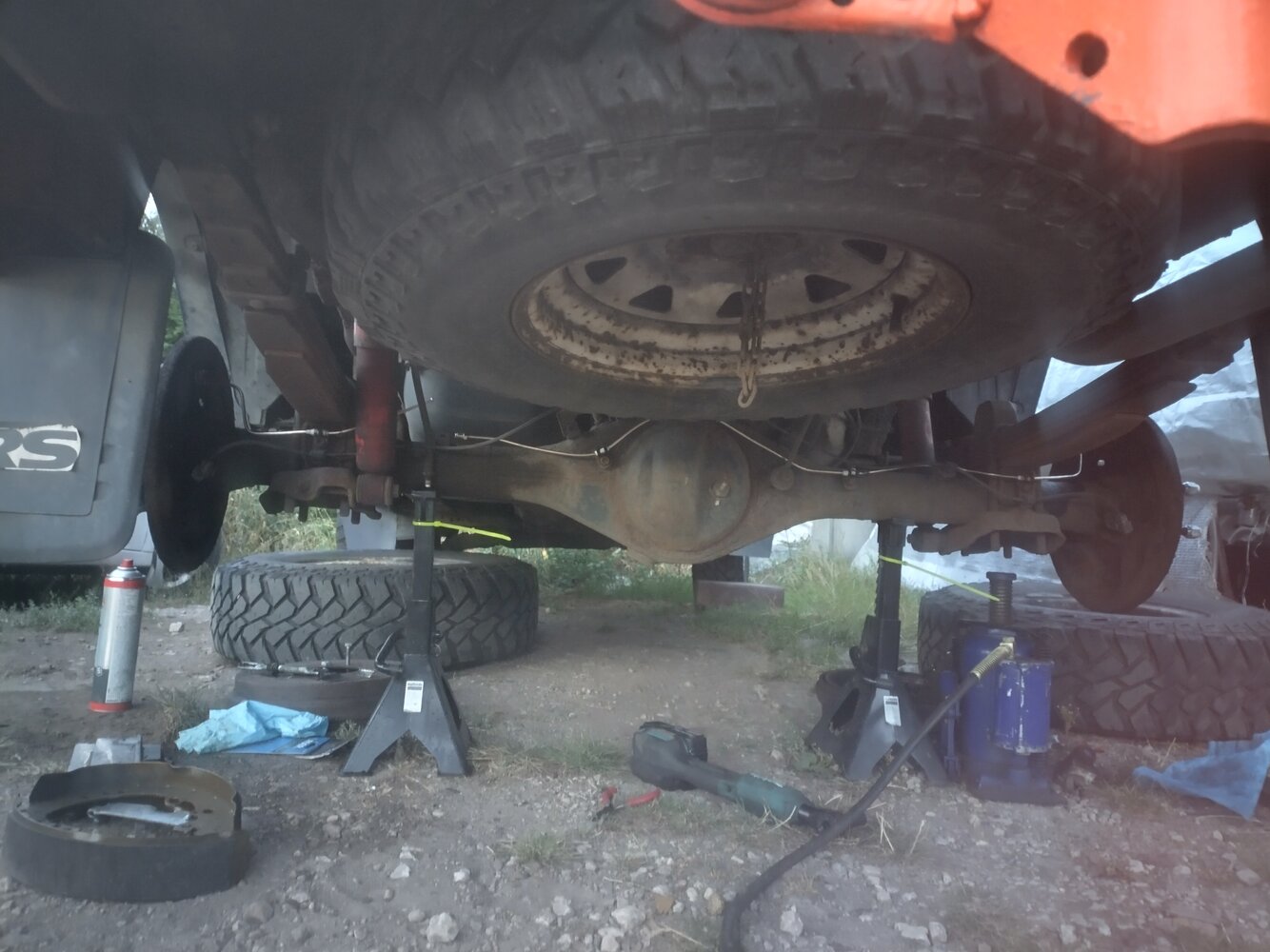

Hope it goes well for you, I didn't find it to be a particularly bad job, but it is time consuming to do on stands.BTW, thank you for this thread. I am approaching replacement of the fuel tank cross-member myself. It has totted out entirely where the tank touches it...
Thanks. I have got past the really hard part, I hope. That was separating the tub from the chassis.Hope it goes well for you, I didn't find it to be a particularly bad job, but it is time consuming to do on stands.
The higher you can get it up the easier the awkward welds underneath will be.
Oh and re-fitting the fuel tank alone is an absolute pig of a job, two or three people and at least two jacks will make it a lot easier.
The front left bolt was so corroded the head was 13.5mm instead of 17mm across the flats. I opened up a 30mm hole in the base of the tib immediately above it then drilled the head off. The front right captive nut had separate from the bracket, there was enough room there, and it was loose enough, to cut the bolt through with a hacksaw. Lifting the tub gives a lot more room to work. I can now do it in a morning, or afternoon , using the tractor front loader to lift the tub off.
I managed the fuel tank alone using Jenga type blocks of wood to raise and lower each end a bit at a time . Crap design of the hanger straps.
