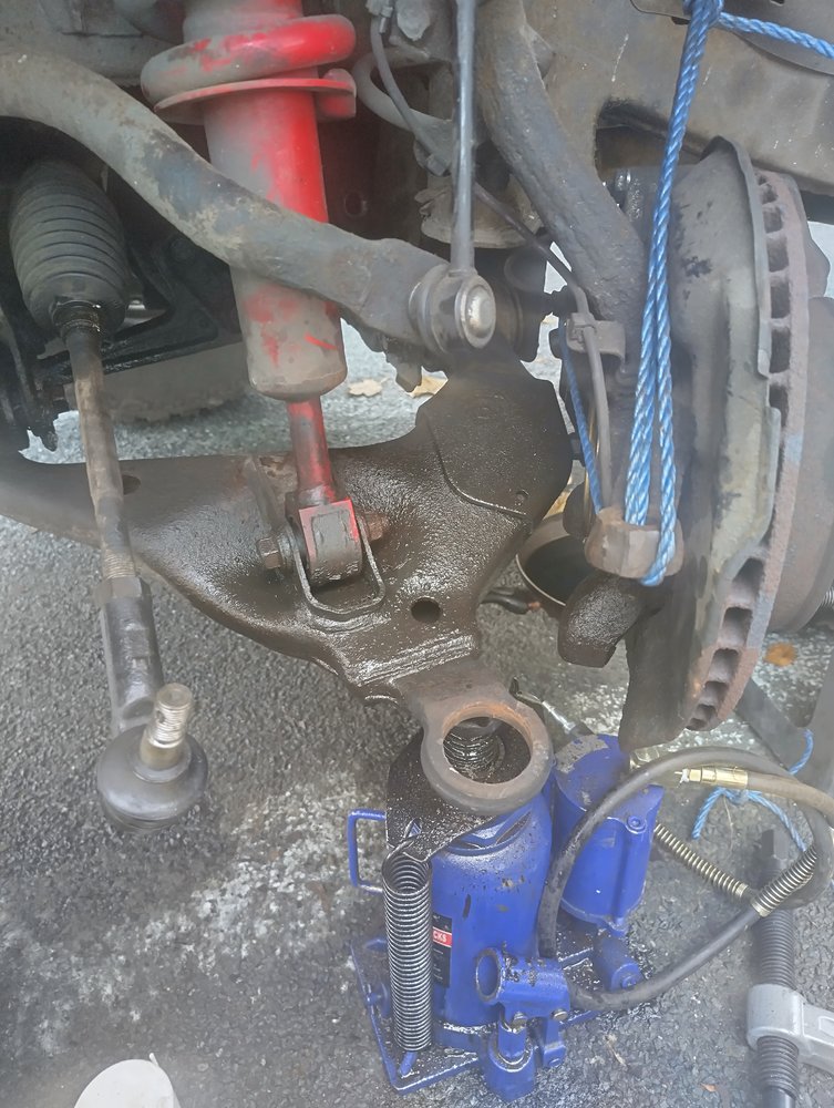

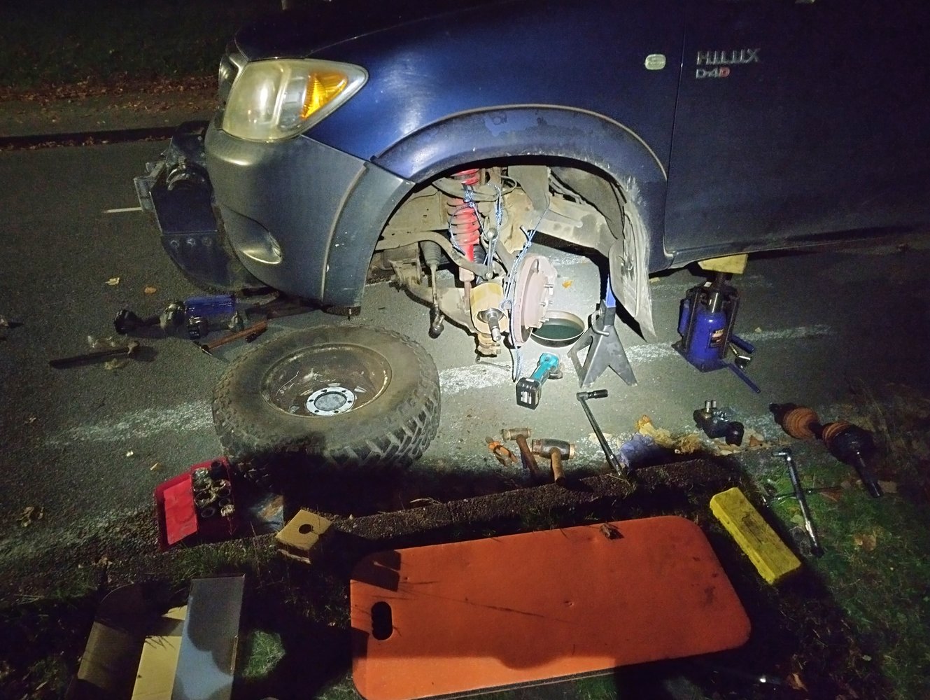

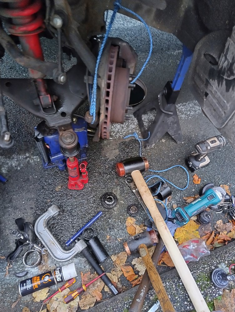

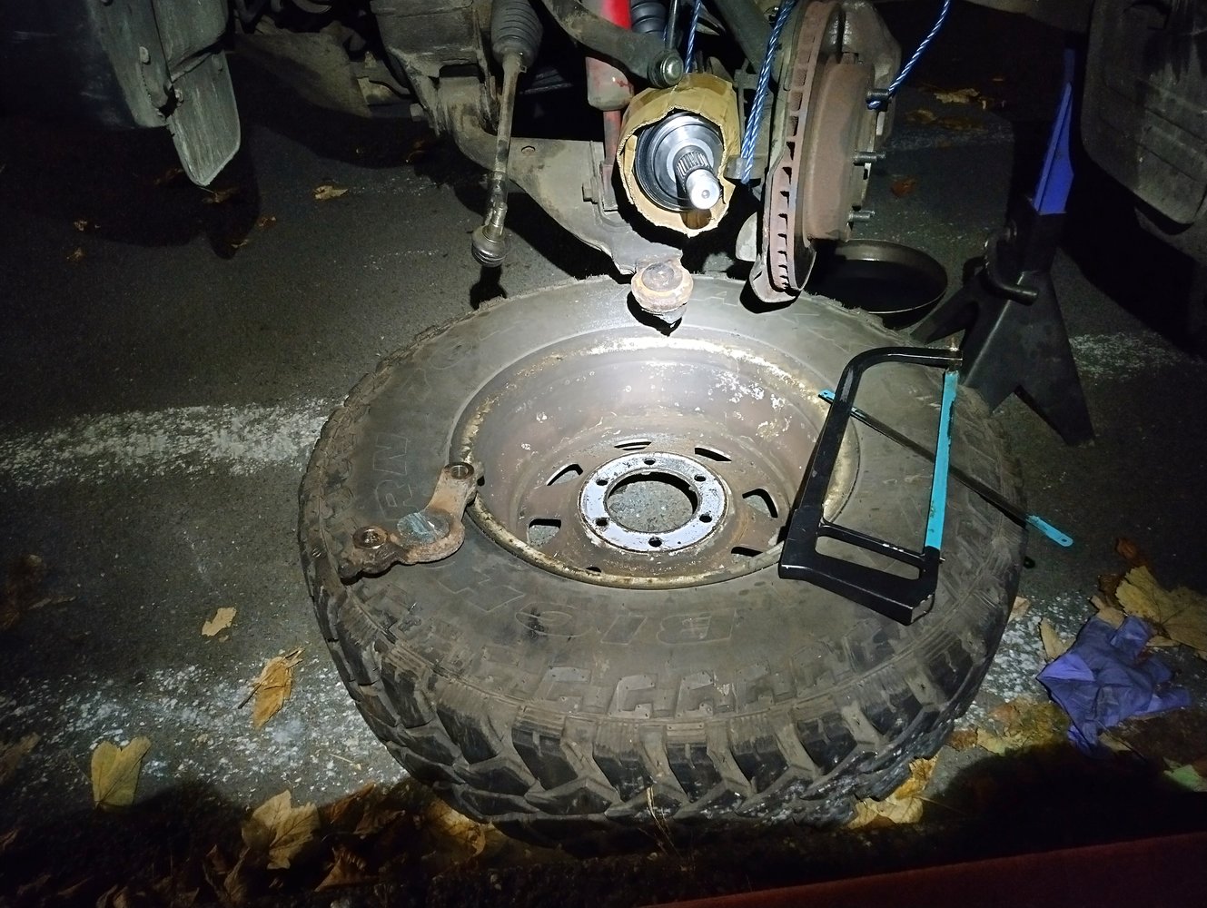

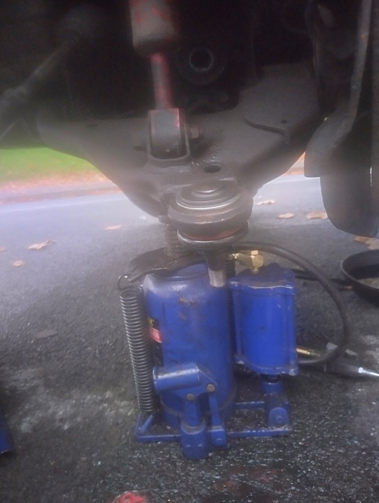

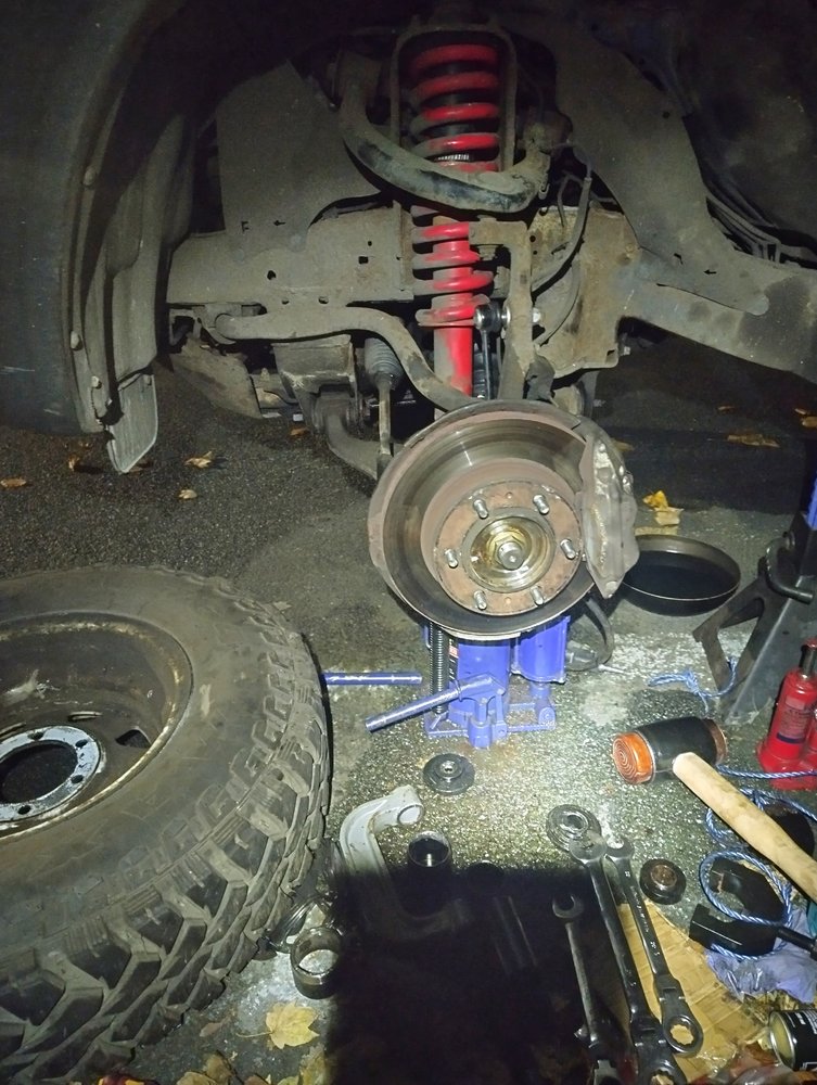

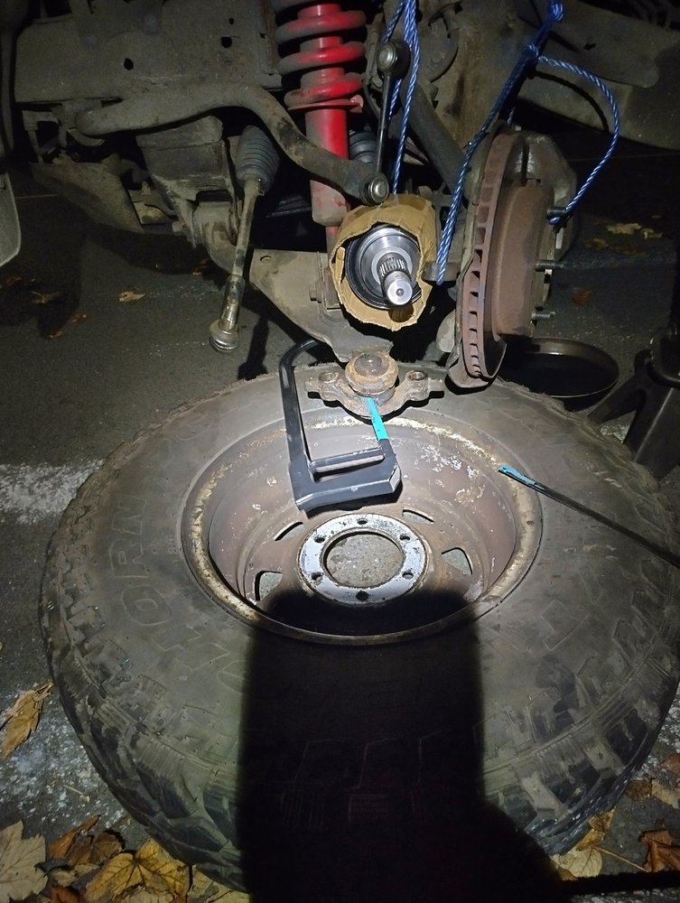

you did wellWell, it's coming, I have got it apart, drained the diff, popped the knackered driveshaft out, and reinstalled a new one...

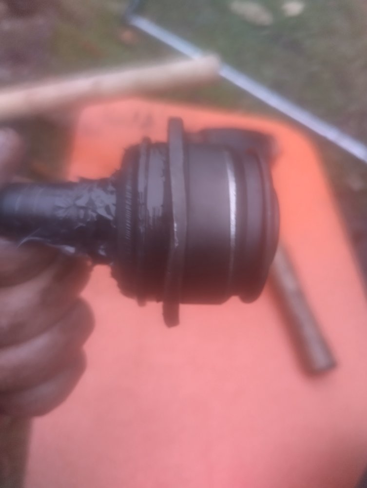

Unfortunately the ball joint is knackered, but it's taper is thoroughly seized.
Given I'm having to fix it on the only flat residential street near my house, I have to call it for the night I think.

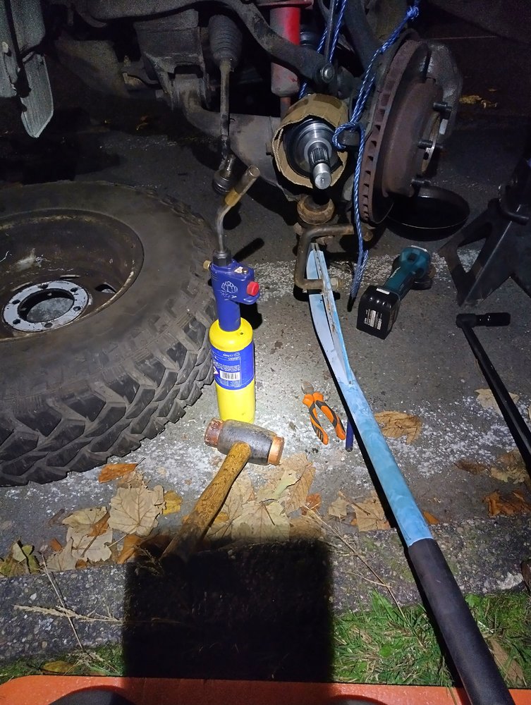

Or take the driveshaft back out and go get a sledgehammer in a last ditch attempt to avoid doing anything really drastic.I regret my decisions.
Had I left the knackered one in place I could just about have limped to a garage and made it their problem.
Currently the pressed in ball joint will not come out, and has trashed my ball joint press trying.
Options are:
- take the wishbone out and take it to my mates house to use a hydraulic press, or
- lug my oxy propane down and try to pierce it and burn out enough that the remainder shrinks and can be drifted out.
Two smaller ones connected together to get you by?The clips supplied are the awful tension style ones, rather than the gigantic adjustable O-clip style, I don't have the tool, not would I want to keep them, so I'm going to chuck a huge zip tie on for tonight to get it out of the road then go buy a set of proper clips from the auto factors tomorrow.
FFS
Edit: Double FFS run out of large zip ties.
I've run out of all the big wide ones that will take the tension needed unfortunately.Two smaller ones connected together to get you by?

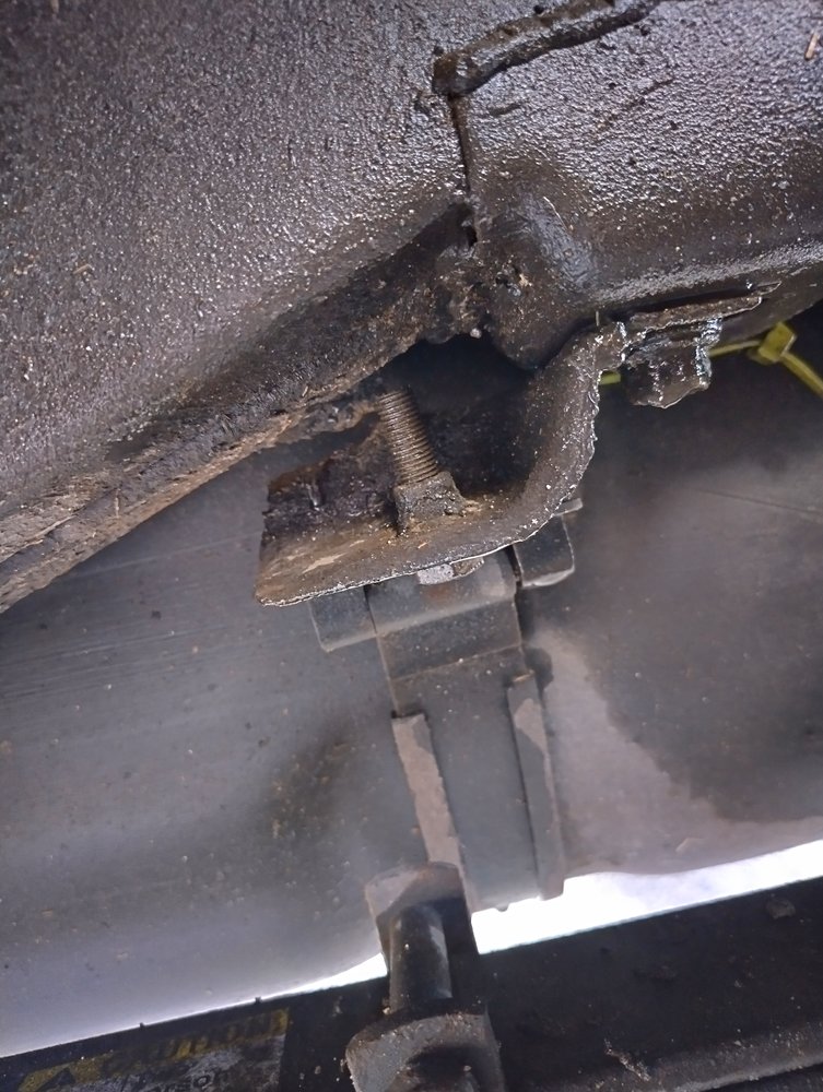

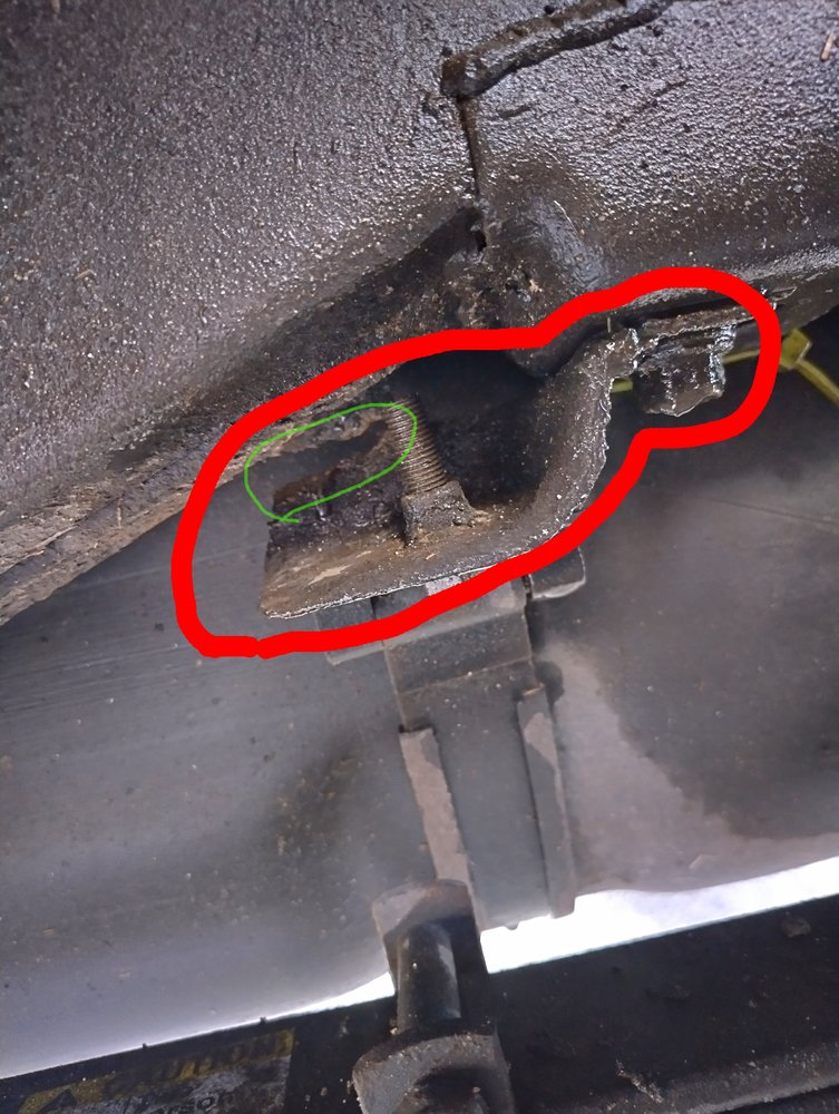

Alas the tank straps are fine (replaced with those exact ones in the summer).Not sure what exact model but Roughtrax have this,
Genuine Toyota Fuel Tank Strap - Front - KUN25/26
Original tank strap 77601-0K090 with rubber insulator - fits front of fuel tank only (S/Cab & D/Cab)www.roughtrax4x4.com
