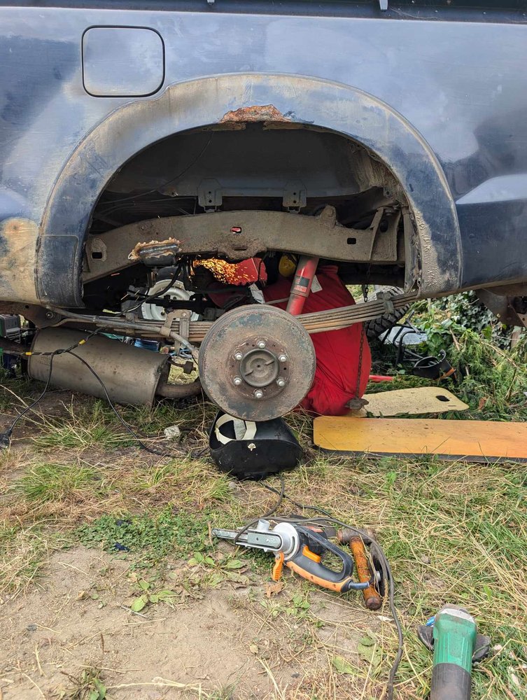

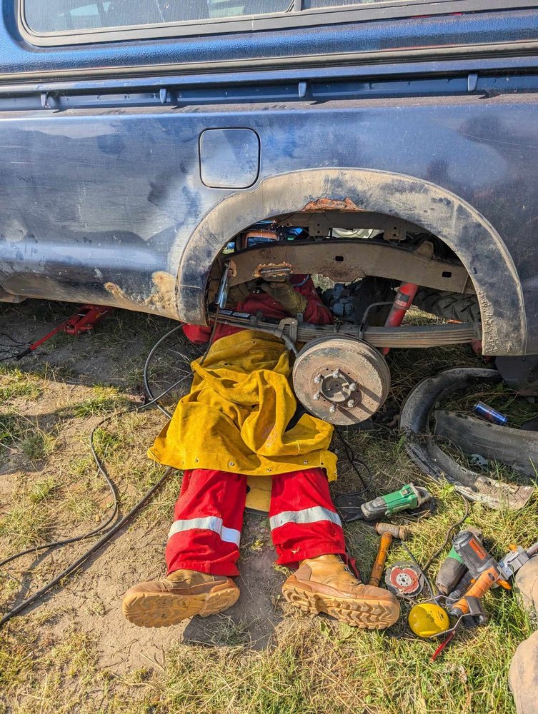

Finally got back from the middle east and had a chance to get on with this today.
No photos as I was in a hurry to get on with it after being delayed.
For anyone coming after me, I have made some notes
Procedure:
- chock front wheels, jack up both rear wheels, and get the vehicle on stands, my truck is about 5" higher than stock (between tyres and suspension) and I only barely needed the wheels off the ground to have enough space to work, on a stock vehicle you would probably need more height.
- Remove the rear wheels, "Eyebrows" and inner arch covers from both rear wheels.
- Remove the filler neck assembly.
- Siphon the fuel out of the tank
- Remove the fuel tank protector from the straps.
- put a jack under the tank and disconnect the straps at the passenger side, in theory they unbolt, but in practice it's likely you'll have to cut them off, a metal blade on an oscillating multi-tool is the only way I could do this without risking damage to the tank.
- using the jack slowly hinge the tank down until you can disconnect the fuel lines and sensor wiring.
- Then fold back the self adhesive rubber and lift the wiring loom and fuel lines out of their channels, remove any remaining wiring clips.
- fully drop the tank and pull out of the straps,
- if you cut the straps off, you can now remove the pins holding them under the center and detach them for replacement, you can also safely attack the strap bolts with a gas torch in an attempt to remove them... Not that it will help.
- disconnect the midsection of the exhaust and cut off the two supports on the fuel tank cross member going to the exhaust rubbers.
- Remove the drivers side rear shock.
- taking care around the wiring loom and brake lines, cut off the fuel tank cross member with a recip saw on the passenger side, as close to the chassis rail as is practical
- on the drivers side cut it off next to the exhaust bracket you chopped, if you cut at the chassis side it will destroy a reinforcing plate you want to reclaim to save work.
- thoroughly needle scale and wire wheel around the welds that originally mounted the cross member so you can see how it was attached.
- make reference marks with a punch or soapstone to help align the new cross-member later
- disconnect the battery and alternator.
- plasma gouge (or grind) the welds off gently to remove the remaining bits of cross-member.
I will add the rest as I work it out tomorrow evening.
