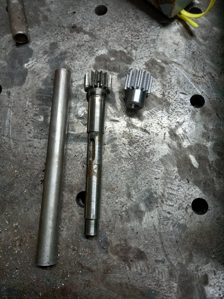

Sometimes you have to tease a drill down it, then tap it out.Try twisting it back. A large vice with aluminium soft jaws gripping the shaft then a pair of Stilsons with ali sheet wrapped around the teeth ought to get something to happen.
Can you drill into them ? i thought they would be too hardSometimes you have to tease a drill down it, then tap it out.
I think i may try a combination of ideas later if I get time , i'll drill one side first then see if i can twist it. Like you say re-reaming it is possible and they are not expensiveTaper pins are soft. Choose a drill bit smaller than the small end of the pin and enter from the small end.
That being said, the twisting and punching idea is worth trying. You need a short, well-fitted punch to get it moving and solid support of the part. A wobbly long parallel pin punch is not the right tool.
You can always re-ream and use a bigger pin on reassembly.

If you can determine module/DP and pressure angle then you can probably buy the gear and weld on to a shaft.this is the gear/shaft that engages with the rack on the bed of the lathe and its really worn would this be expensive to get made ?

measured it and its module 1.5 15 teeth i can buy one for about £15If you can determine module/DP and pressure angle then you can probably buy the gear and weld on to a shaft.
measured it and its module 1.5 15 teeth. I can buy one for about £15

I'll have to turn off the boss on the new gear as the roller bearings in the apron are only 4mm from the gear edge so not sure I will be able to pin itPIn and socket it, leave a “v”, weld up with the mig. If it’s ok for car driveshafts it will be fine for your lathe.
