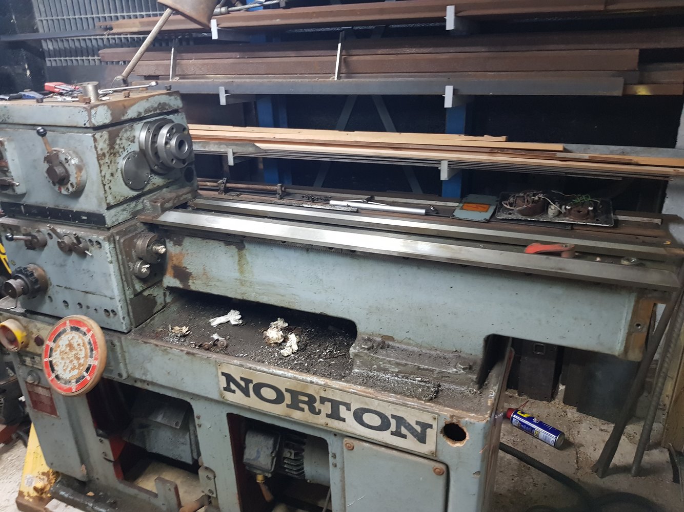

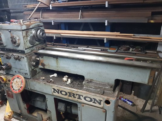

Oh yea of little faith...

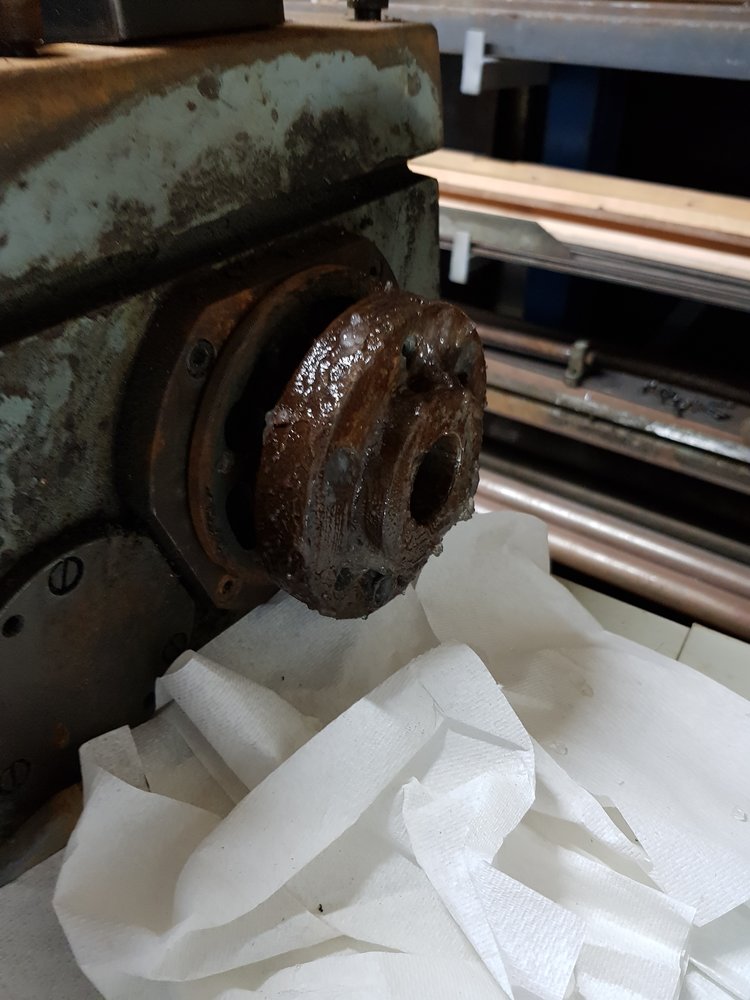

Looks like a gem. Slowly slowly catchee monkee

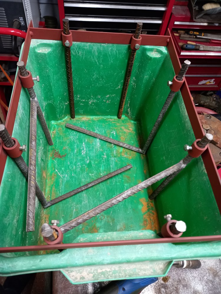

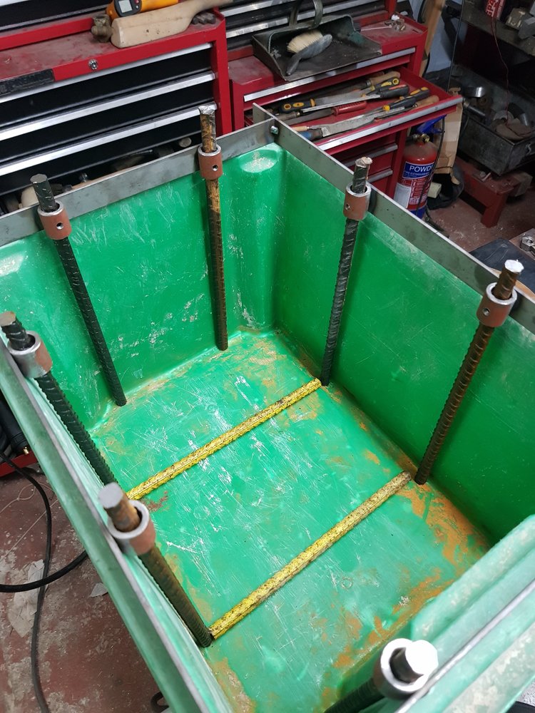

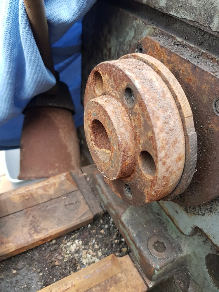

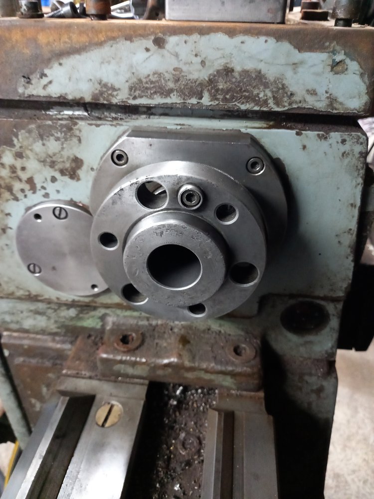

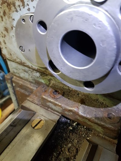

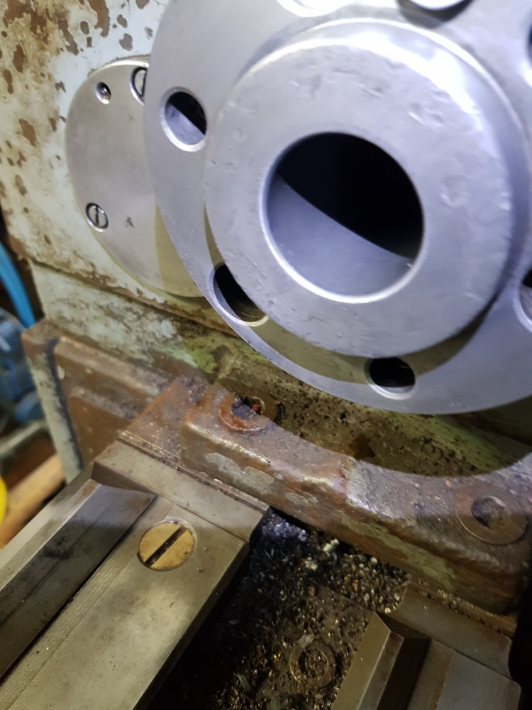

I'm impressed with your electrolysis - what are you using?
Found a small plastic tank and had some gash rebar from building job so lashed this up
30 ltrs of water and 1/2kg of soda crystals + my 12amp battery charger
not much has needed more than a few hours to derust
