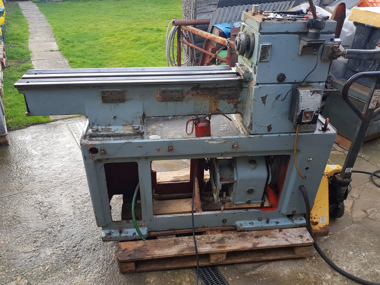

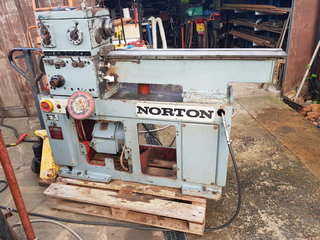

Paint it! strip as far as you need to do the repairs, derust, degrease and repaint the bare metal with a couple of coats of red oxide, don't overlap it onto the grey, then give it all a coat of grey machine enamel using a gloss roller, and a brush for the fiddly bits, it will look amazing! That is a very nice machine!!

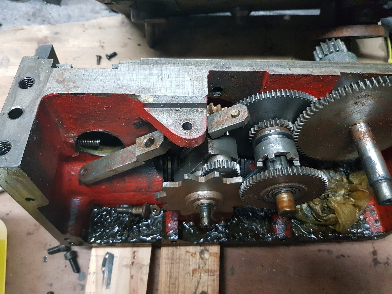

theres a little tank that fills up and a setting on the control lever that flicks oil about
