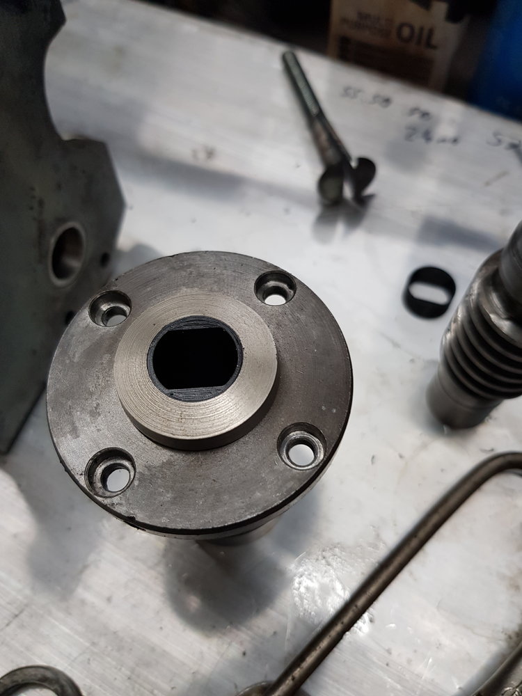

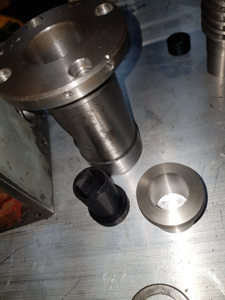

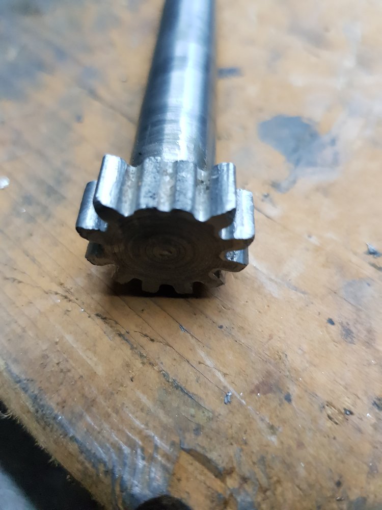

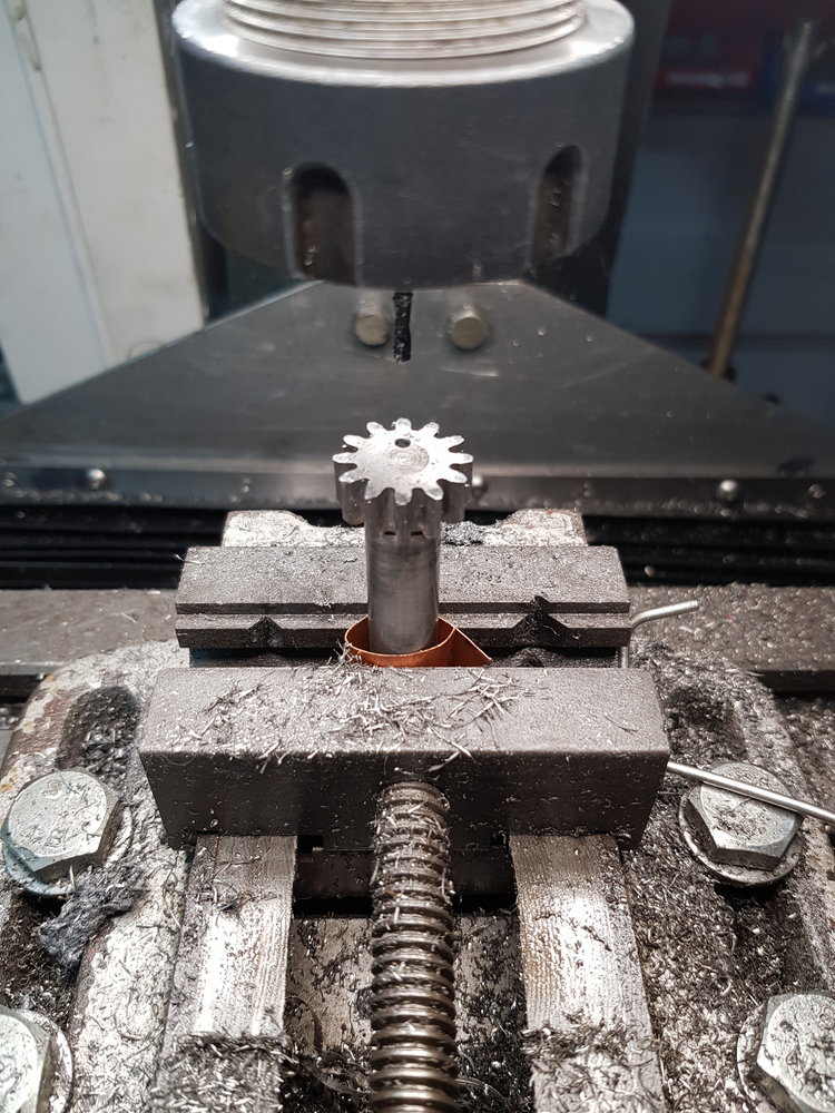

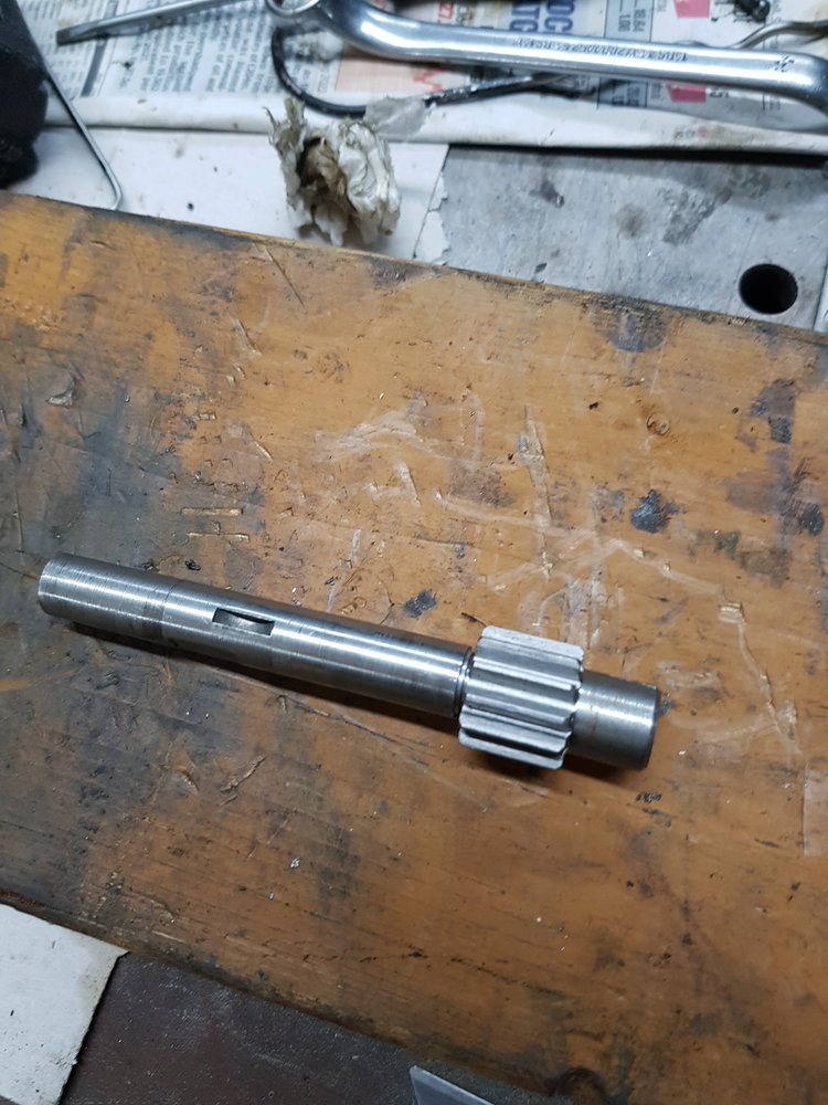

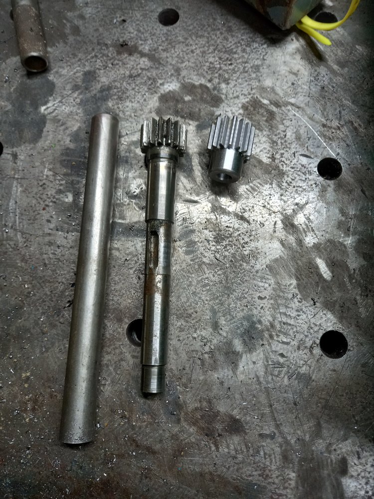

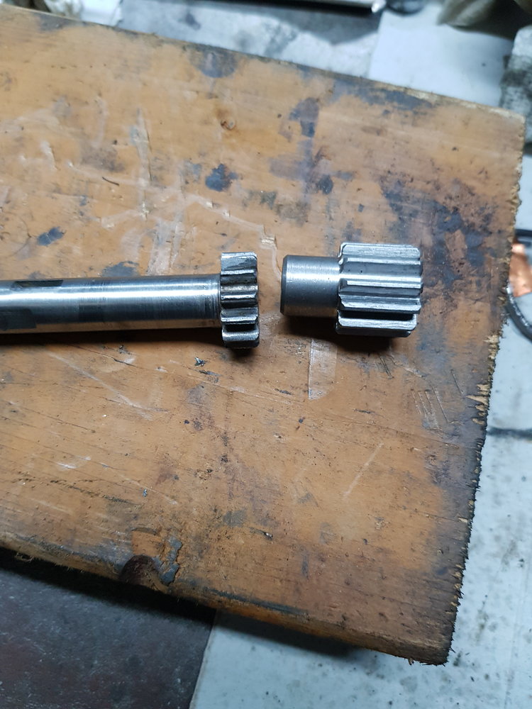

yet another option i like tooOr a variation on the French key as below (is this a screwed French key ???).
This one has a normal key too, but the grub screw keeps the lateral position as there's no room for a circlip.
So loctite, then when its gone off drill and tap for a grub screw.
Or if you decide to go loctite and taper pin I have pins and reamers you're welcome to borrow.

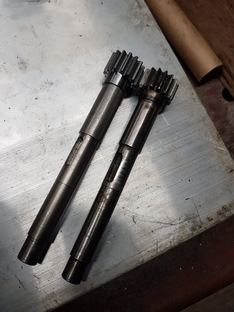

have you got any 3mm and 3.5mm taper reamers ? ive ordered some as need to ream out a gear and shaft with a misaligned one needed drilling out but they may not be the best quality will have to see
