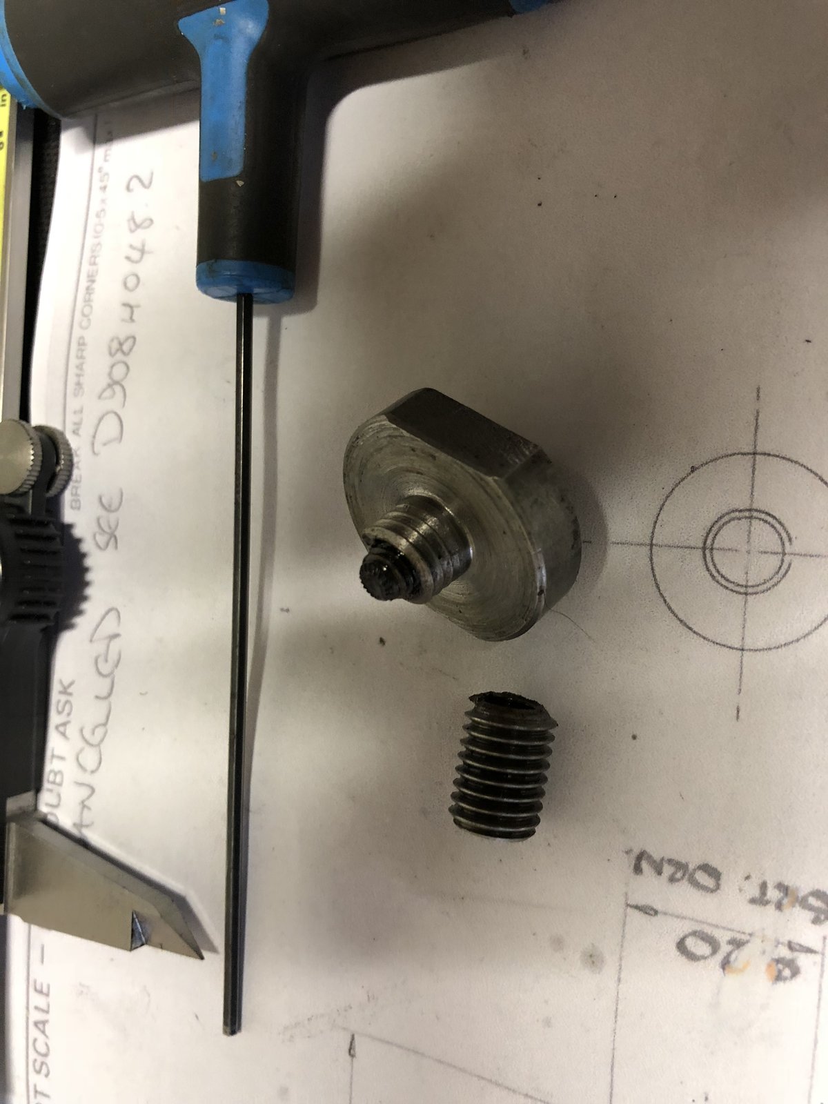

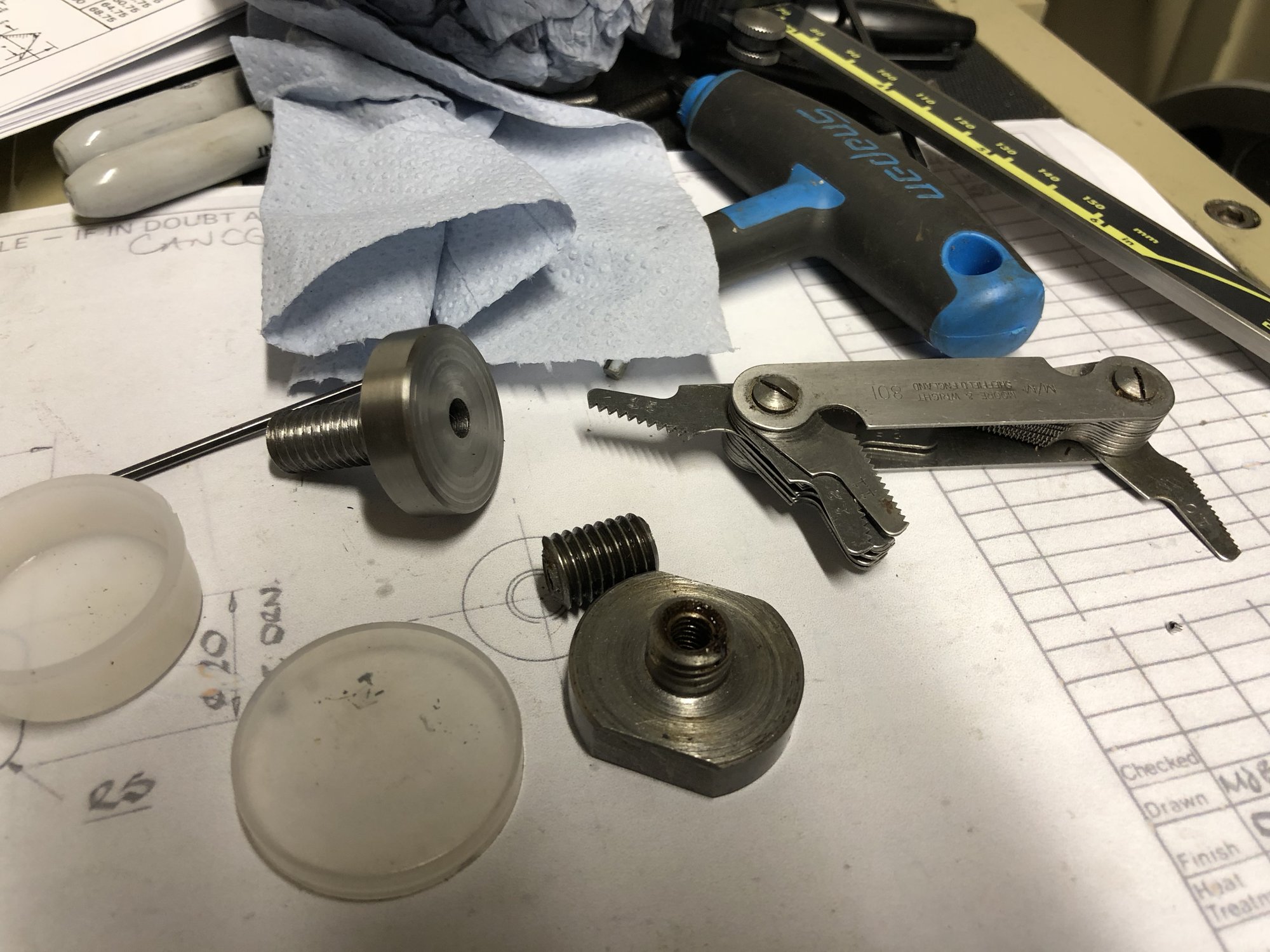

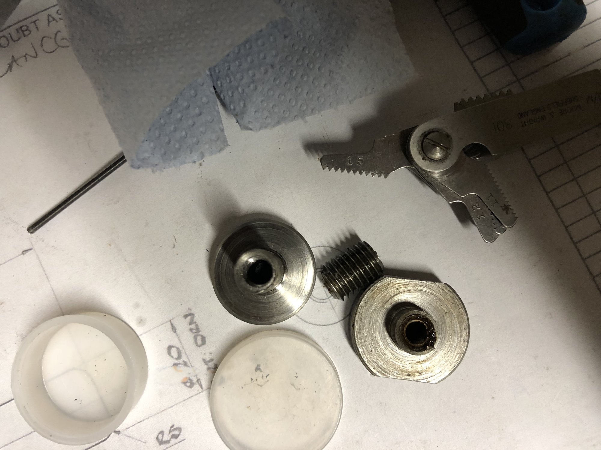

    Had a bash at another part tonight but failed. This part was fractured and I properly snapped It :dontknow:
    Made an interpretation of the part but hit two issues, the internal m6 thread couldn’t Finnish as my cheapo BETA m6 Tap has a rubbish design where the shank is thicker than the Tap so it can’t pass through to form deeper threads. Not the end of the world I’ve ordered a new Tap but the second problem is the internal thread was hand tapped and I must have skewed it as it’s not centric with the piece. So, wait for the tap to come and I’ll make part v2.0
    It’s all an enjoyable learning curve
    You can see the internal wonky thread here...
    Ped likes this.
  2. RichardM Member
    start the tap in the lathe next time which will help in keeping it straight
    slim_boy_fat, R-D-R and Brad93 like this.

    Thanks @RichardM - kicking myself as I've seen that done but didn't put it into practice :ashamed:

    Yep see double boosts videos. Centre in the tailstock into the back of the gap.
    Mind you only anygood if your tap has a centredrilled hold in the back.
    R-D-R likes this.

    If not you can wrap some gasket paper round the tap and clamp it tight in the tailstock chuck. The paper will allow it to spin without taking off the numbers.

    Re holding the tap in the tailstock chuck. Great use for the jog function on your vfd. Good for starting taps or power tapping.

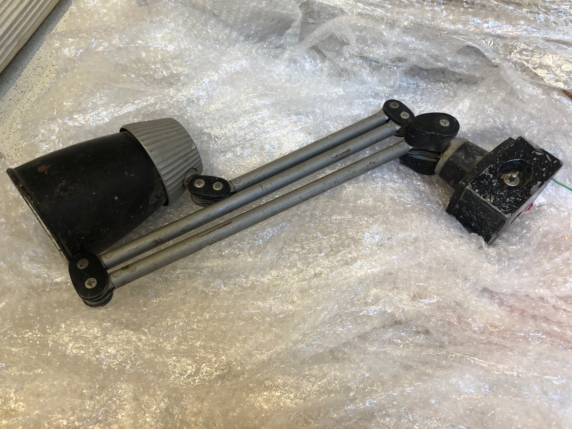

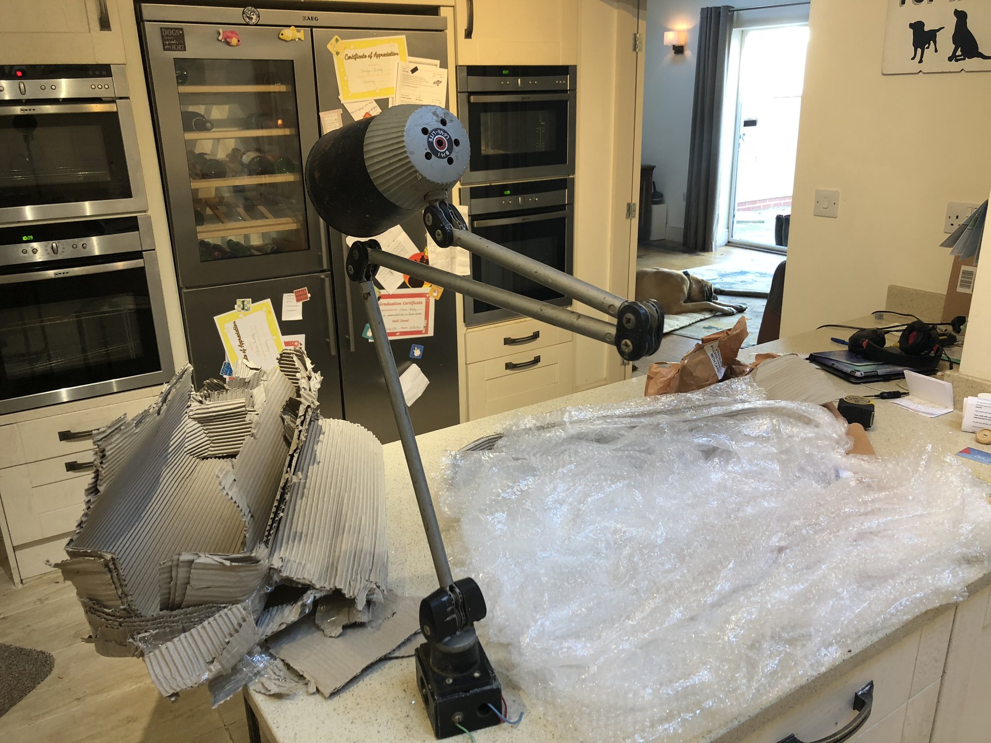

    Picked up a LoVo-Lite this week. Needs refurbishing but is all intact by the looks of it with nice swivel actions. Needs all new wiring and painting. Can anyone point me to where the Light is normally attached on the M series lathes. I had it in mind there were mounting holes on the back of the headstock but just looked and there isn't :dontknow:

    On my 140 it mounts to the back of the headstock with 3 button head slotted screws.
    Although for your machine I think I would of gone for something more modern like this https://uk.rs-online.com/mobile/p/machine-lights/0600723/

    DSC_1696.JPG Hello RDR. That light is the same one that is fitted to my Harrison Mill. I believe it's also the same as the ones fitted to the L5 etc lathes. On my mill the light is bolted to a pretty chunky 50 volt transformer that runs it. It got a bit bent after the incident in the back of the lorry.
    On my M250 the light is a slightly different design. It is also bolted to the top of a boxed transformer. The whole is then bolted to the back of the headstock, pretty much centrally above the motor.
    I'm away working just now but I tried to find a picture where you could see the transformer for the light. The light is fixed on top of this. You can just about see it in the above picture.

    Thanks Guys I thought they went on the back of the headstock, I'll have another poke around for some holes I didn't fill anything when I was restoring it.
    This is an older type of light, I was looking around for something in keeping and made a cheeky offer as it needs a complete rewire which was accepted :-) Ill be putting a suitable holder and LED bulb in it using a 240V toggle switch in keeping with the original meaning I won't need the transformer box. Will look to fabricate something to hold it off the back of the Headstock. I'm thinking ill use the last of my Harrison Beige for the arms with the black bits fresh Matt hopefully will look fitting for the lathe when done.
    If you had asked me 2 months ago the light would be the last on my list but on using it even with lighting above I struggle at times to see the detail in what I'm doing.
    slim_boy_fat and Brad93 like this.

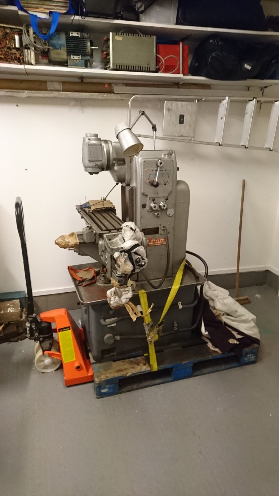

    Here is my circa mid 1960s Harrison Mill with a slightly bent looking light that is the same design as yours.
    Nice idea to update the light with an LED. I find it is really useful especially for boring or any other sort of internal work.
