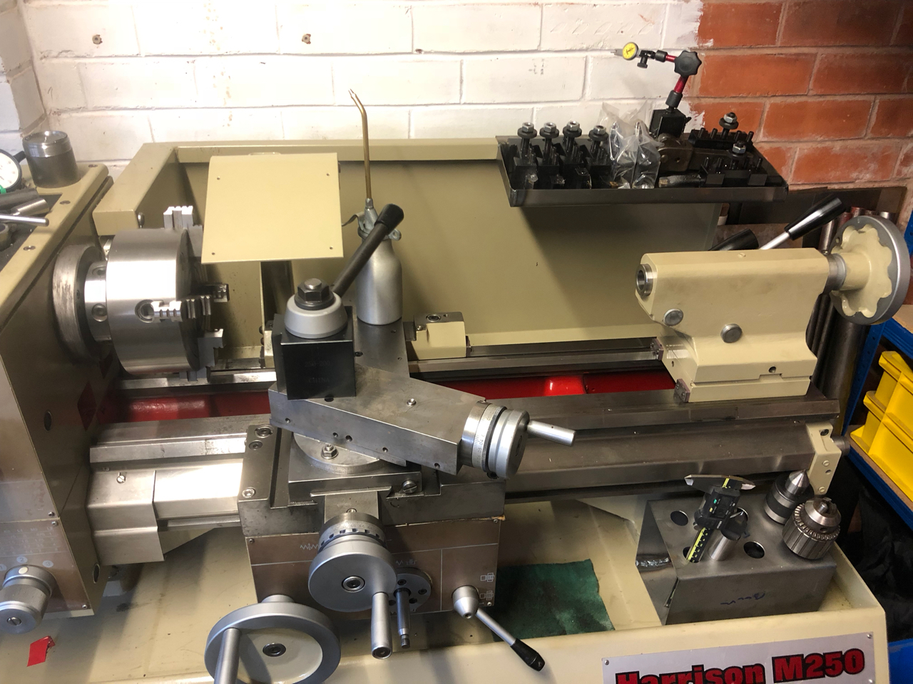

    Back home for a few days and decided to sort the tool post so made a post holder for the old toolpost so I can use it to cut the new toolpost:
    Mounted the toolpost and got it as true as I could, I still struggle using the indicators but getting quicker.
    Cutting went ok, it was noisy on the edges! got it done in half a dozen light passes
    Fit’s nice and snug, just need to tidy up the edges but another job off the list :-)

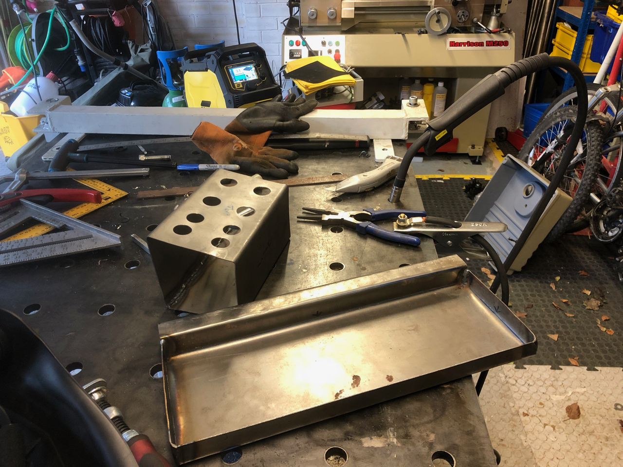

    Had to use my sheet bender to do a favour for a friend tonight and got side tracked afterwards making some organisation accessories for the lathe. Ill spray them to match when I paint the VFD enclosure.
    Should stop me piling things up on tray base was getting very messy.

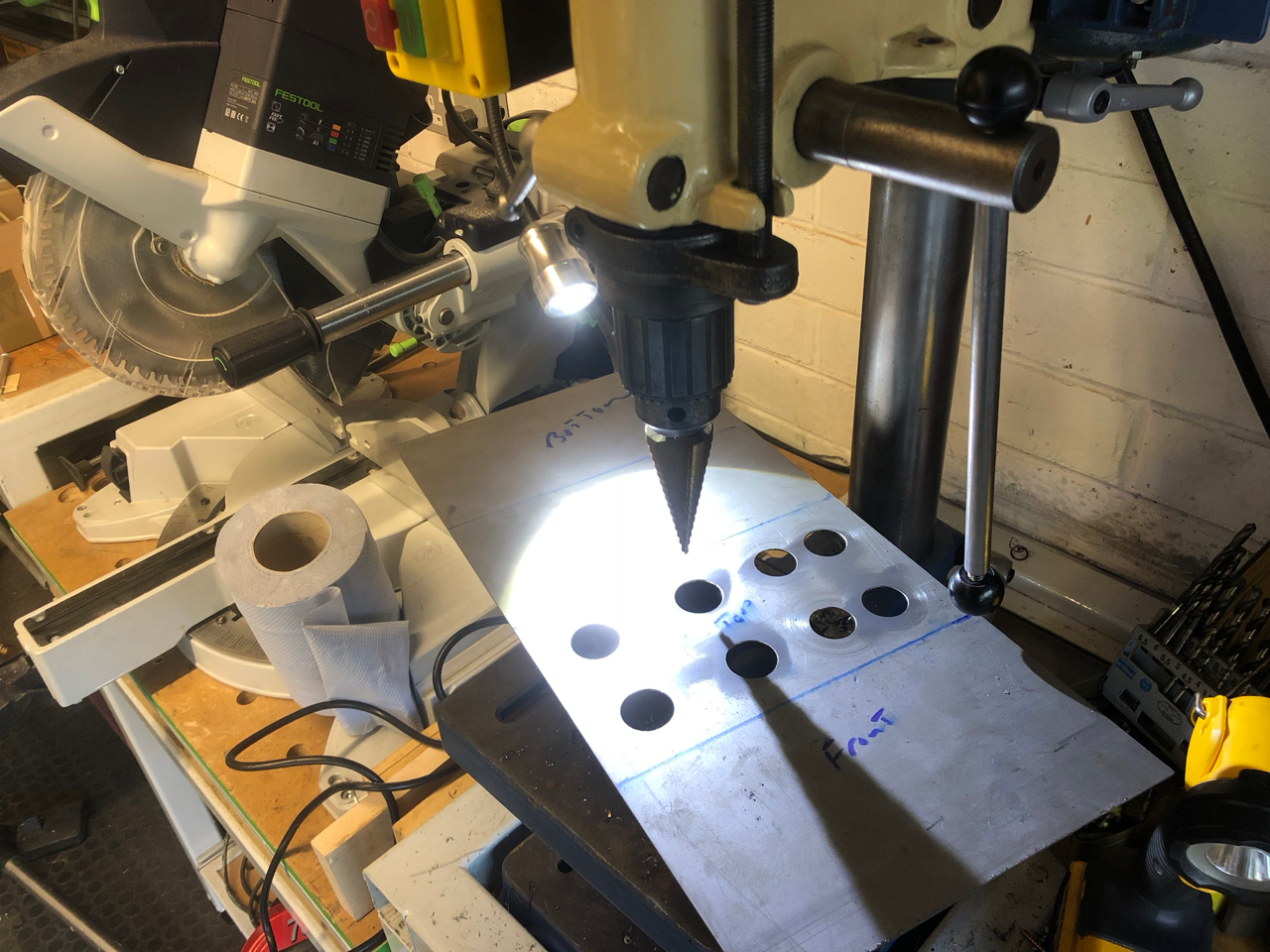

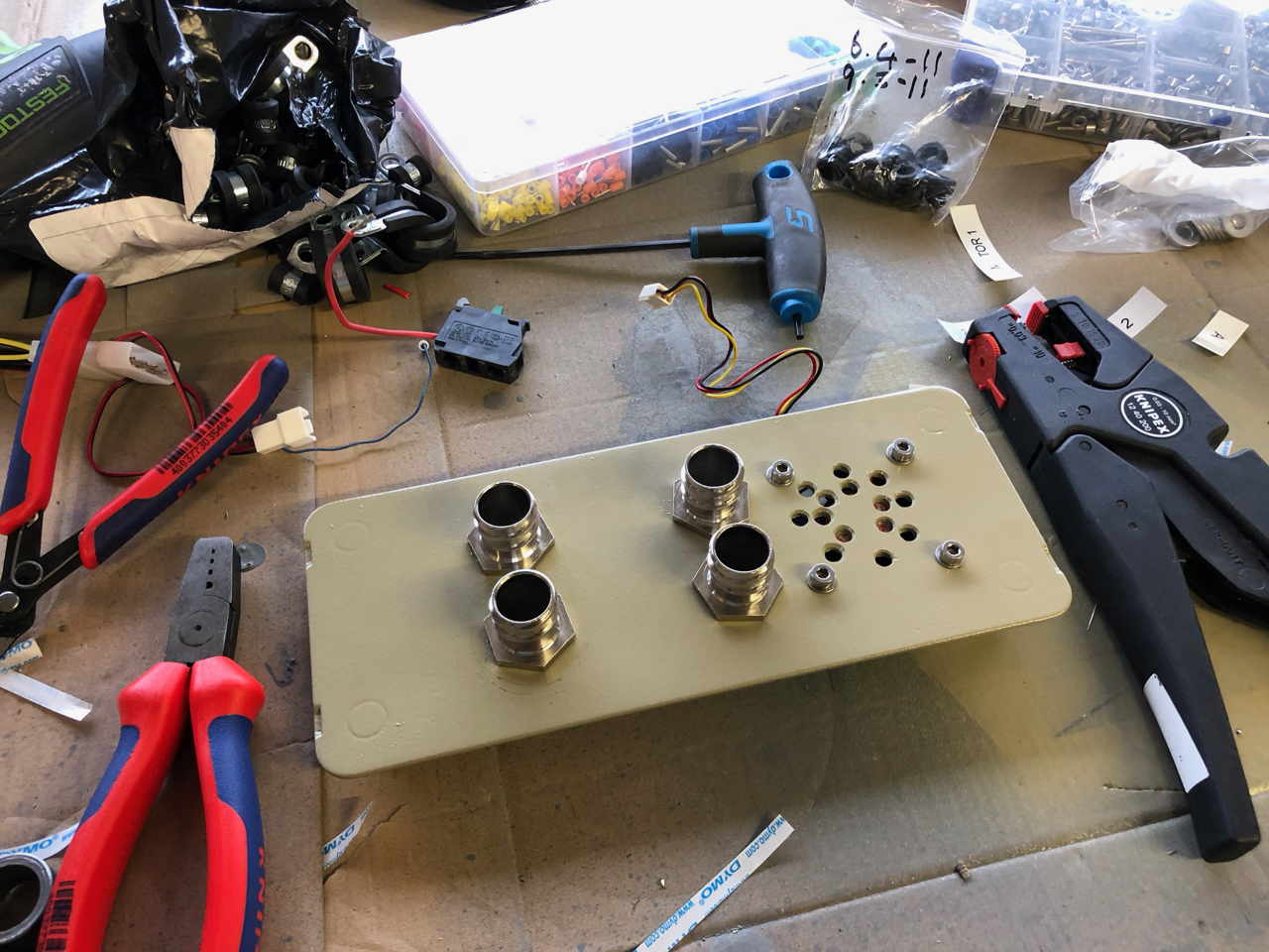

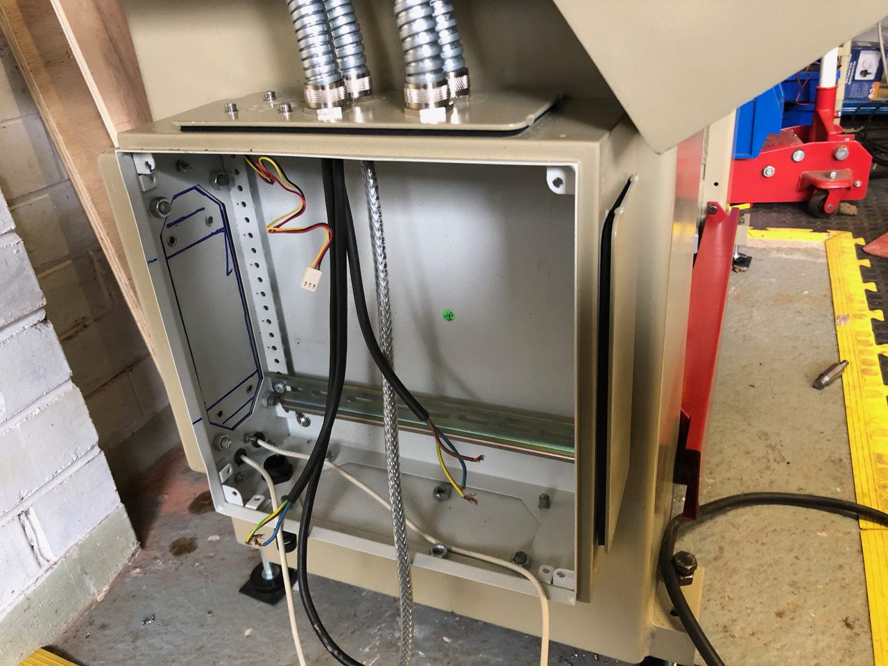

    Not had much time lately, made a start of the VFD enclosure tonight. Its a heavy duty steel Schneider enclosure, I'll be taking advantage of the VFDs thermal design by mounting it sideways to create the right air flow as per spec, there will be a fan at the top left of the enclose that will turn on when the VFD heatsink hits 85% thermal capacity and air intake on the bottom left - both will be filtered. It is handy having a lathe, I turned some custom standoffs for the VFD mounting plate in under 10 mins something that normally means a purchase :-). The Heavy Duty Brake Resistor is mounted on the outside and I made a cover to protect it. Now the main fabrication is done I can paint it to match the lathe then properly install and wire it all up.
    Below final position of components. High voltage cables will be routed up the rear of the VFD between the standoffs and all the control cables will be to the front to avoid interference. It's just the contactor and a 12v Transformer on the DIN rail which will power the Enclosure Fan and the Spindle Tacho.
    Knocked up a basic cover to protect the resistor.
    All mounted, painting next.

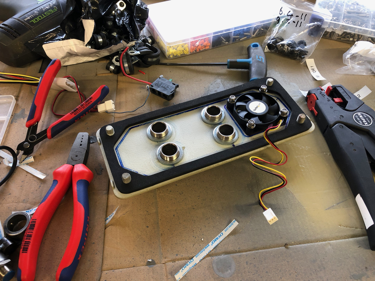

    I was worried about the Resistor producing heat, for the use I have given it so far its never got even warm. I did choose to mount it on the outside to be safe and then I have added a computer fan to the top to draw air out of the enclosure. This fan will be controlled by the VFD and programmed to kick in when the heatsink hits 85% of its max working temperature.
    Modified the top plate to take the fan
    mounted on the box
    there will be intake holes at the bottom protected by a filter.
