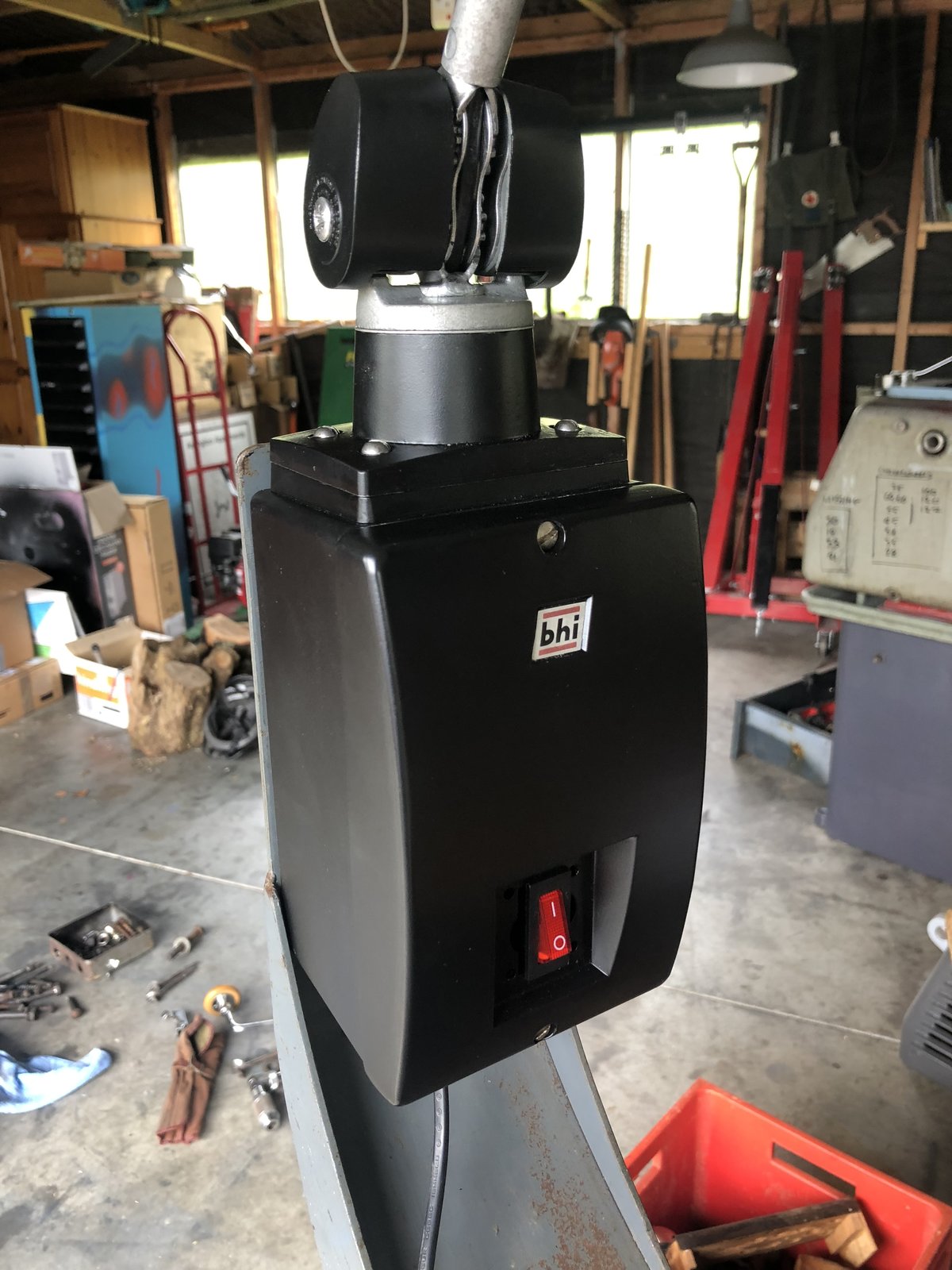

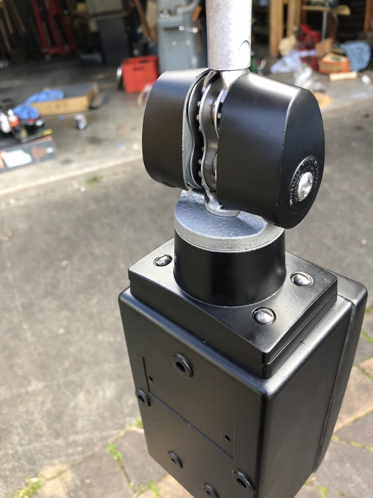

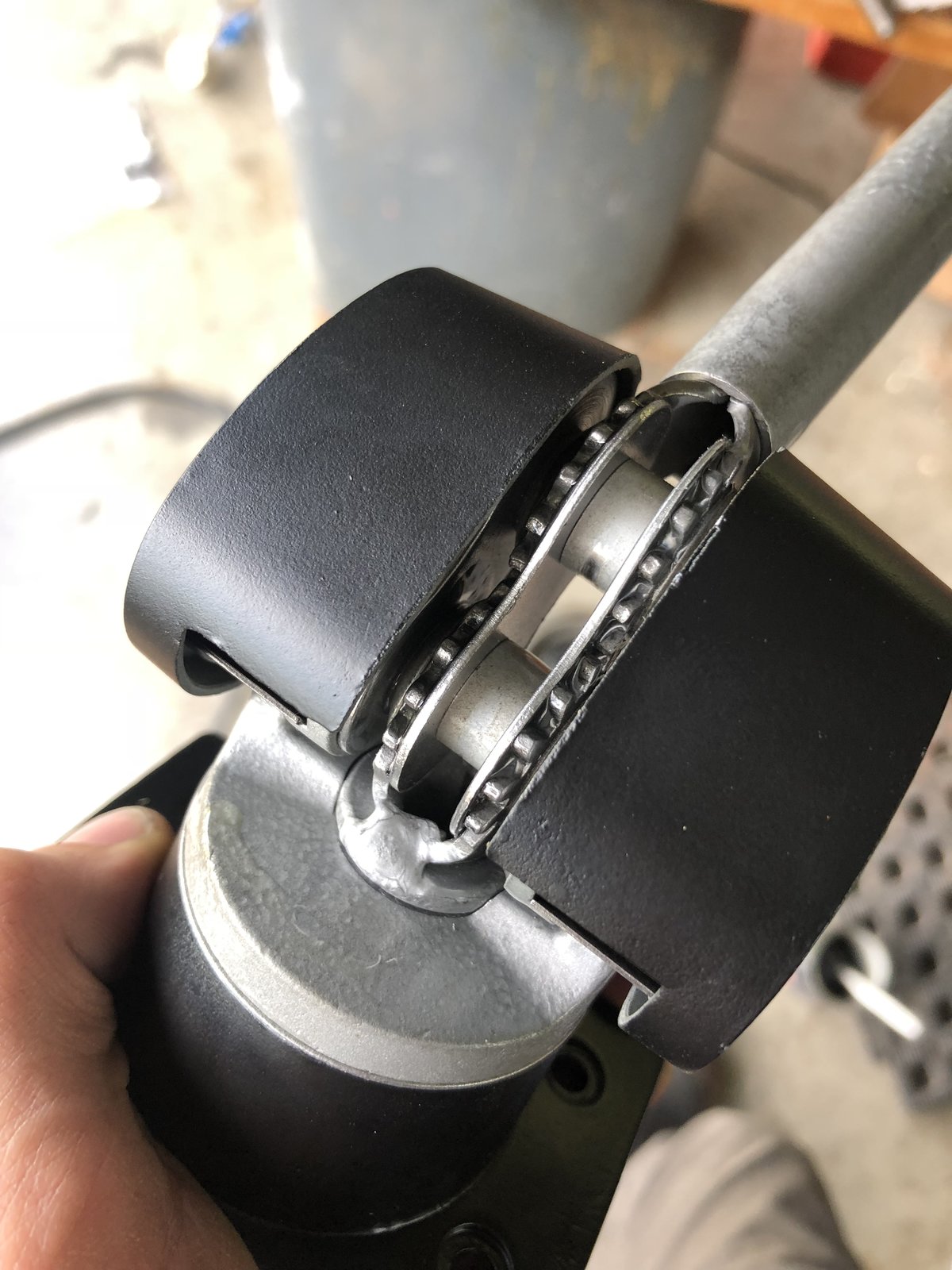

    Those lamps are lovely. I have the two arm version for my Graduate plus the transformer box. I chose to repaint in the original colours, black and hammered silver.

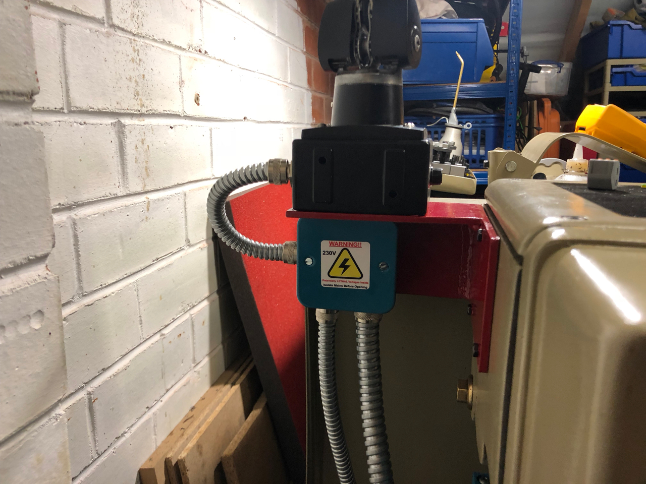

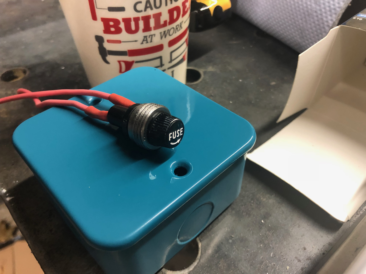

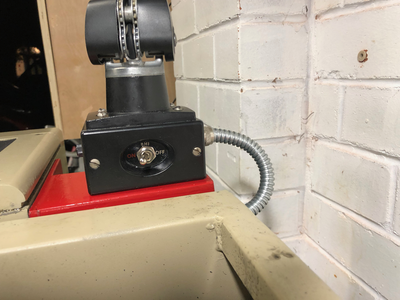

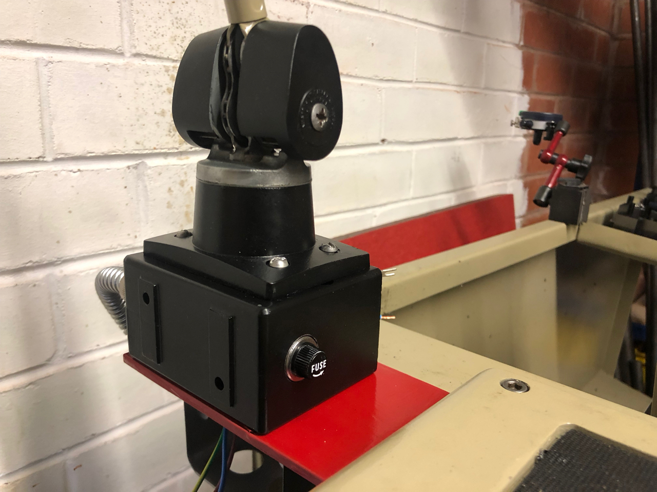

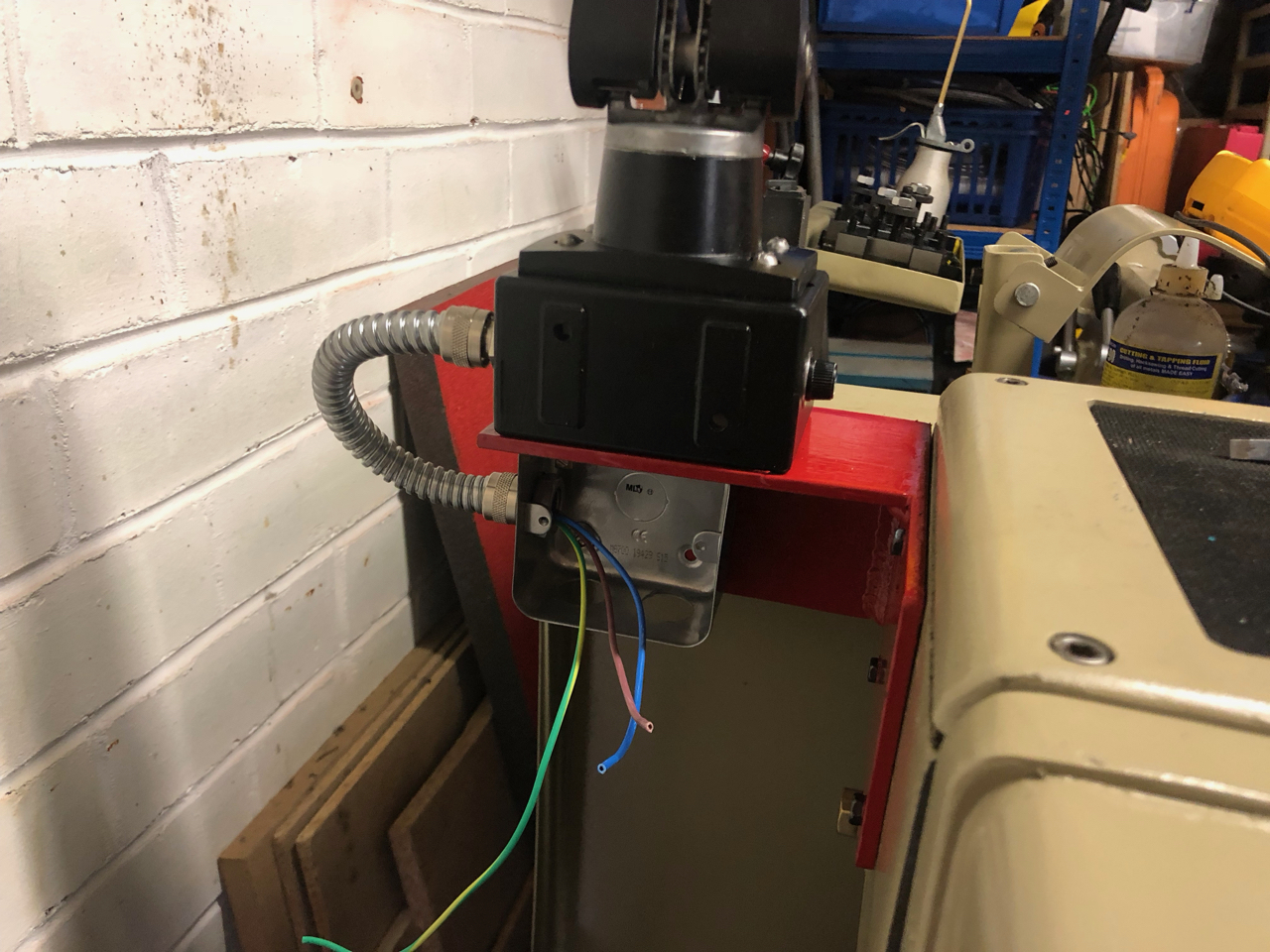

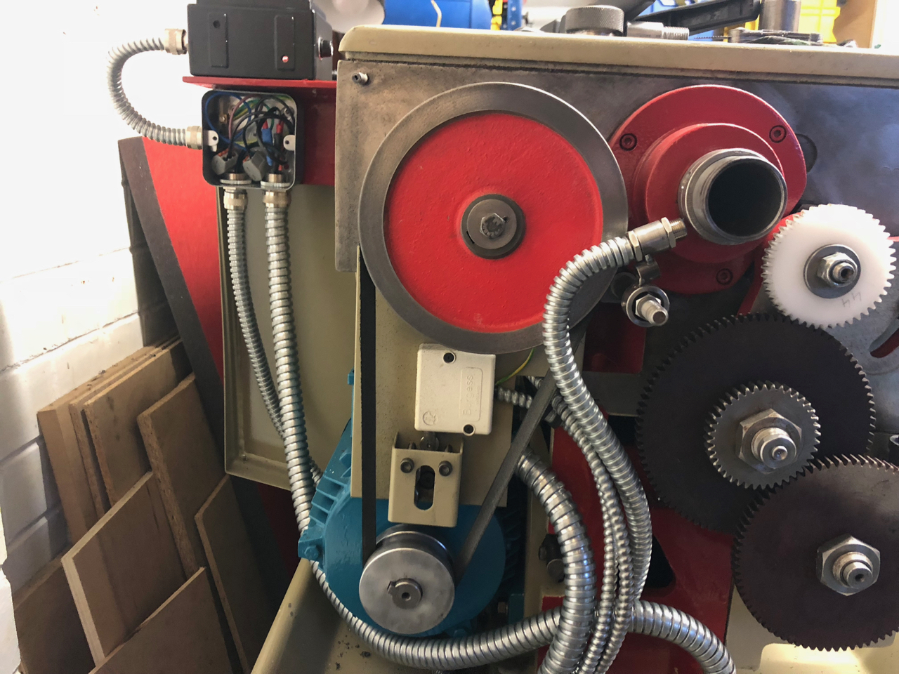

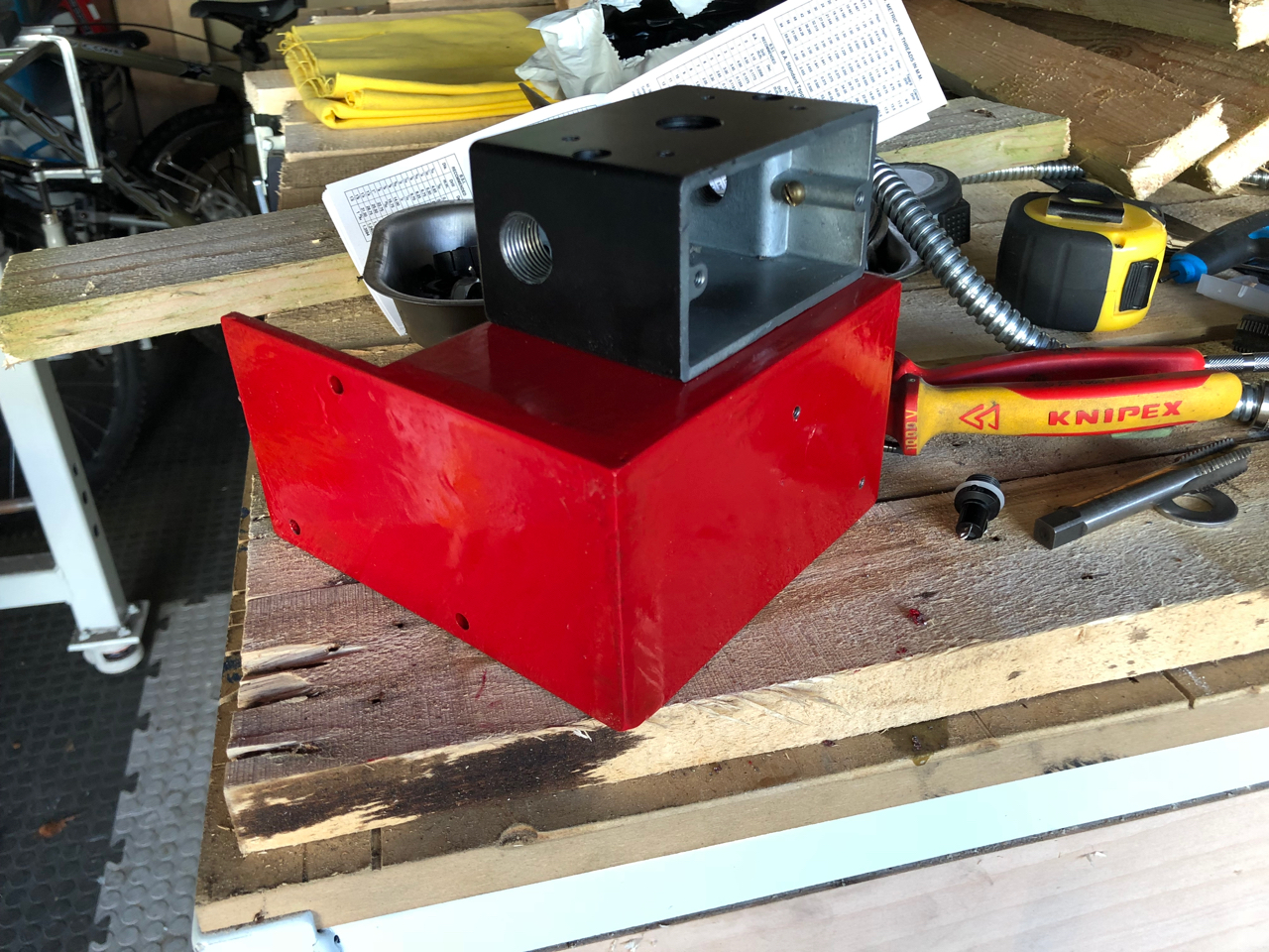

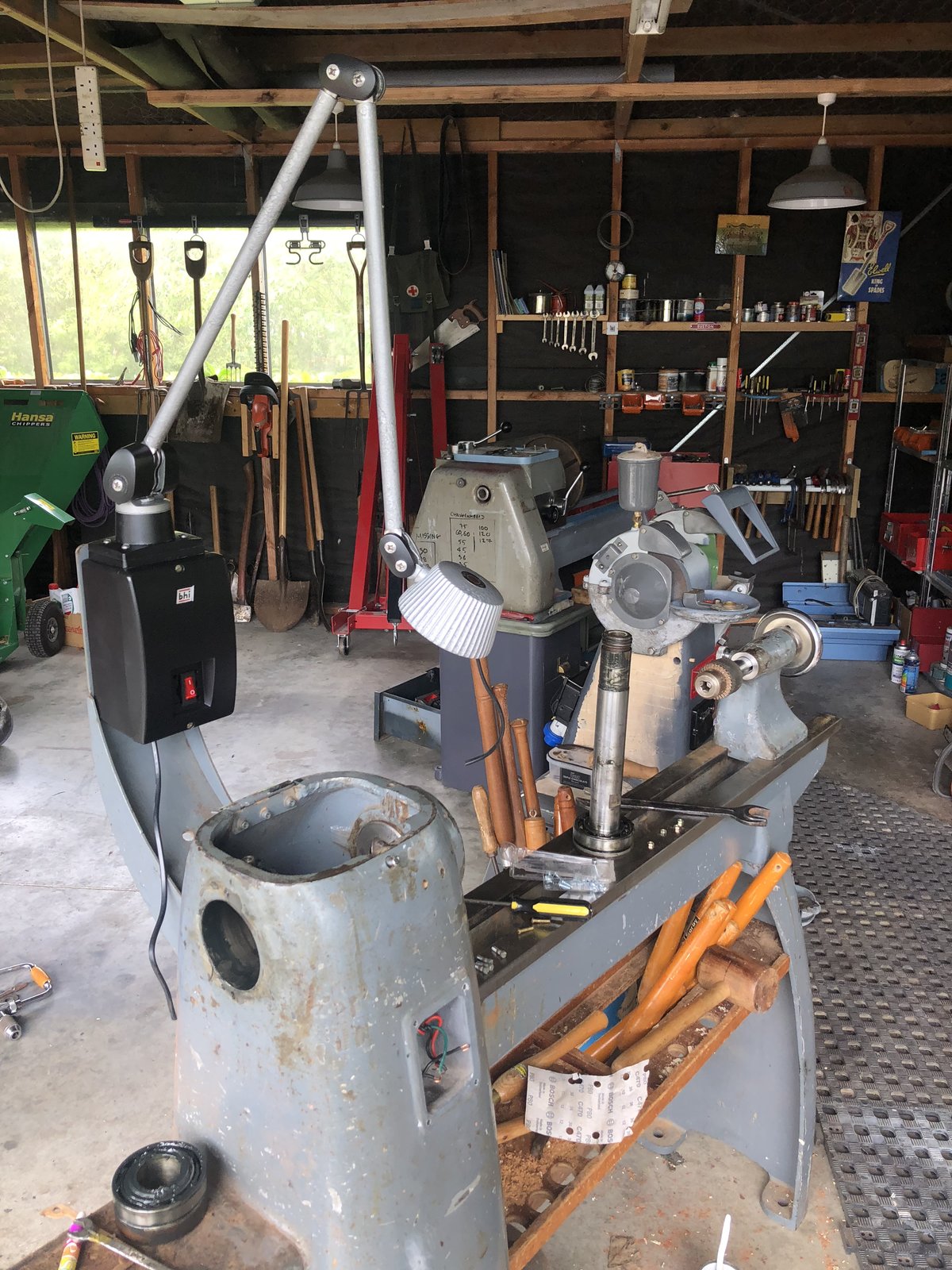

    Back home this weekend so finished off mounting the lamp.
    Fabricated a mounting plate to fit the rear of the Headstock, 5mm plate was all I had so it's turned out pretty sturdy. No Beige left so its the matching Red.
    I Turned a fitting to mount a fuse holder in one of the existing 18mm threaded holes on the lamp base. Nice being able to make things for problems you have:laughing:
    Mounted on the back ready to wire up, using a single gang metal clad back box sprayed in the same colour as the motor as a junction box.
    Fuse holder fitted
    sorted routing for the various conduits, looks tight but gearing and belt have lots of clearance
    All wired up, there is also a switched live to here for the future coolant system to be fed from and the DRO can be patched into here too.
    Managed to find a retro looking toggle switch that fitted
    all finished

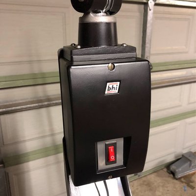

    Interesting - I went the other way with mine and embraced the modern lines of the lamp and added something which I think can be made to glow!

    @Dieselkid 63 that defo matches your more modern electrical box, and i would absolutely look at making it glow :laughing: mine came with the small, older looking box and had a toggle switch so i just went a replacement for that.

    It has three terminals on the back, not sure how you wire it, perhaps I'll do a thread, useless at electrics but eager to play with them!

    You'll probably have the wiring schematic on the switch, usually live in switched live out and earth. Check what voltage it is for.
  12. Dieselkid 63
    Dieselkid 63 Banned from forklifts
    Messages:
    4,572
    Location:
    Wellington, New Zealand
    Oh it’s 230vac I know that

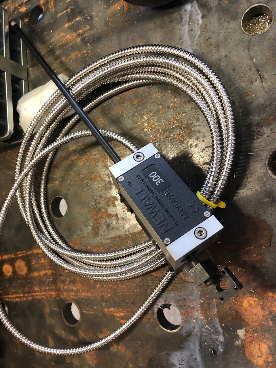

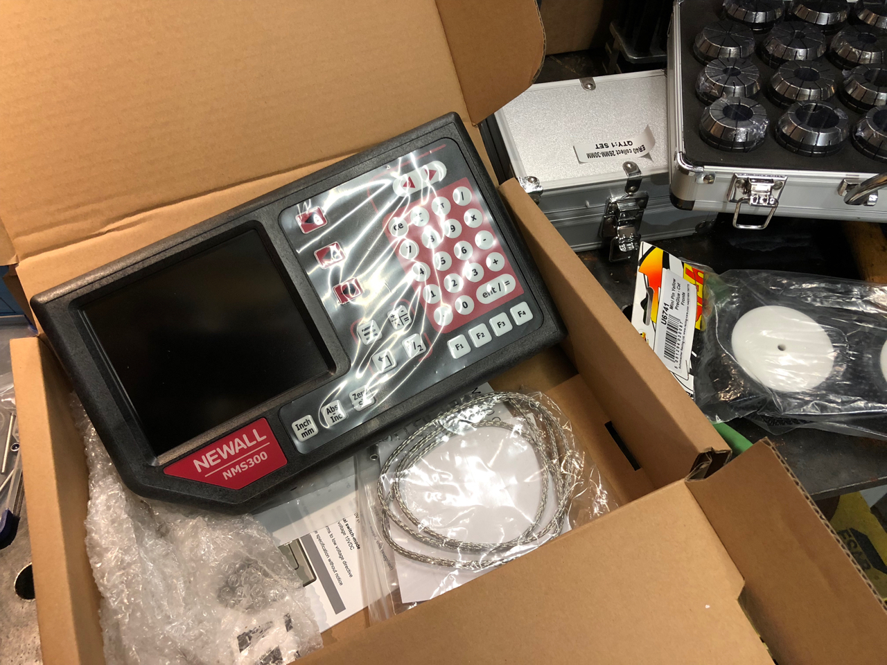

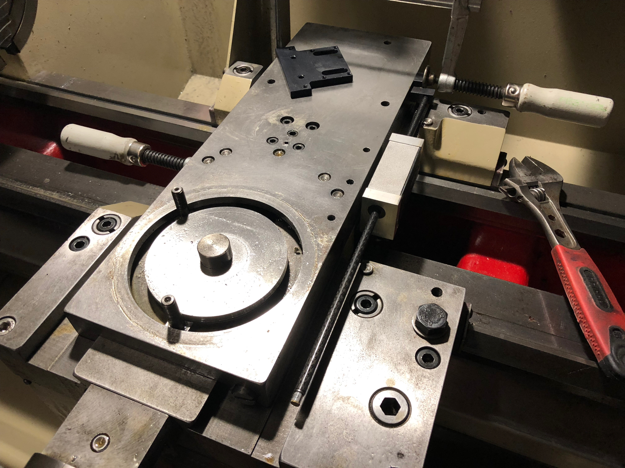

    Back from Christmas and new year Hols and decided to crack into the DRO kit. Just spent some time sizing things up, looking at it there are quite a few mounting options so will have a ponder and hopefully grab time to start drilling some holes in the lathe this weekend...
    Opted for a Newall system in the end, first impressions pretty good - nice solid feel to everything.

  19. Pete.
    Pete. Member
    Messages:
    9,329
    Location:
    Kent, UK
    Wow - someone's been splashing out. Not happy with the socks then? :D :D
    I hope those adjustables are kept in the 'tools you shouldn't really be using on a precision machine' drawer ;)

    Chuck them in the plumbing drawer
