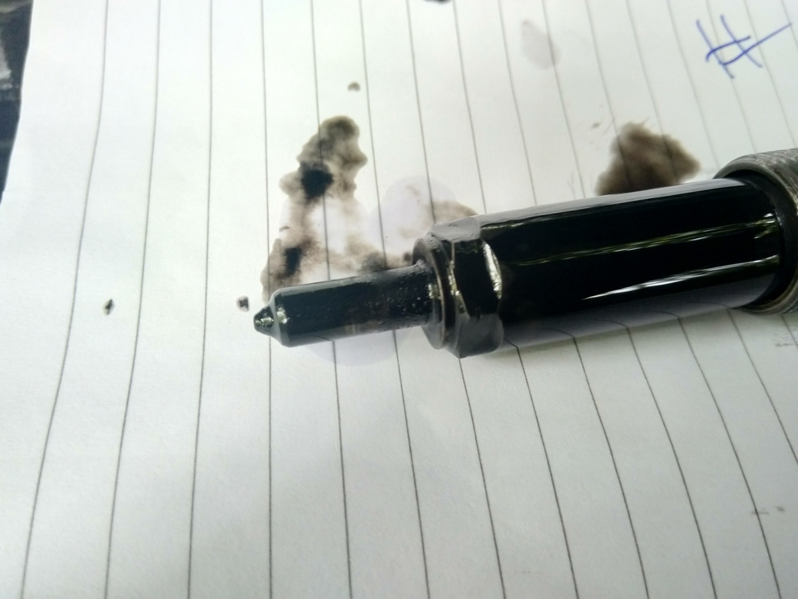

Thanks @Melvyn Best The " fuel metering valve" is by the pump not on the rail - it being blocked/contaminated comes up early in the diagnosis chart.
Going to replace the filter then when the 21mm injector socket arrives I'll tighten the loose injector as that is a rather obvious issue. If that does not fix it then yes a leak off test is probably next, the kit is cheap enough - unless I can get any more useful codes out of it.
know what else it might relate to (a solid hour of google turns up nothing) or could it be an error in the code reader?
