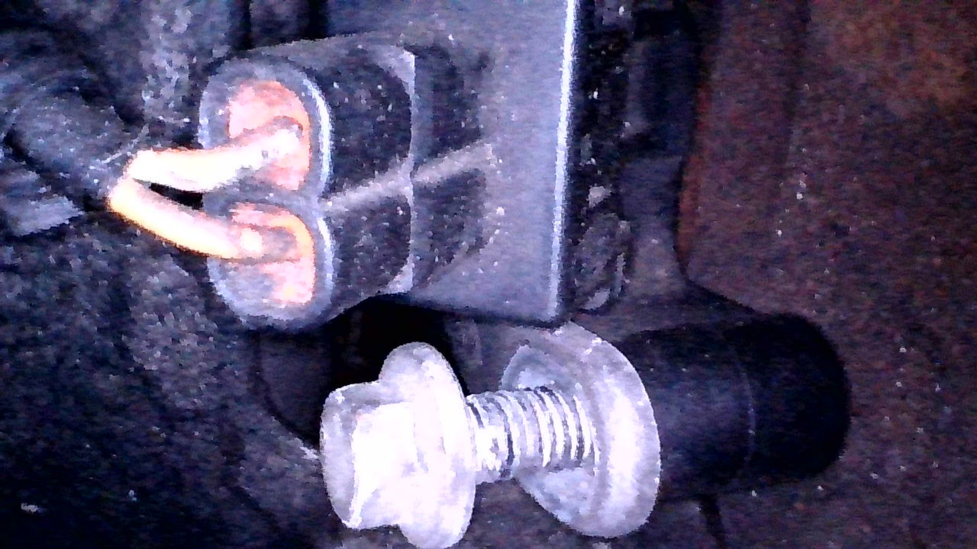

    Right so having a few minutes spare I thought I would have a poke around with the inspection cam, I found a small loose pipe off the air intake - between filter and MAF sensor unfortunately, so no change to start - as expected.
    However, bearing in mind Craig's post re crank sensor I took a look down there and I am pretty sure that's it - waggling around in the breeze..
    Pull it out, inspect and bolt up tomorrow.

    Alas took it out, cleaned, checked resistance @400 ohm OK, Re- mounted and still no start.

    I went back to the crank angle sensor and pulled it out as something was bugging me - despite no code there is a crack in it so it may well be the culprit.

    Replaced the crank sensor, still no start.:dontknow:
