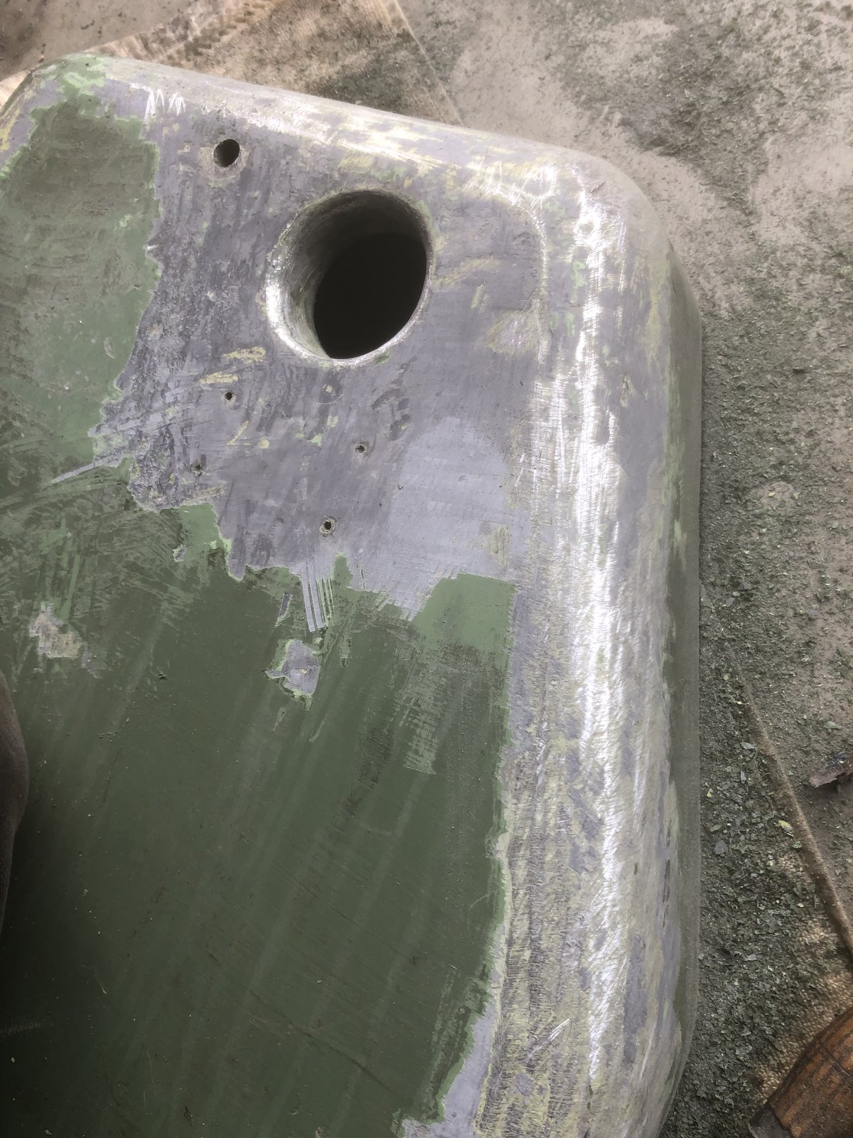

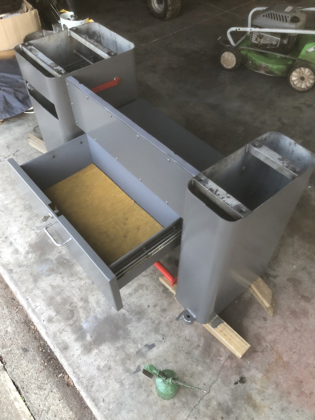

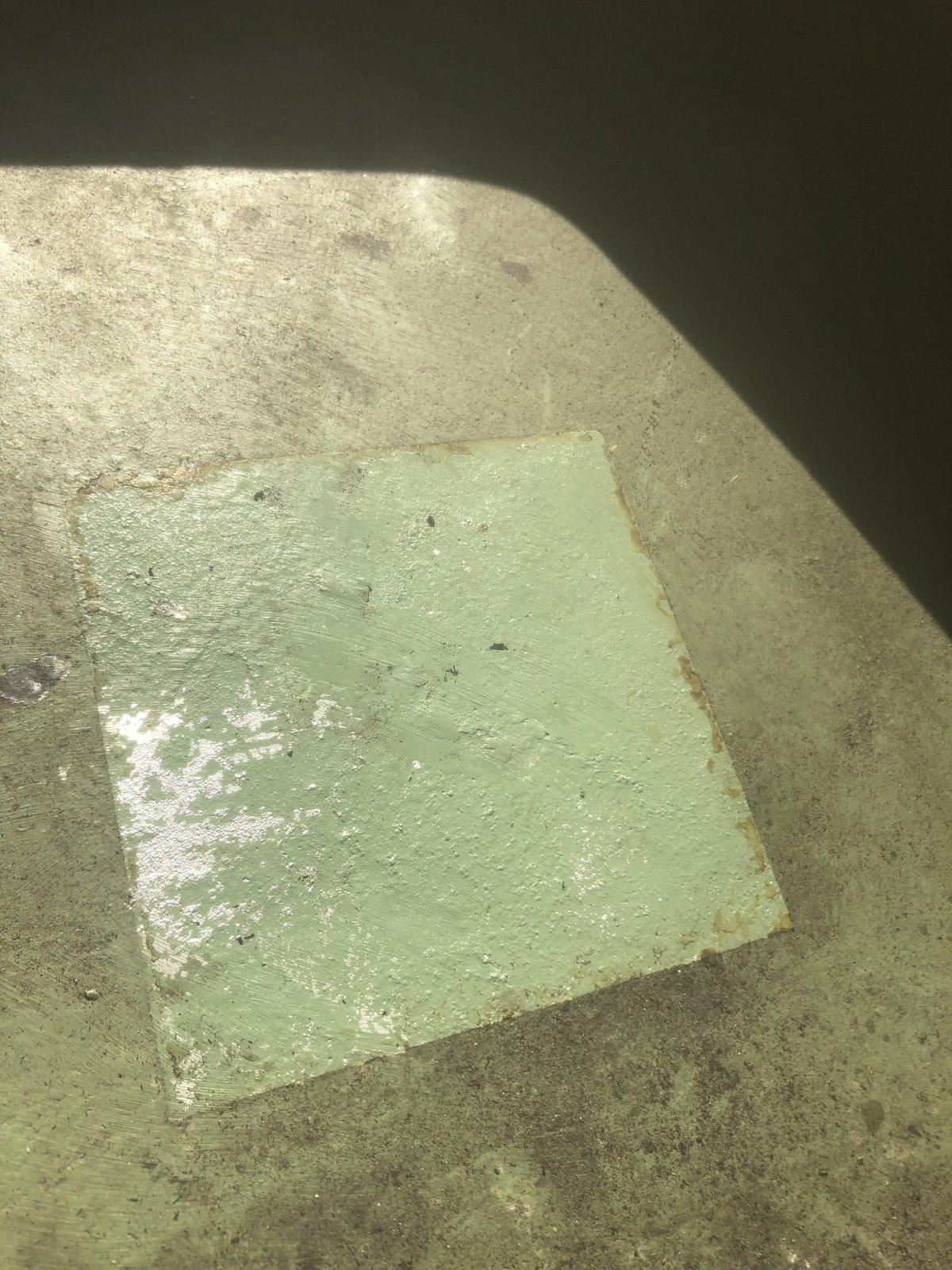

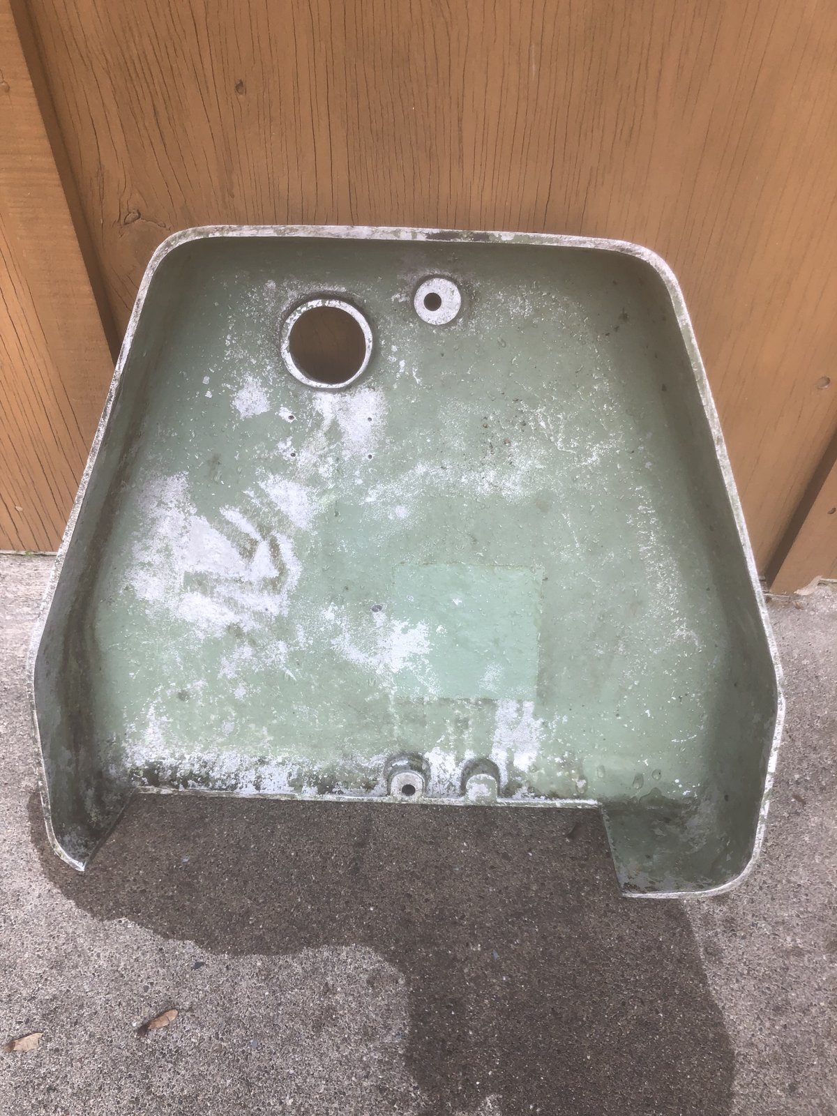

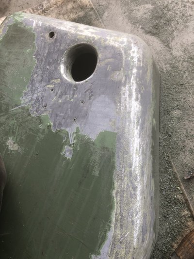

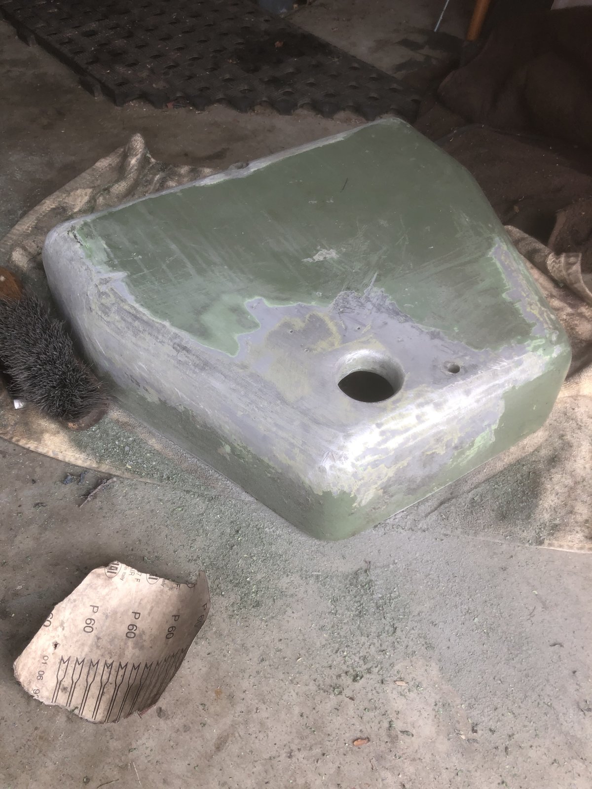

Don't use your equivalent of Aldi metal paint if you are going to do the inside of the suds tank. I looked in mine when I was putting my "new" feet on the Boxford yesterday and it had lifted with the suds.

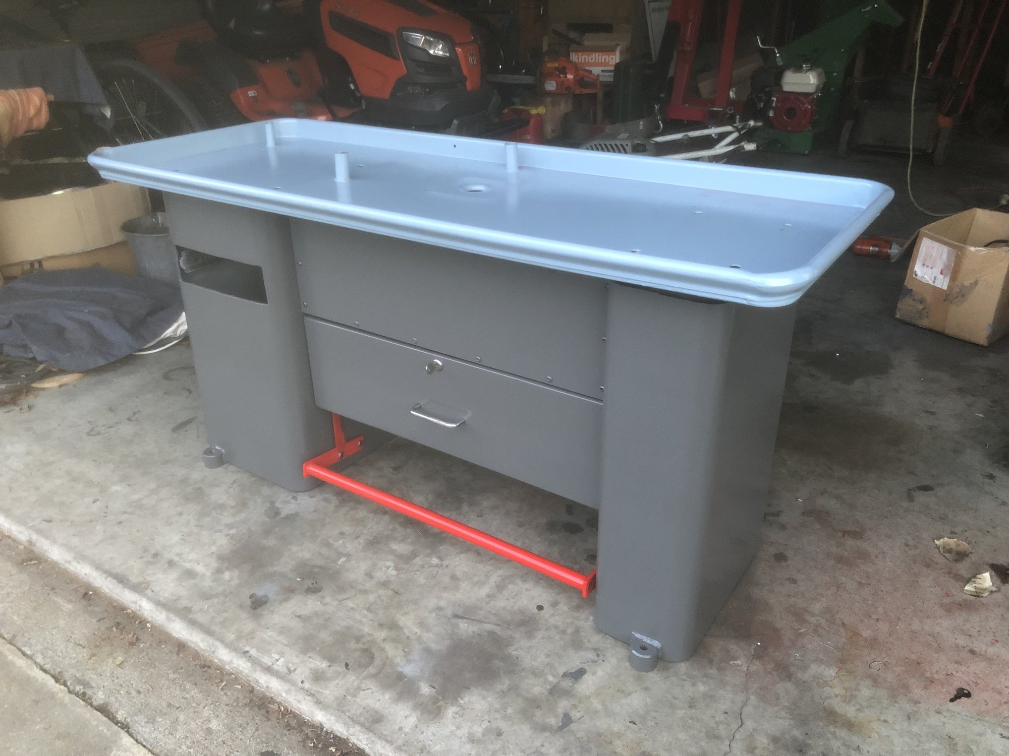

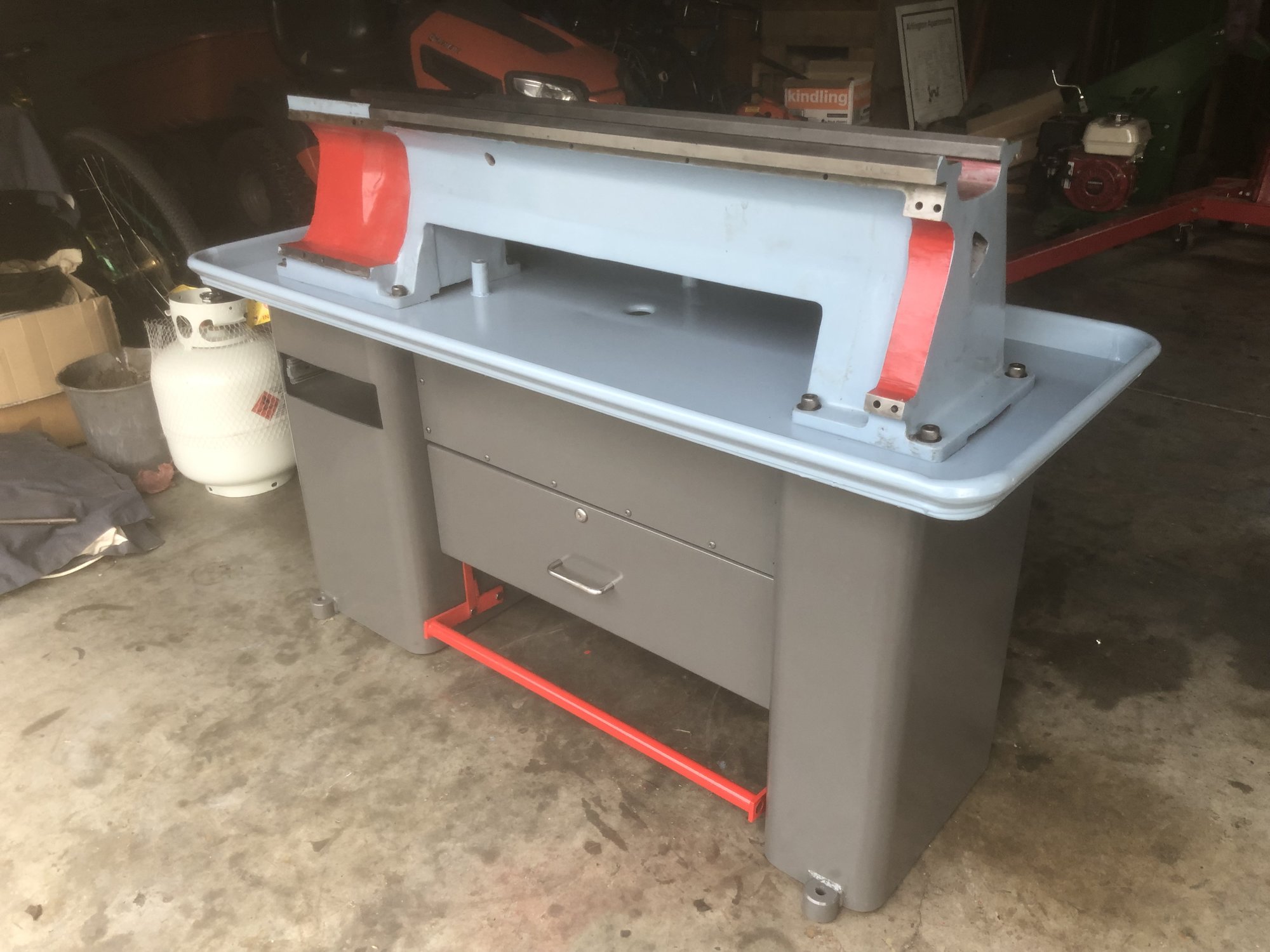

Much the same reason I left the inside of my lathe cabinet light grey.I painted the inside of my HLV cabinet white too. When I was dismantling it I couldn't see properly to work on the vari-speed mechanism even with a light in there so painting it white made it all the easier to re-build and for when I have to work on it again.

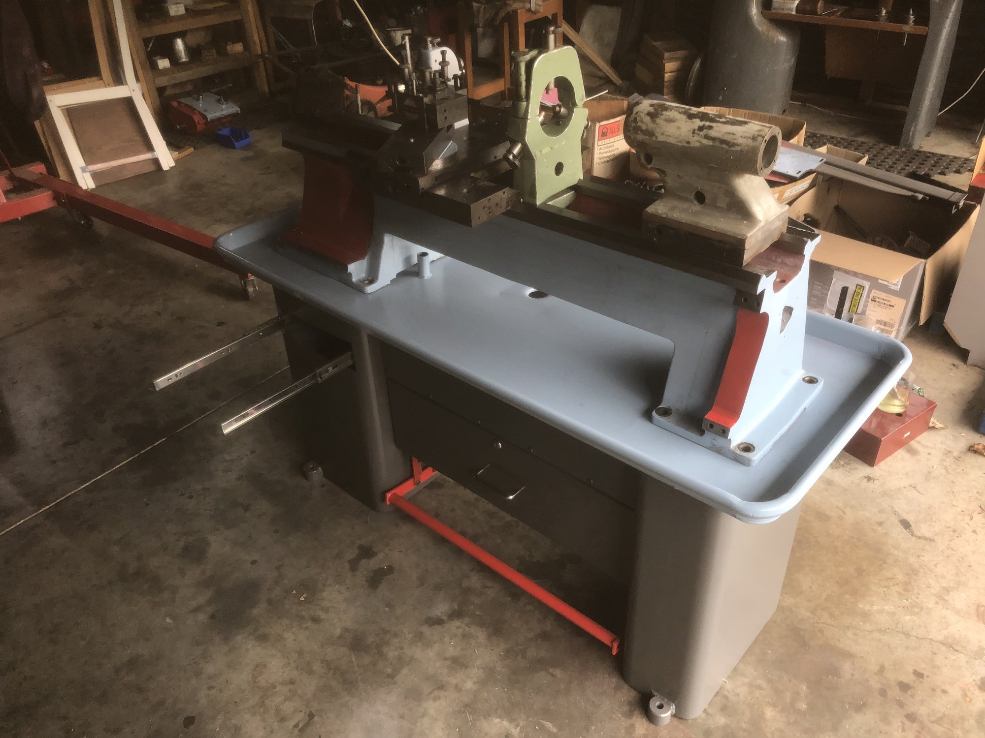

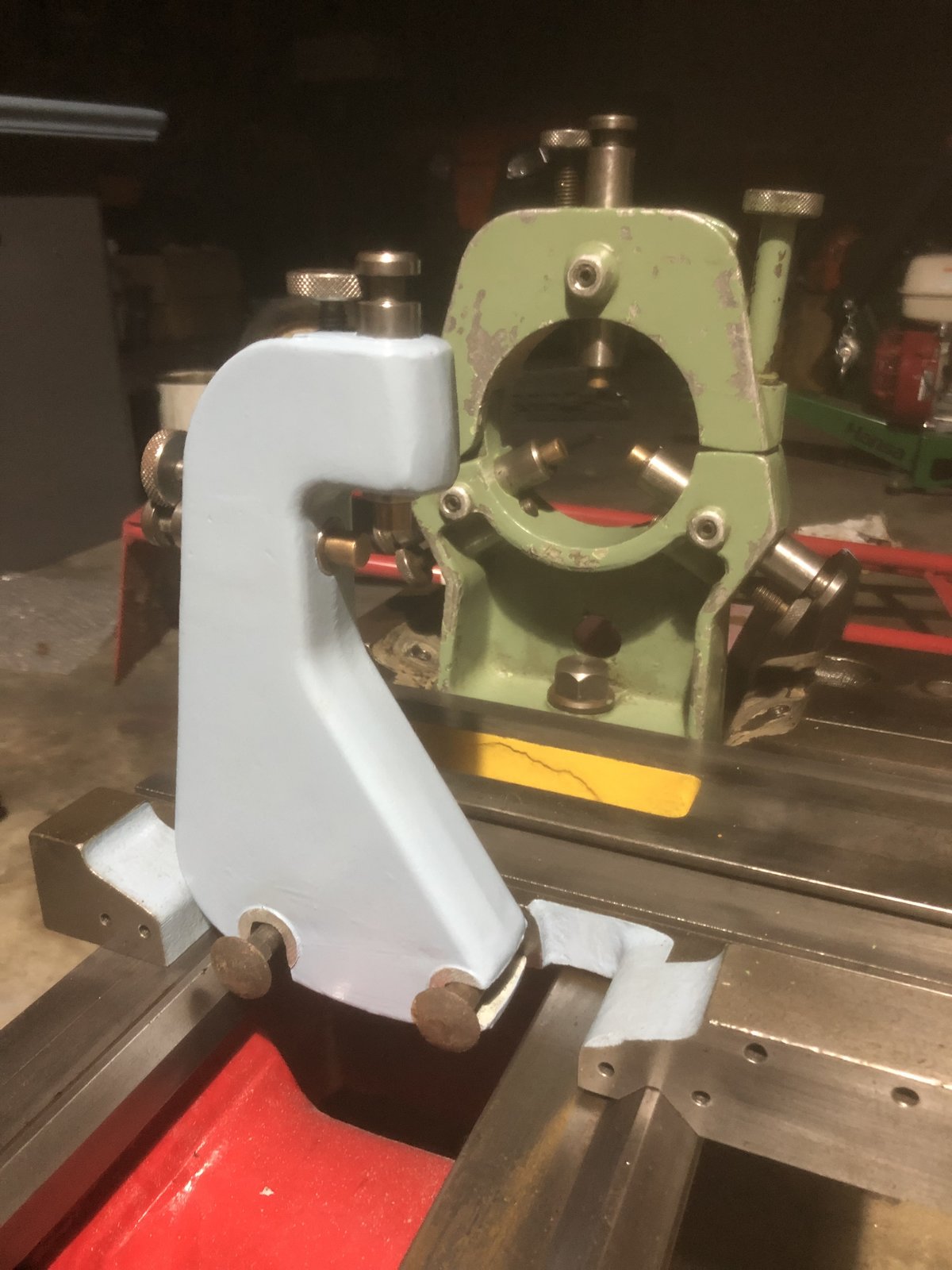

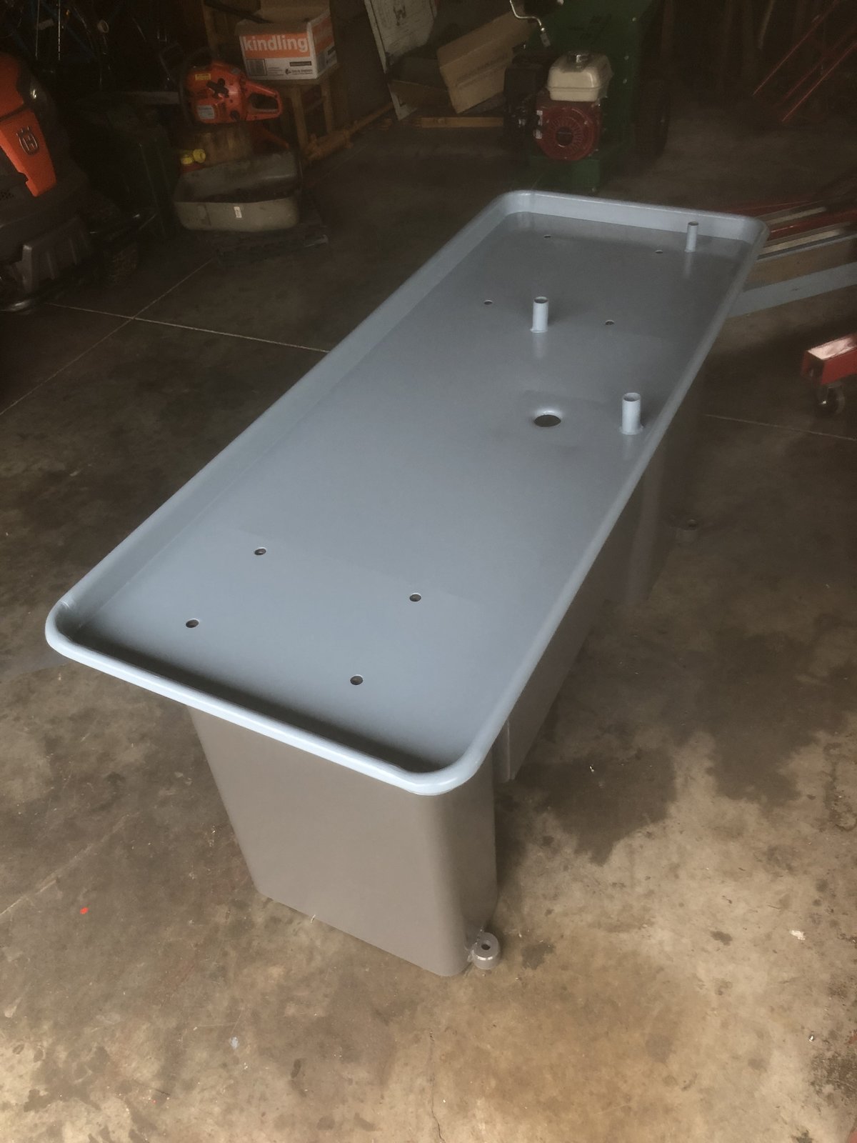

 I hate lifting the bed, it’s so heavy and swings easily. Got to raise it a little to get the cap screws in, then it’s finally one piece again.

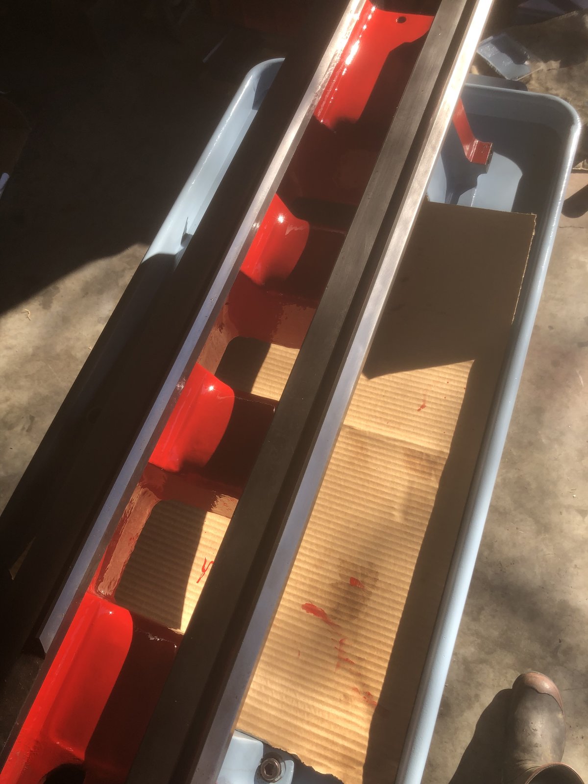

 An unexpectedly free and sunny afternoon has proved a perfect opportunity to put the final topcoat on between the bedways. I put some cardboard underneath to catch the drips. So far I’m dead pleased, looks brilliant.
a) then why are you wearing wellies?
b) drips? What drips?![]()
