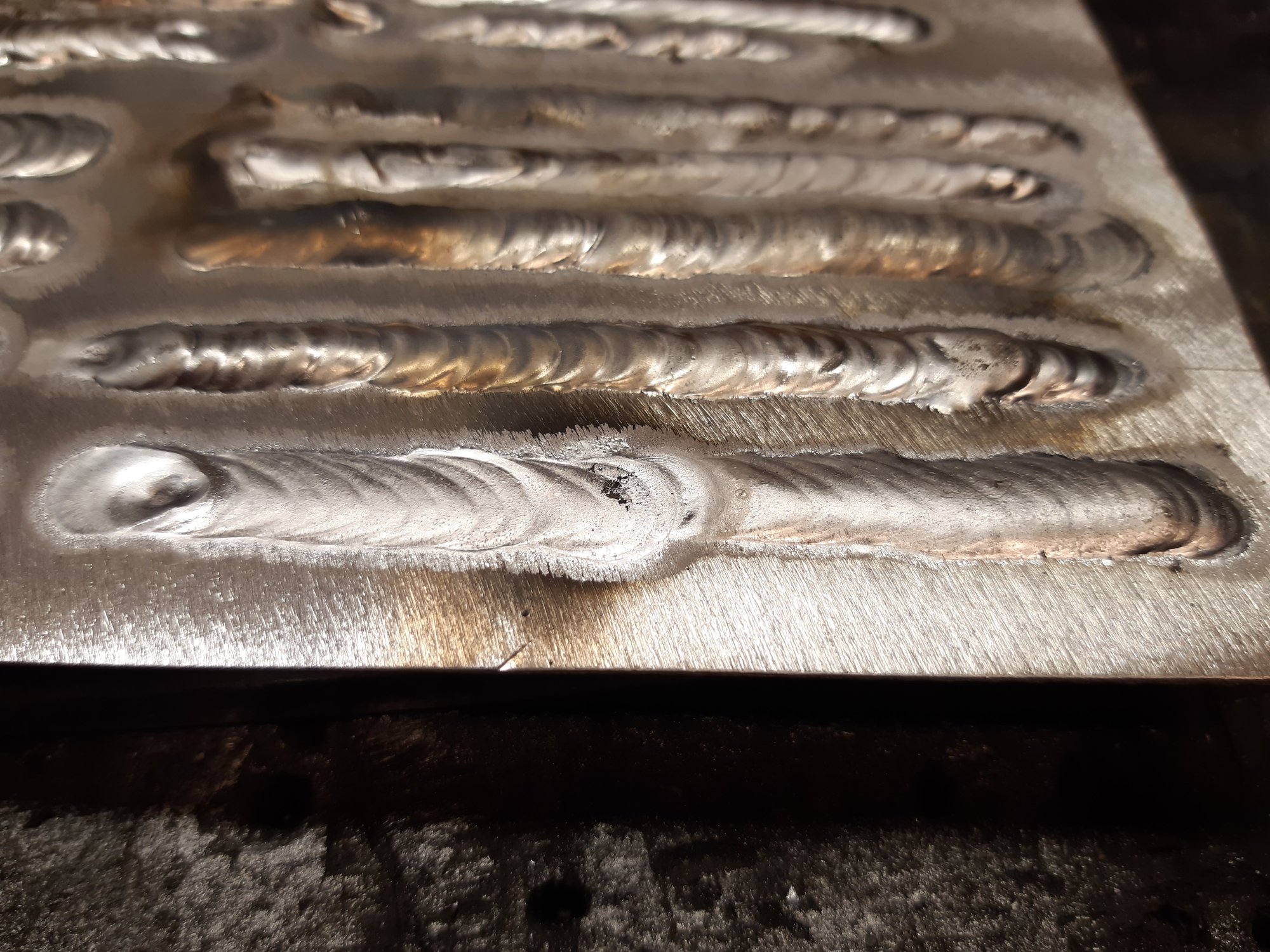

90A, 1.6 grey, 120hz and 30% balance.
Carefully read the "Aluminium TIG basics" thread from Richard, it's great !
Well I realize a little bit late my miswriting (as you may see I'm not englich native ...), I was'nt able to edit my post anymore.Where would he find that?...

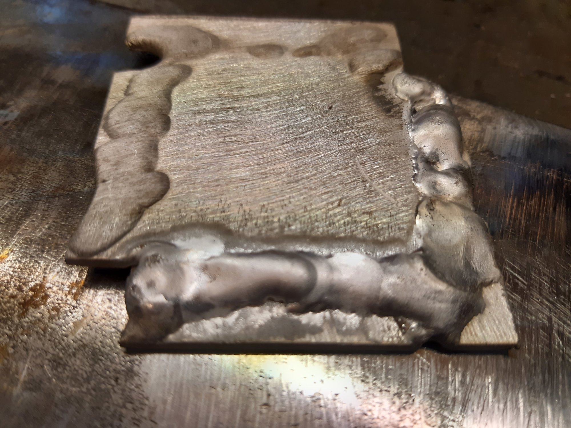

On a more serious note. Thicker Ally will make your life a bit easier but I agree with above, stick with the flat plate drill for now. Especially when learning Ally.
When your flat plate is 4 inches thick with perfect beads then move to joints.![]()

Taken from a previous post if you don't wish to read through a long drawn out post you can use this simple guide settings below
Alu
These are very rough settings that I know work they don't cover all case scenarios but they will get you results and you can fine tune as your experience grows.
- Set machine to ac
 - Set balance to 70% dc negative
 - Current work around 40amps per 1 Mm of material thickness
 - Frequency 80hz for butts, 120hz fillets and outside corners
 - Gas argon 100% @ 6-8lpm
 - Pre flow 1sec
 - Post flow 6 seconds for 1mm and add 1 second for every mm after
 - Arc length 1-2mm
 - Torch angle 10 degrees from vertical lean away from your direction of travel.
 - Tungsten white, blue, gold, grey, don't worry about which people prefer at this time.
