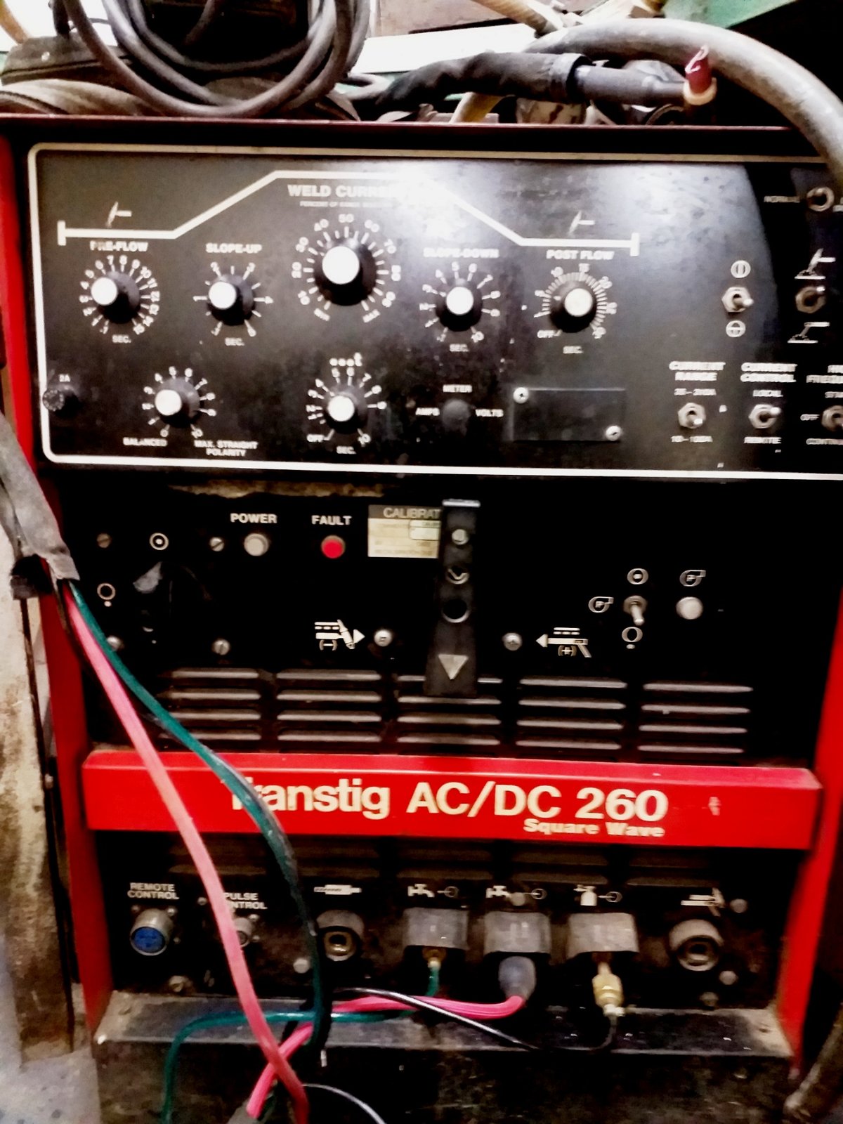

I have never used a TIG but have acquired an old Transtig 260 squarewave ac/dc tig, should be connected to power next week, I think / hope I have someone who will teach me the basics but in advance of that I need to get some rods, what should I get, size and grade, ideally I would like a mixed sample pack but I don't see any advertised, don't want a kilo of some size I will never use, for a start I have some alloy chequer plate to weld and an alloy wheel to repair (under supervision)

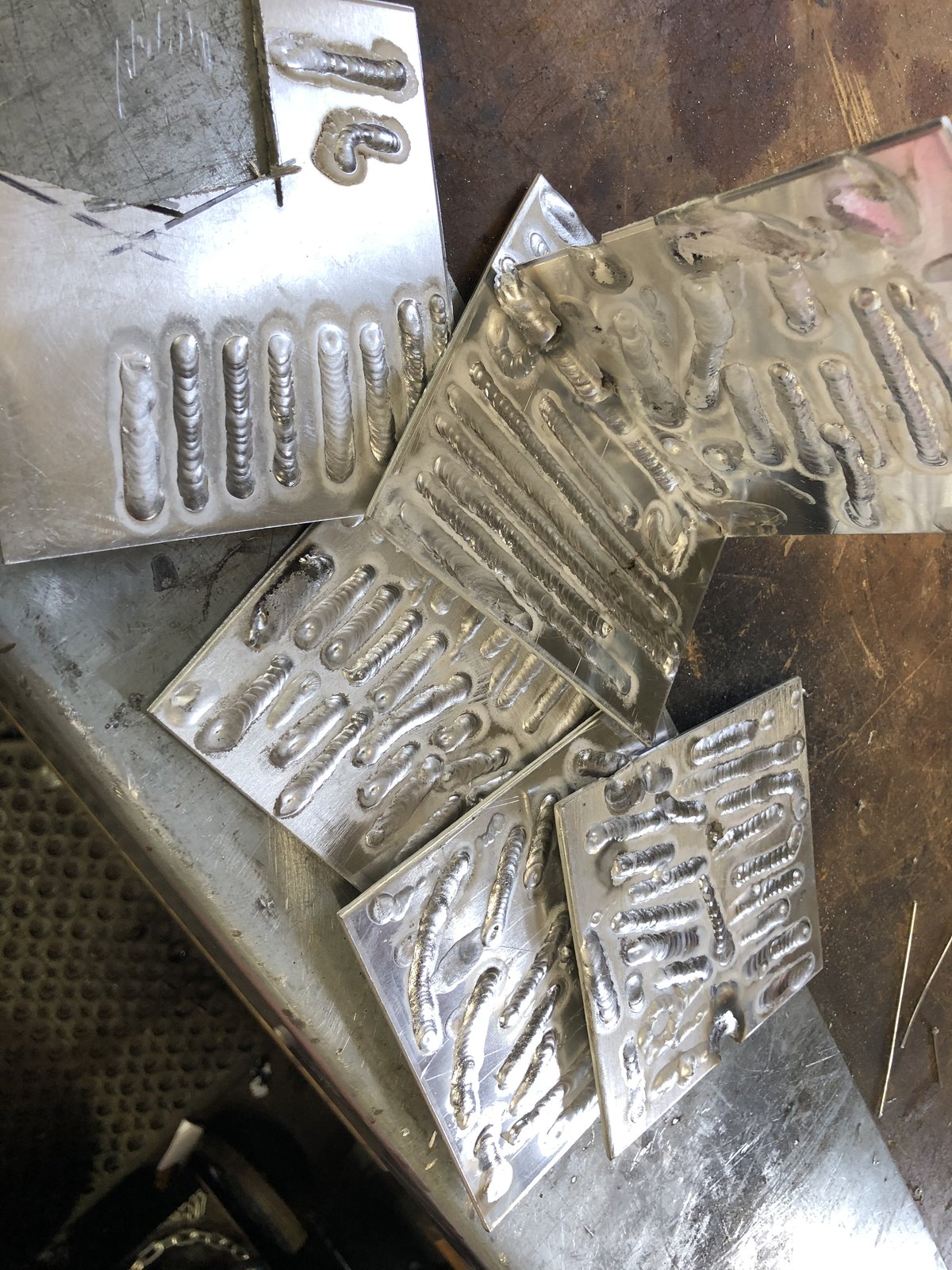

you should have fun with that!As a relative beginner on alu, looks good to me.View attachment 229598 View attachment 229597 View attachment 229596 View attachment 229596 View attachment 229597 View attachment 229598 Some ali practice the other day.

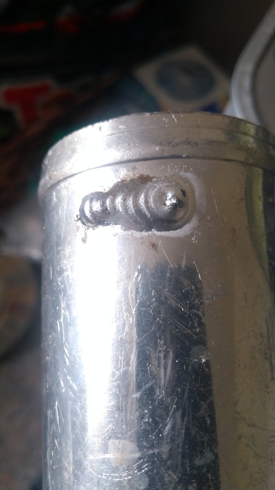

Several lines changing a few settings and some text message help from a friend.
Got it a bit better. I think what I was doing is going in hot as **Language** to get a pool fast and then traveled rather than building a pool and letting it clean maby?

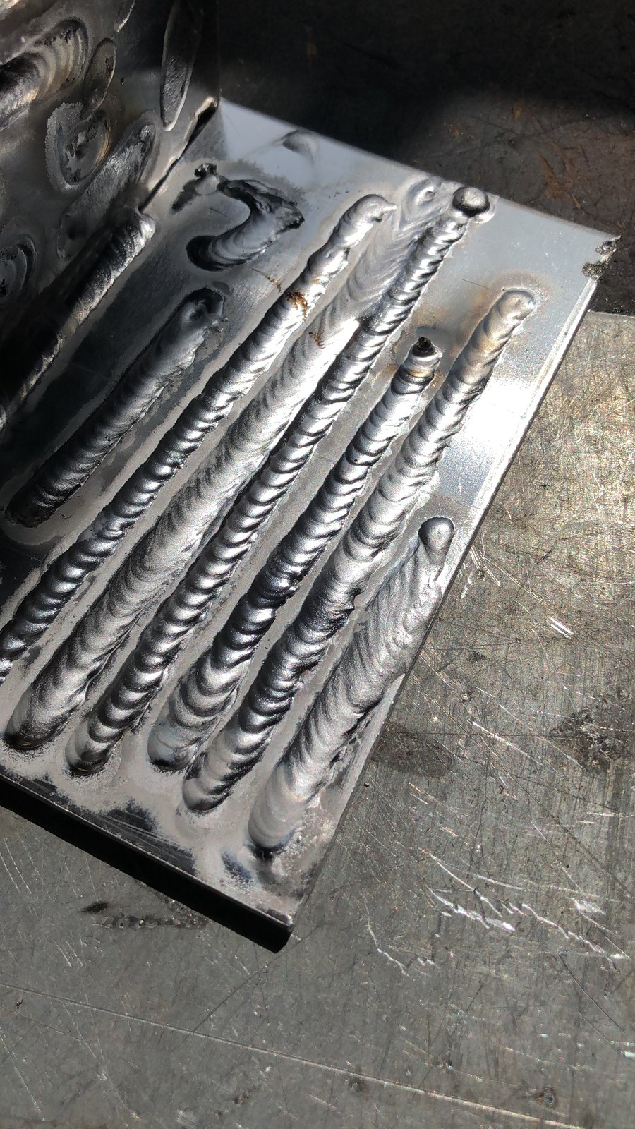

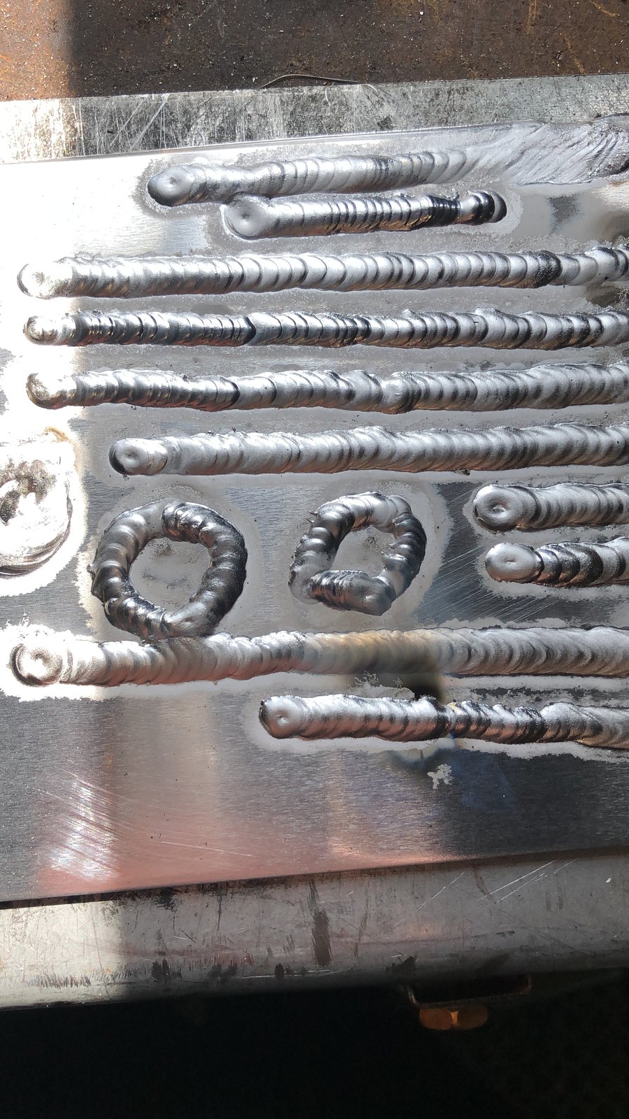

Getting there though I’m just running practice beads. When were a bit more relaxed on the lock down I’ll get some more gas and get more practice in around a set of headers that’s ment to be arriving
And me. there is some good runs in there and I see a bit of attention has been paid to some of those craters too. Nice.
id probably look at doing some common joints before attacking your headers.
Stand a few fillets up and see if you can make a nice job of them.

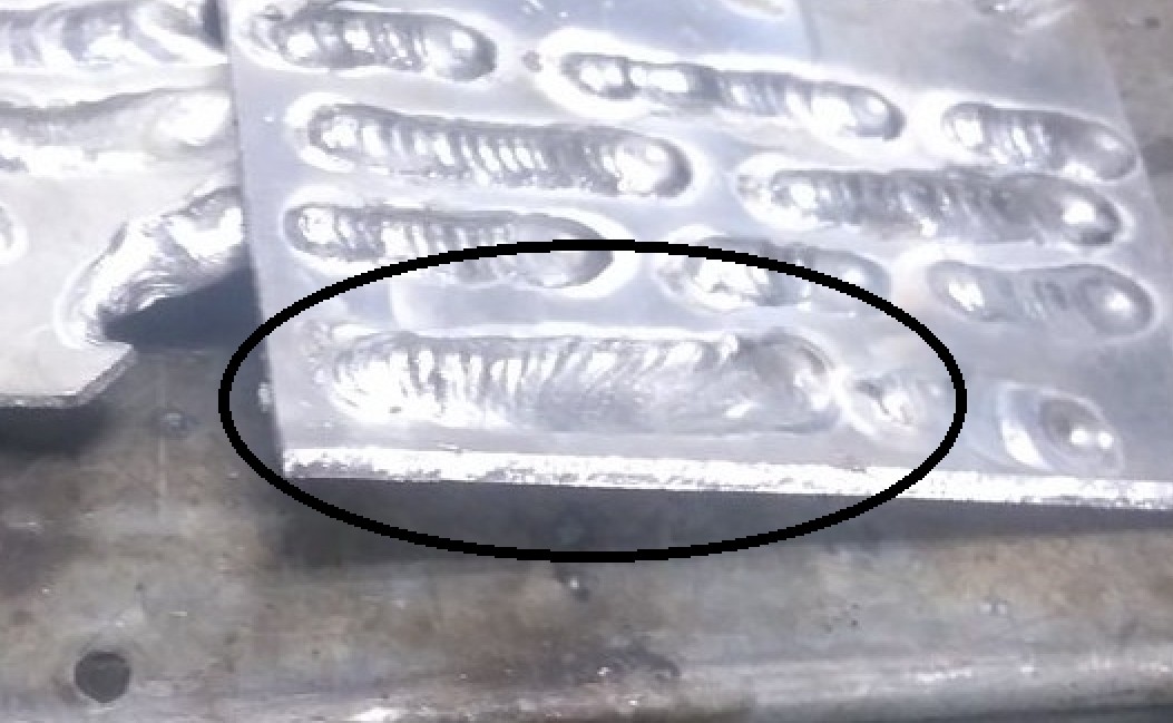

The pool widens and sinks.When welding as a beginner, how do you see your alu plate getting too hot ?
