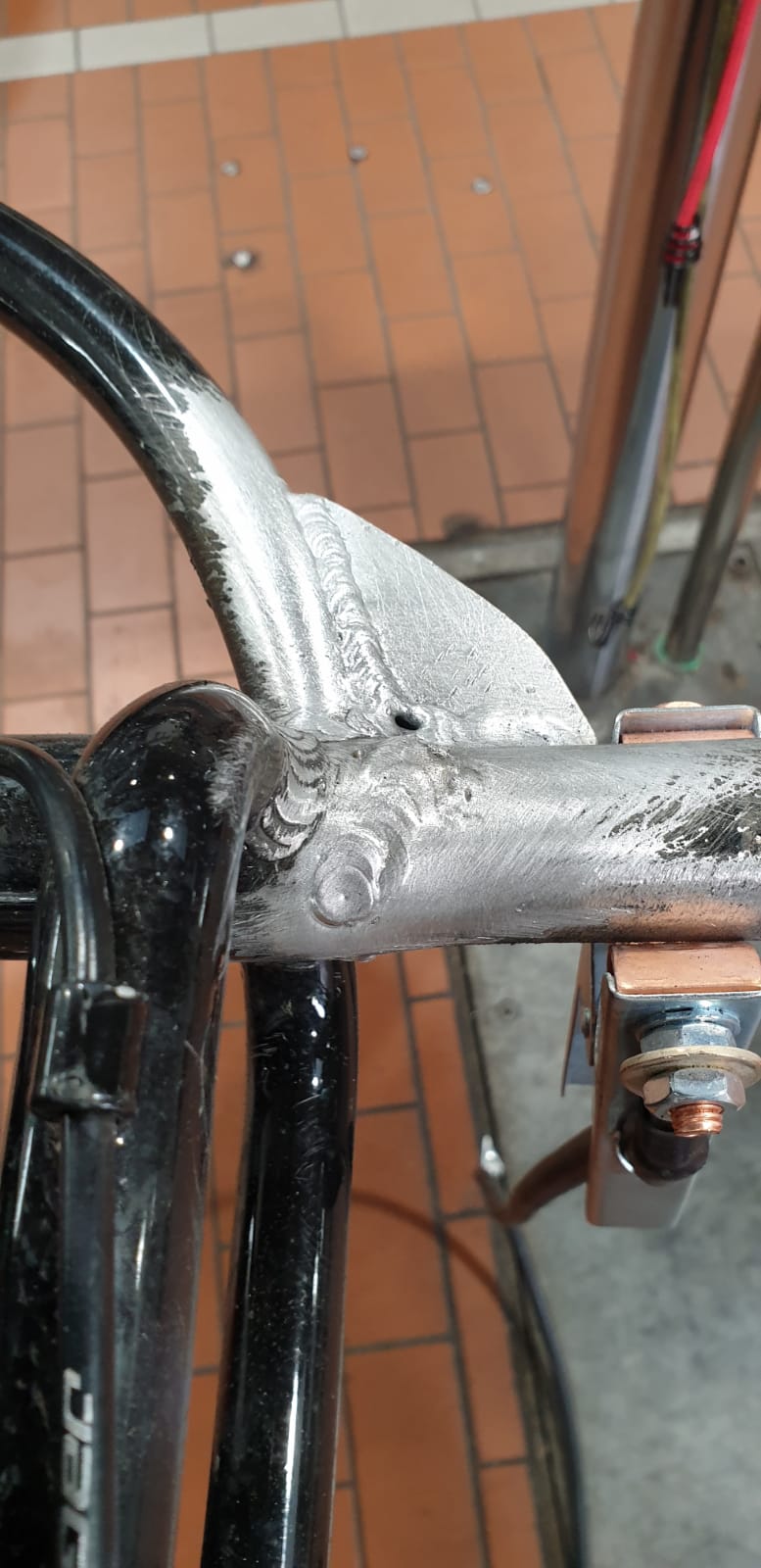

Need clearer picturePurchased recently Vector OW240 Plus welder, but having issues welding aluminium. The manufacturer has not provided proper manuals.
I read this topic, but not certain if those impulse settings can be applied to this device. Wondered if someone tried welding aluminium with such model and how the welder should be adjusted ?

Alu tig is welded in AC and
You require an AC DC tig machine to do this.
In all honesty if I could get away with no ball at all for every joint and situation I would. The balling is inevitable as we need cleaning and we need current. So I grind up my tungstens with various sized preps to allow various sized ball caps depending on how much current I want to apply. I won’t let the ball go out of control and keep it as small as possible. I don’t really want it there I’d rather weld with the point. It’s an old school thing. Some people are of the belief that in order to weld aluminium you need a big round ball on the electrode. Well it’s not that you need it but back then it was the norm with big soft wave transformers and pure tungstens you welded with domed electrodes. Modern inverters on advanced square waves with much harder tungstens allow you to slam the balance at 80-85% and still keep things clean. The ball will always be there but you can keep it much smaller and keep the tungsten more focused.I didn't notice this guide until recently, it's excellent.

On the subject of tungsten sharpening I used a tutorial from 6061.com that makes two different angles on the tip but Richards comment on sizing it up for different ball sizes is an interesting extension of that.
Would I presume you'd want a larger ball for larger current or is it about a particular arc shape to match a joint type?
I can weld with a 1.6 lanth tungsten at 150 amps and still keep that ball at under 1mm diameter with my balance control at 85%. The welds still come out clean.
