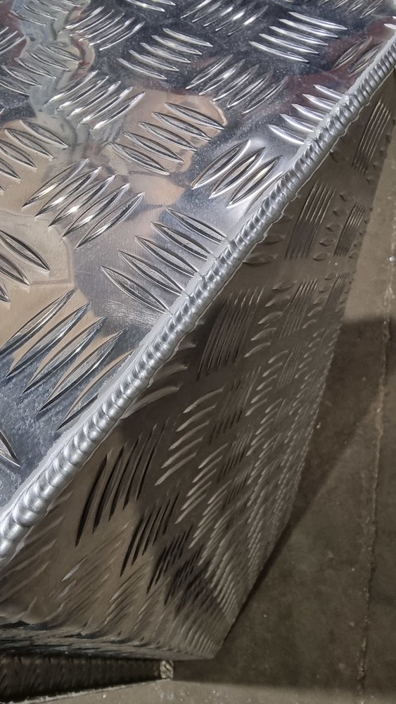

Show us a photo of your tungsten after a weld,
Looks more like a gas problem to me, not enough and or bad torch angle, it doesn't look like anodised to me, I haven’t come across anodised aluminium chequer plate, I will say this it quite often comes with an oily scum, and because of the Durbar it's difficult to rub with a rag that's got brake cleaner on it without leaving half the rag caught yo the plate

looking good thereBeen using 2.4 Zirc and E3, 25-30% balance and sitting at 120hz right now. Have been running these joints (3.2mm base/1.2mm leg) with 160A max, the advice has definitely helped ta!
