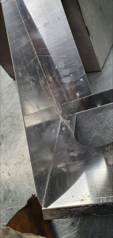

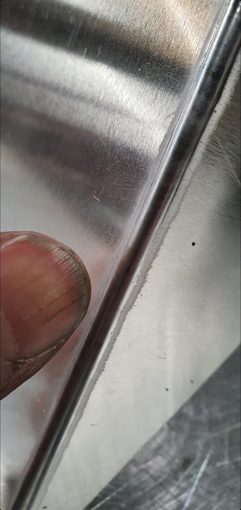

 I do these in work with no filler it depends on use adding filler slows the process down, material used to be 2mm but I made things harder for myself by agreeing to do it in 1.5, I'd prefer to have burn through but it is not wanted, any dirt on the edge that your welding and you end up with a hole these parts get powder coated,
 I do these in work with no filler it depends on use adding filler slows the process down, material used to be 2mm but I made things harder for myself by agreeing to do it in 1.5, I'd prefer to have burn through but it is not wanted, any dirt on the edge that your welding and you end up with a hole these parts get powder coated,I have seen that on youtube videos. No cracking apparent. The ali is 6mm x 60mm angle of unknown properties. Probably was part of a carport or similar. For this job it was good enough. No issues. The angle was cut 45 at deg. So the corners were knife edges which fused back to form a nice bead.You can't weld ali without filler, it will crack.
