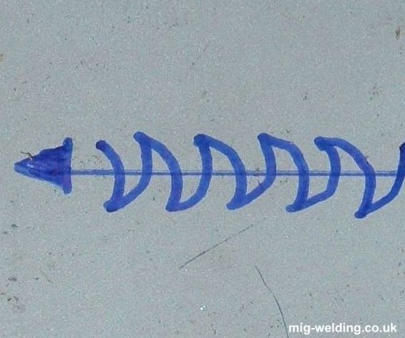

Torch Movement
Various torch movements are used in MIG welding. The one I tend to use most on metal thinner than 2mm is a curved zig-zag motion illustrated by the photo. It lays a little weld on the edge of each sheet, then gets out of there before the sheet has a chance to blow through. Next time the arc gets to the sheet it is a little thicker and less prone to blowing through. This tends to result in a reasonably flat, neat looking weld.
Other torch movements include a ziz-zag with no curves (useful for thicker metal), and welding in a straight line without going from side to side at all (actually that one is useful for all thicknesses of metal but takes a whole lot of practice to ensure the heat is evenly distributed into both sheets of metal).
Curved zigzag welding motion

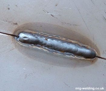

Tack welding
The heat in welding will distort metal. If you started welding with two pieces of metal perfectly aligned, then after an inch of welding one of the sheets would have moved and you'd end up trying to weld across a gap. Tack welds (shown in the photo) stitch the two sheets together to prevent movement.
For car bodywork the tack welds would be spaced at an inch apart.
When welding a seam don't start the weld on a tack as it will break. Start between the tacks, keep welding over the tacks, and finish the weld between tacks if possible.
