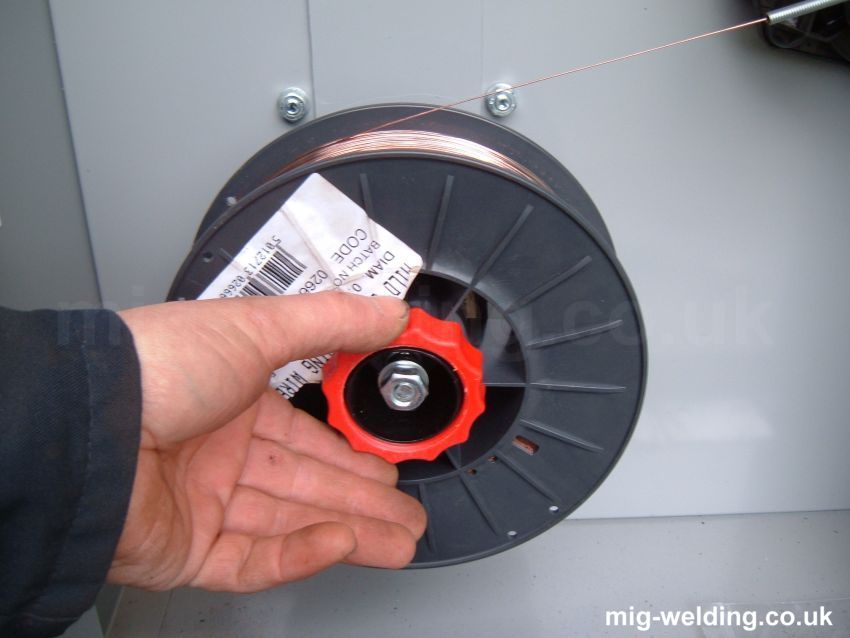

The wire reel mounting normally includes a spring tensioner. This tensioner should be initially tightened to the point where the reel of wire doesn't unravel under it's own spring tension.

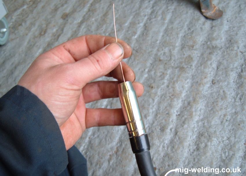

The first 3 inches of wire should be as straight as possible to reduce the chance of damage to the liner or snagging as the wire is fed through. Sharp wire cutters can be used for trimming.
Letting go of the end of the wire would cause it to unravel and tangle. (In the photo the hand normally used to hold the wire when cutting is being used to operate the camera.)
Straightening and snipping wire

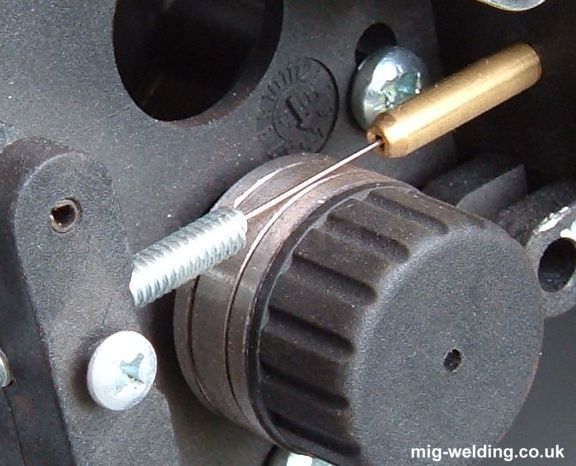

The wire is inserted through the guide tube and over the roller. On the torch side of the welder the small hole of the end of the wire liner should be visible. The end of the wire can be aligned with that hole using a small screwdriver or the piece of wire that was removed at the start.
The wire can then be pushed into the liner manually for a few inches, and should feed easily and without any force. If force is required it is likely that the wire has missed the liner.

Setting the reel tensioner
Finally check the tension on the wire reel. The tensioner on the reel is there to stop the wire becoming loose and tangled, but the tension should be as light as possible to make life easy for the wire feed mechanism.
Set your wire speed to the maximum you are likely to use, and press the trigger on the torch. The wire reel should stop without unraveling when you lift off the trigger.
Tensioning MIG wire reel

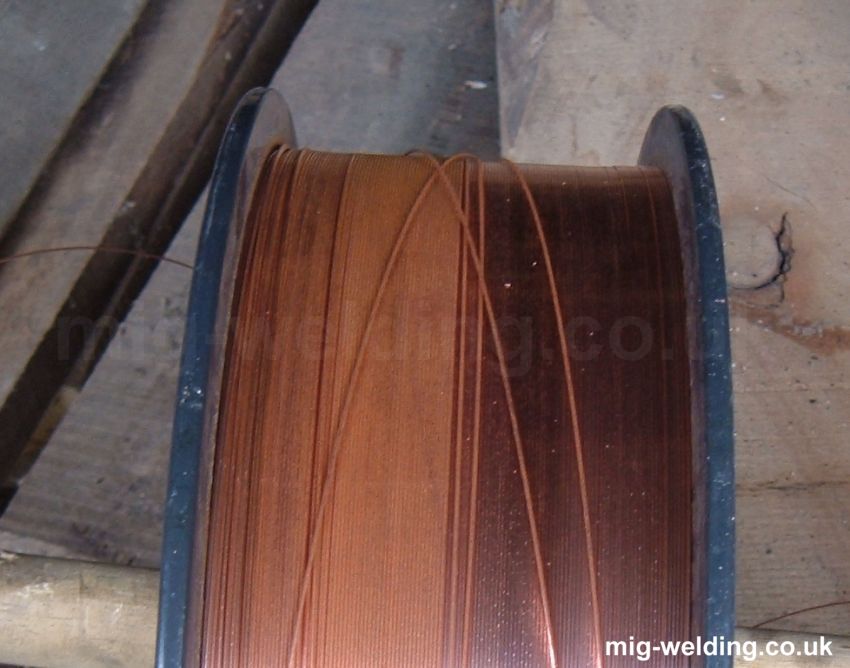

Wire feed problems are commonly caused by rusty welding wire. The rust acts as a lubricant on the feed rollers causing slip, and as an abrasive on the wire liner which increases resistance.
Wire can quickly go rusty when left unused inside a welder. Ideally the wire should be removed and stored indoors when the welder is not in use. This wire in the photo was reusable after the top couple of layers of wire had been removed. Liners damaged by rusty wire can be replaced fairly cheaply.
