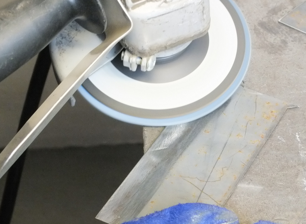

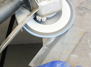

Metal needs to be completely clean of rust or paint in the area where you want to weld. Any rust or paint will act as an electrical insulator which isn't good when you are are using an electric welder. An area needs to be cleaned for the earth clamp too.
Light use of a flap disc on an angle grinder will quickly remove surface rust and paint without thinning the metal. For more inaccessible areas an air grinder or dremmel can be effective.

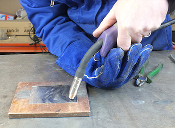

MIG can be used one handed but nobody does that because it can be used two handed as well. Throw away the hand held mask that came with the welder and buy a full face helmet, preferably an auto-darkenining helmet. Welding control will be further improved if you can rest an arm against something solid.
In the photo one hand is resting on the bench and steadying the front of the torch while the other hand (the right hand for right handed welders) holds the handle and operates the trigger.
Both hands ought to be wearing gloves to protect from UV light. No arcs were struck in the photo.
