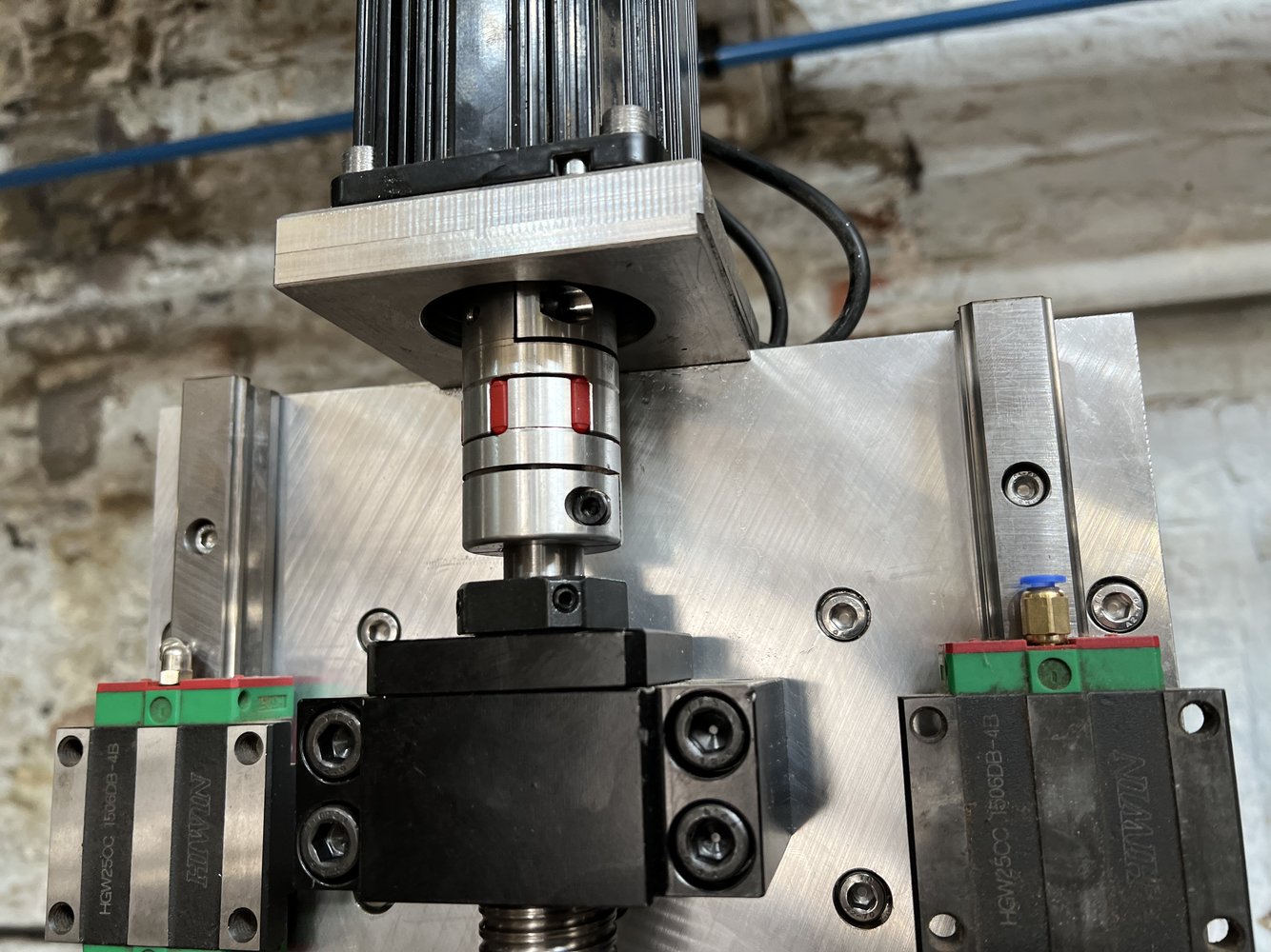

Only used them on routers in the past so it remains to be seen.How are you finding these couplings? I put similar on my lathes turret but found there was too much compression in them even with the hardest inserts I could get. Then again the turret is a heavy lump to swing round 300mm dia by 55mm thick then all the VDI holders and tools, must come in around about 50kg plus.
