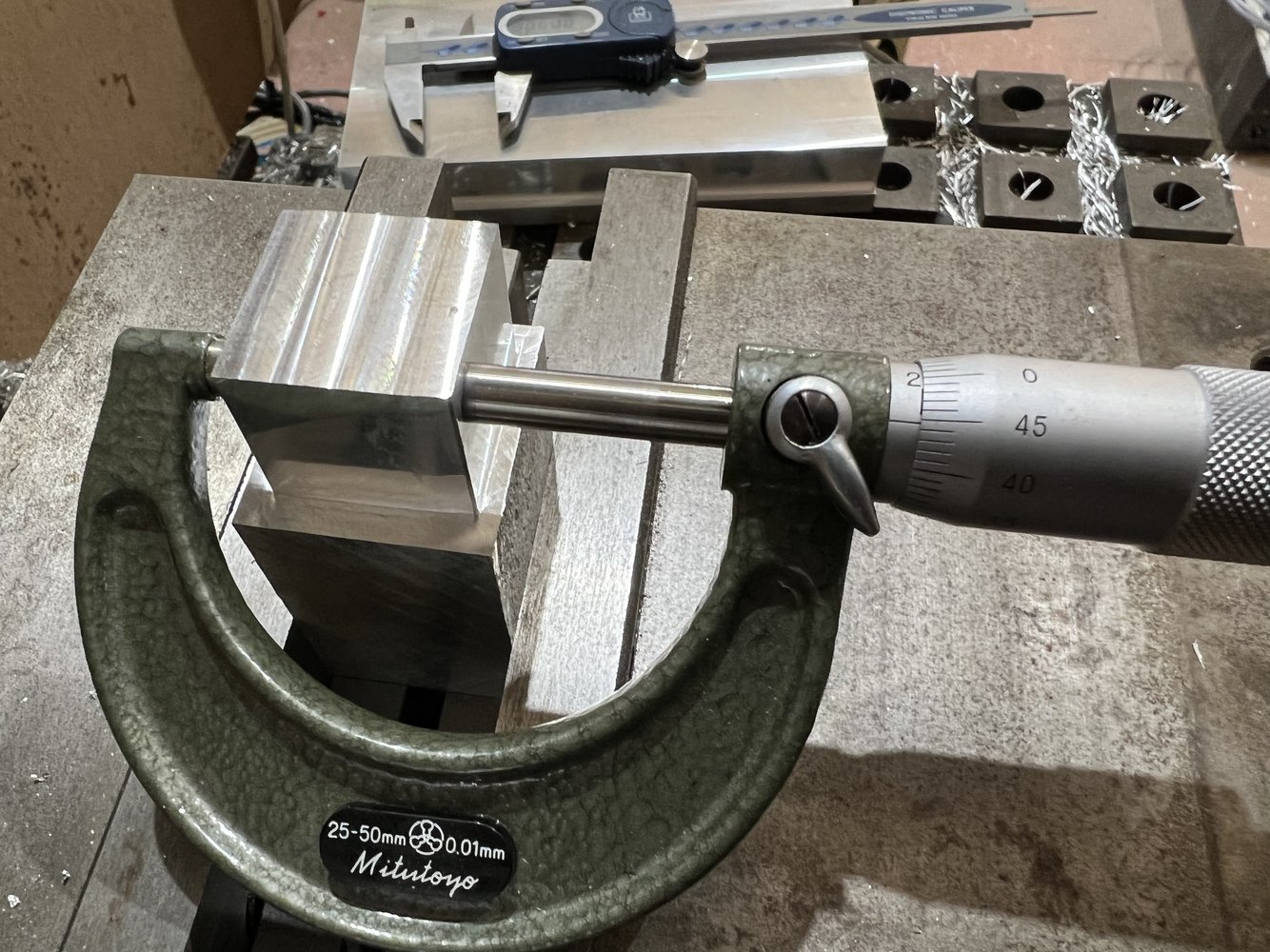

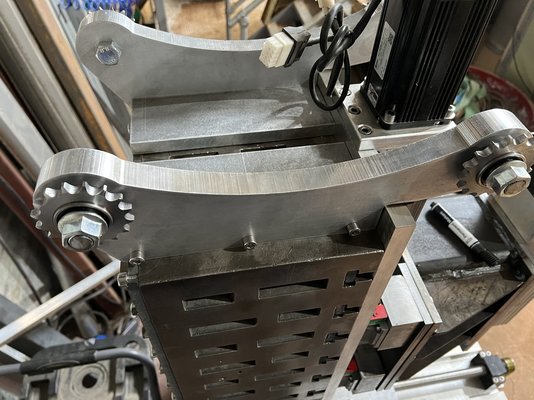

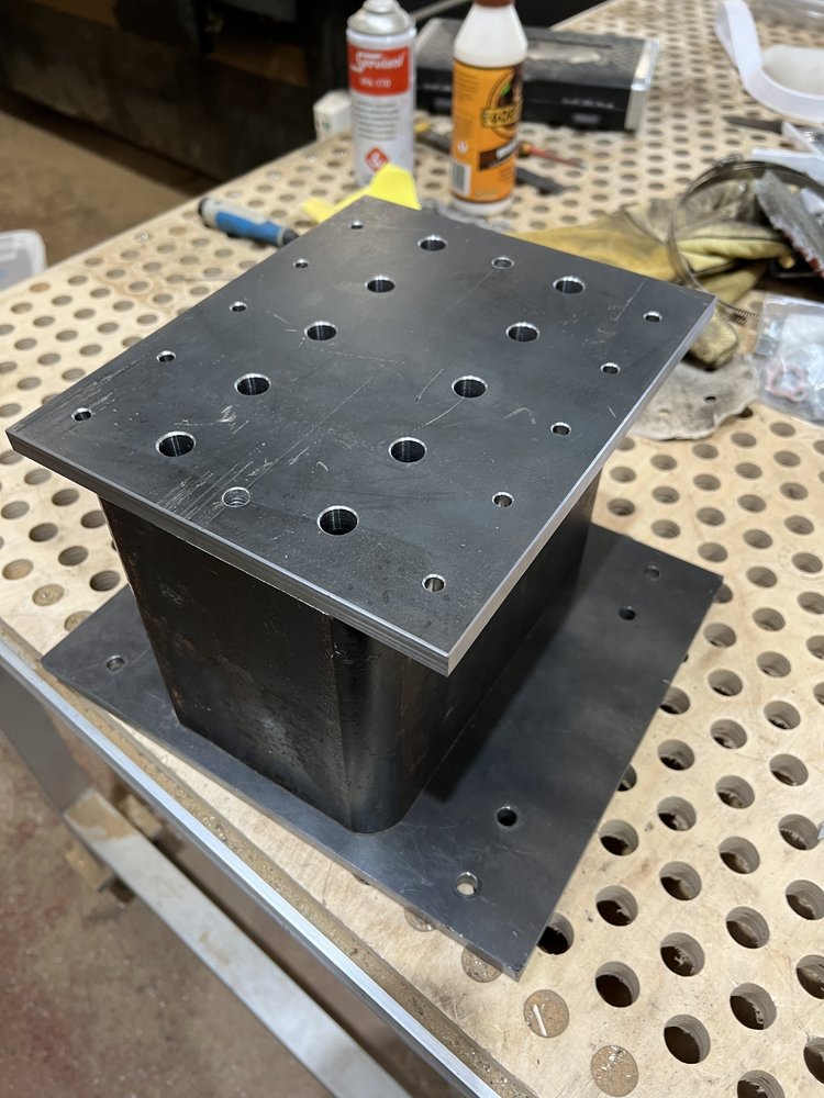

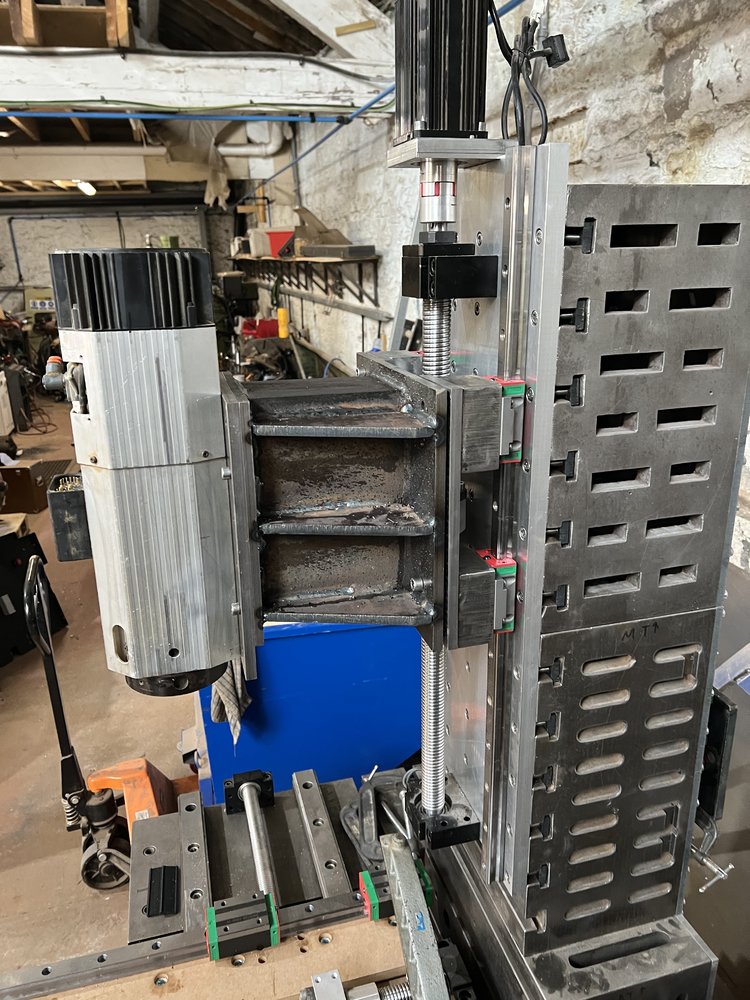

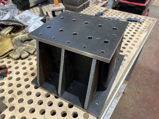

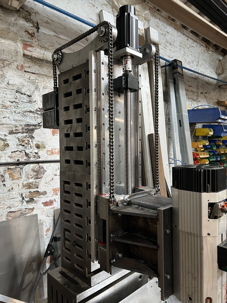

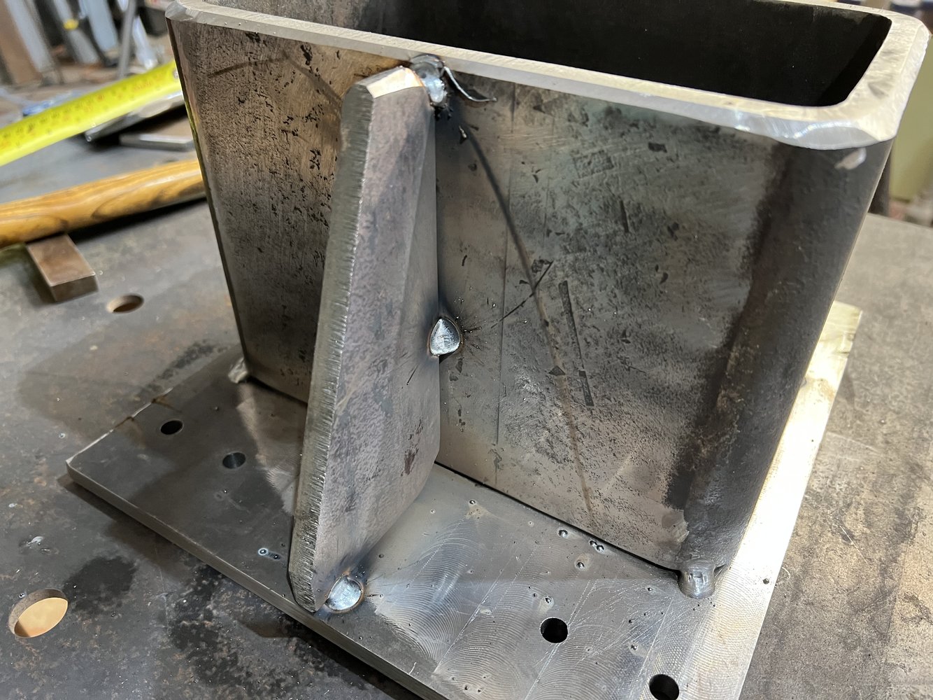

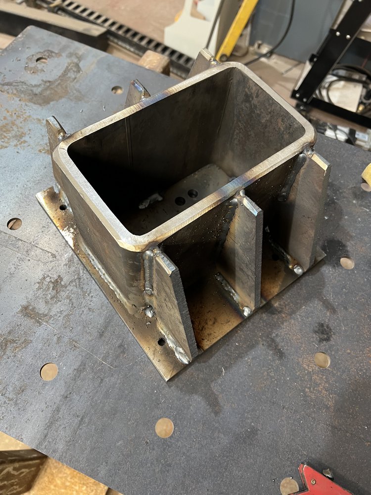

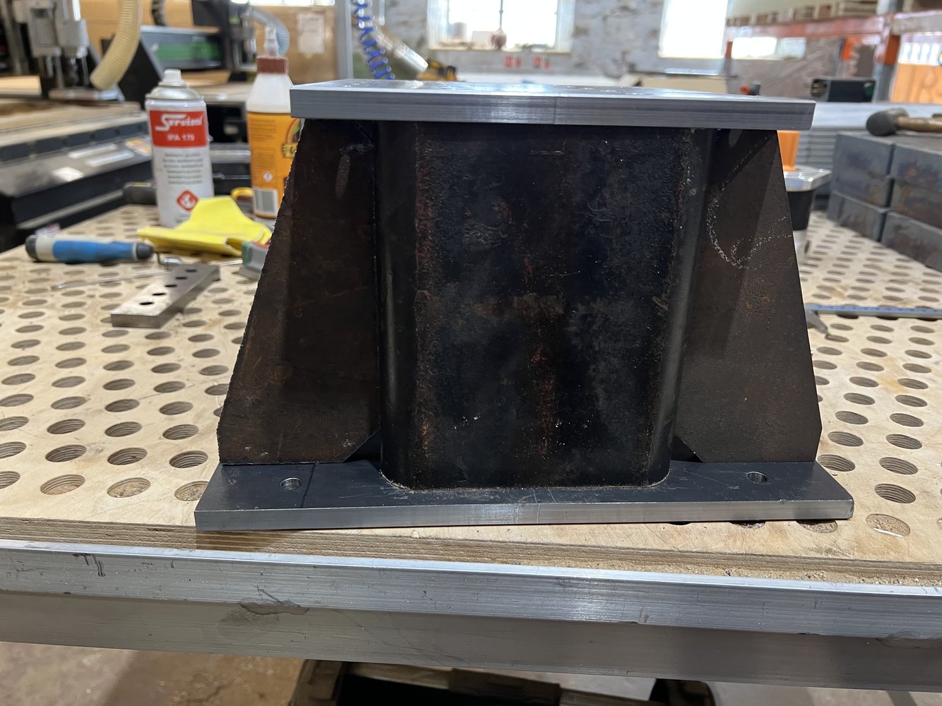

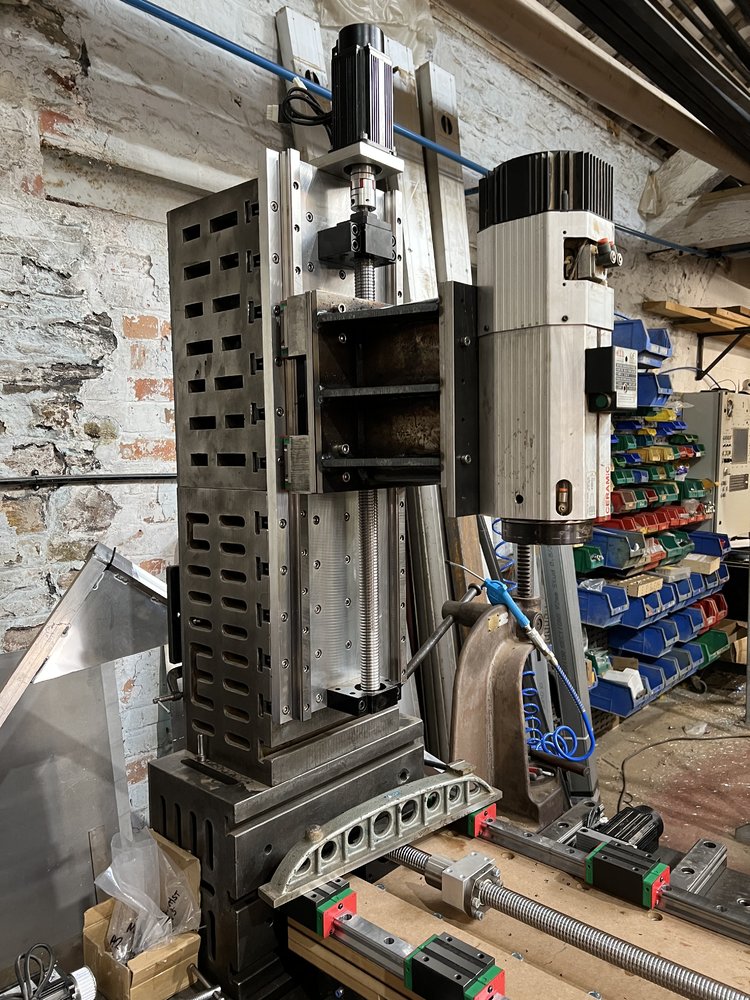

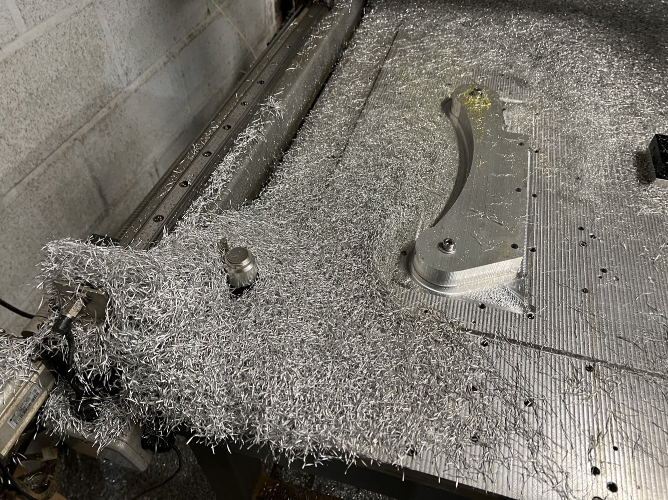

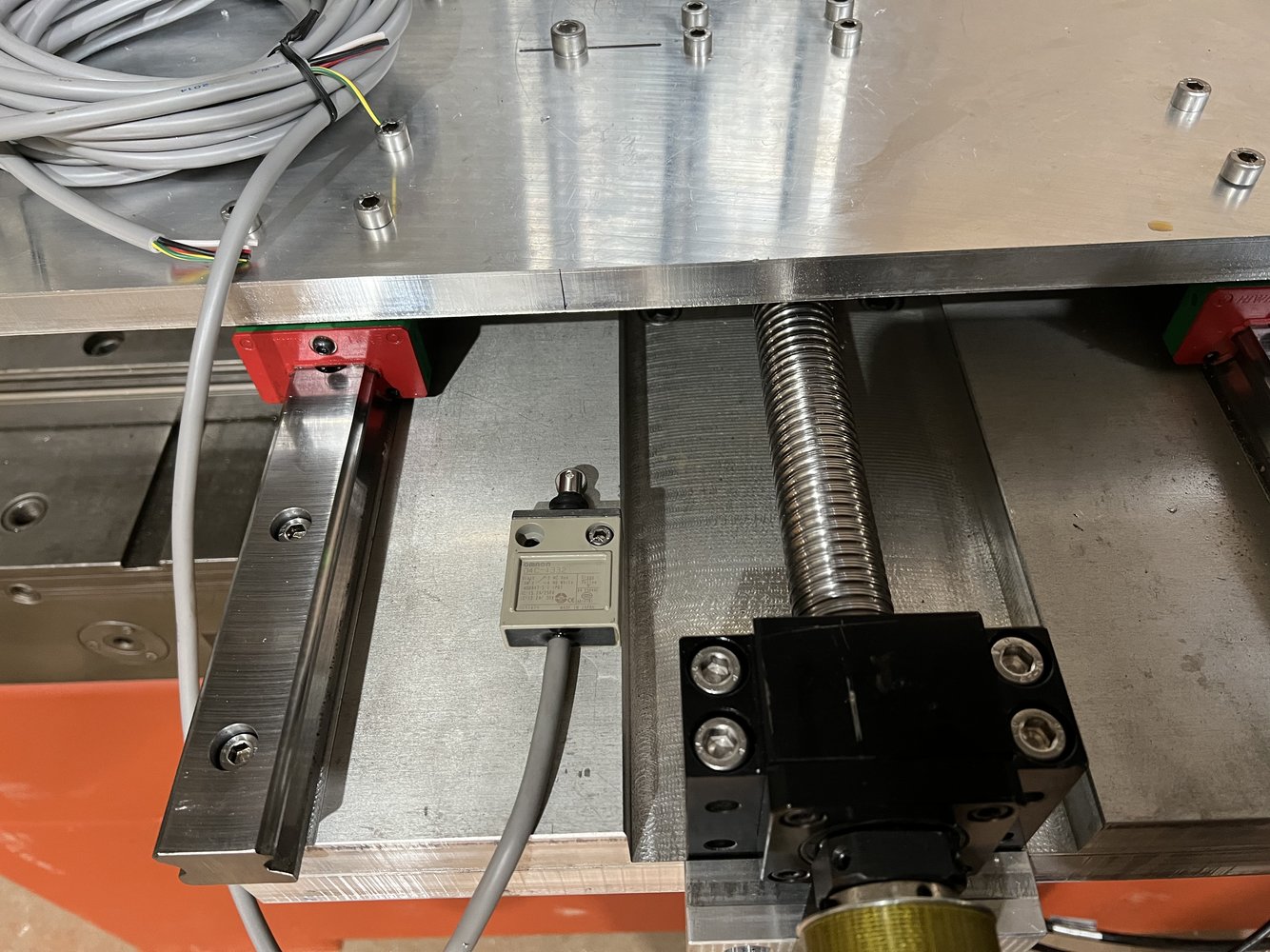

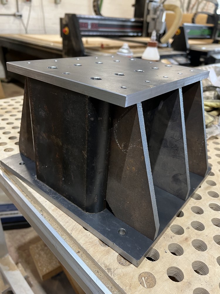

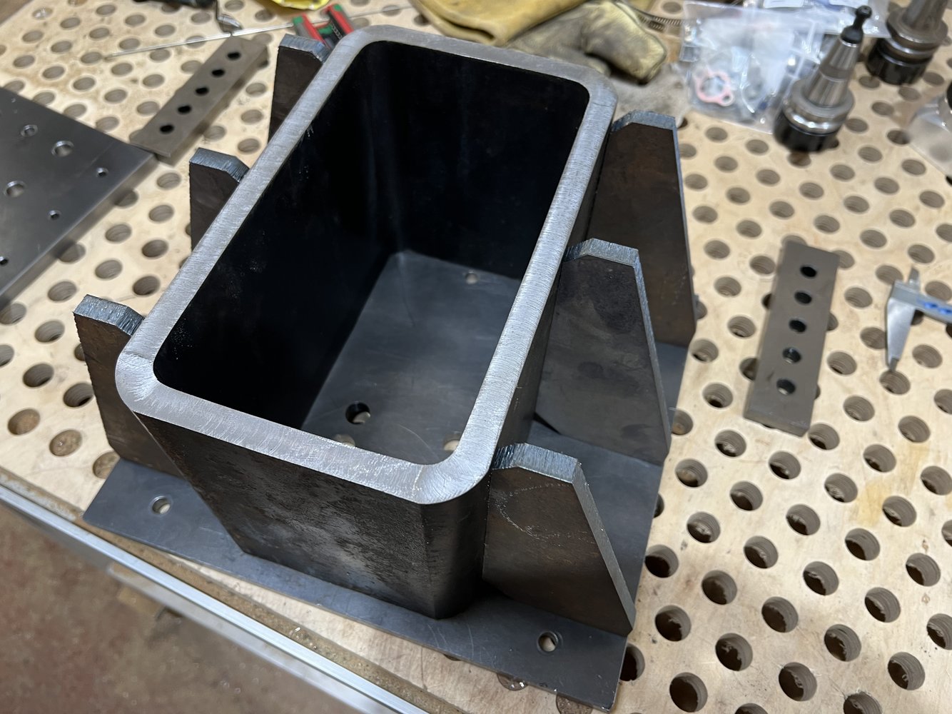

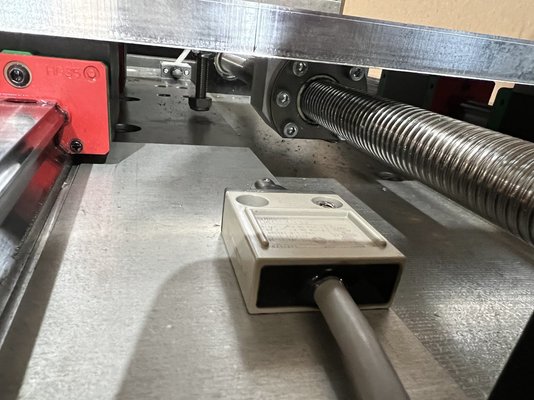

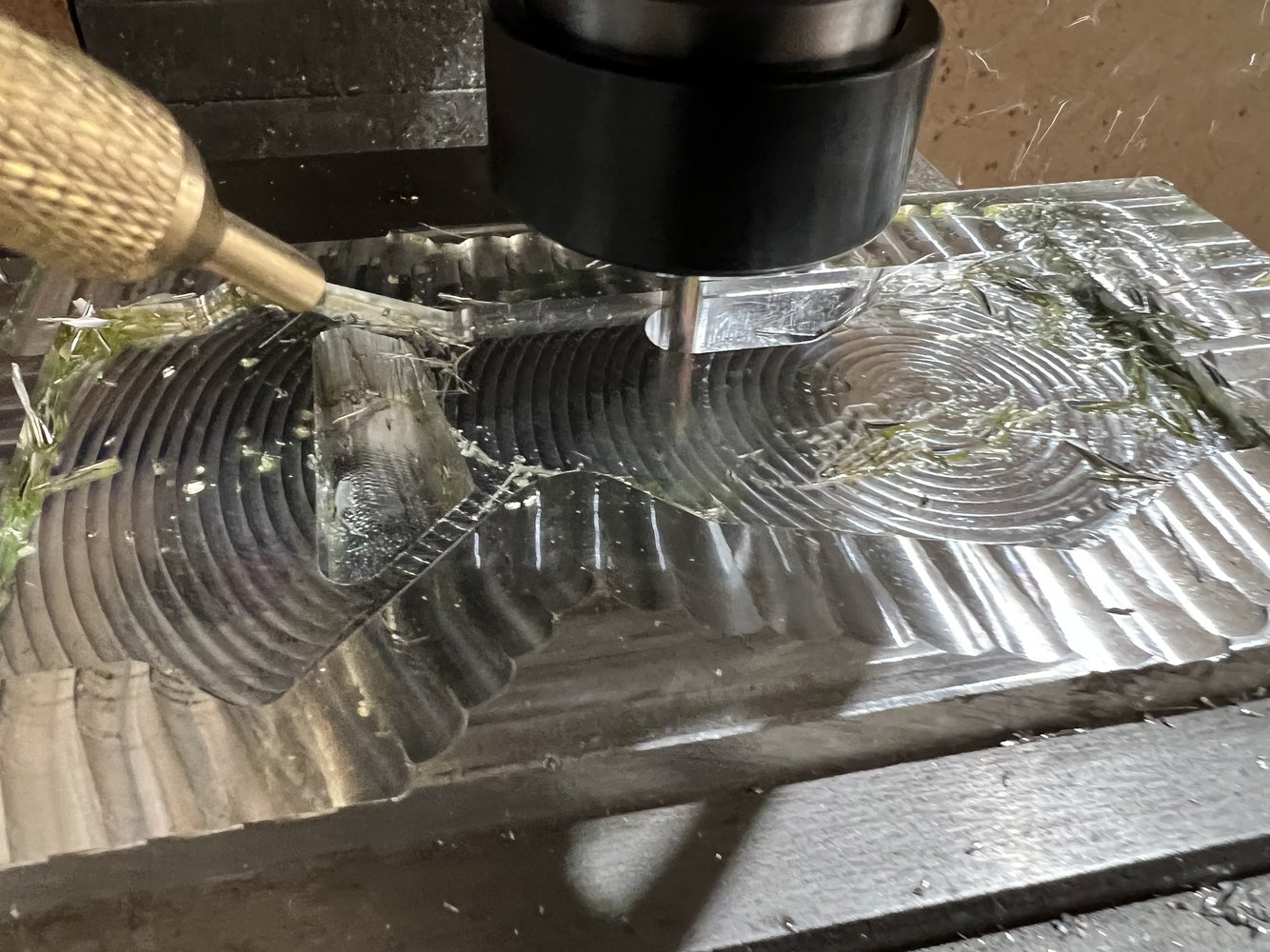

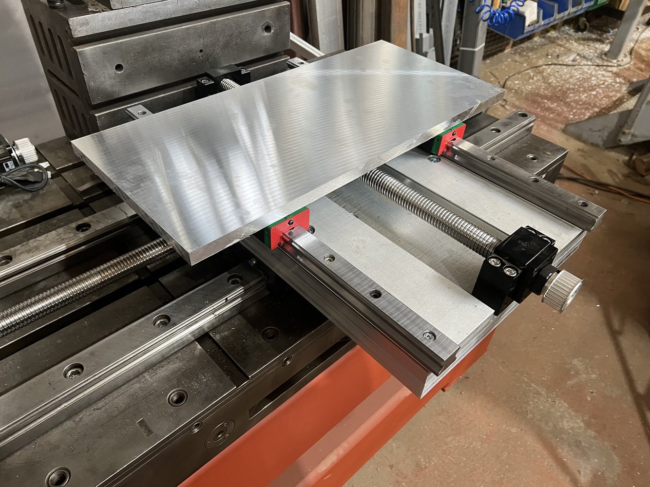

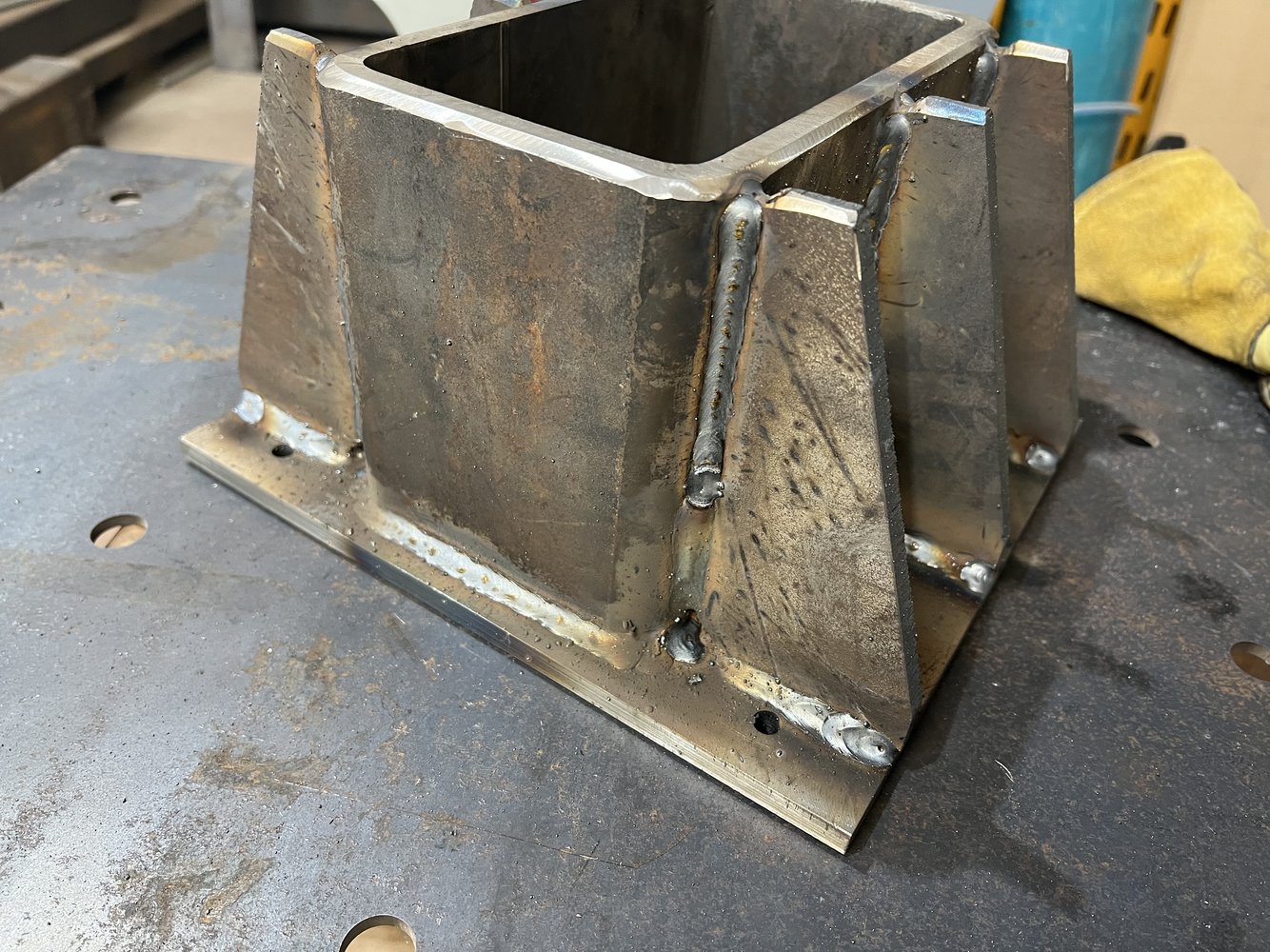

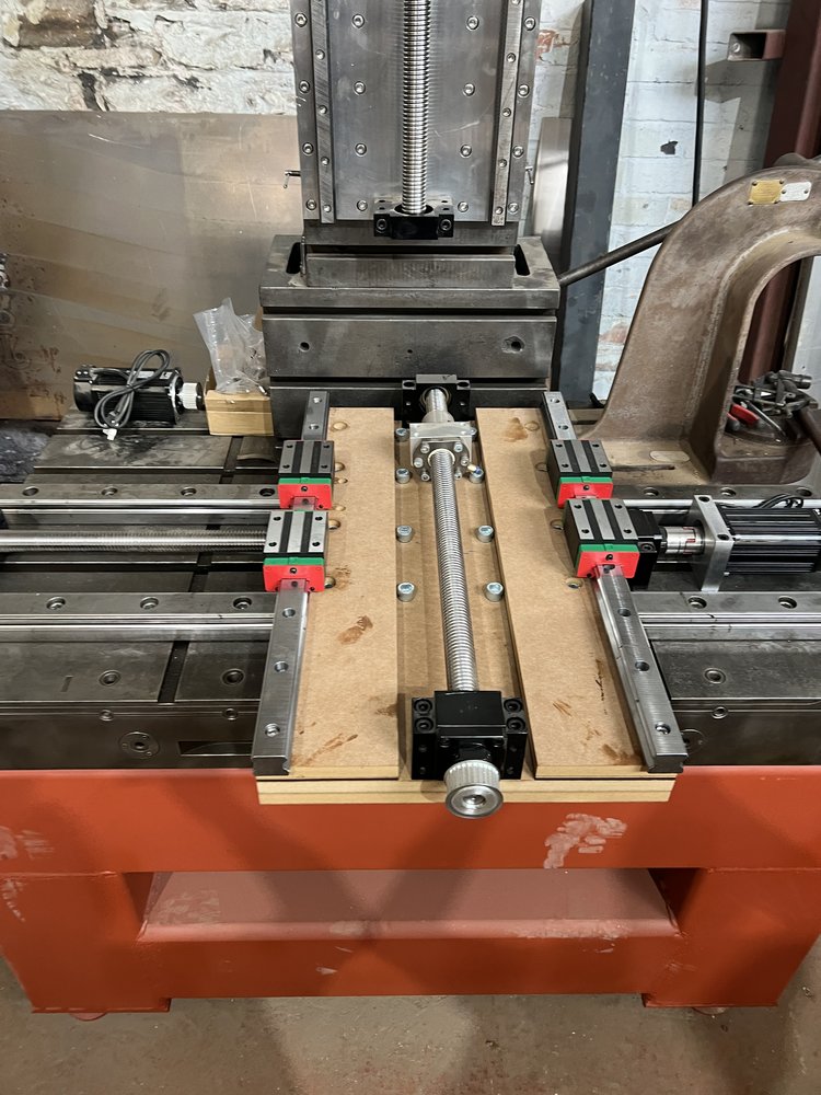

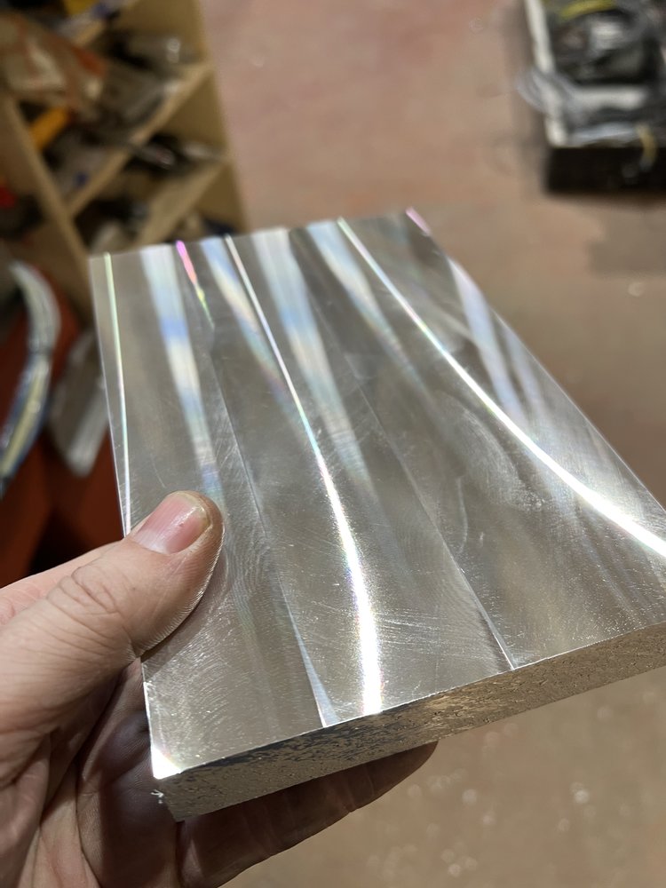

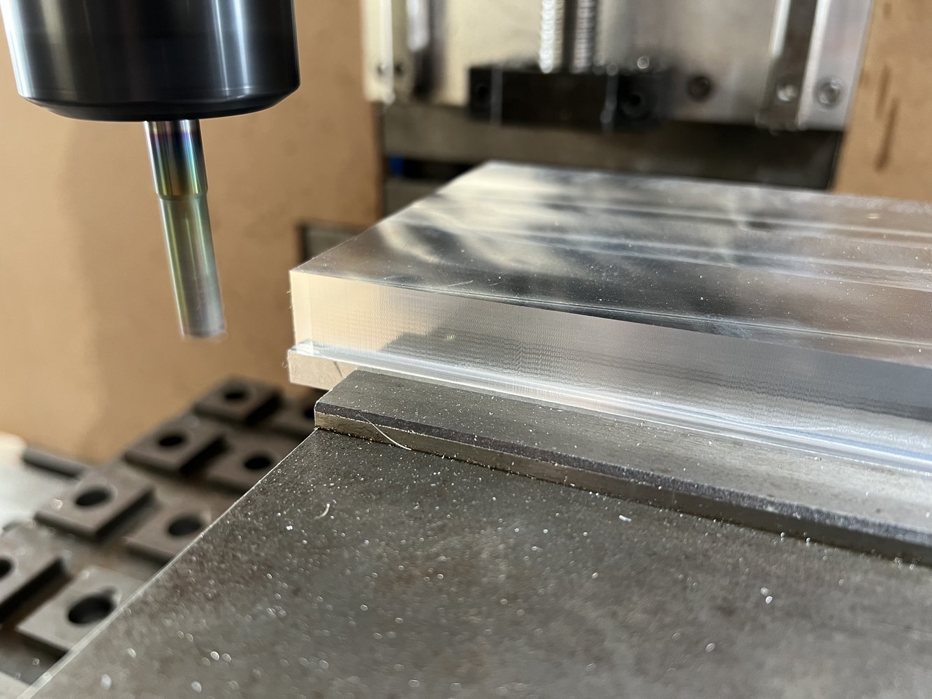

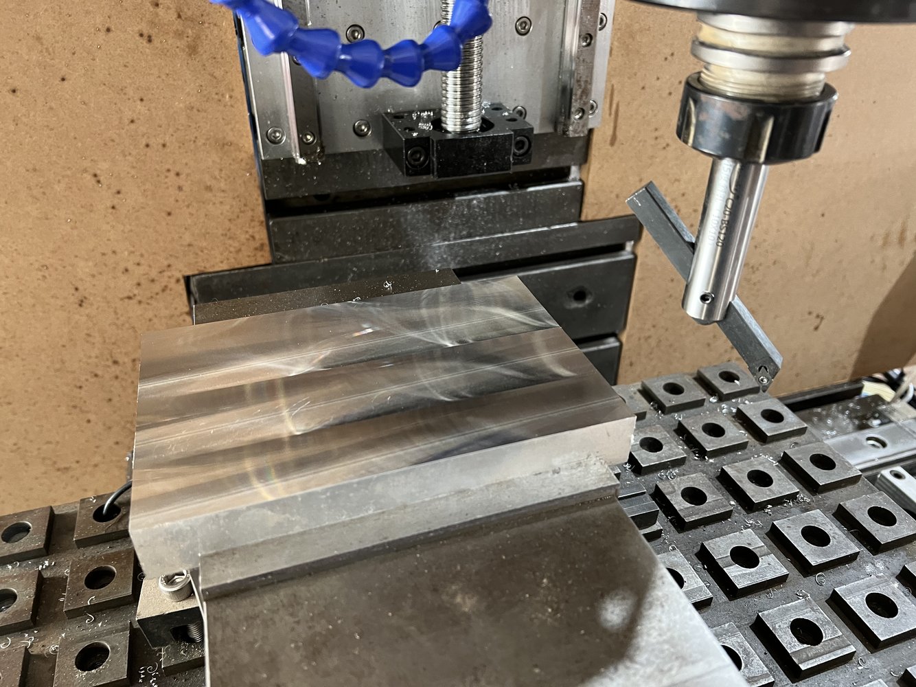

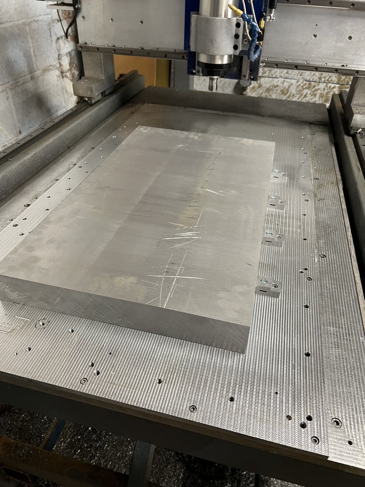

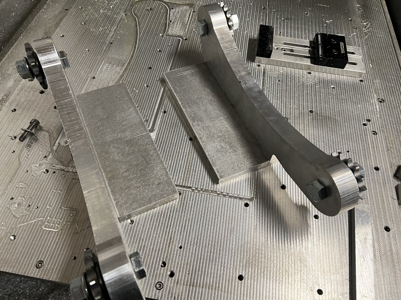

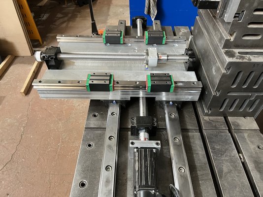

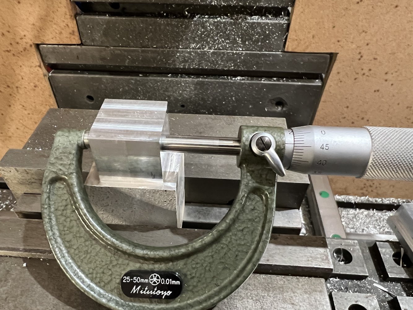

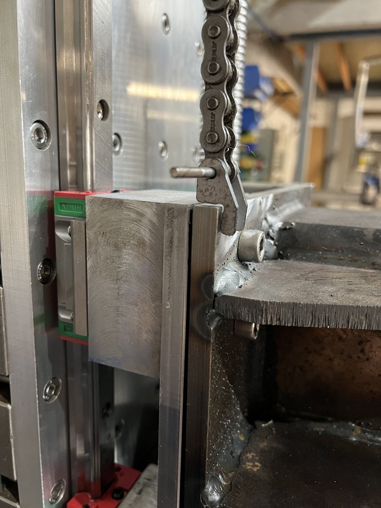

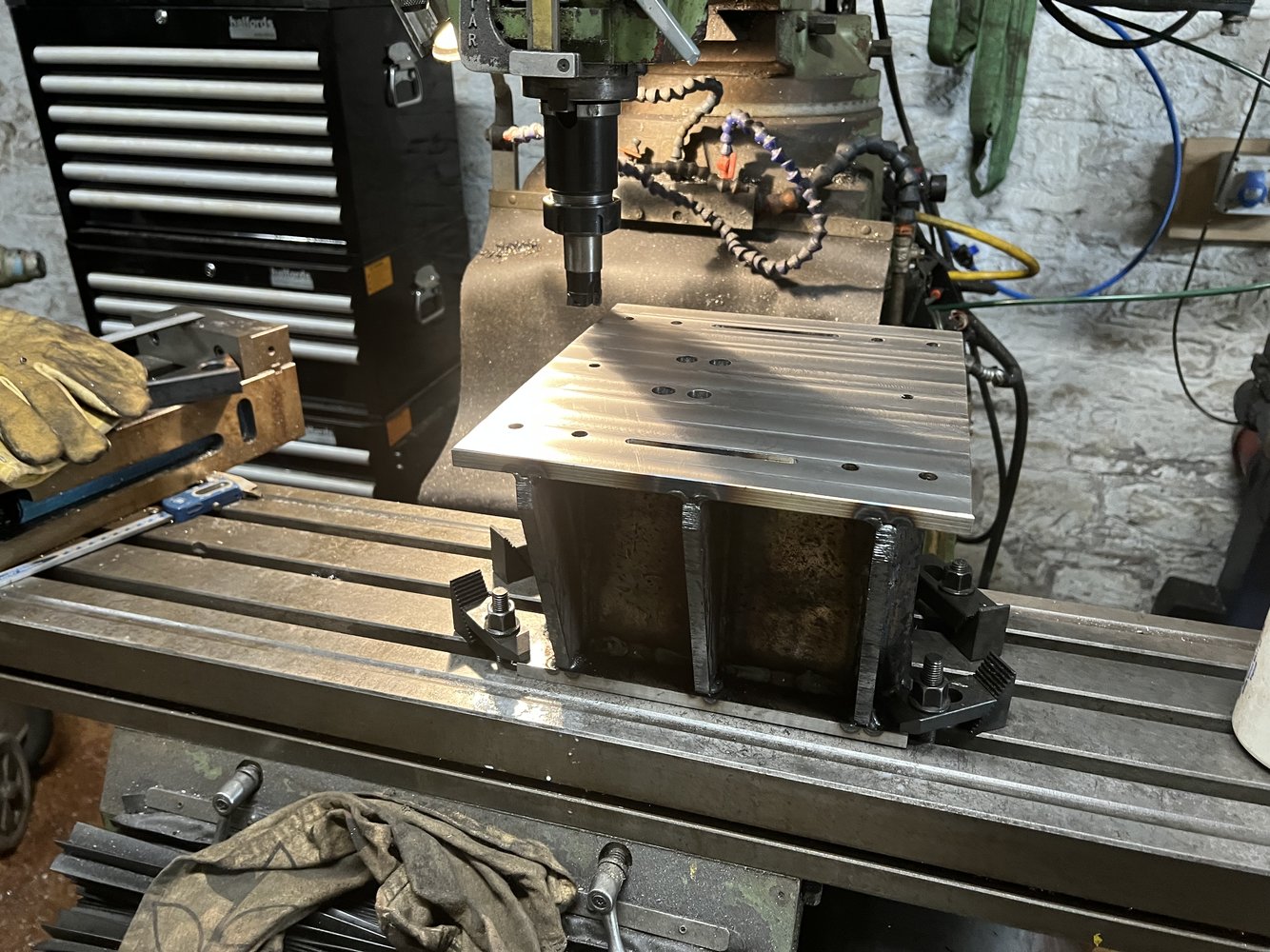

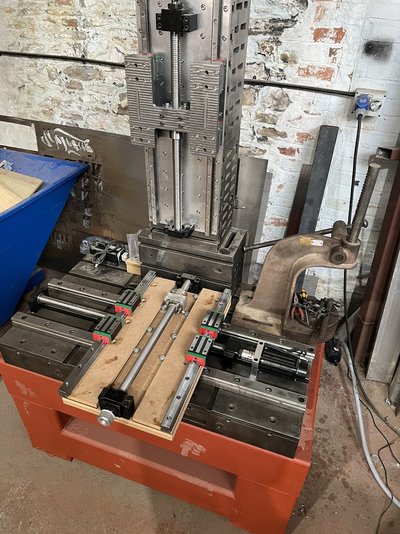

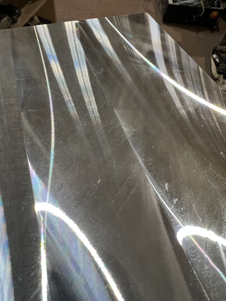

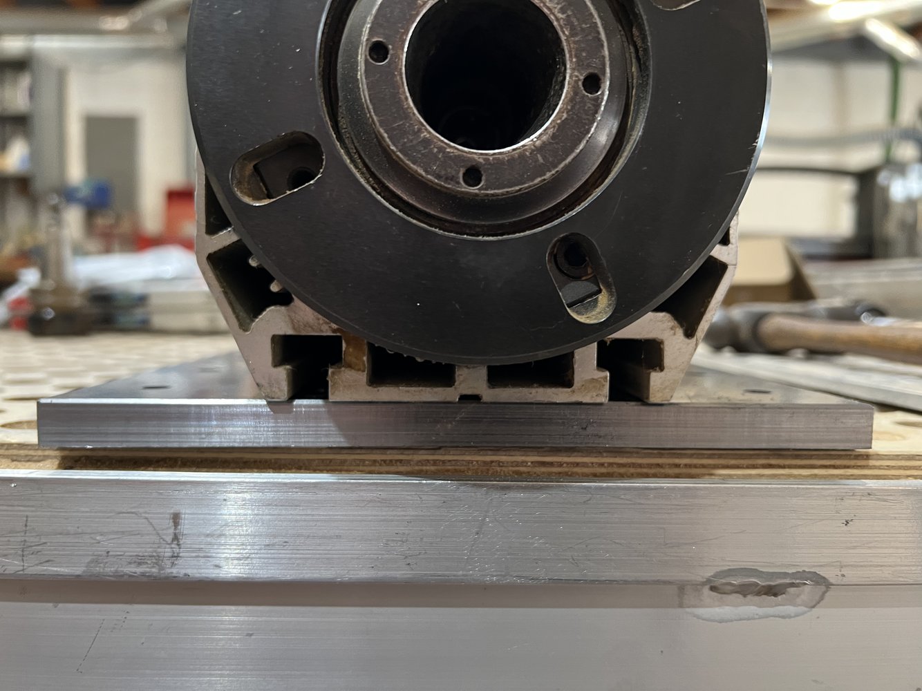

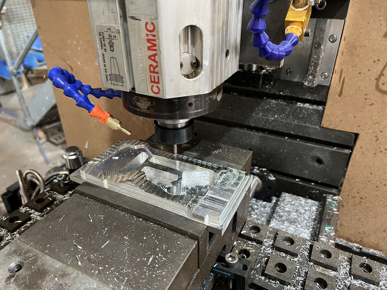

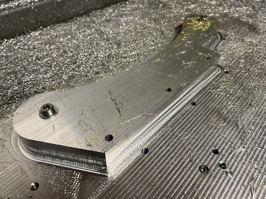

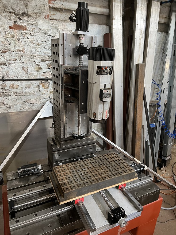

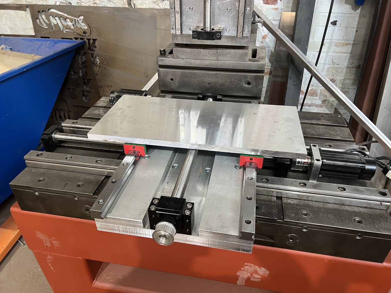

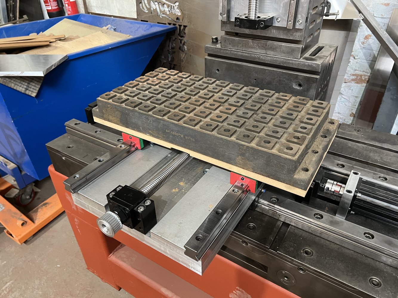

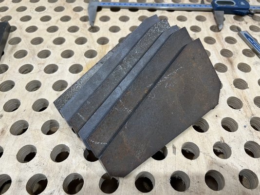

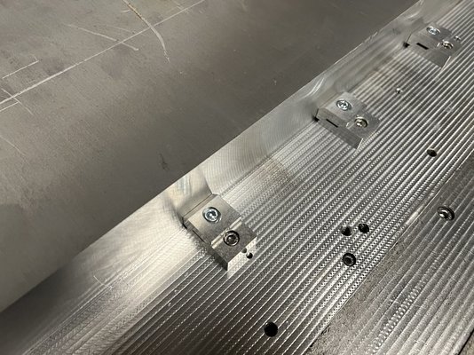

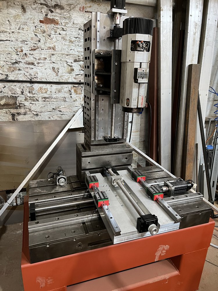

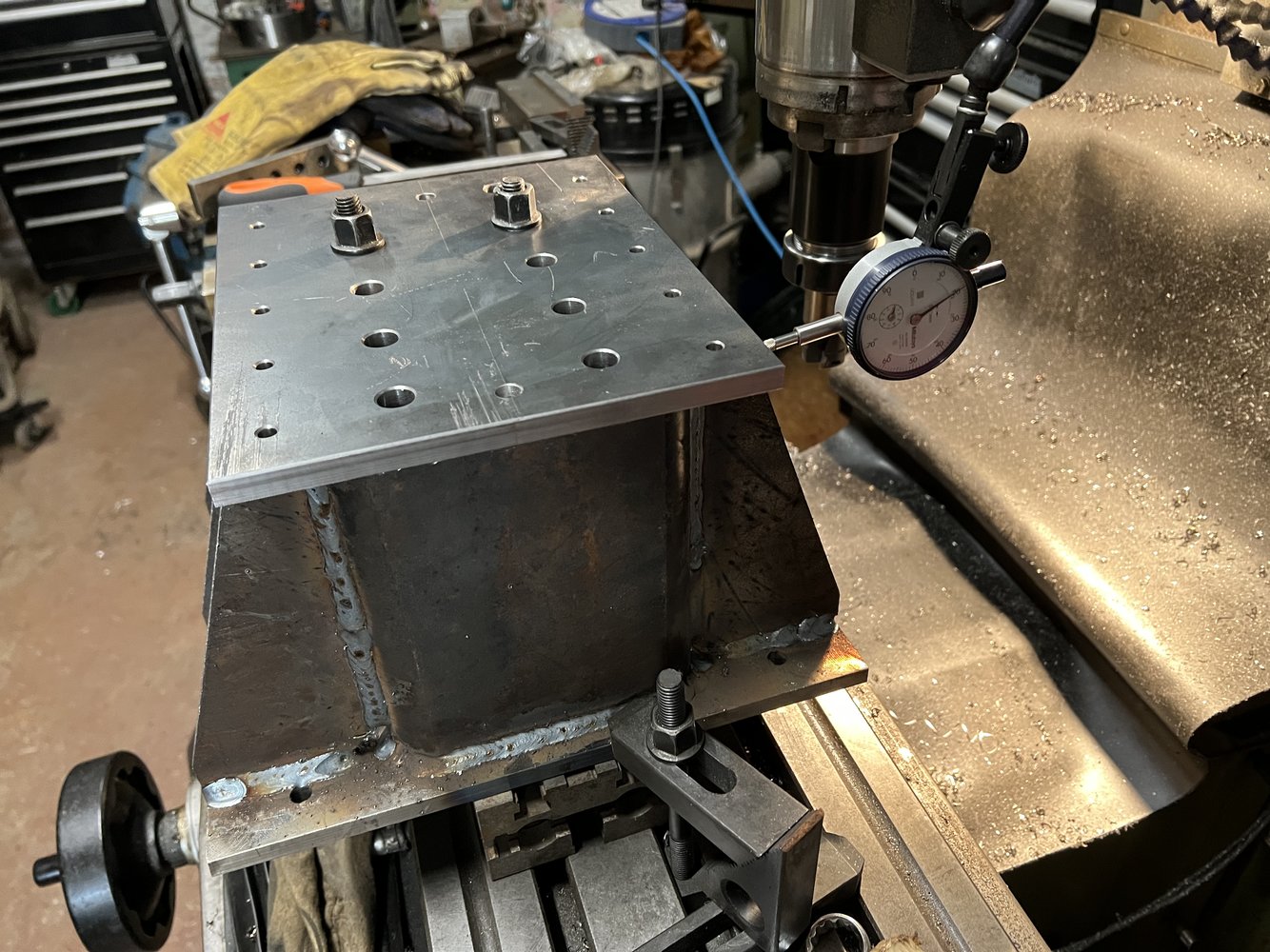

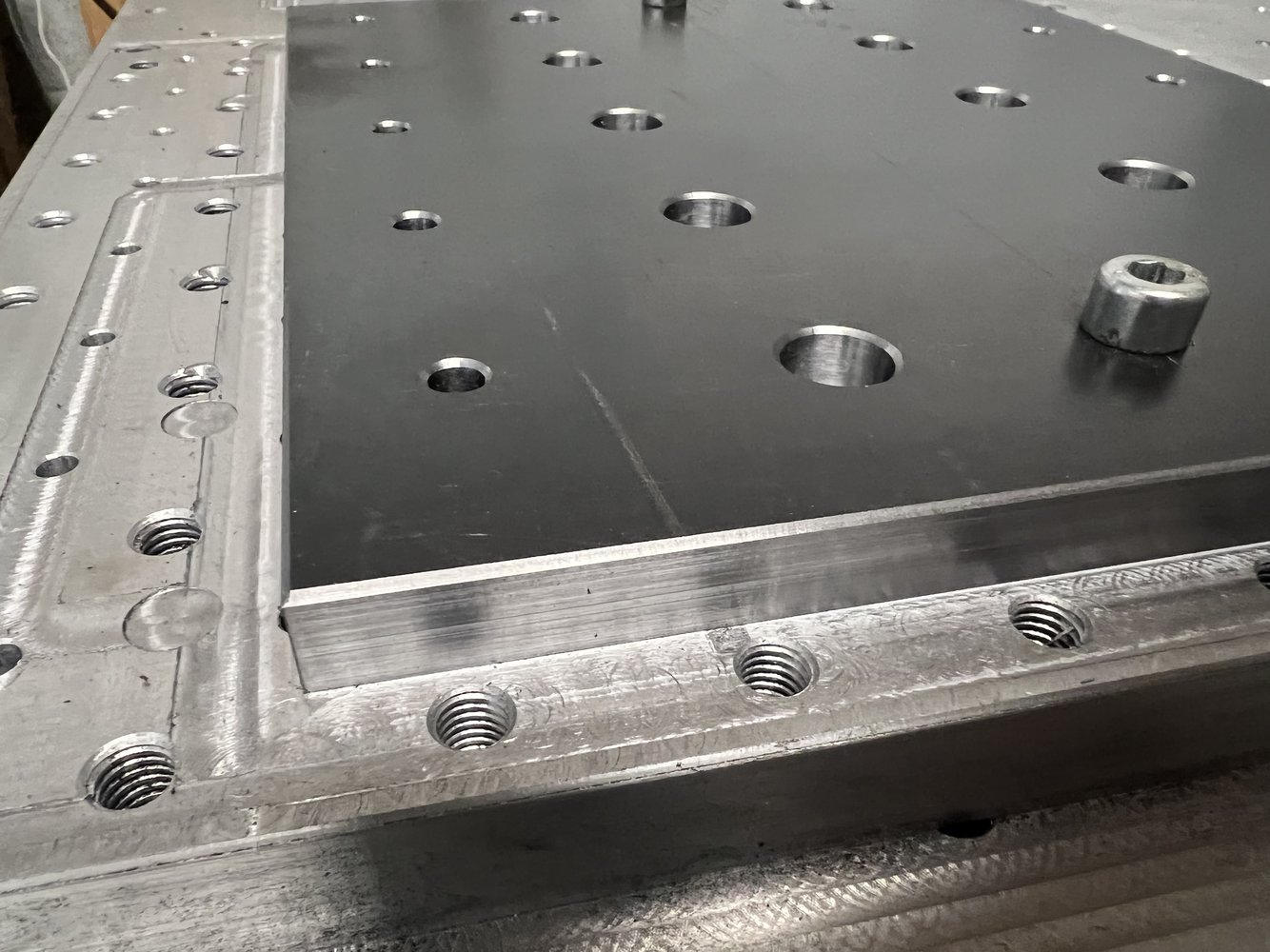

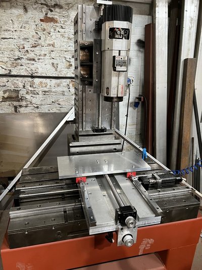

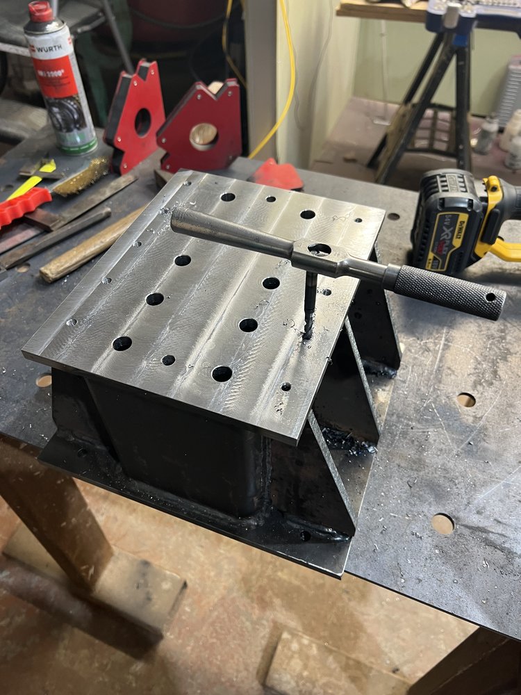

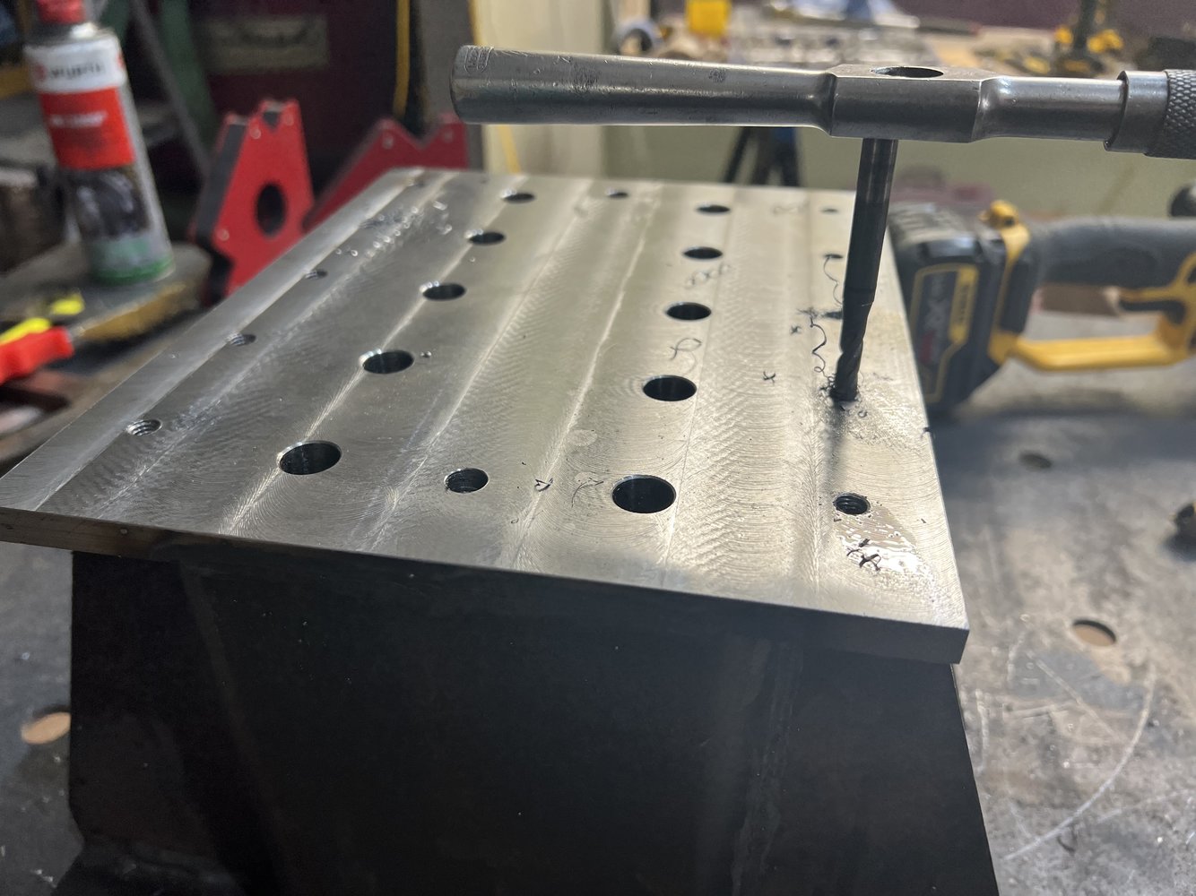

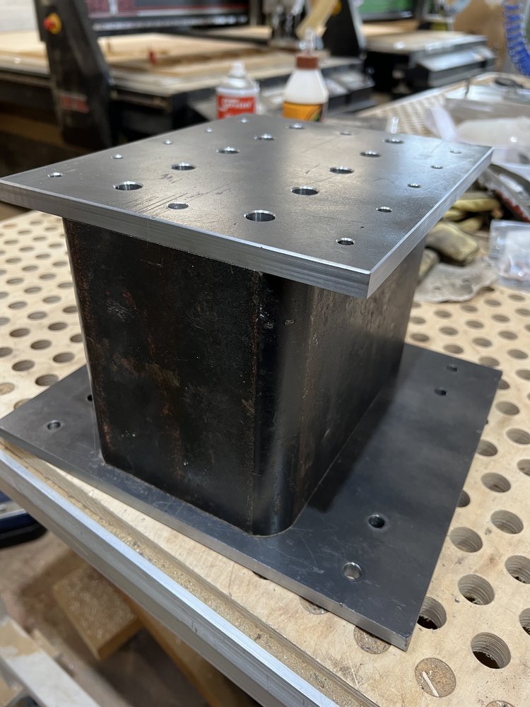

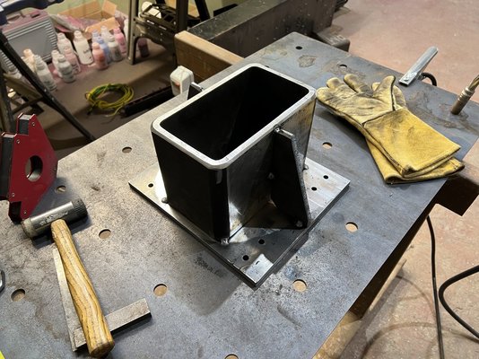

Good stuff this.I cut the back plate of the spindle spacer weldment today.

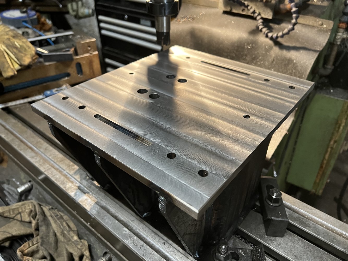

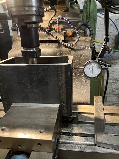

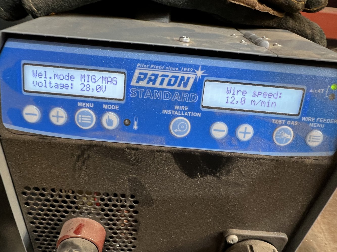

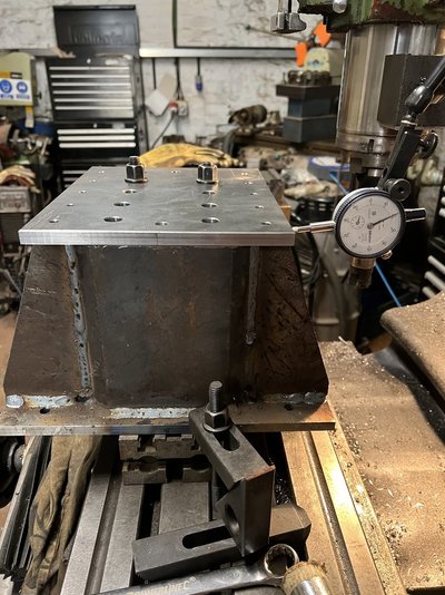

I haven’t surfaced the plate yet, I intend to weld the spacer first and then surface it front and back on the manual mill to ensure parallelism.

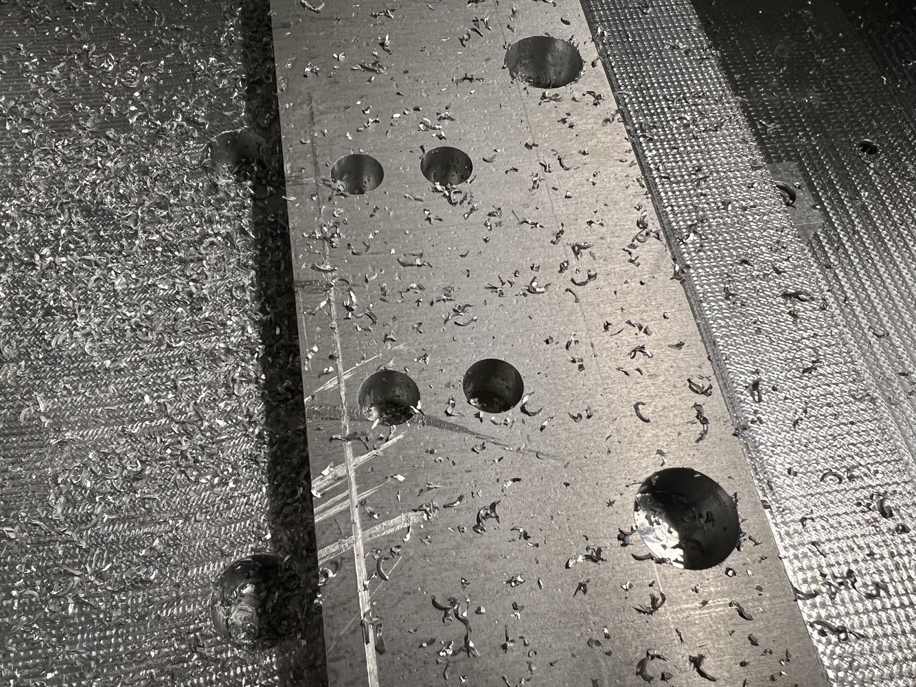

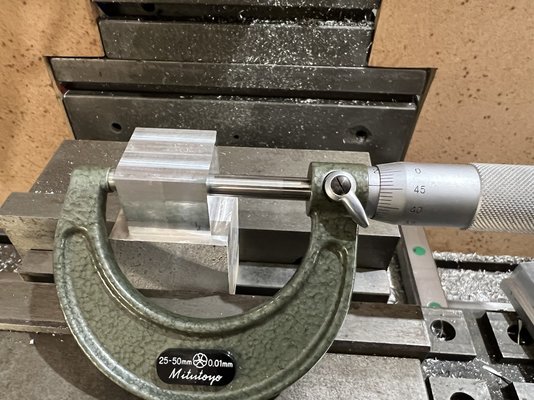

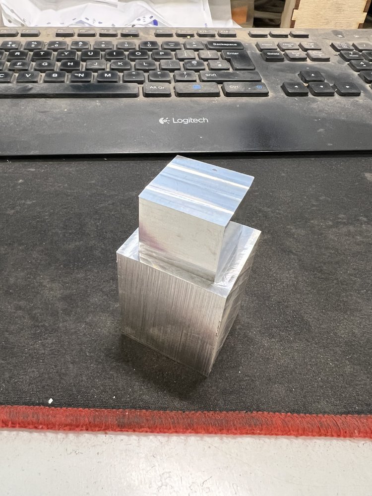

I cut and fitted two keys to Z spindle plate, they are a slightly interference fit and needed tapping home with a hammer, the corresponding keyways in the spacer plate are a nice tight slip fit.
View attachment 357378View attachment 357379View attachment 357380View attachment 357381View attachment 357382View attachment 357383
