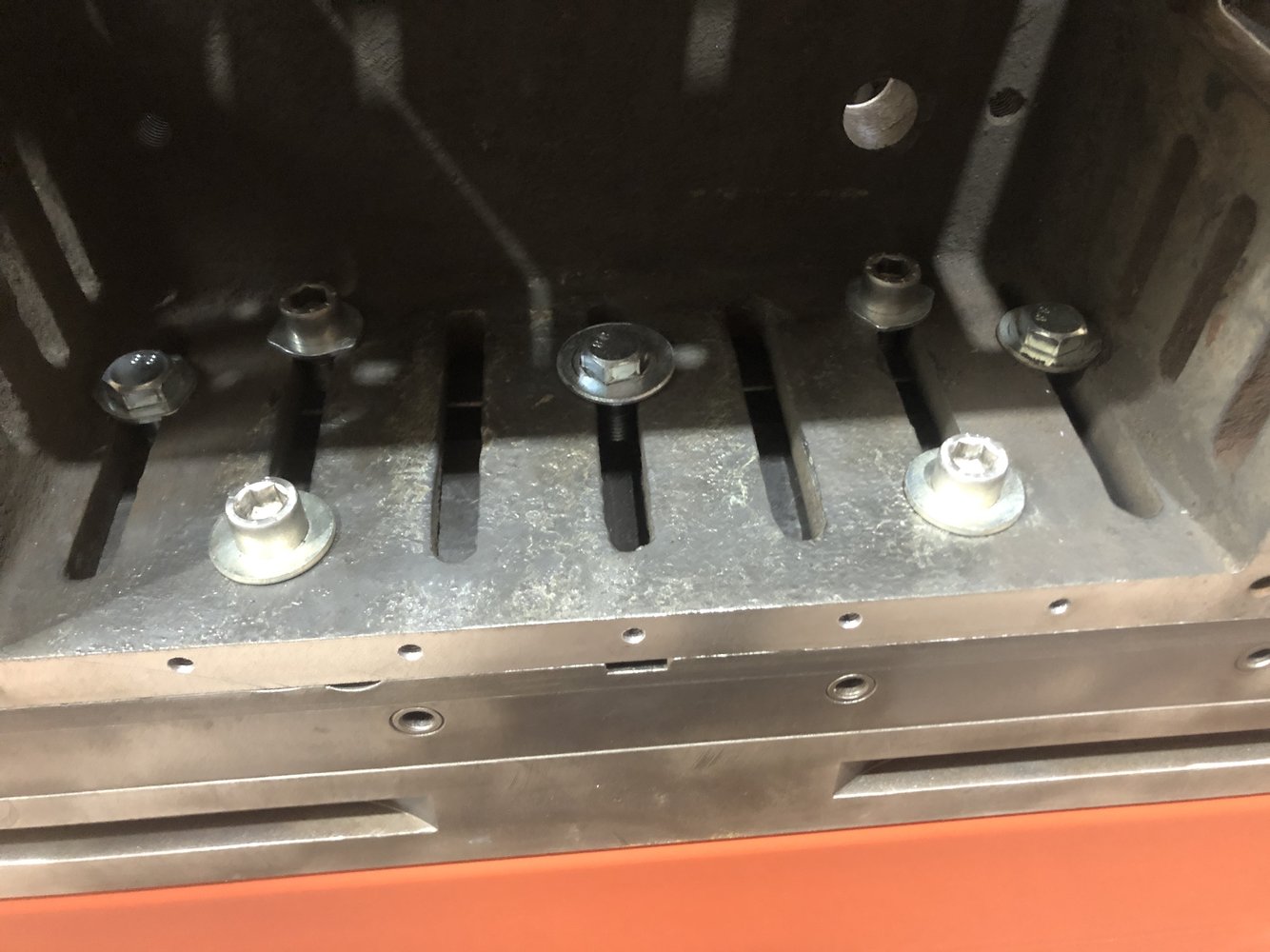

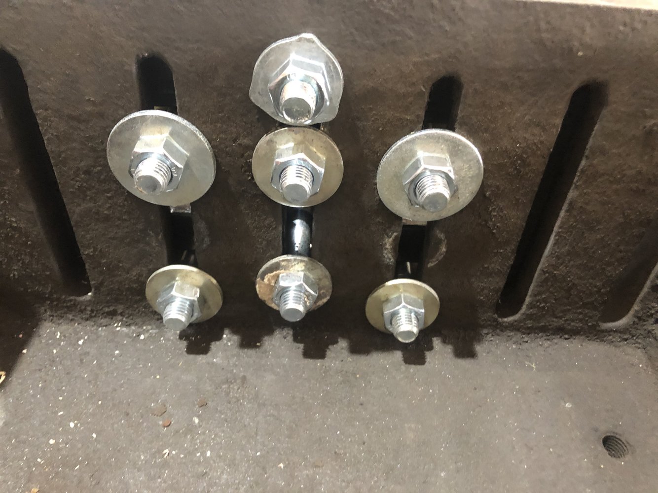

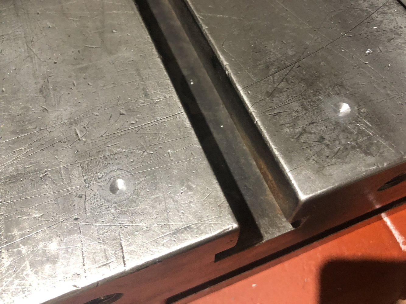

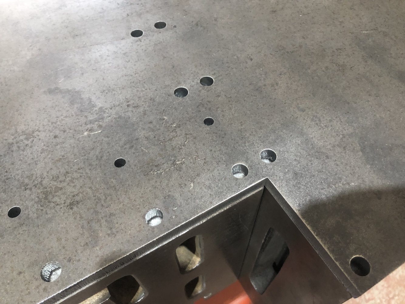

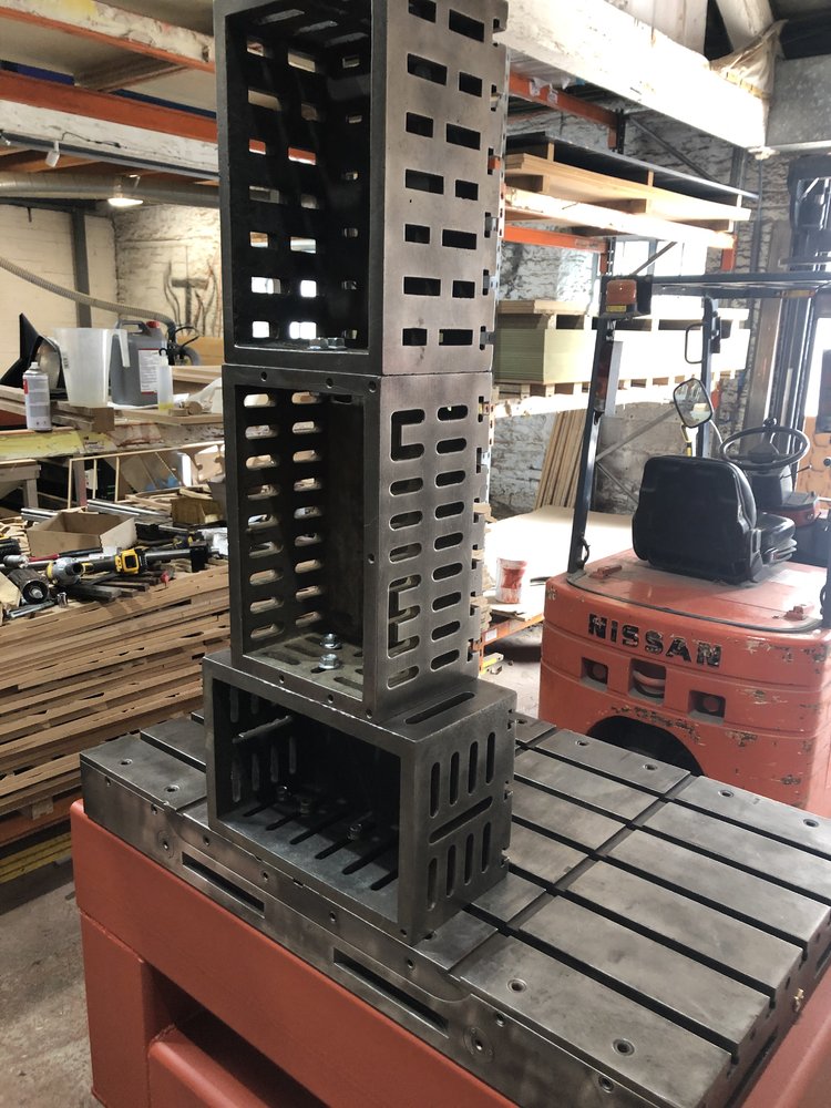

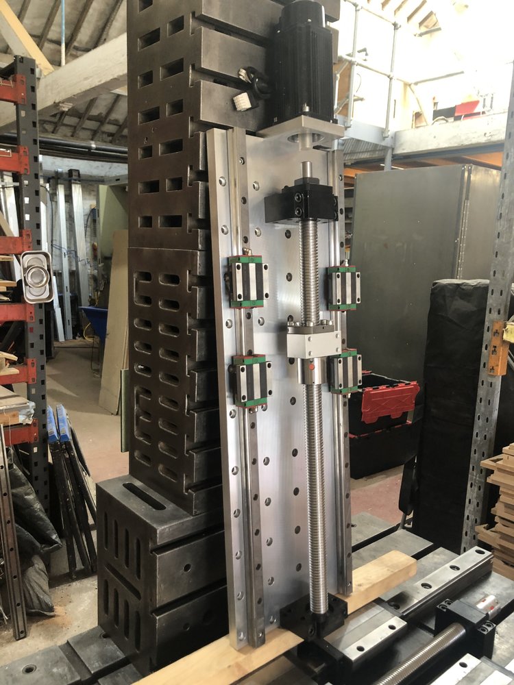

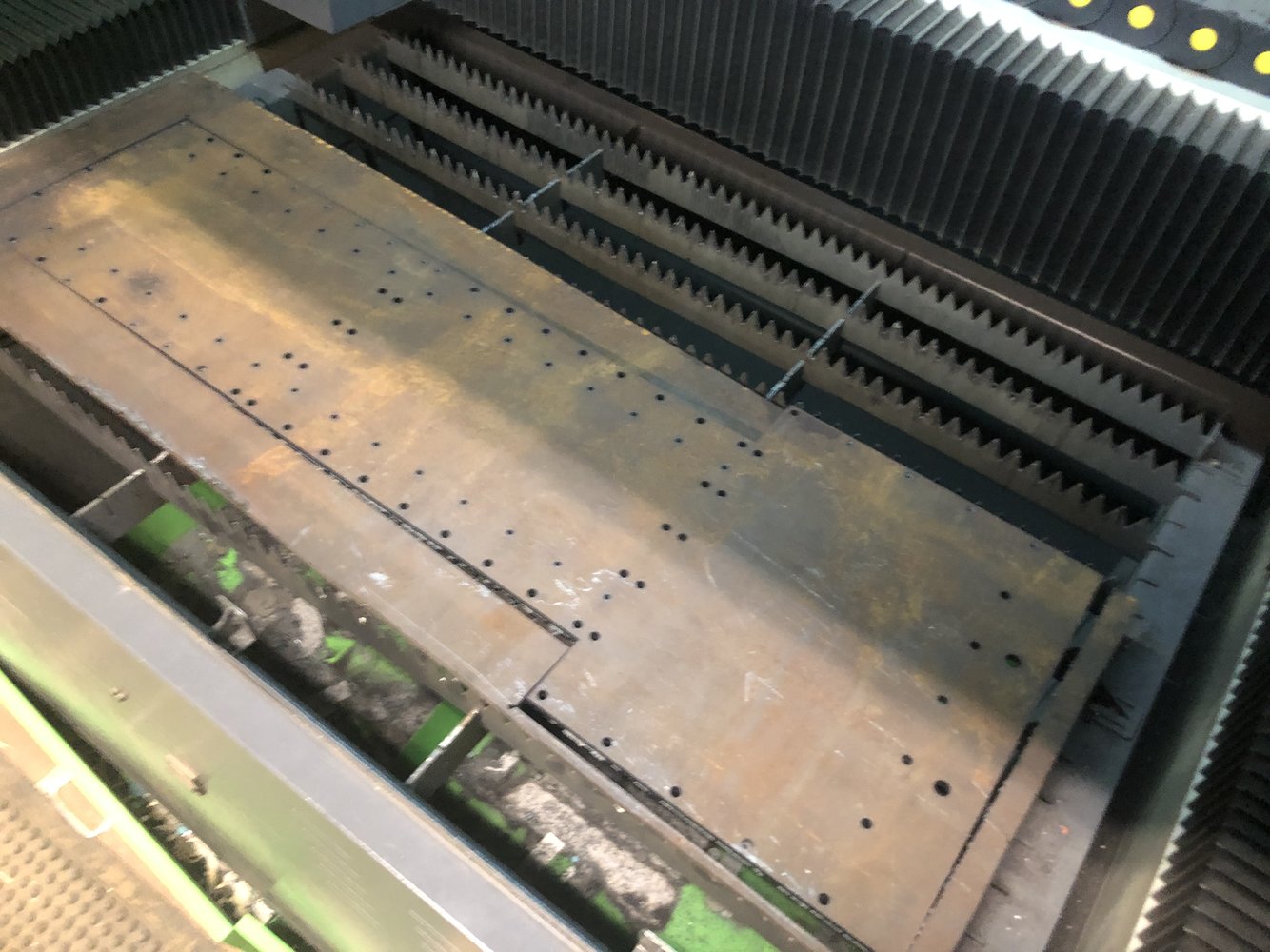

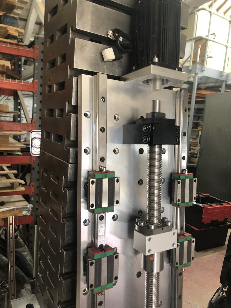

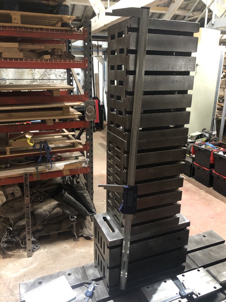

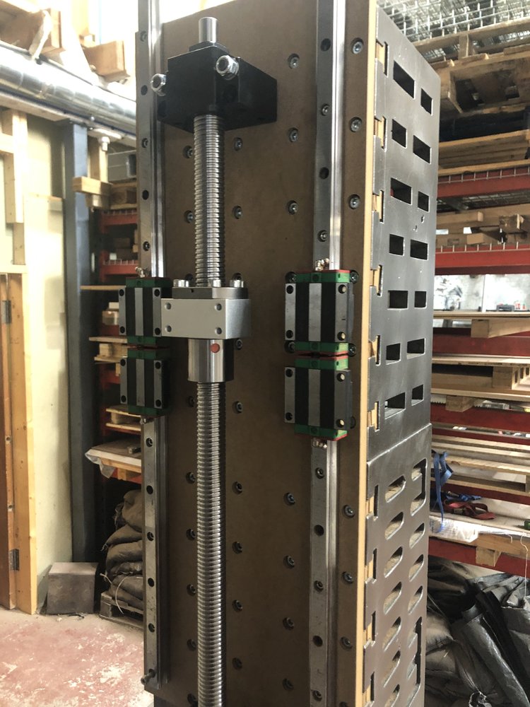

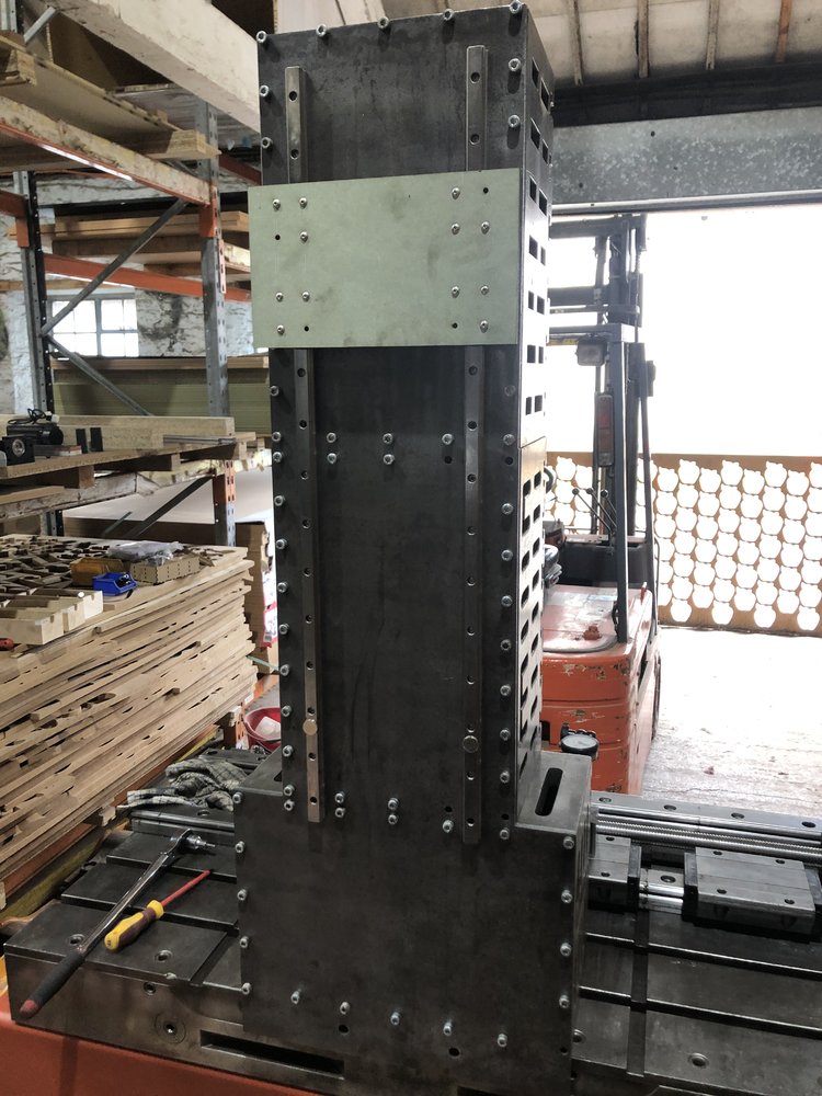

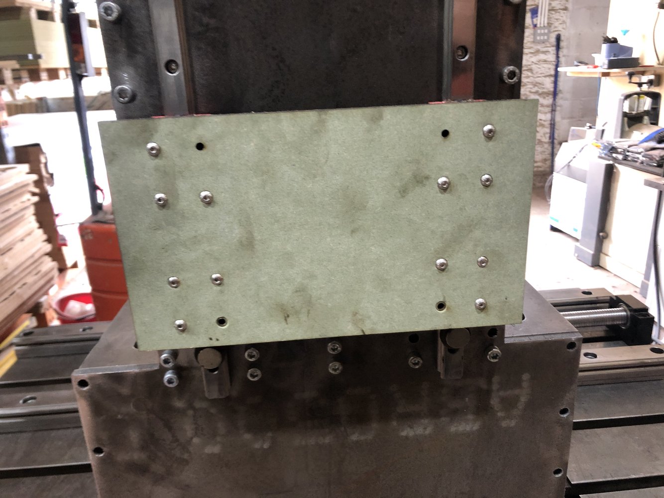

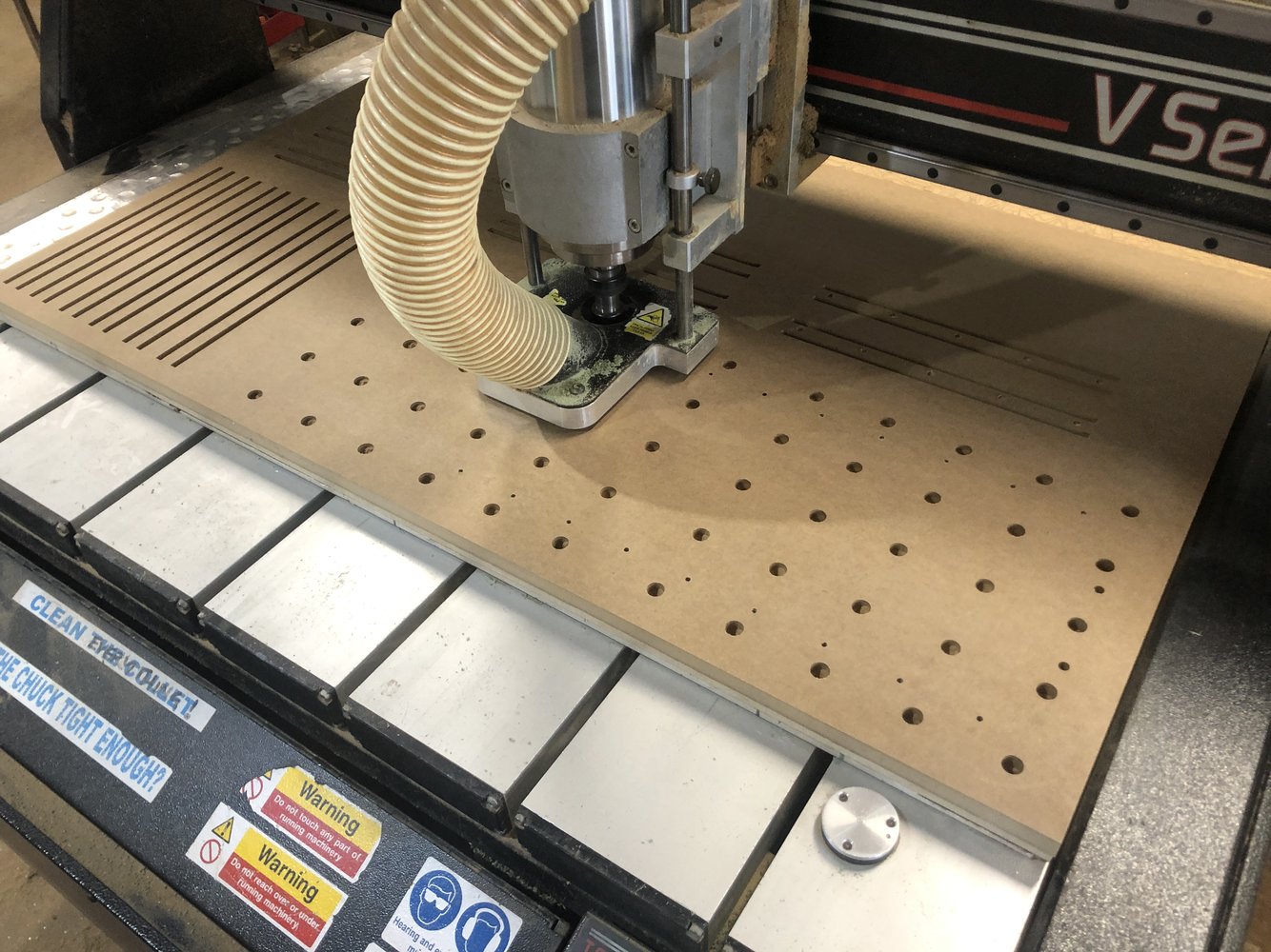

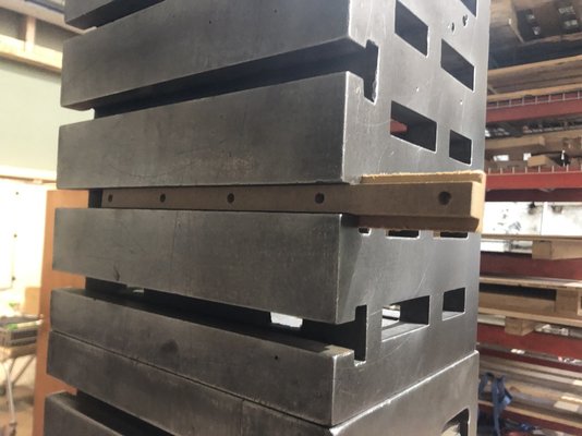

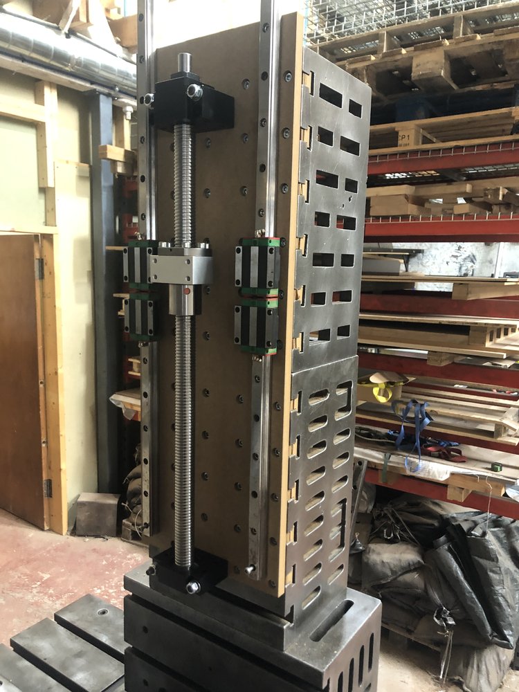

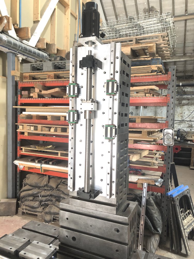

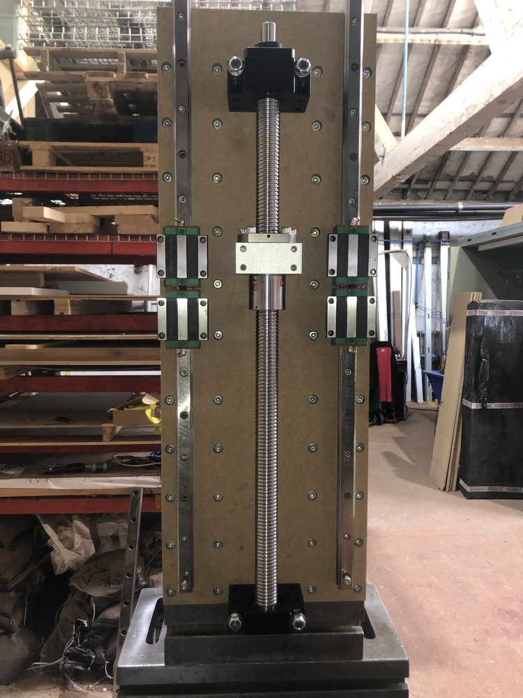

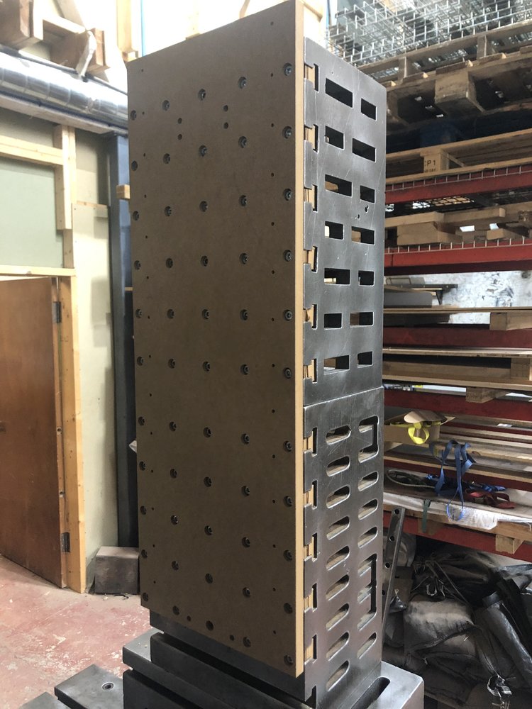

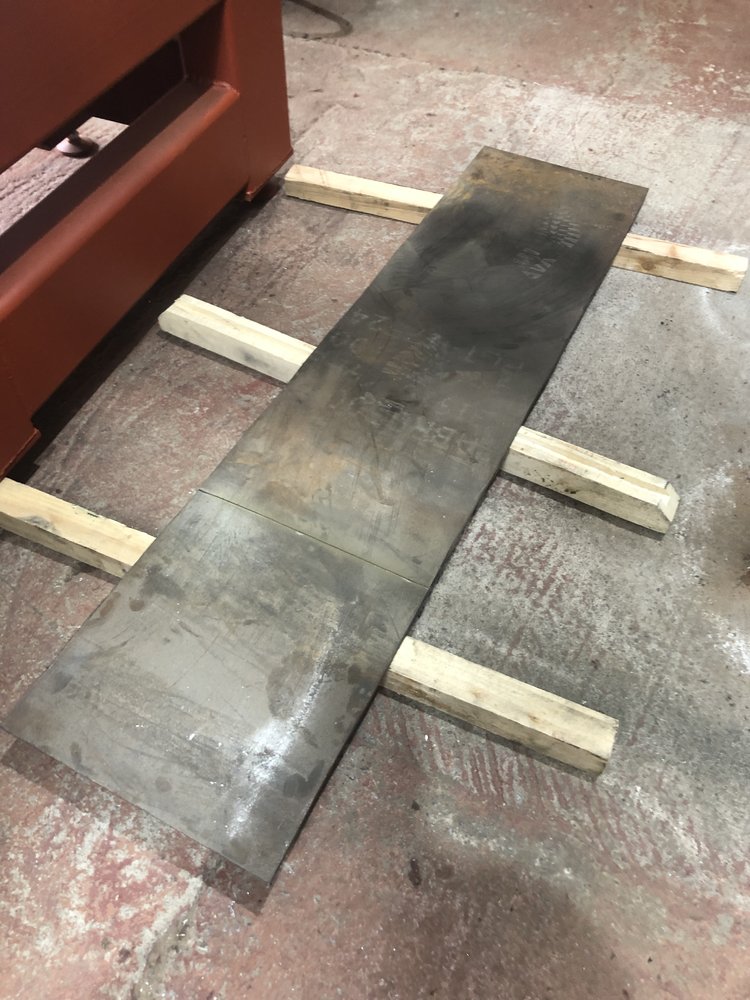

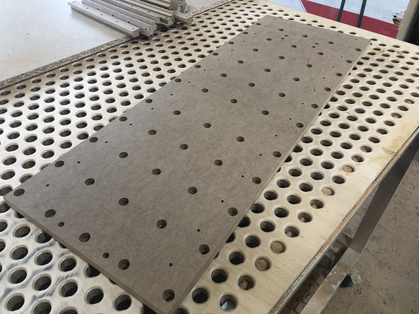

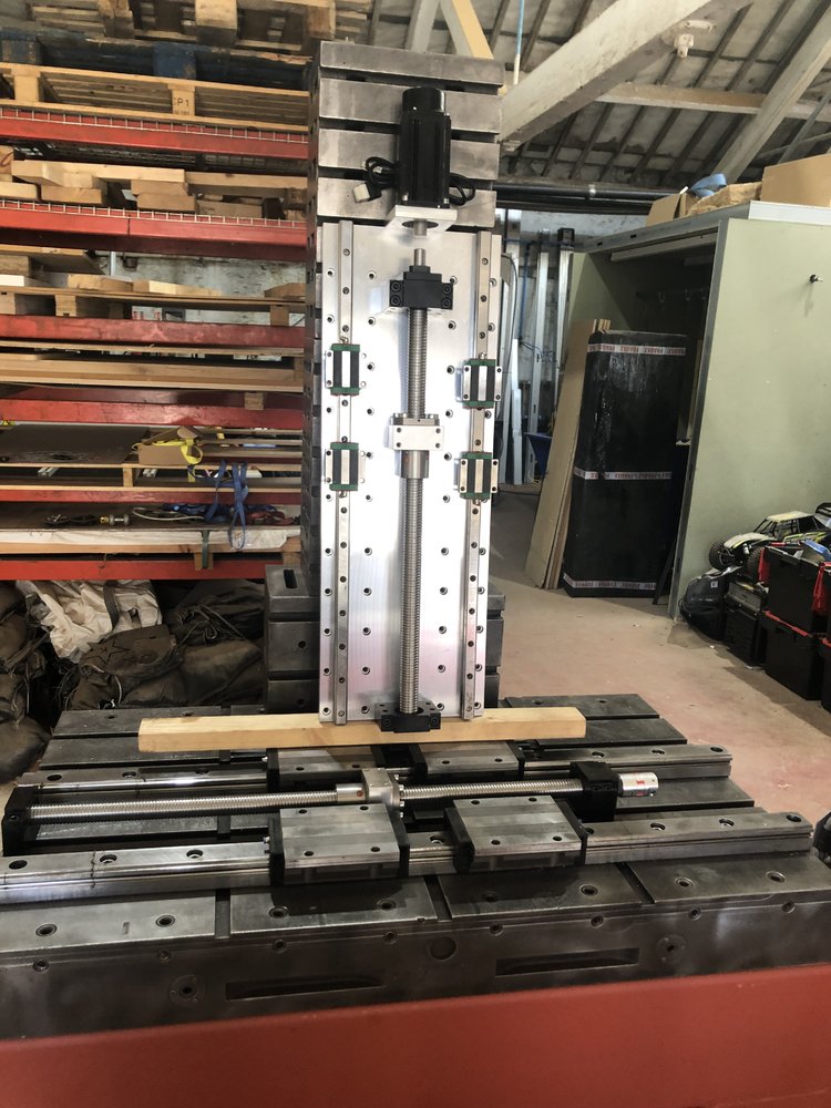

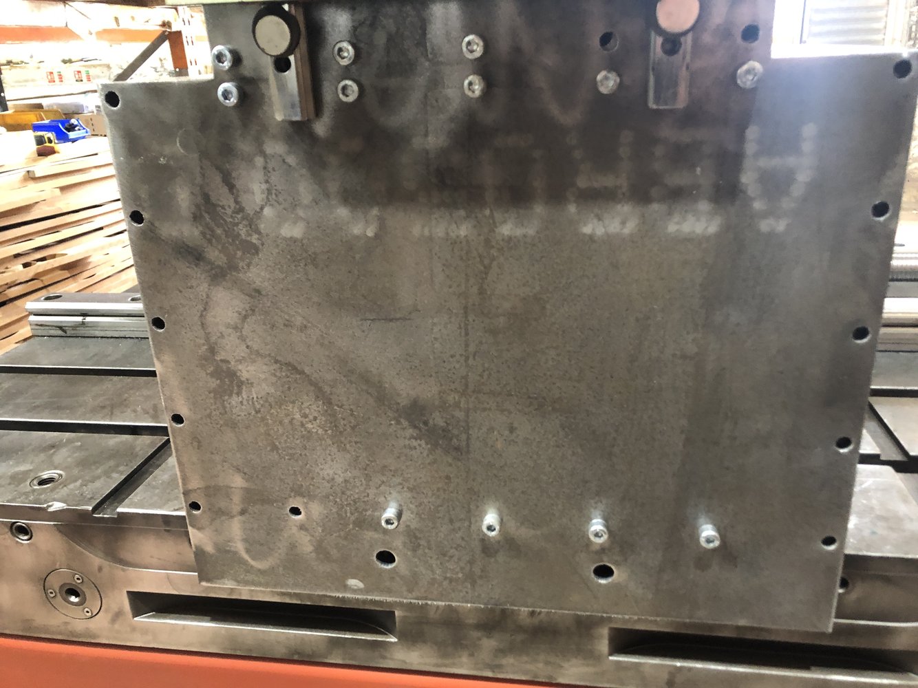

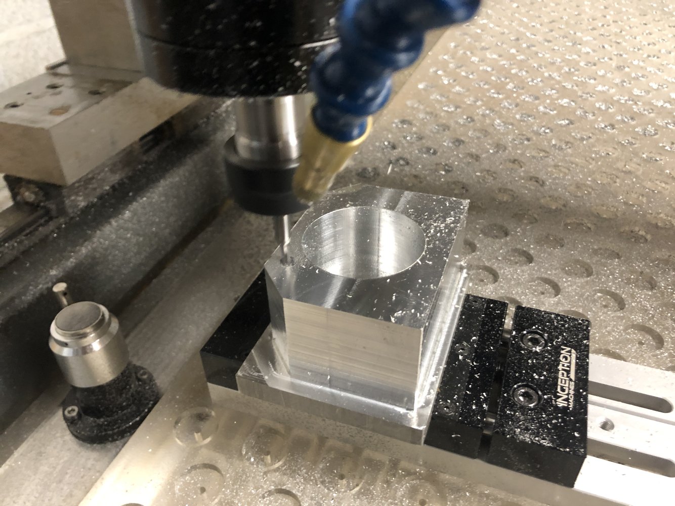

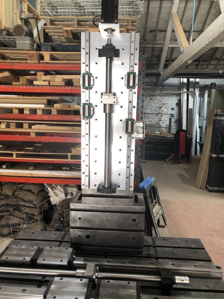

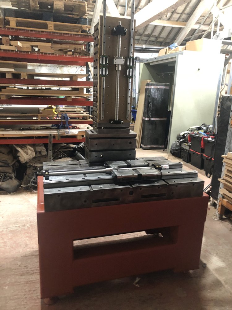

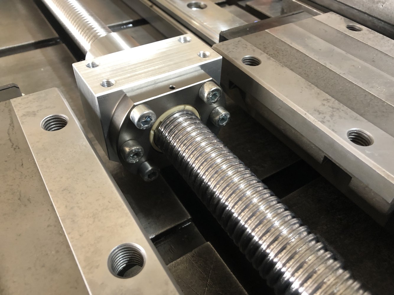

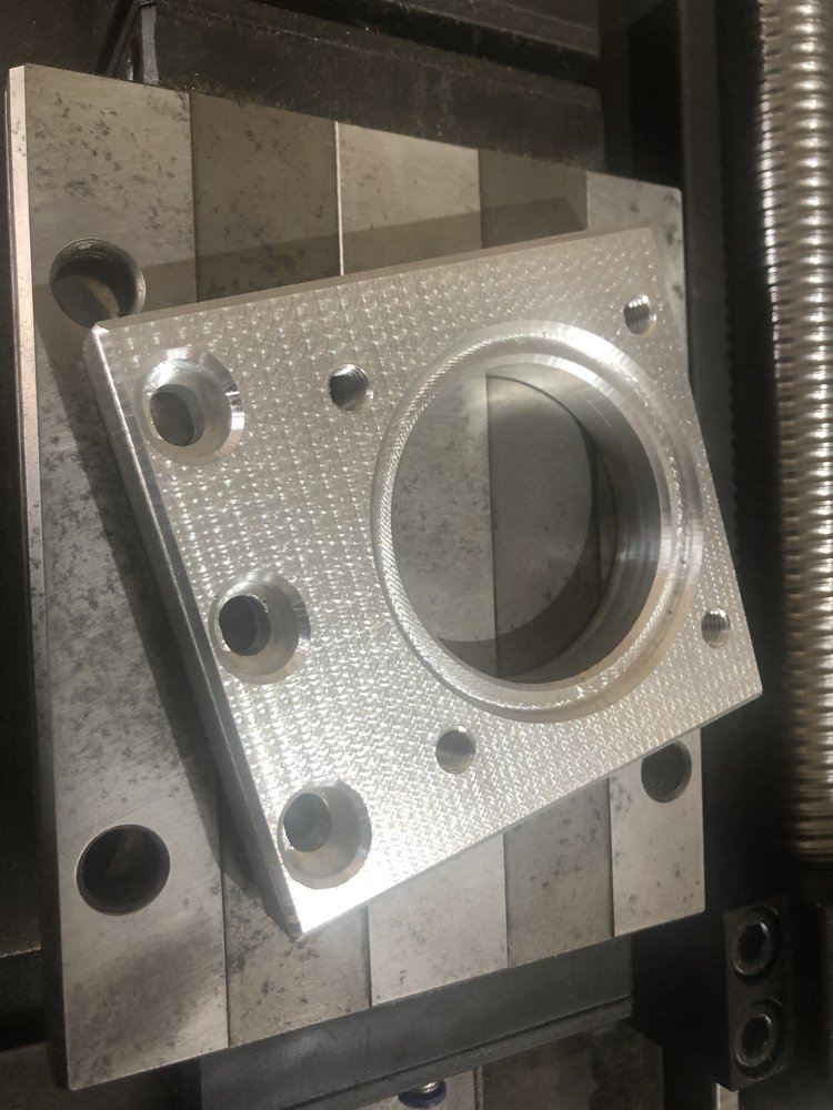

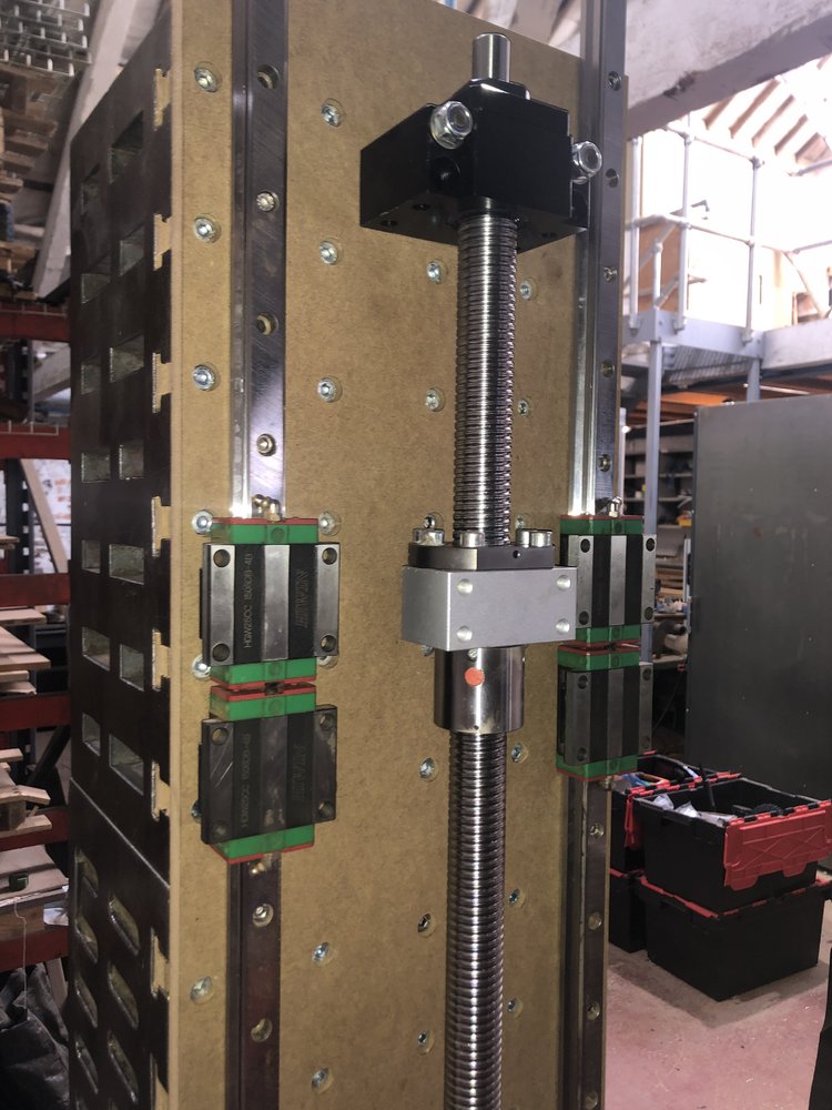

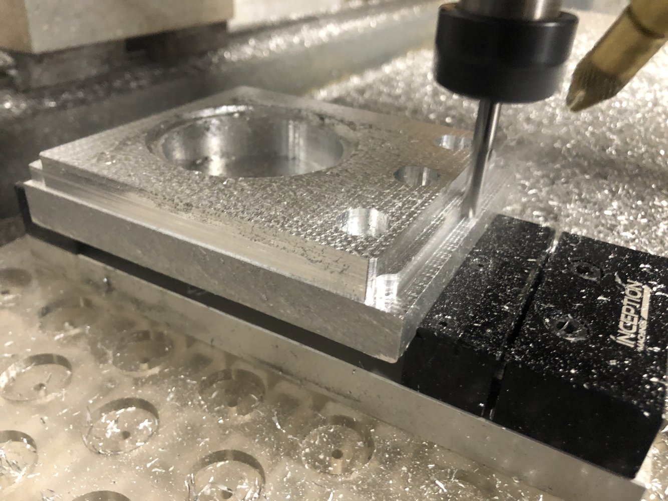

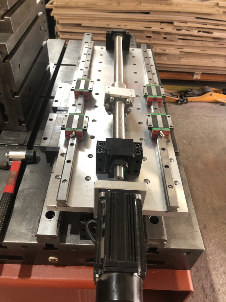

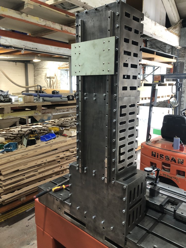

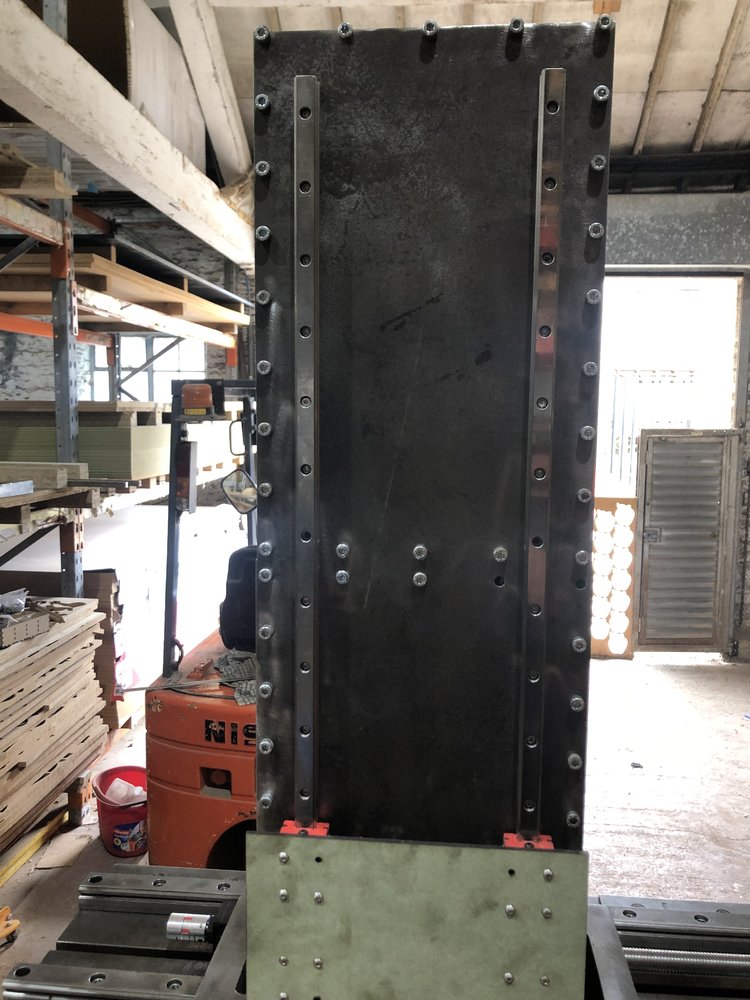

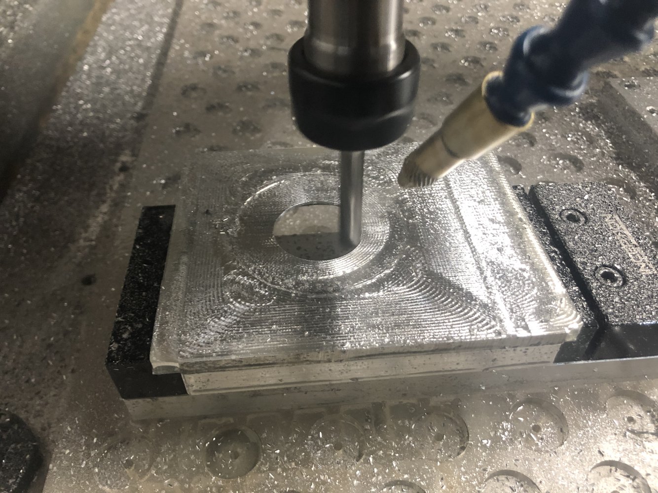

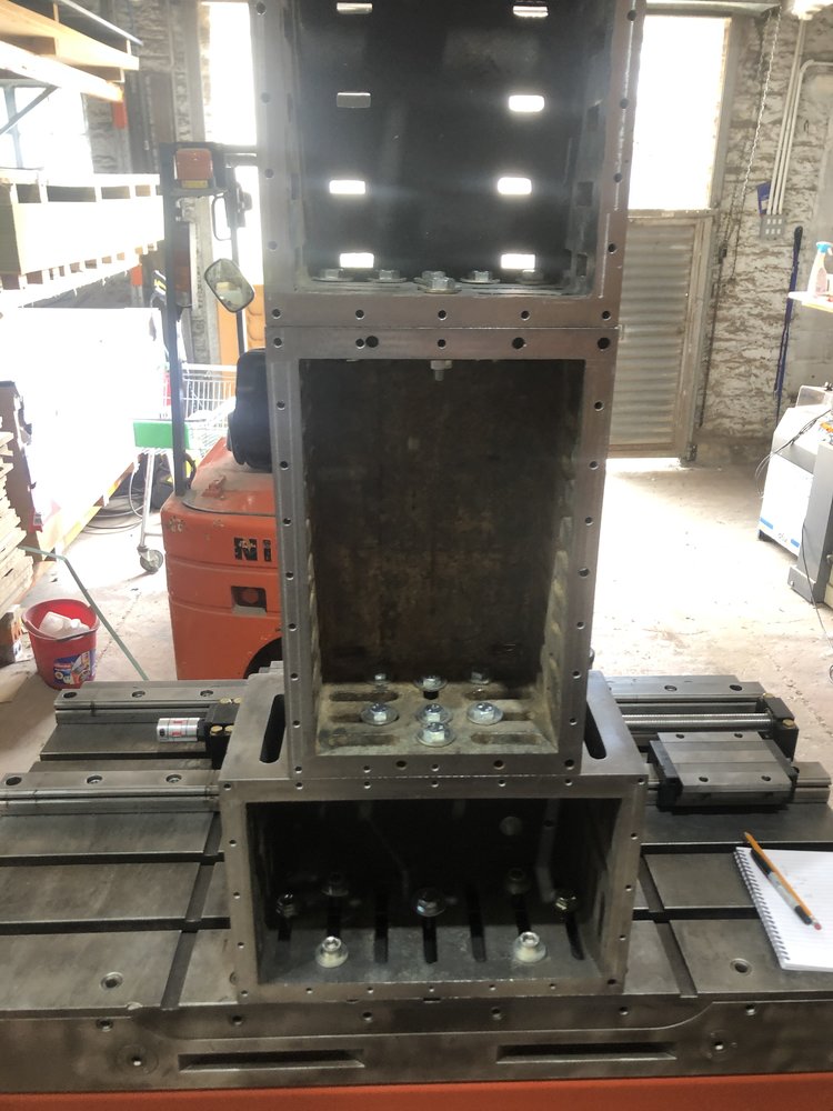

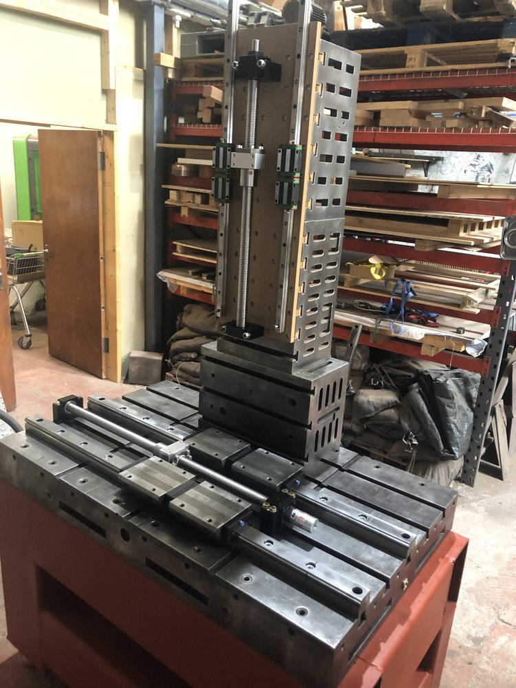

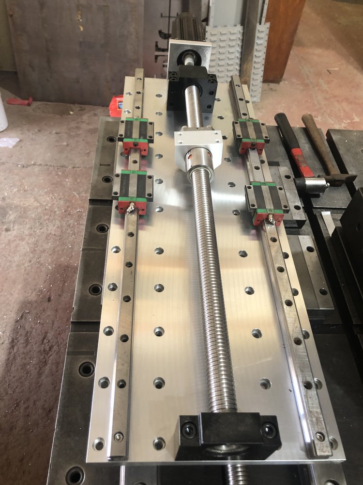

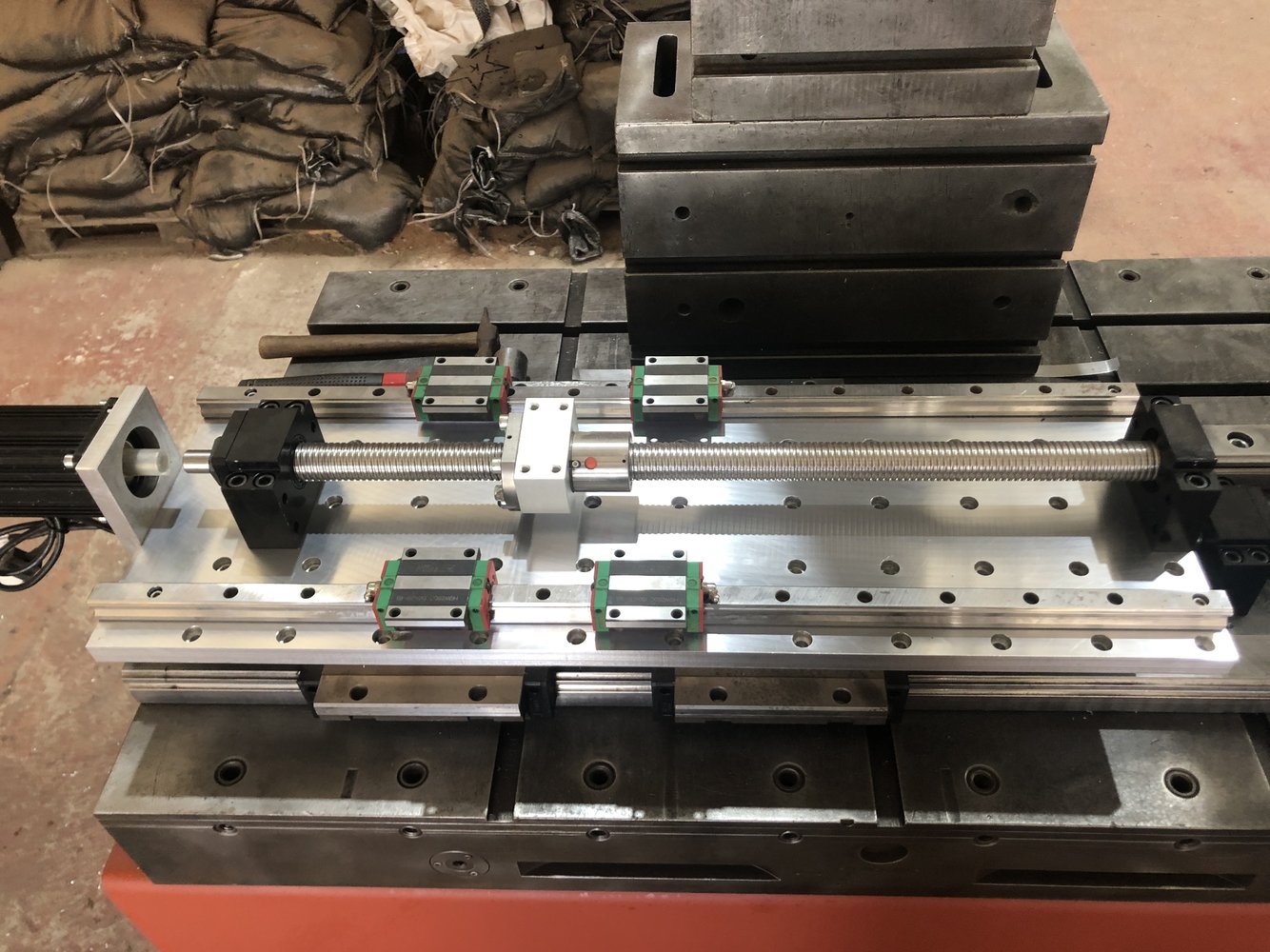

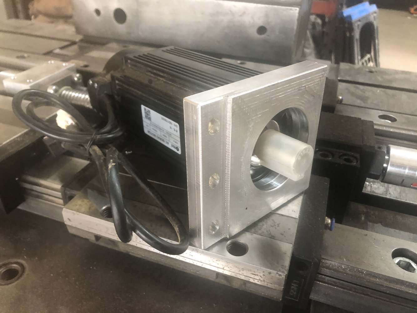

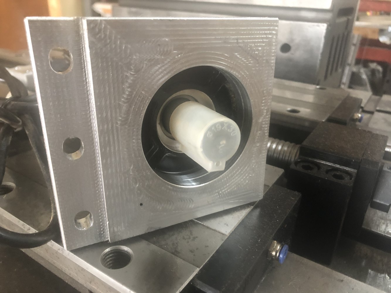

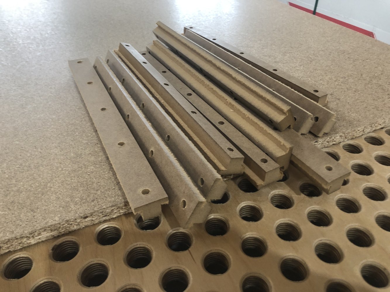

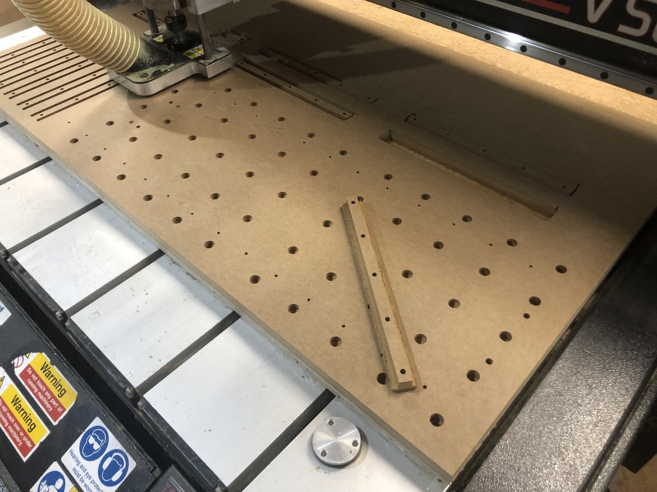

Ah Ah now it makes sense...lolUsed one of the Tekcel routers to prototype the Z axis mounting plate from 18mm HDF.
I have a piece of 20mm Aluminium tooling plate for this part but wanted to test all the hole locations before committing it to metal:
View attachment 347424View attachment 347425View attachment 347426View attachment 347427View attachment 347428View attachment 347429

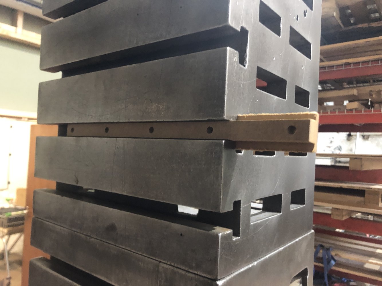

Haha, made you look twice.Ah Ah now it makes sense...lol
Edit I thought "wood" what on earth...lol
