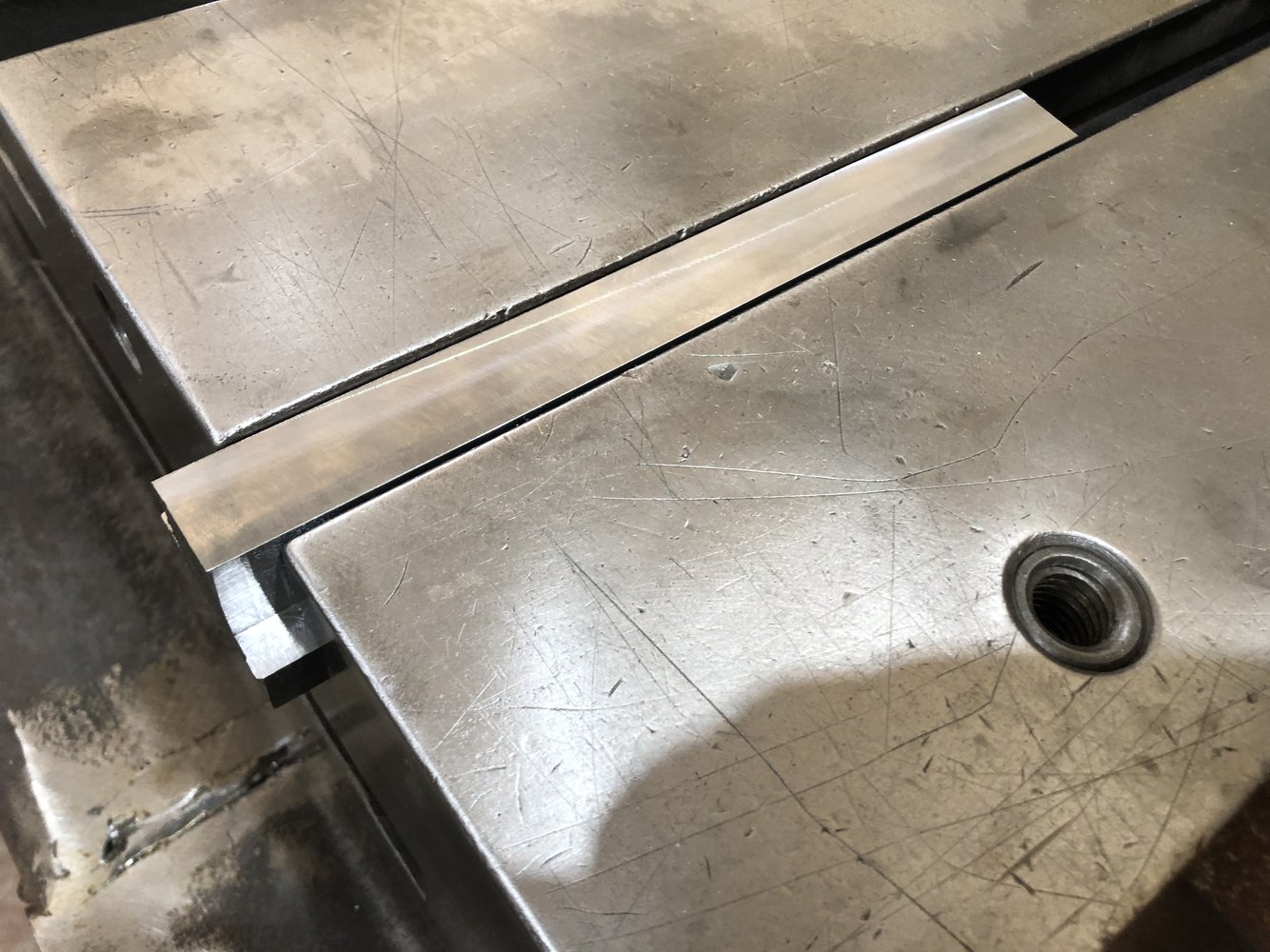

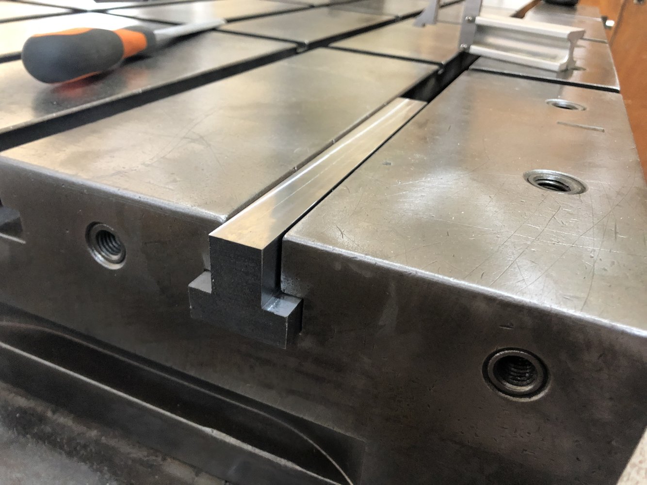

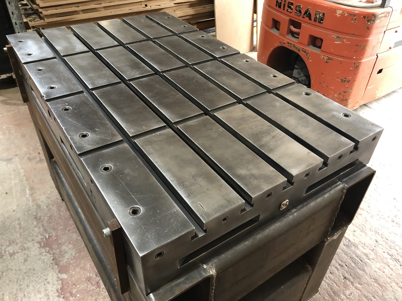

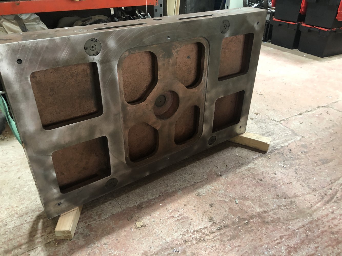

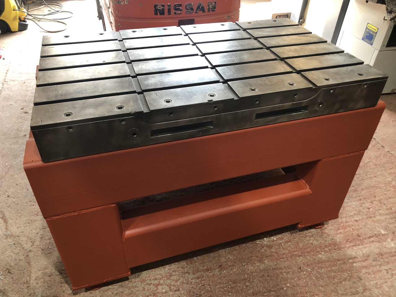

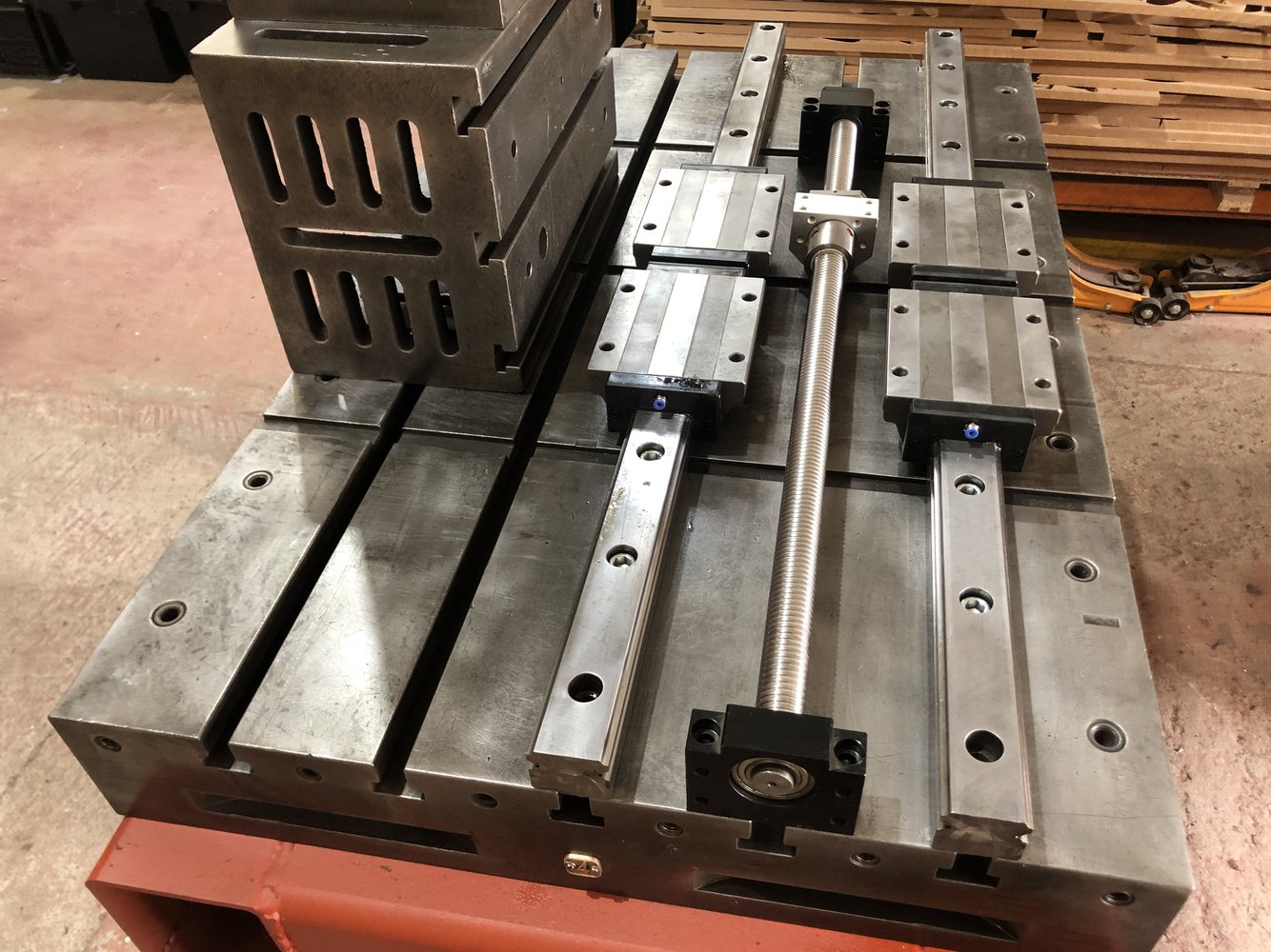

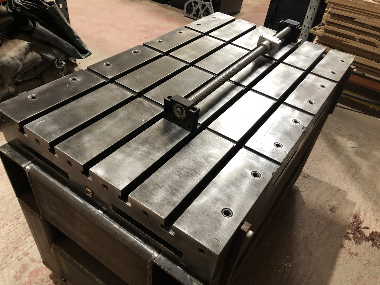

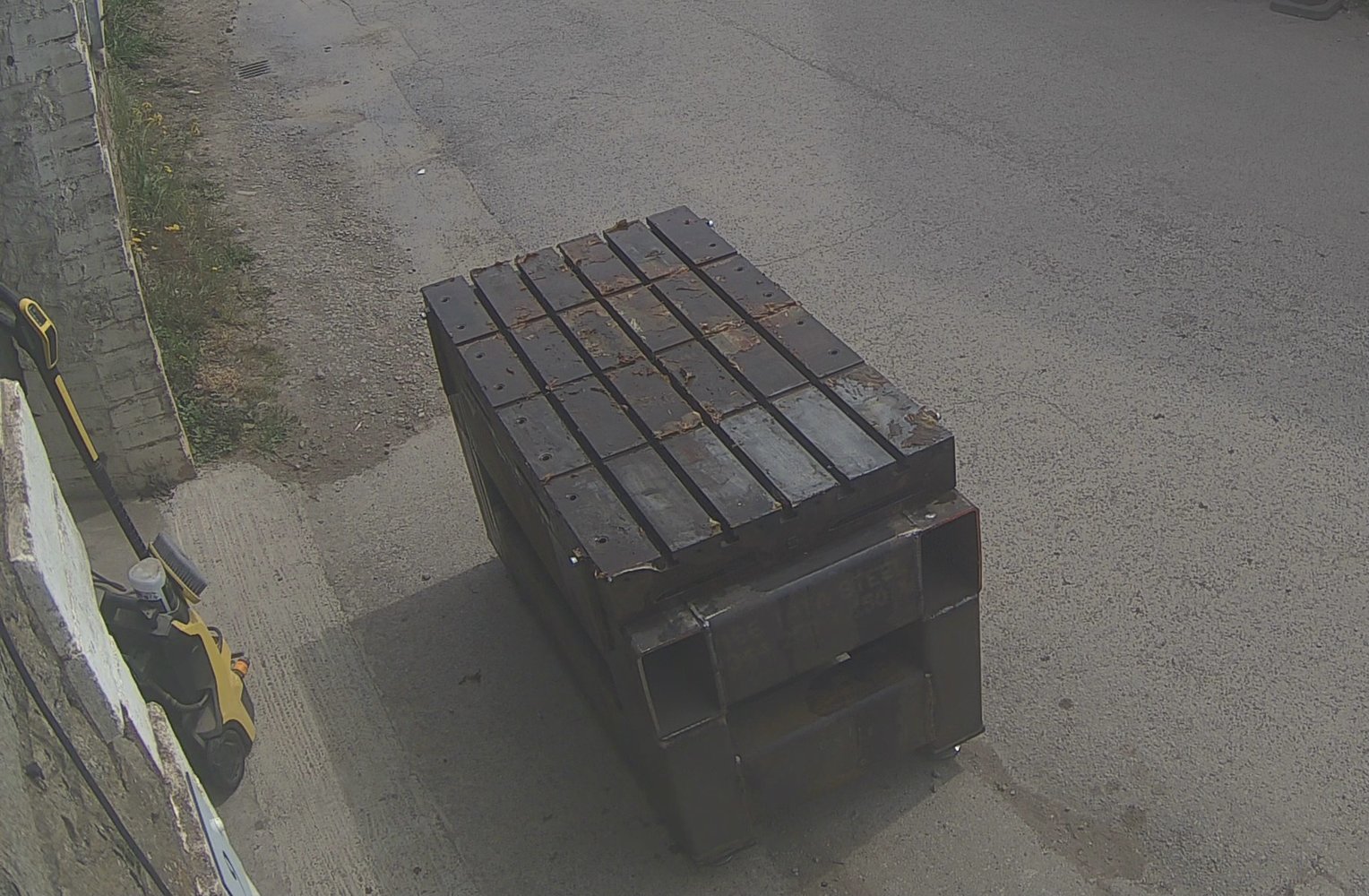

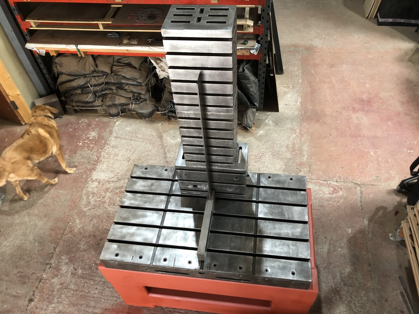

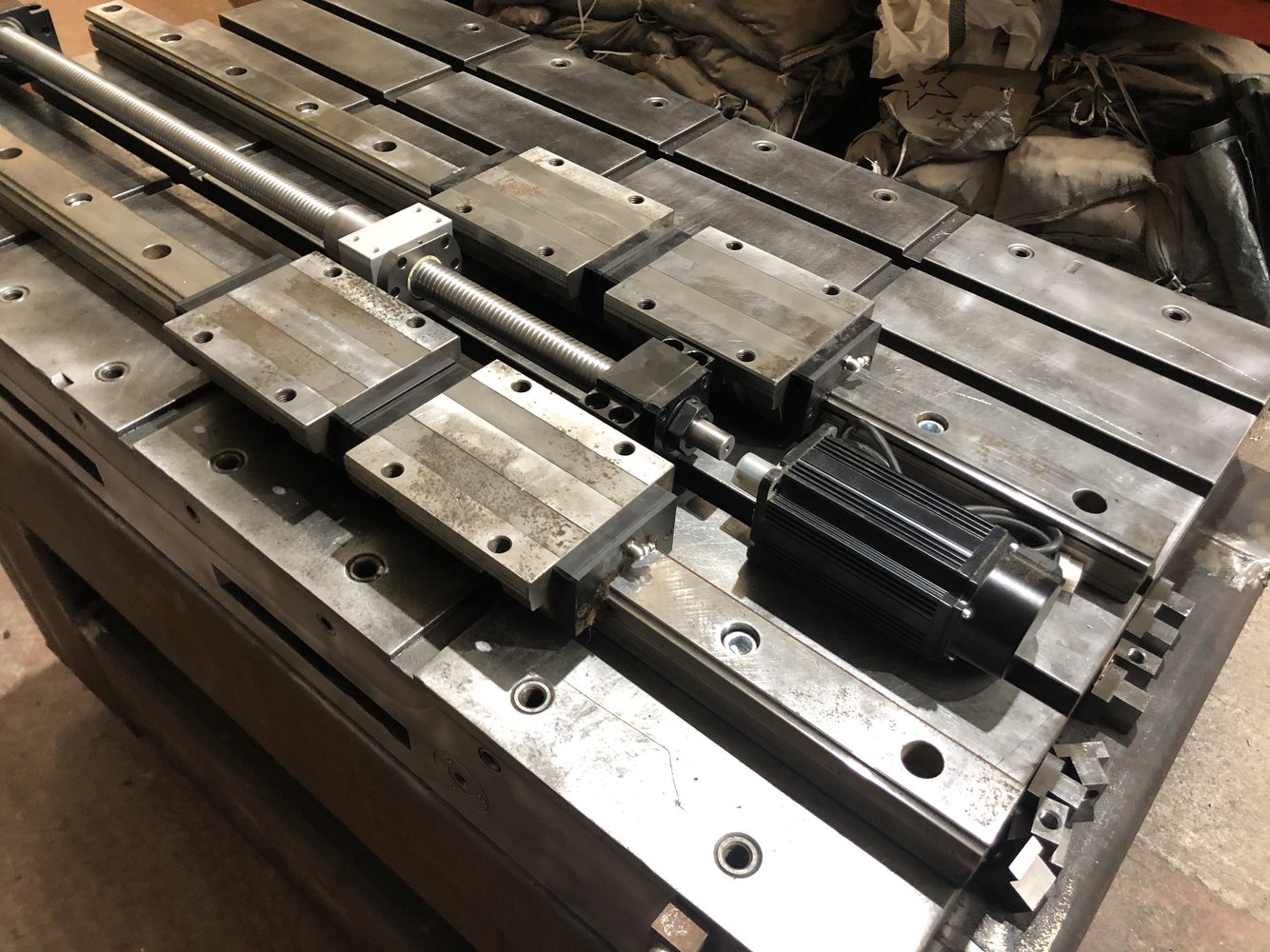

Did you just paint the evaporust on it? Rather than soaking overnight?Spent some time today cleaning up the T-slot plate.

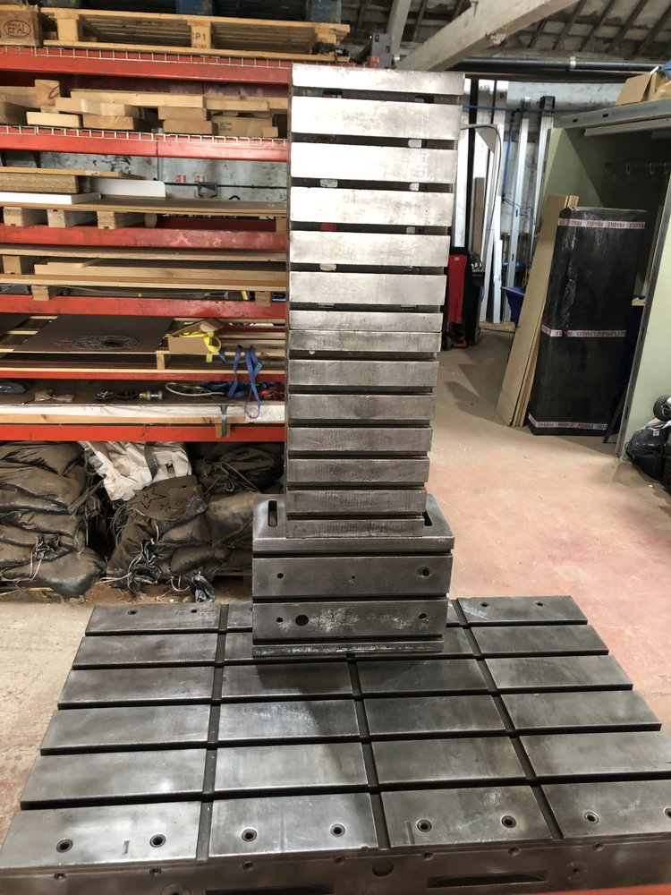

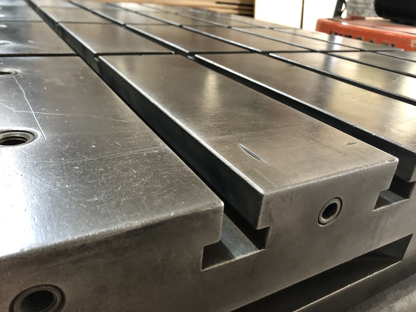

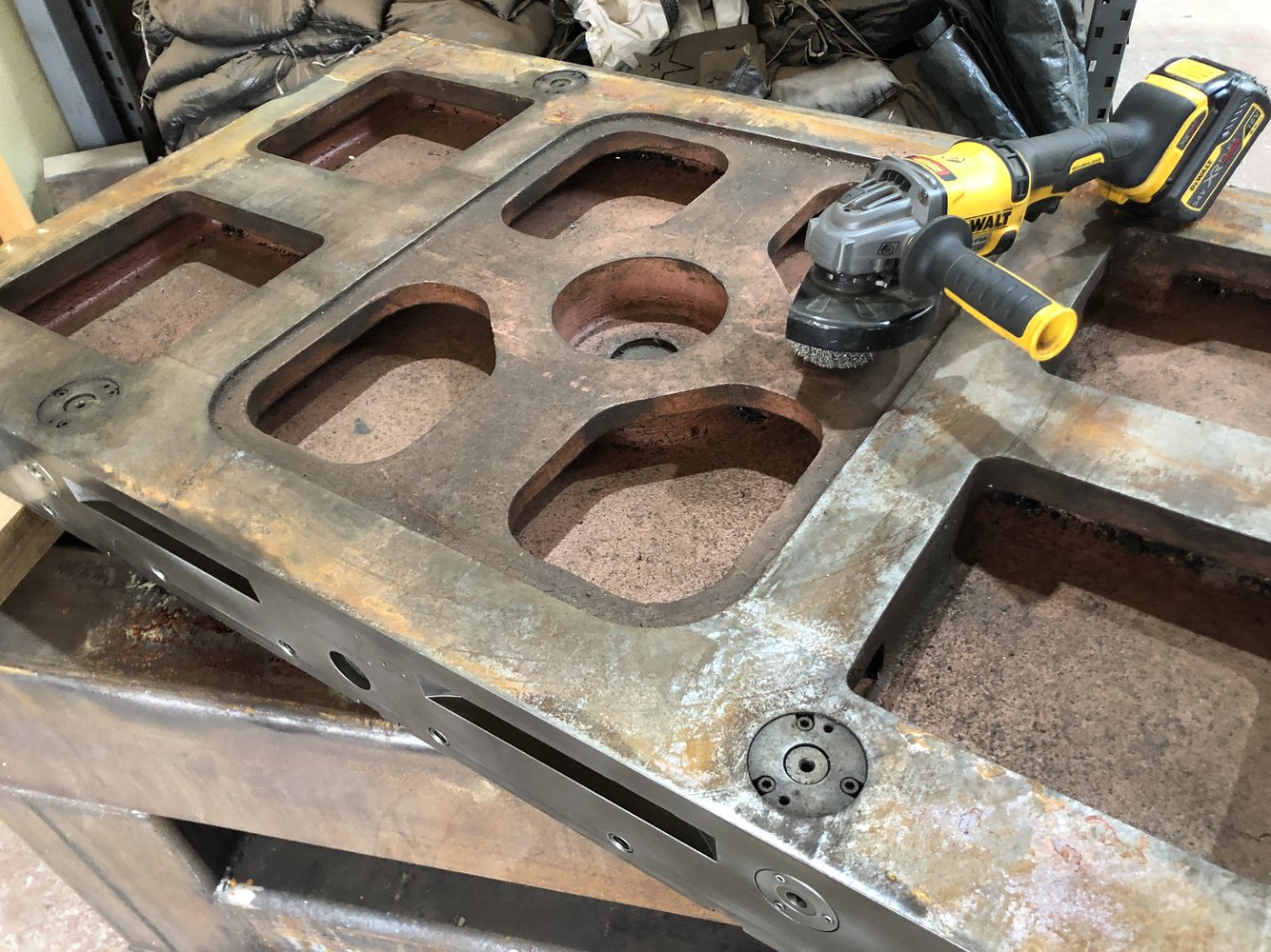

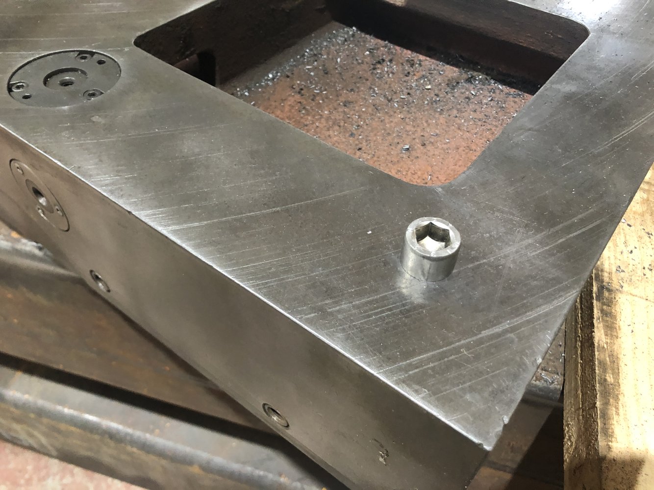

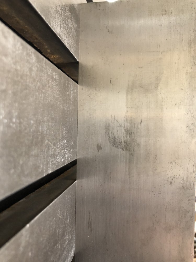

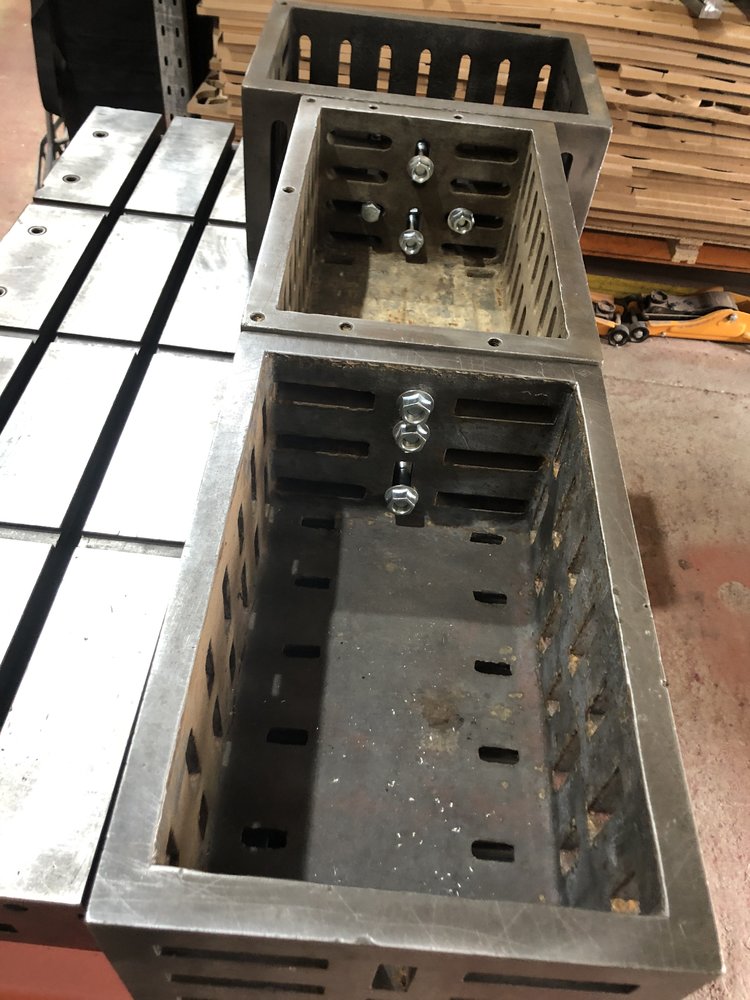

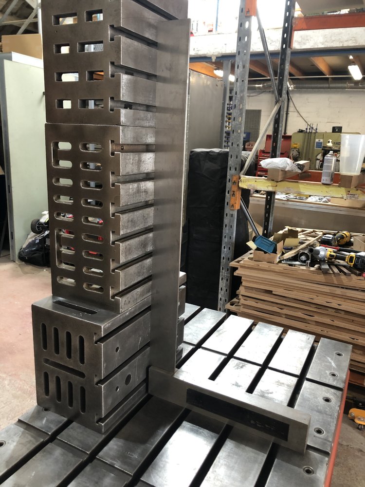

Left it overnight yesterday with some evaporust on it.
Jet washed it today and then went over it with a wire cup and some scotchbrite pads.
View attachment 345553View attachment 345554View attachment 345555View attachment 345556View attachment 345557
I followed the instructions that said to lay paper towels over it, soak them and cover them. I left it 24 hours.Did you just paint the evaporust on it? Rather than soaking overnight?
