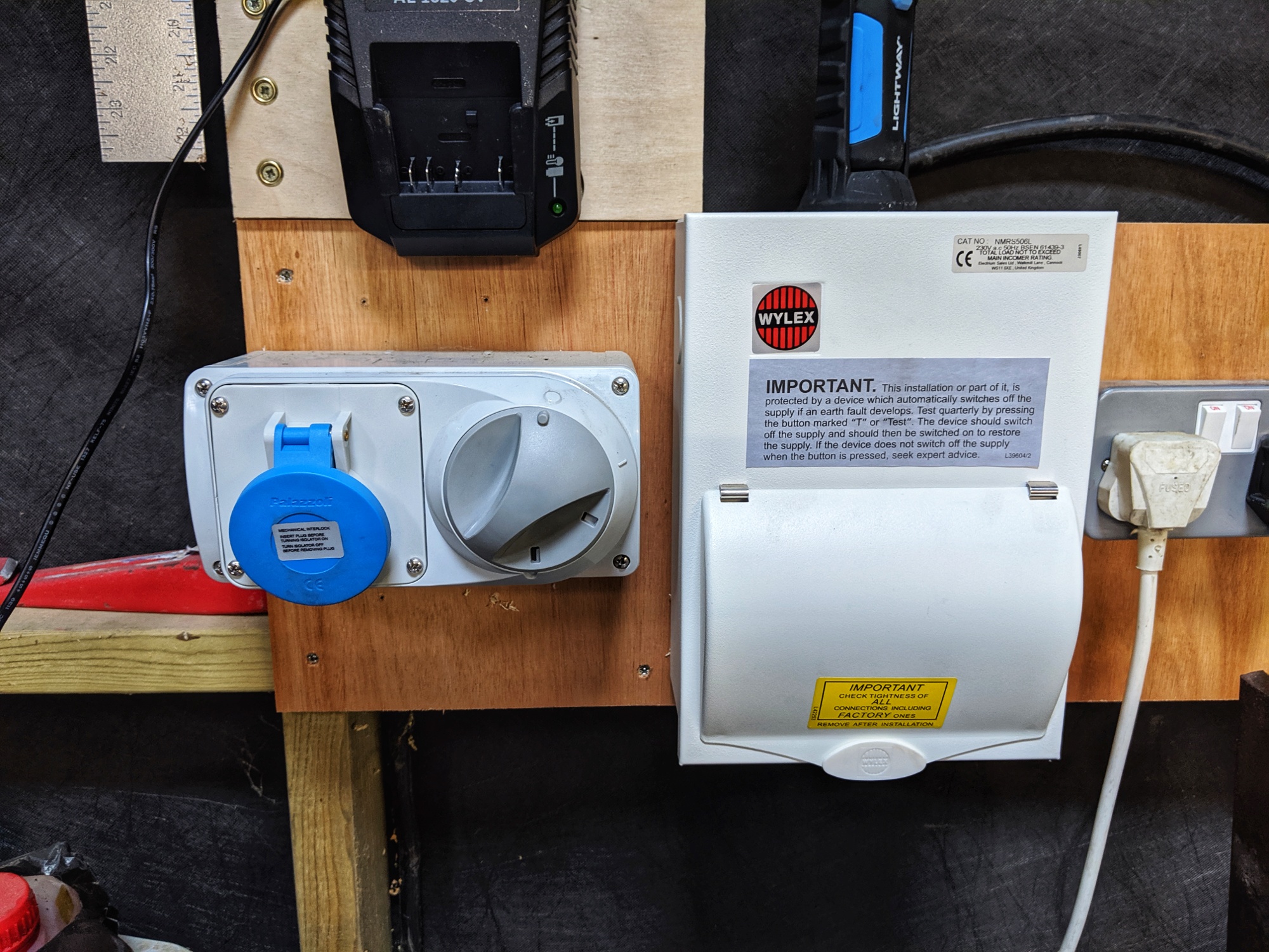

I can see your thinking now and I can see that the supply in the garage is the weak link. There's a 6mm2 32A cable from the house main consumer unit out to the garage but the cabling from the garage consumer unit to the 16A 'commando' socket right next to it is only 2.5mm2 - a short length of only 300mm at most. I think my first task will be to upgrade that from the 2.5mm to 4.0mm2...
If you can also change the power cord of the plasma itself should be great .
