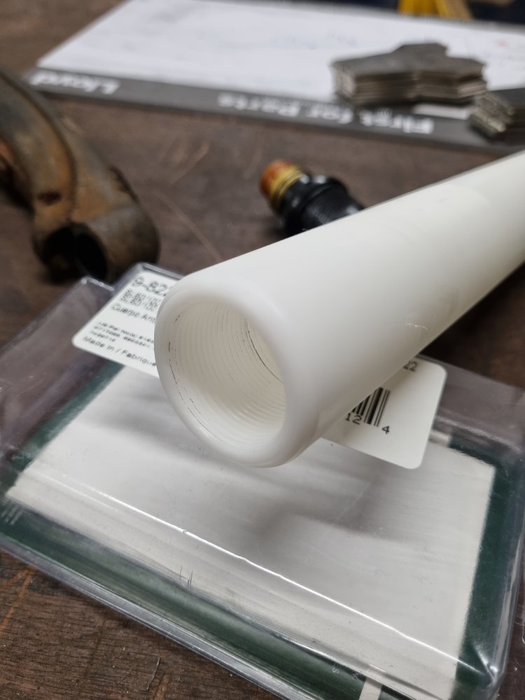

Does acetal engrave ok with the laser?

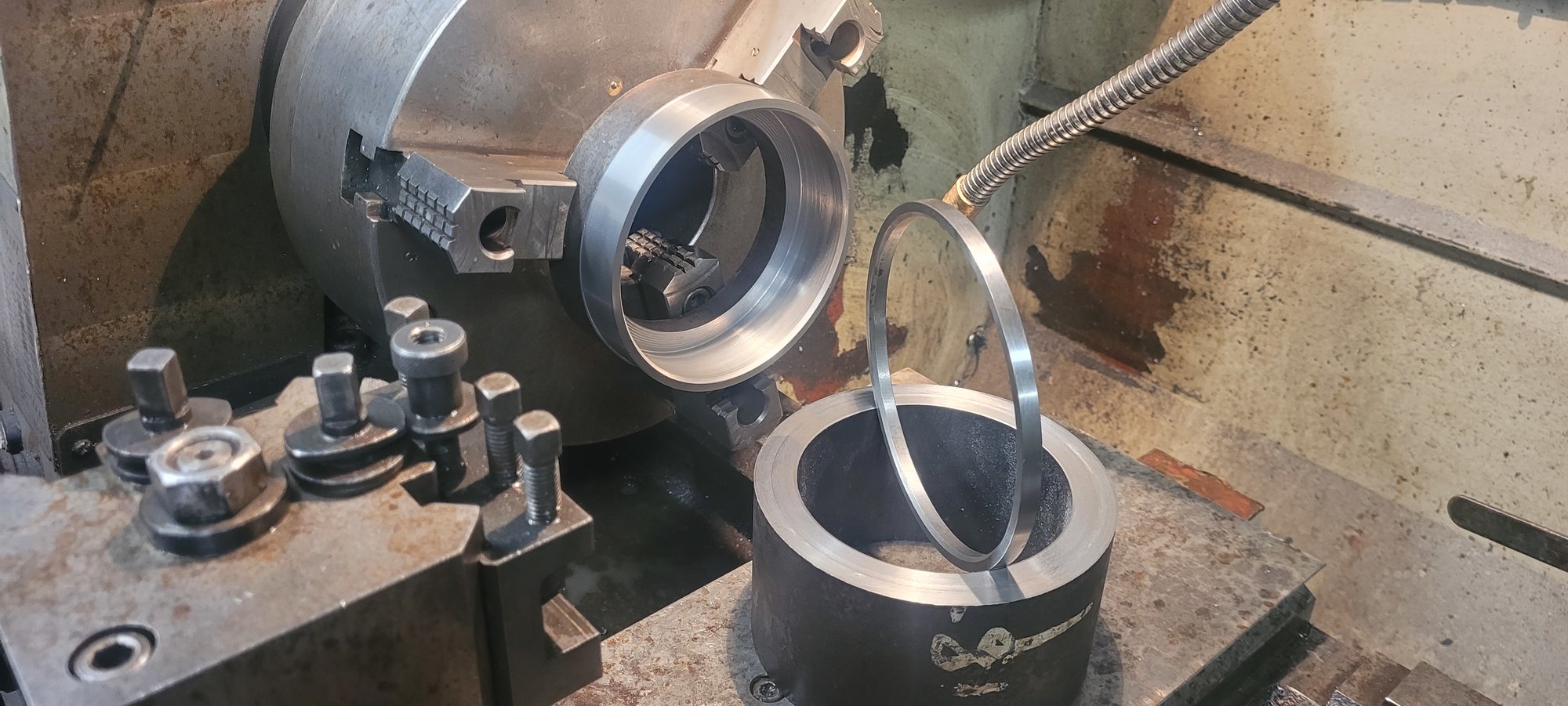

Finished the alu test piece. This has taken over a year!I was taking 0.5mm passes as somewhere said 0.2* diameter for slotting.
So on to the 316 stainless. Took me ages to get the cutter true. If my indicator is to be believed it was under 0.5μm of runout at the shank. 0.0005mm runout. Mitutoyo with 2μm divisions and the needle has just a slight wobble. I would have said that is impossible?! Was not bottomed out or sticking.
First cut I found forces much higher, it was jumpy. A longer handle was required. 0.25mm passes as 0.5mm was too much for it.

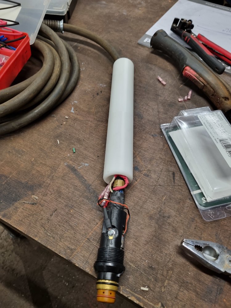

Yes, as long as you don't breathe in the fumesDoes acetal engrave ok with the laser?
Acetal stamp and the leather I tried it in.
Yes.So that's actually taking away most of the plastic leaving a small amount raised up in the shape you require?
What material are the sliders?
How do they black stainless steel?
AcetalWhat material are the sliders?
No idea but would like to find out.
Ah Ah that's why it engravedNo idea but would like to find out.
Acetal
I will run a 2.5m endmill along one side to split it.
