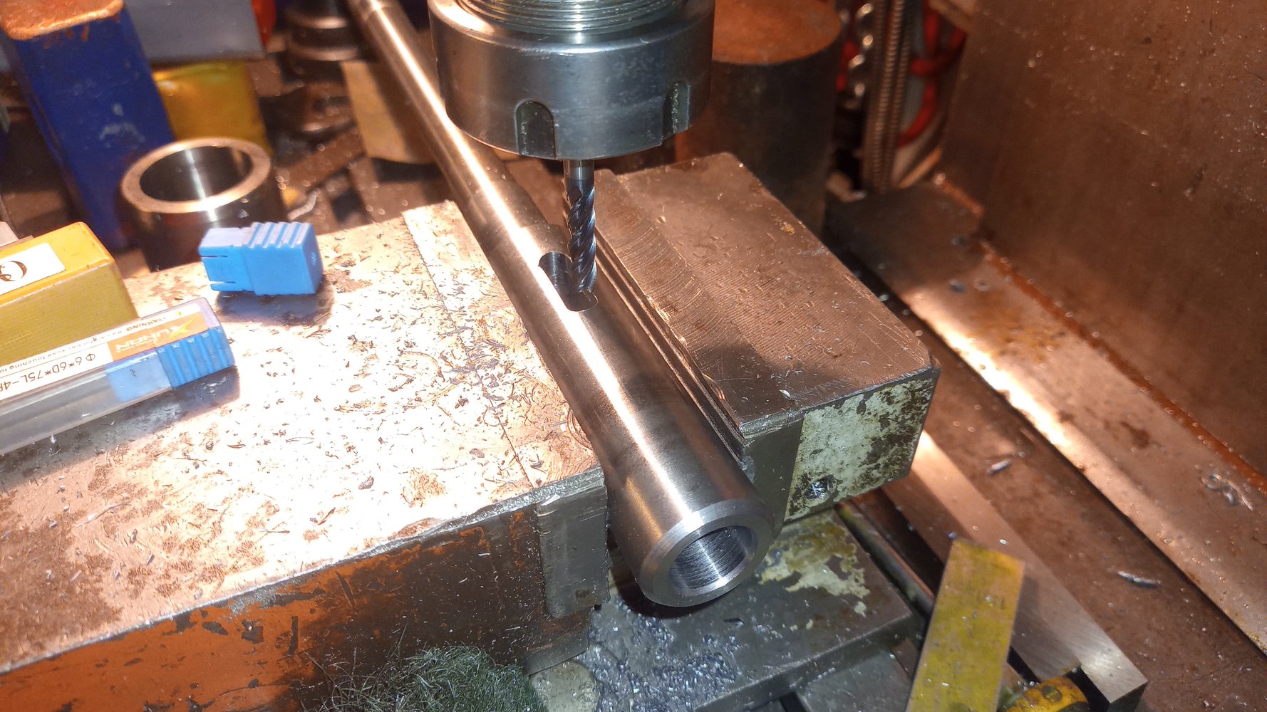

The problem is time.If you're doing similar sized jobs often enough to justify the time investment, it's fairly straightforward to make insertable trepanning tools inexpensively in-house.
There was a guy who goes to my local pub who recently retired from running a one man deep hole and trepanning shop, made all his own tooling from a particular style of carbide insert and heavy wall tube.
He did actually post some how-to videos before he retired, but I can't find them again right now.
The upshot was he would:
• get some tube of approximately the correct size,
• mill two or three flutes down the outside,
• let in a section to clamp indexable lathe tools with countersunk screws level with the top of the flutes (because it's cheaper to replace them if an insert breaks deep in a cut),
• then weld a cap on the back with a BSP 3/4 I tapped hole for coolant,
• weld a toolholder on, either a large square bar to clamp in the Toolpost, or an MT7 to fit the powered tailstock on a turret lathe,
• for really long jobs he had a additional fixed steadies on most of the lathes with the bearings at 90° to the normal orientation to support the tool whilst starting a cut.
I think the key information which I'm unable to remember is which insert geometry he'd found most reliable.
Most days he'd have 3-5 lathes running with automatic feed trips, slowly chomping away at big trepanning jobs, whilst he was doing finish boring ops on "the good lathe", making up new tooling, or doing office stuff...

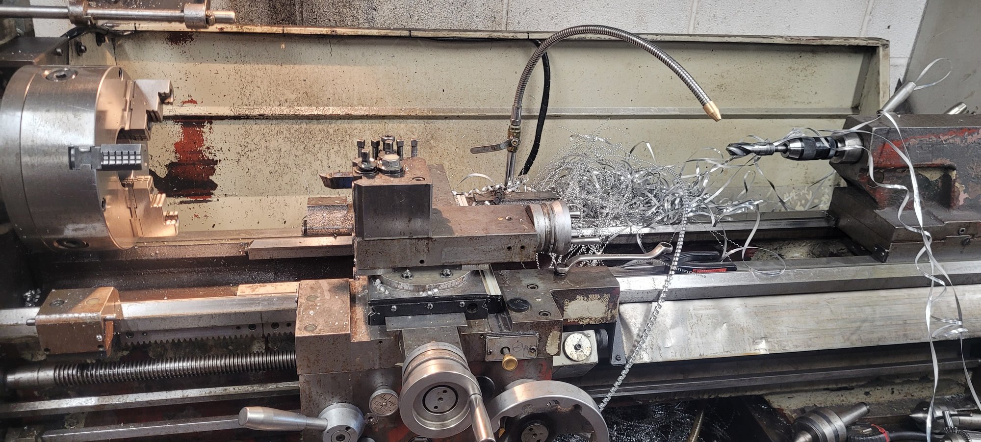

It's time consuming drilling and boring big holes. We do have a Spade drill for the big semi cnc lathe but i haven't figured out any of the programming side yet

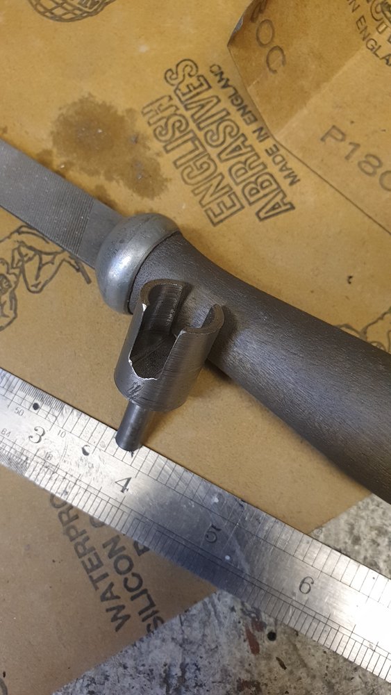

One of the model engineering suppliers used to sell cast iron bar - 17ton iron I think it was called, some years ago mind. I can't remember the supplier though..When I worked in the machine shop one job was 6” diameter locking rings, 5 1/2” bore, acme thread, from 316 stainless. I used a trepanning tool, like a parting off tool but curved for clearance, and cut the centre out of each piece. They were maybe an inch thick and it cut okay.
First dozen or so I went halfway in from each side, but it was time consuming, so I tried a single cut straight through from one side, until I could feel it getting towards the end, compound slide would suddenly get easier to turn, and I’d back out before it came loose and locked up. Then I’d knock the centre out with a hammer. Then we had freebie chunks of 316 stainless for some other jobs.
