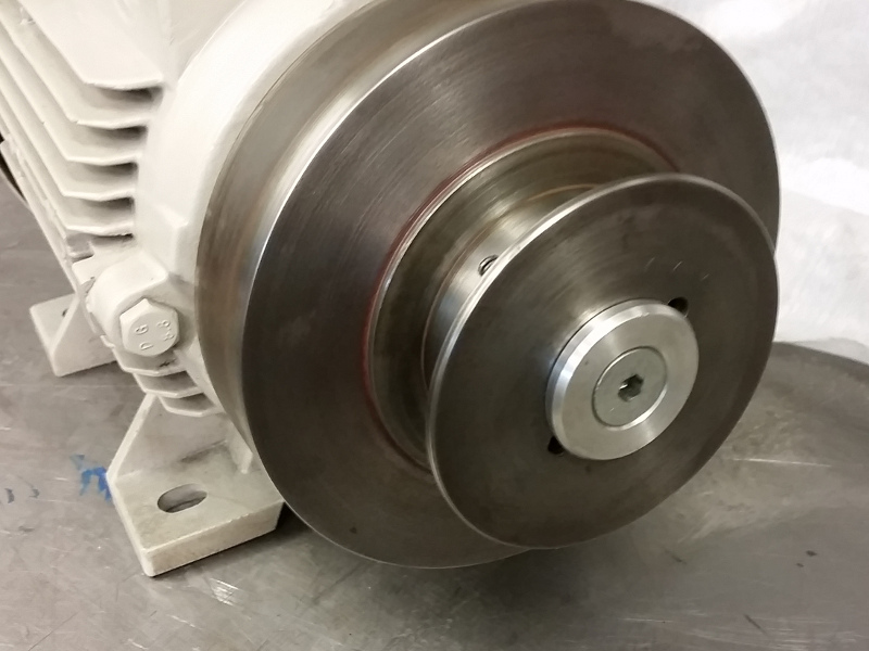

I wend direct to the spindle so the gearing for feeds etc are still in play.You bypassed the headstock gears altogether ?
You will have to put up a thread on that conversion, my colchester is like a bag of spanners.

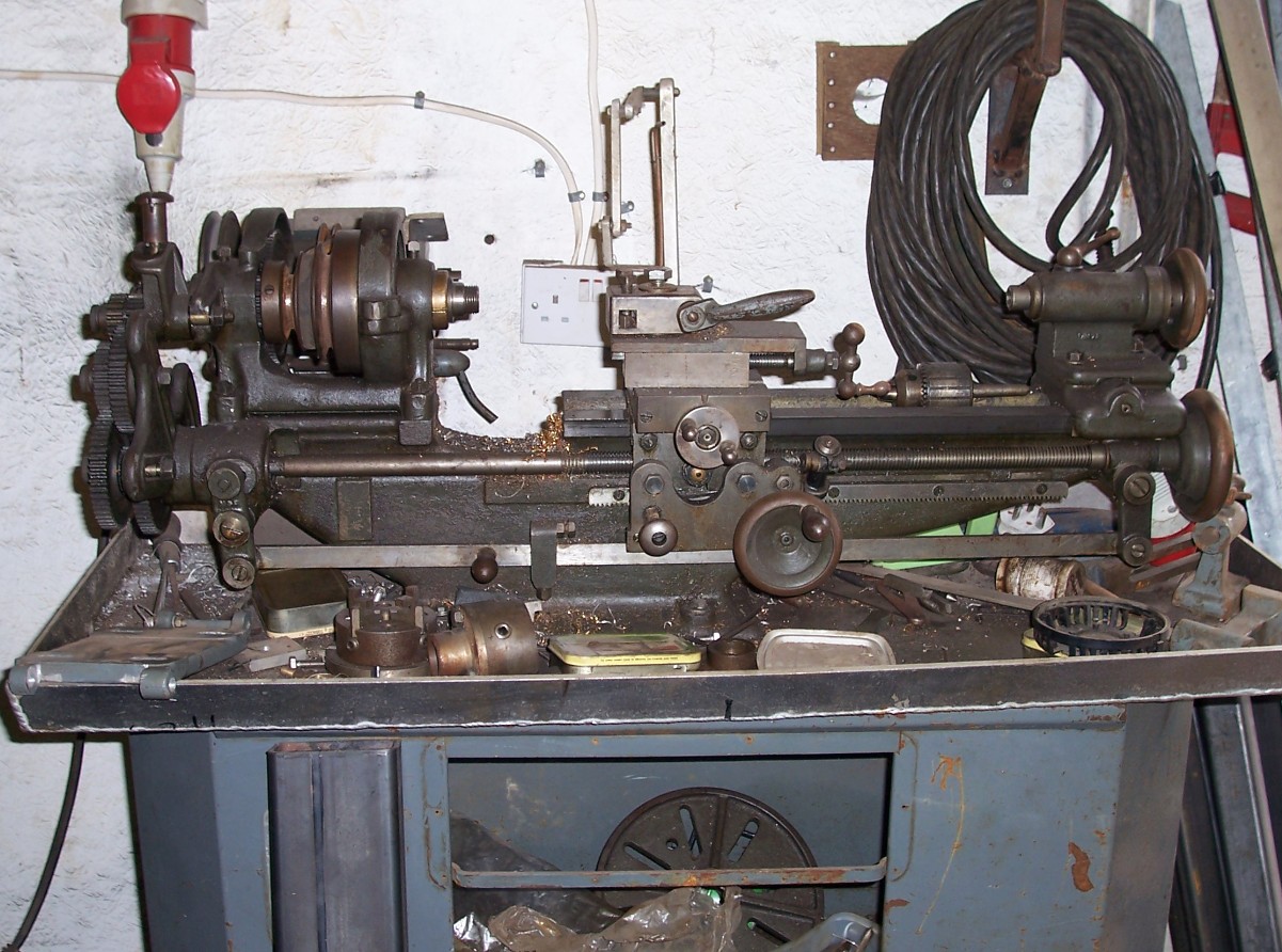

I could almost have put it in the Churchill and used it as live toolingA Drummond Type M. My dad had one. You could put it in the Triumph and turn it down to Unimat size![]()

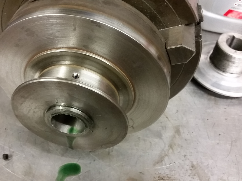

Making an ER32 backplate. Could have drilled and bored the ID but wanted to try holesaw on a 50mm thick part. It works, went 30mm deep on the first side then flipped. Quite slow because of chip clearance having to peck drill. I did not use a pilot as I want the centre for another part.
