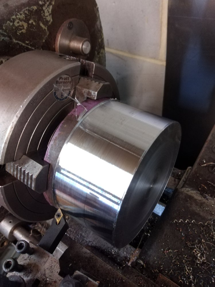

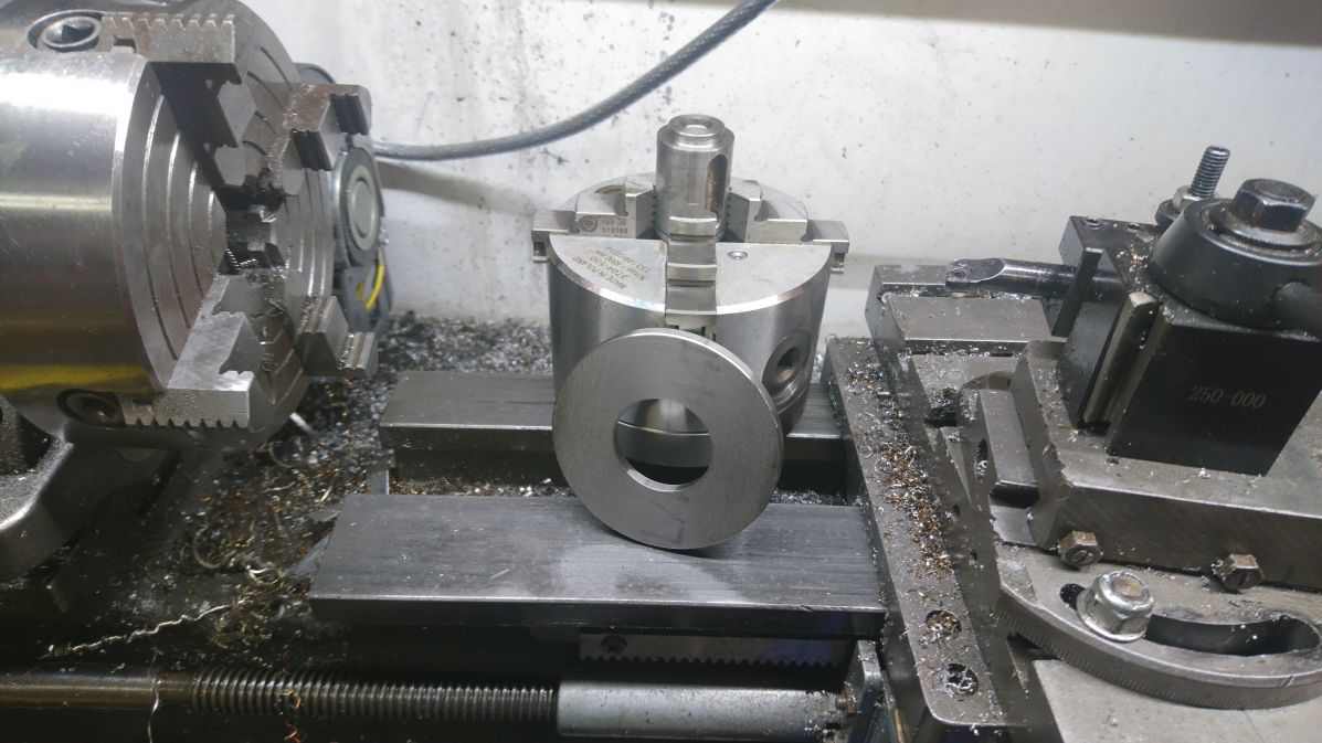

Behave Johnny , lolMade some En36b shavings. 8mm drill for scale. 8mm on diameter off per pass. Pity I didn’t have a stronger leadscrew or a Cnc lathe or I could take bigger cuts
Doesnt even feel it. Reckon I try 10mm next time
View attachment 345046 View attachment 345047
No coolant in first pic and the chips dont look like they got that hot? , I normally see mine go a blue or yellow typeMade some En36b shavings. 8mm drill for scale. 8mm on the diameter taken off per pass. Pity I didn’t have a stronger leadscrew or a Cnc lathe or I could take bigger cuts
so it just had the bulk bashed off of it. No finesse…

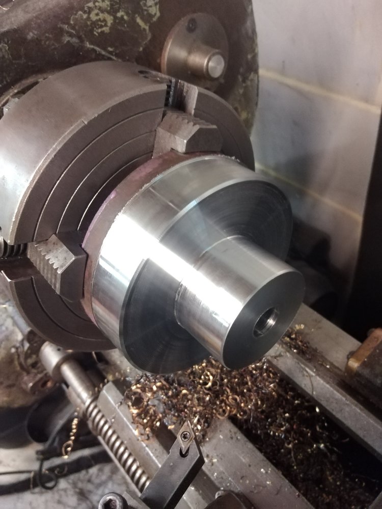

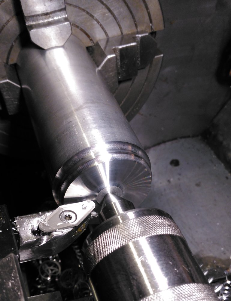

Dear god. But then the cost of fuel and electric has doubled. Must cost a fortune running their furnaces/auto clavesFinish turned the spigot shaft blank after it came back from stress relieving . £120 plus vat I saw as excessive as the last one in December 2019 was £69. Same company

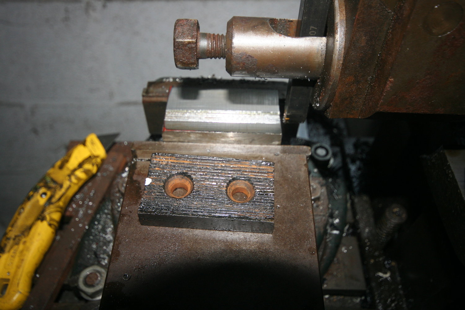

I'm not sure if it's the camera angle, but that cutter looks shot.
