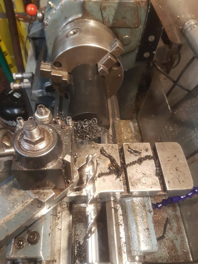

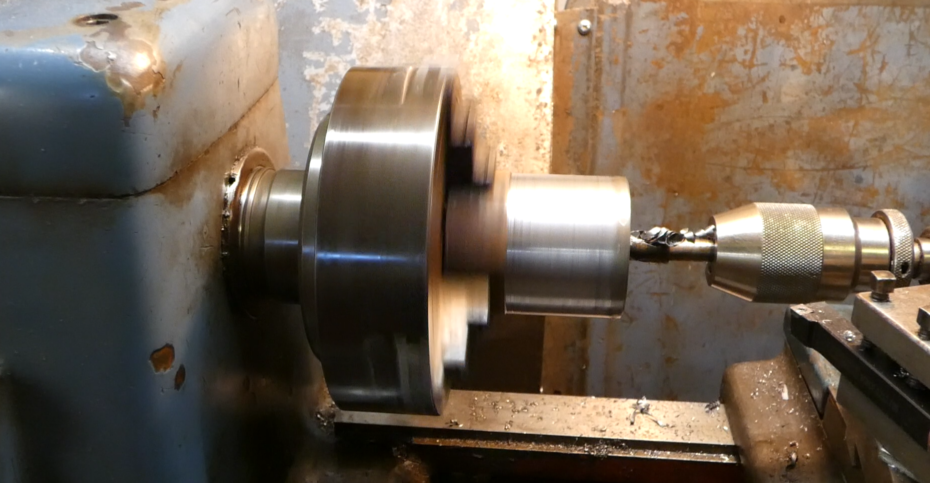

I usually drill the hole before I bore the centre, or I used to before I had broaches and BFHA bit of a tweak with the cutting and relief angles would improve that a lot. What you can also do is turn a spigot to go into the bore,then drill a suitable sized hole half in the pulley,half in the spigot. Makes it a lot easier to get the keyway in as alot of material is removed before you start slotting![]()
