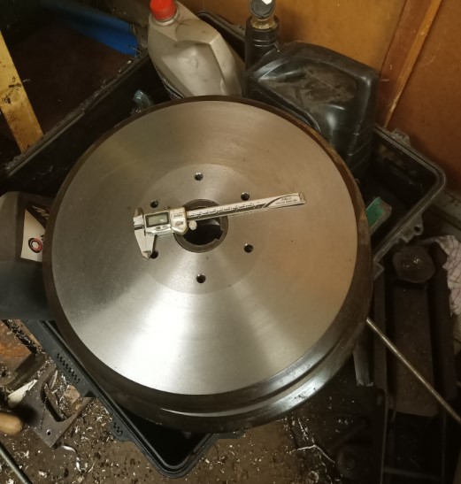

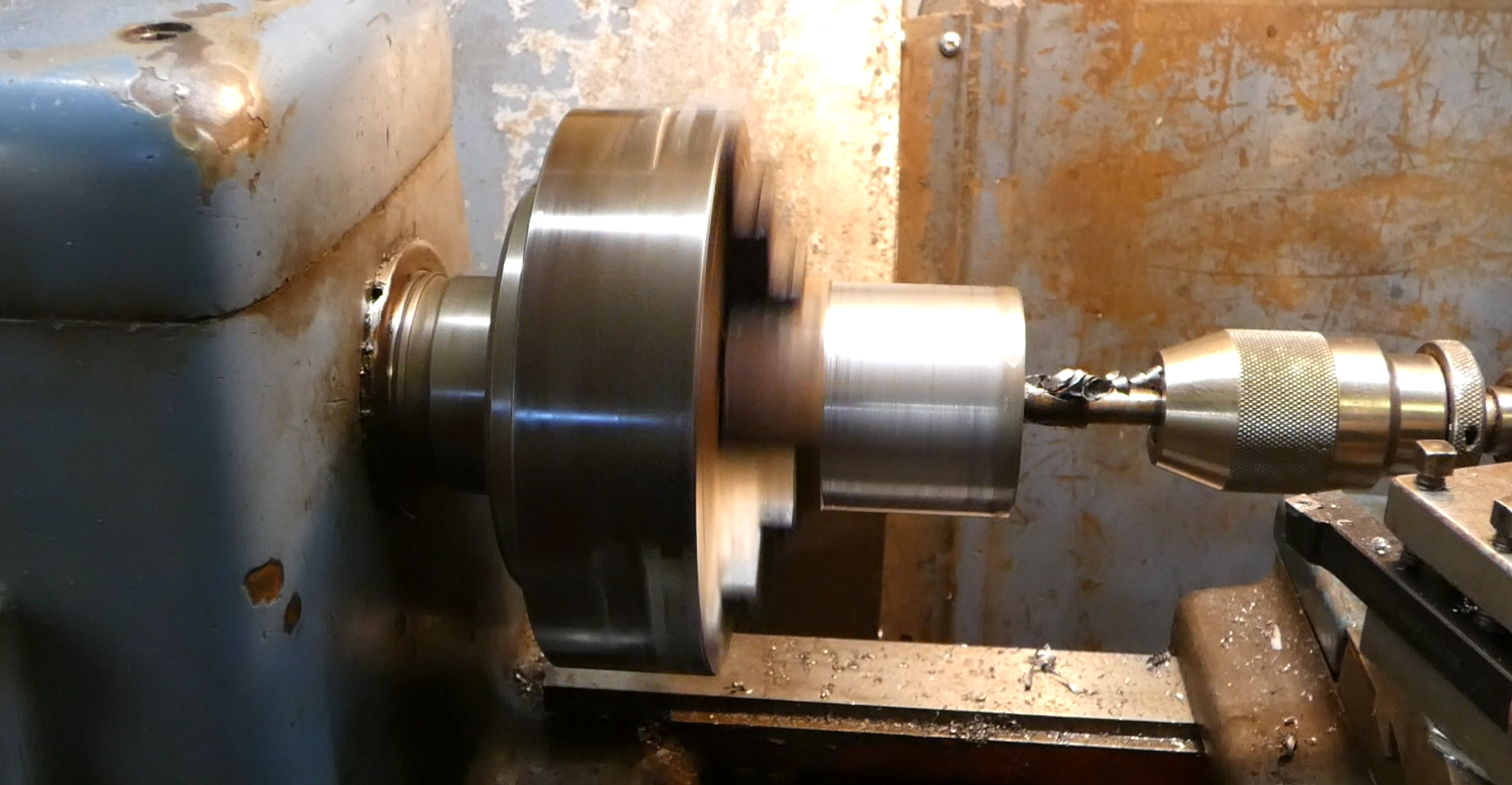

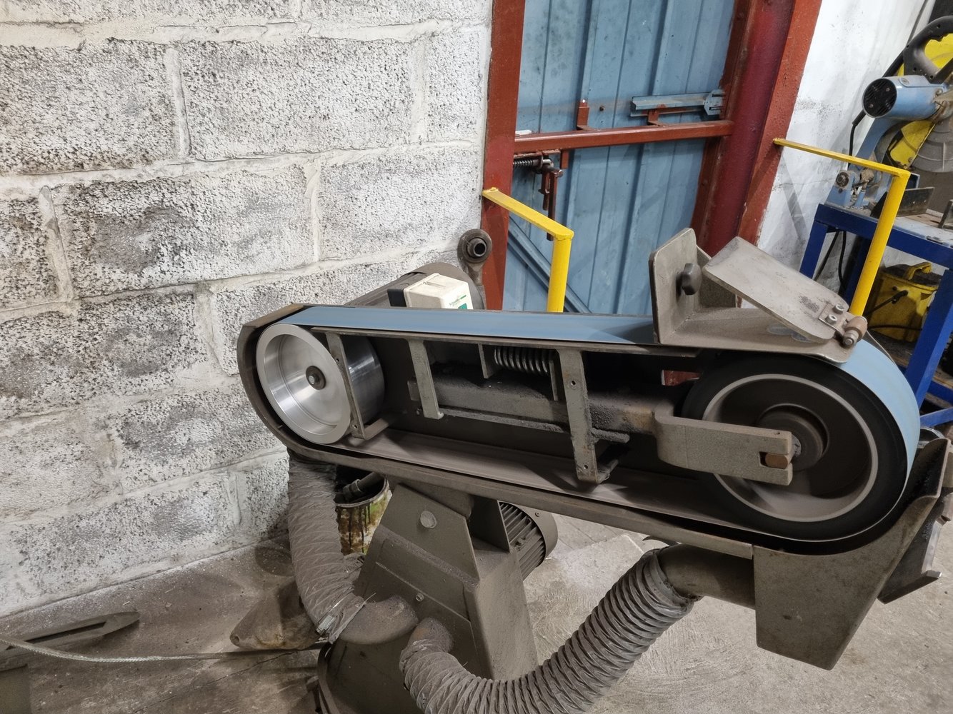

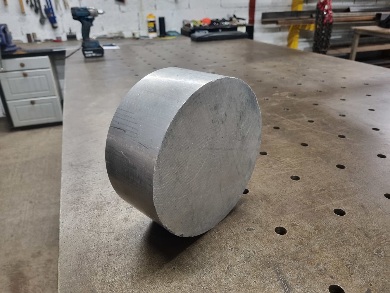

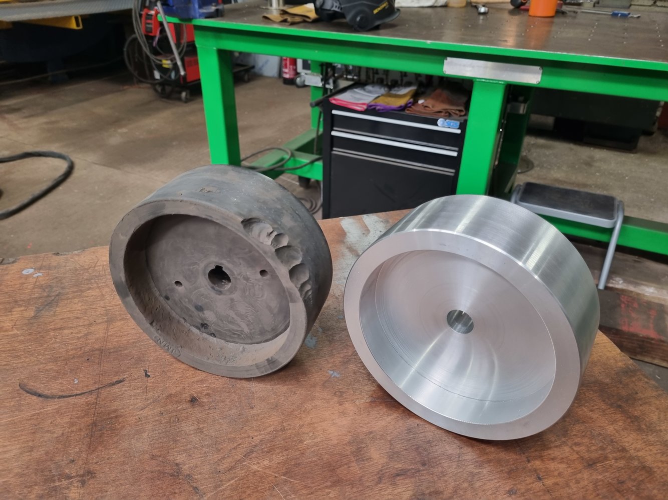

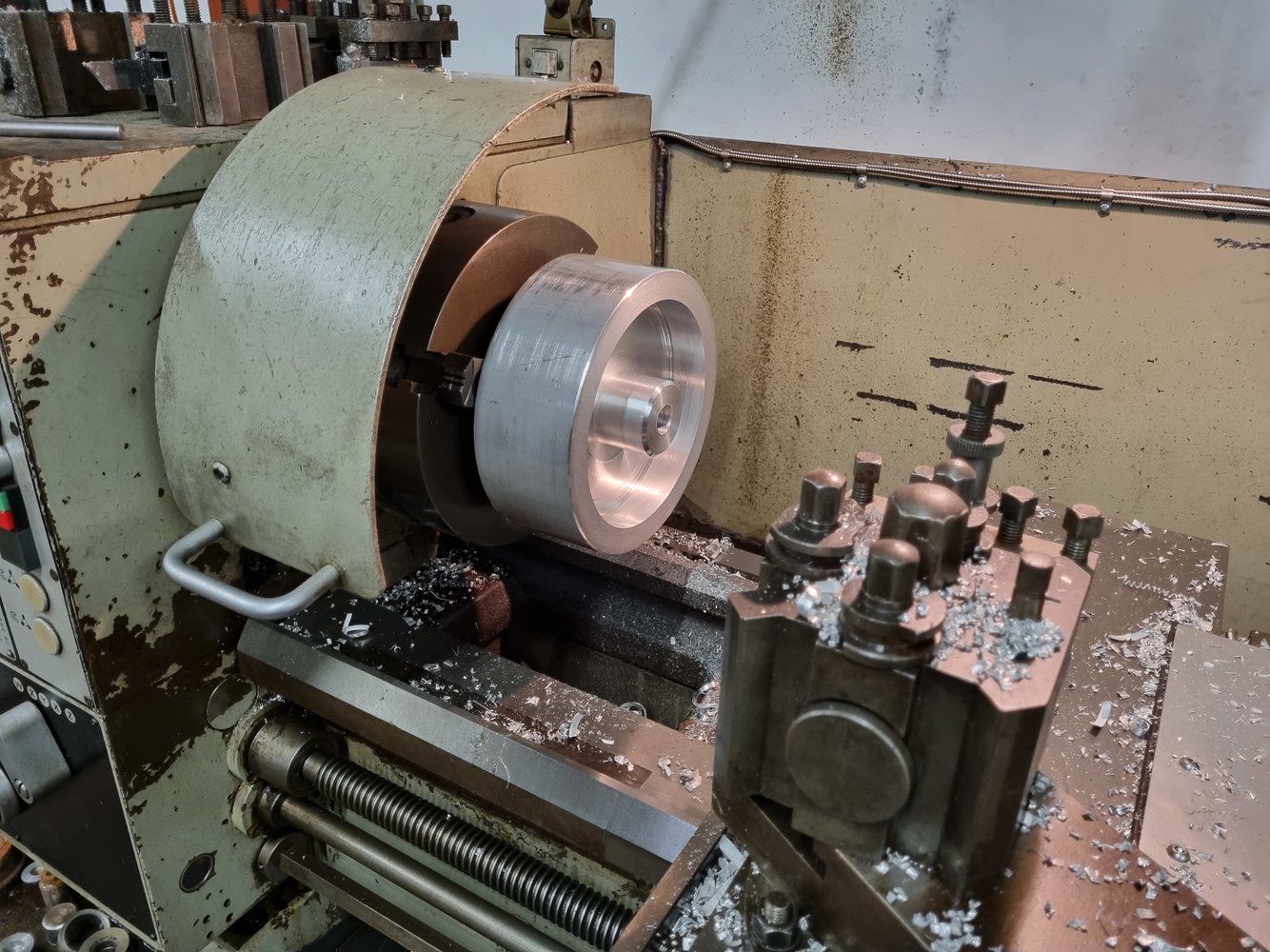

Replacement wheel for my belt grinder drive wheel which cracked. JEI wanted £340 for a new plastic one! Spent £100 on the lump of ally and about 8 hours of my time.

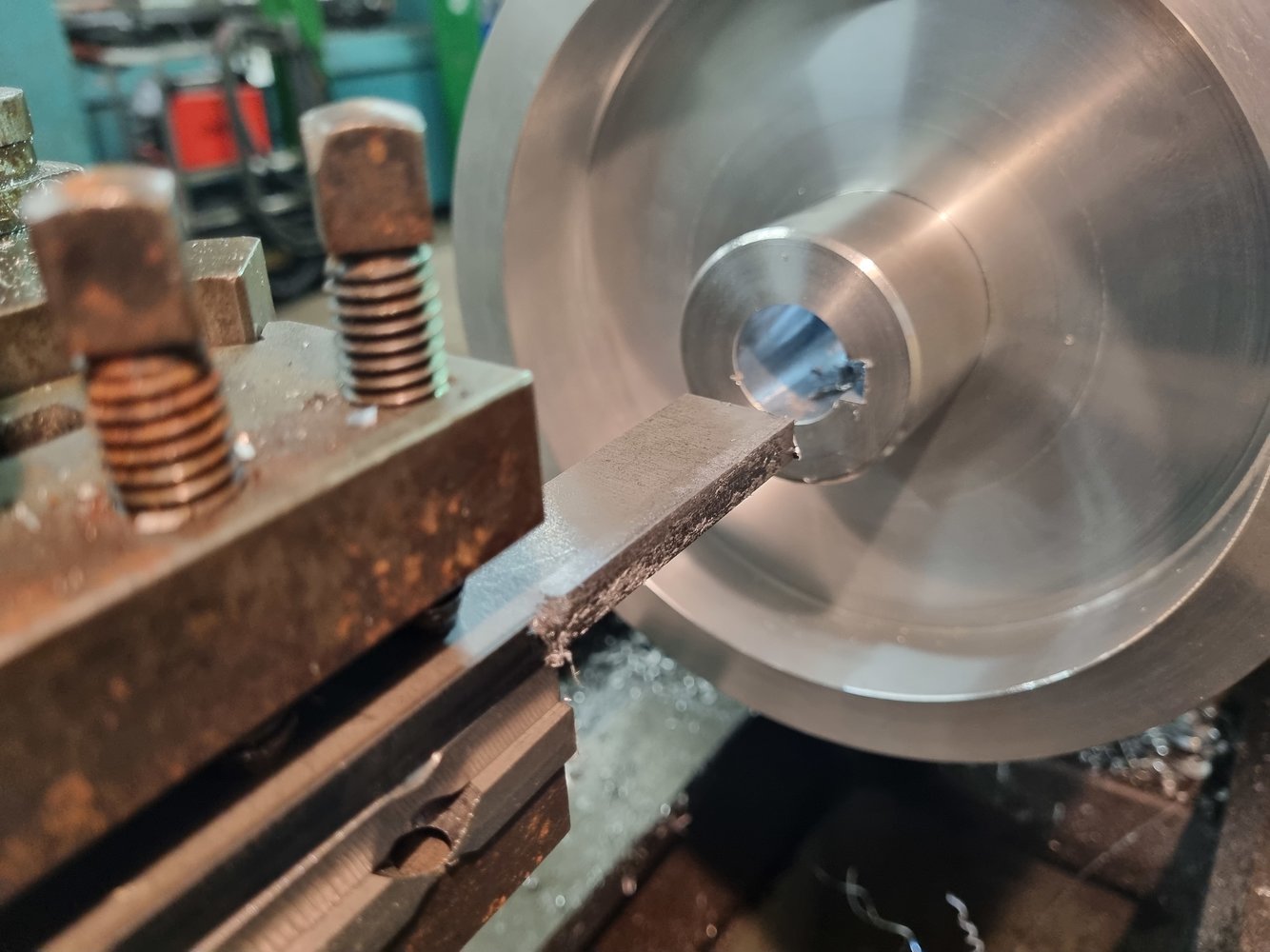

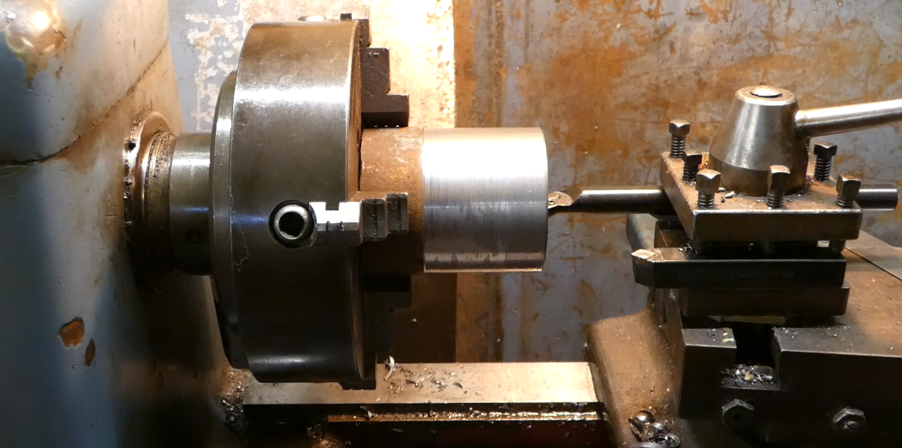

Just some mild steelI Like the key cutting on the lathe , just a bit of HSS there and back and forth action? .
it's a bit rough on the lathe saddle though even for aluminium, i wouldn't want to cut steel that way.Ah smart then you only cut the edges into squares rather than remove all material, Bit like when you drill a hole and sit chuffing away with a file to try and square it up.A bit of a tweak with the cutting and relief angles would improve that a lot. What you can also do is turn a spigot to go into the bore,then drill a suitable sized hole half in the pulley,half in the spigot. Makes it a lot easier to get the keyway in as alot of material is removed before you start slotting![]()
I usually drill the hole before I bore the centre, or I used to before I had broaches and BFHA bit of a tweak with the cutting and relief angles would improve that a lot. What you can also do is turn a spigot to go into the bore,then drill a suitable sized hole half in the pulley,half in the spigot. Makes it a lot easier to get the keyway in as alot of material is removed before you start slotting![]()

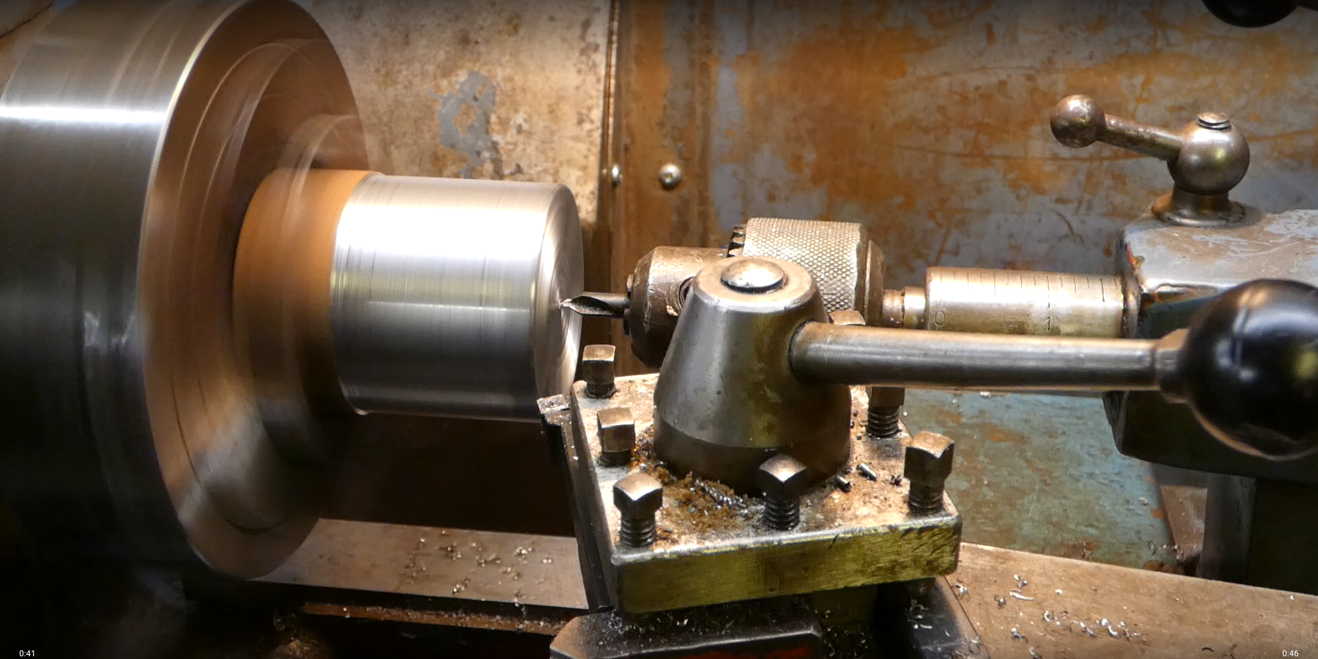

which is something I have not done in years! I even caught it on video!I did tge same last week, I can't remember when I last broke one either. Whacked a carbide end mill in the chuck and soon had it sorted.I did a bit more on my ER32 chuck. I managed to break a centre drillwhich is something I have not done in years! I even caught it on video!

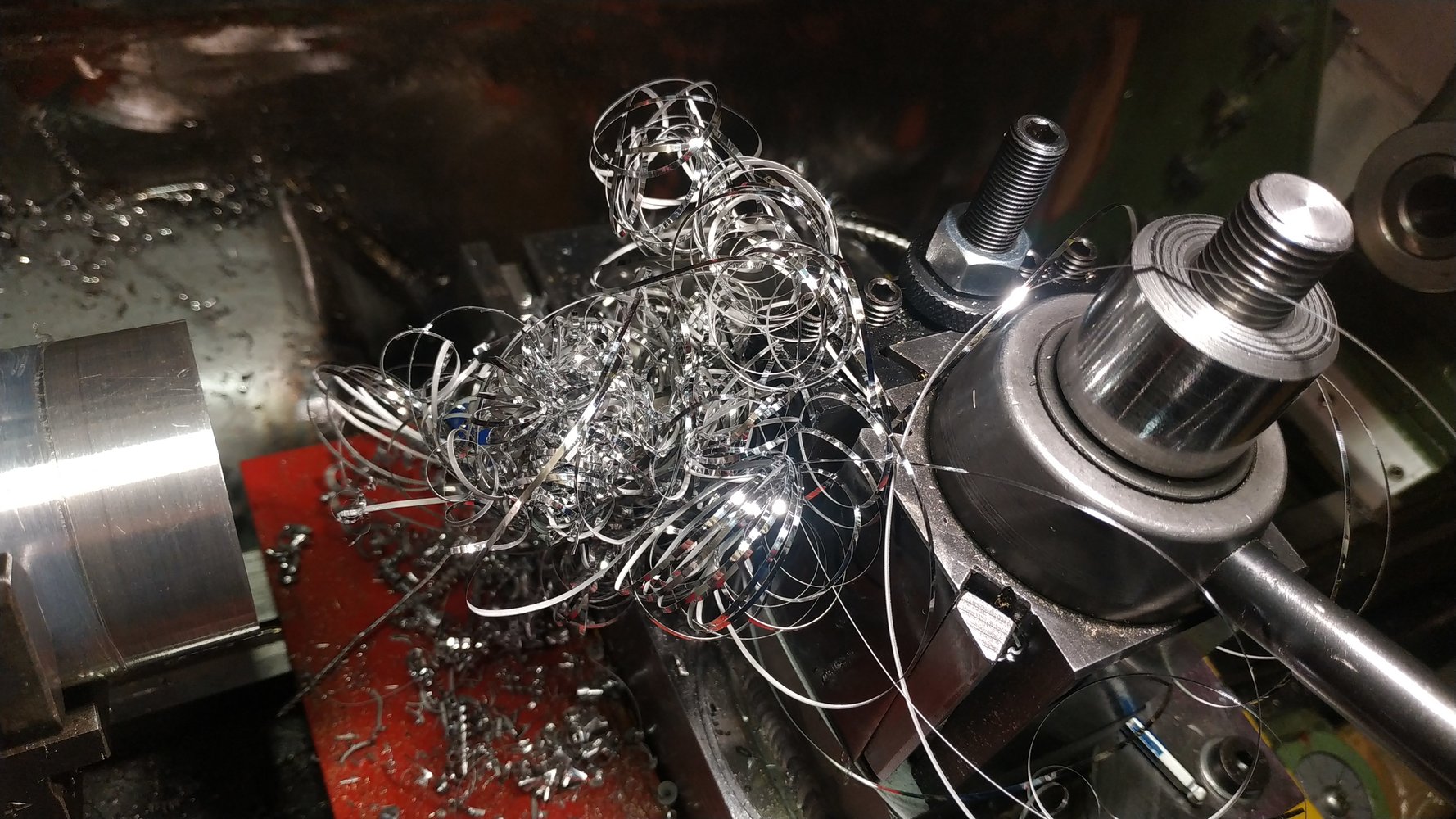

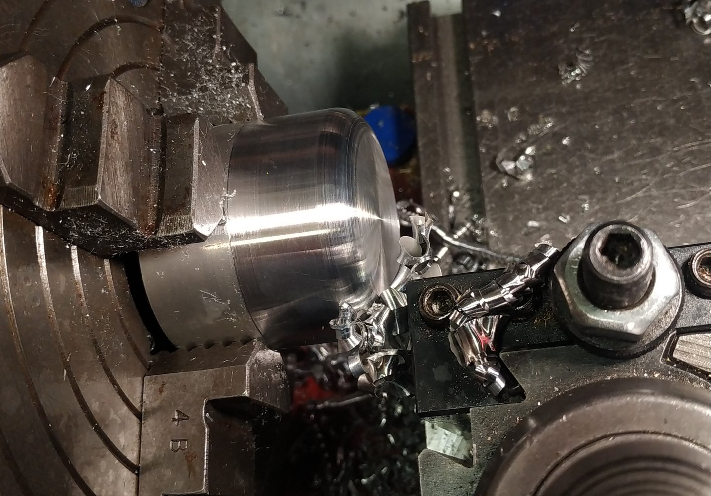

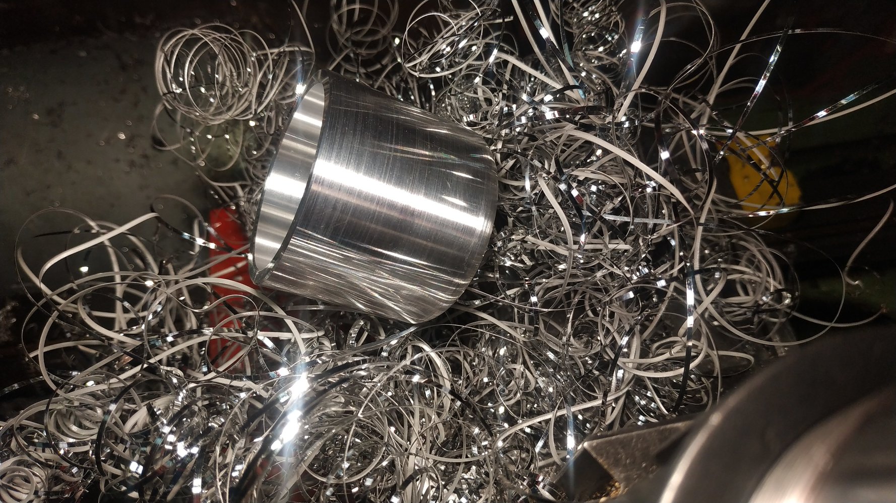

They are for CNC, the major difference is that a CNC machine can push the edge in to the work a lot better than a manual lathe can, also try and get a bigger chip as the bigger the chip the more heat it takes away therefore the less coolant you lose and the more stable the part, better surface finish etc.Remember those speed and feed tables are usually generated specifically for CNC production speeds. As Hood says, you don't need speed necessarily to break chips, just an adequate DOC and good feed rate for the insert...
