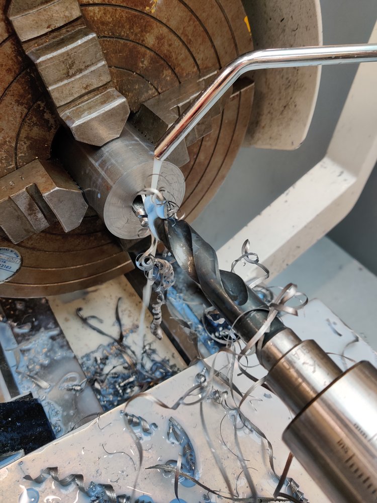

Or worseoooh aaah ouch eeee as the blue hot chips fall down your collar![]()

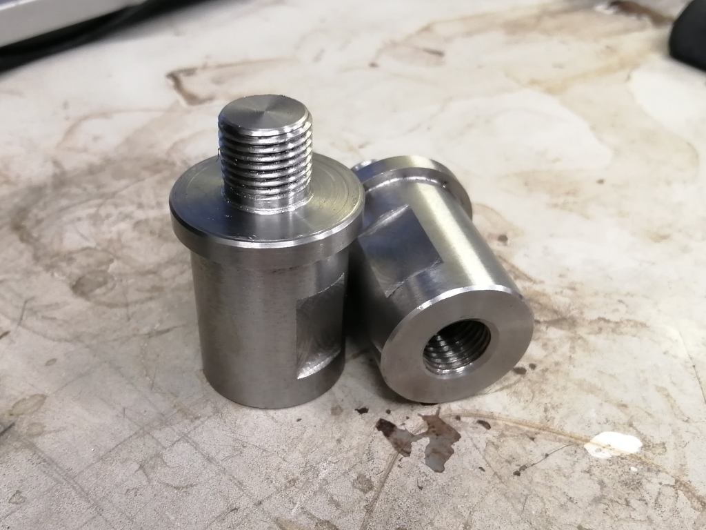

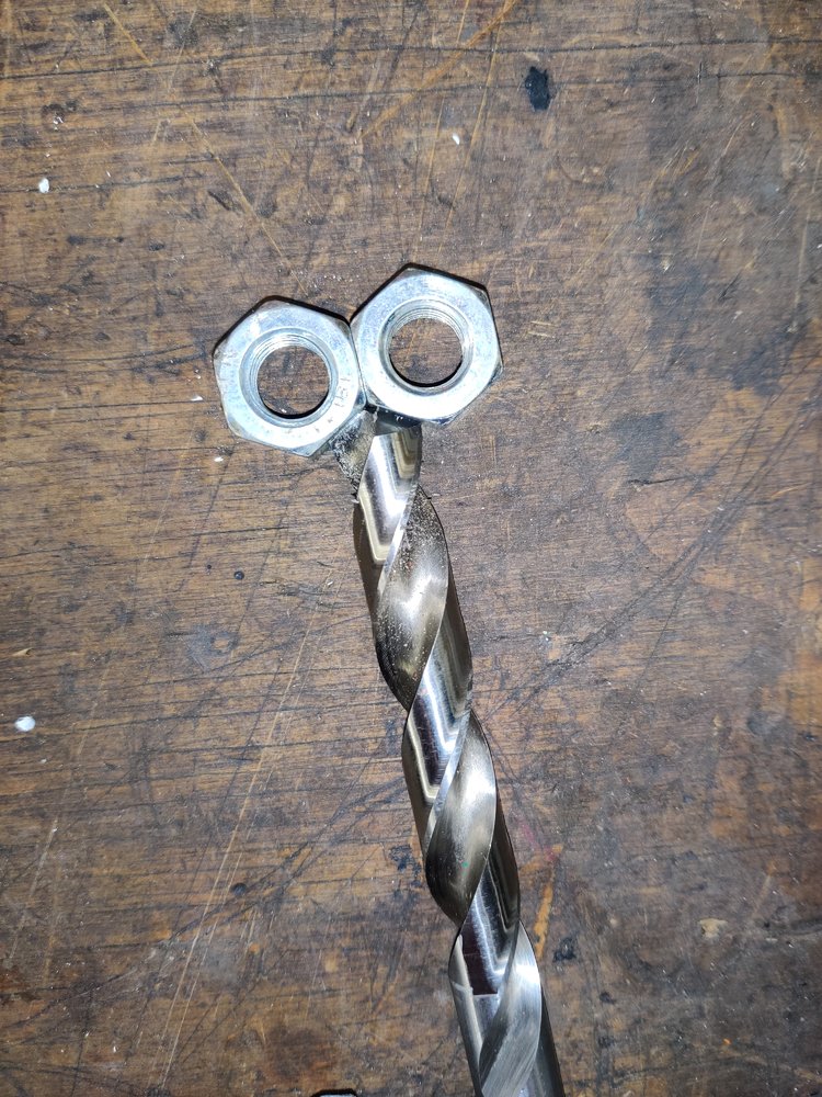

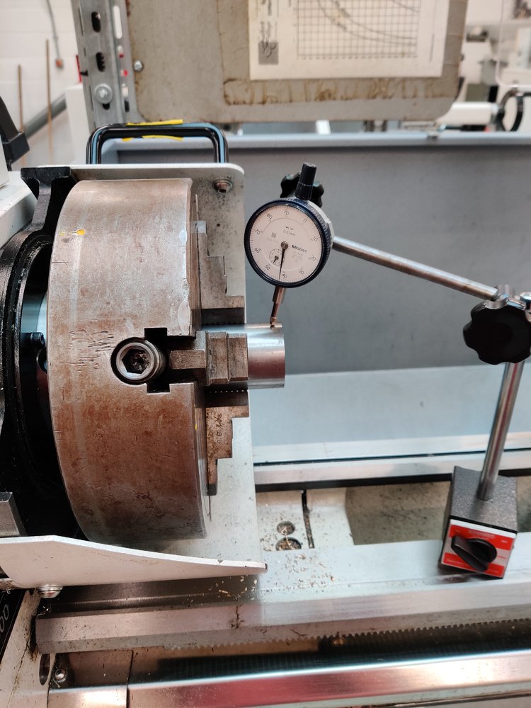

can you explain the two nuts trick ,no pun intendedMaking a die holder at the moment for a training piece

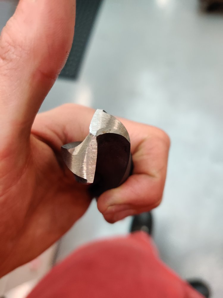

The lecturer liked my two nuts together trick for how to sharpen drill bits that works on big or small ones just as good
Still getting better at the sharpening as I go but Intresting doing it on 24mm drills not the 10mm or so I'm used to doing
So does carbide if you are doing hard steel.Ceramics spray red hot chips
thats perfect , thanksSure , quite simply just put two nuts or bolts and any hex together to get your rough angle for grinding a drill bit in
So when I am grinding and think the grind on the bit is quite hold up to two nuts and can hold up to a light to see if the grind if flat and the same on both sides at the 120° angle that you want for standard drilling
Just keeps you right as you sharpen probably not done in million pound CNC machine shops lol but works for the home shop learning to sharpen drills and if you don't enough you won't need the nuts anymore

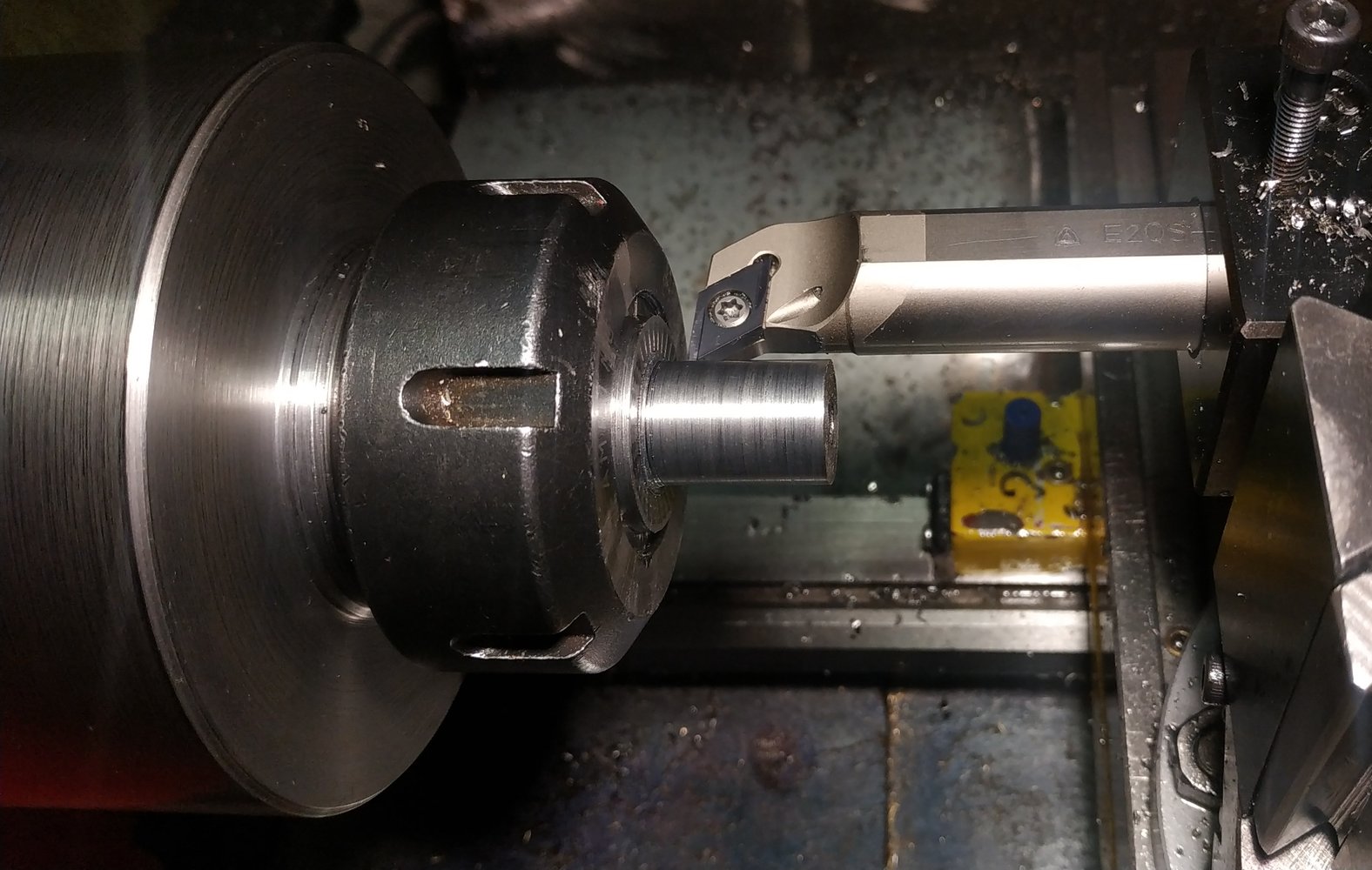

The hot chips problem, I have found two solutions!
External turning in reverse with a left handed holder or RH bar. The chips go away from you. 7mm off diameter was no problem, that is a big cut for this lathe!
These single edge chip breaker inserts, I like them as they break chips 100x better than normal. Instead of high velocity small C's, or high velocity curls, or stringers, you get thick, slow C's, or tight curlers (a bit lile a parting swarf wheel). Did not get burned, did not need the cardboard guards!
Problem is availability. I only know one shop with a few left, on clearance. I would have posted this before, but first I wanted to buy plenty for myself
I think KNUX style inserts are similar? Have not used them but only turning inserts I know, that are normally single edge.

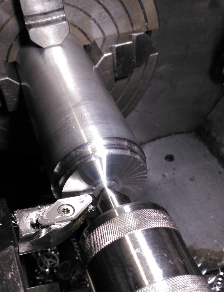

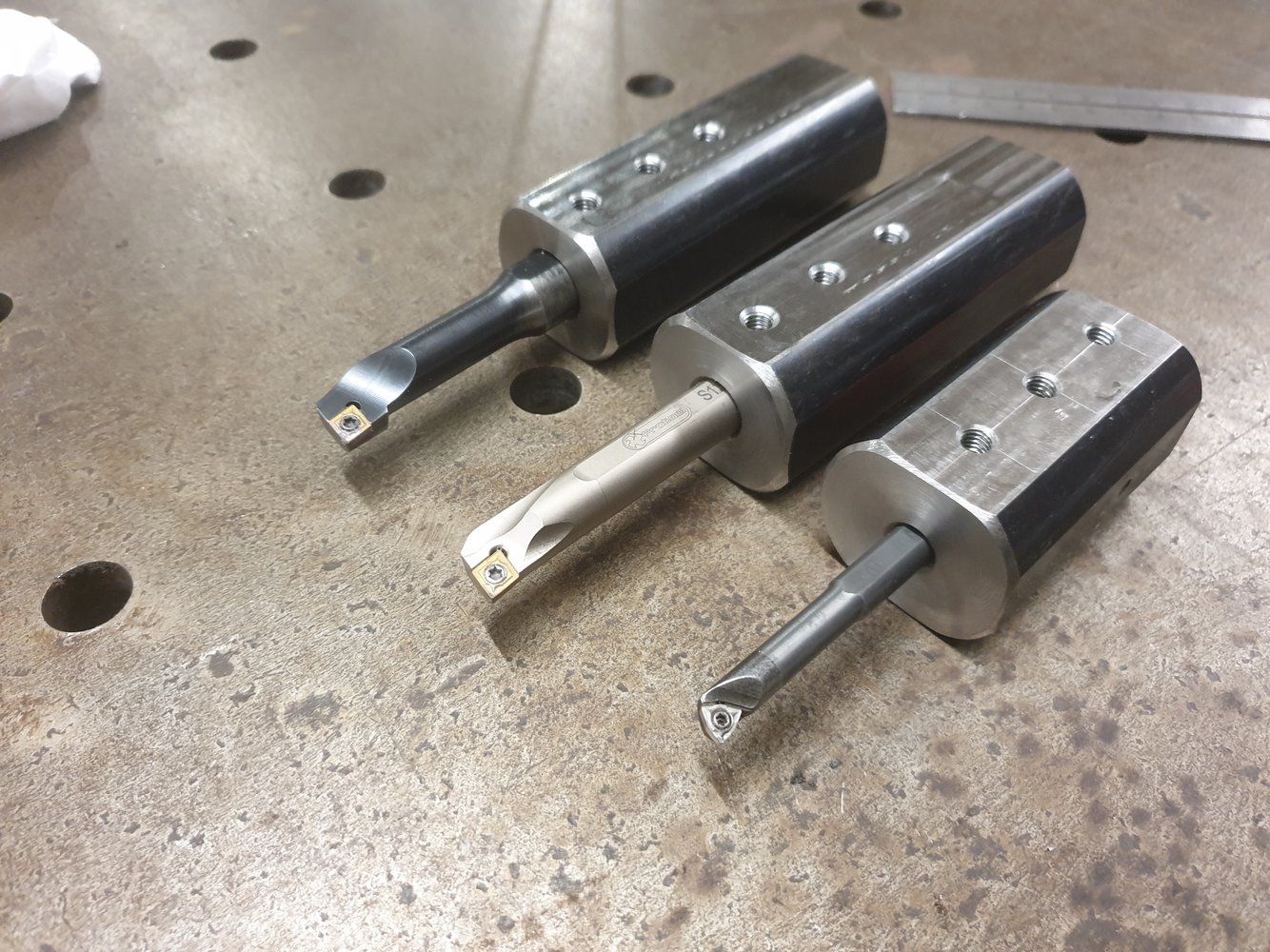

so just a pair of stepped radius grooves to see if it works.For that size insert you need at least a 20mm square shank tool.Ive been making this tool holder and found time to test it. Cant think of anything to turn right nowso just a pair of stepped radius grooves to see if it works.
Good finish tho my lathe lacks the rigidity for the full contact radius with this much stickout, I had to finish turn chuck by hand to remove chatter marks. Hoping a shorter peice, cast alu, brass and plastics should manage the full cut ok under power. It makes nice big curls of swarf.
I did expect the rigidity problem as I have it with my HSS concave radius tools.
