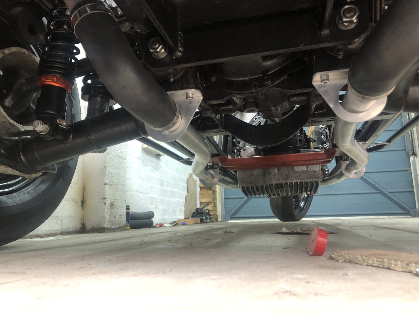

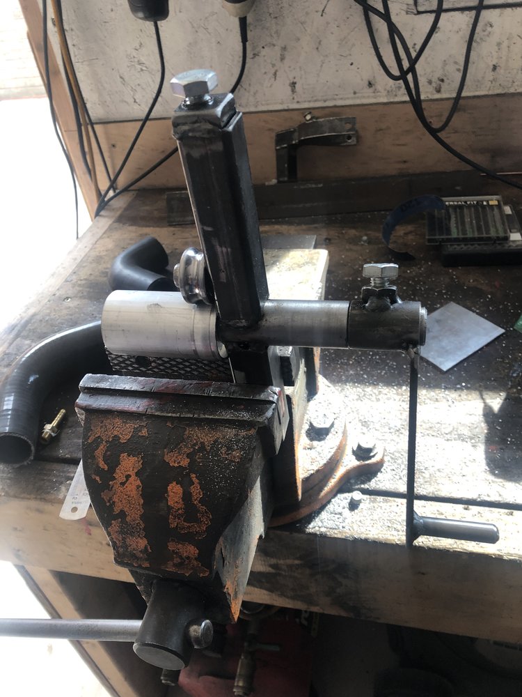

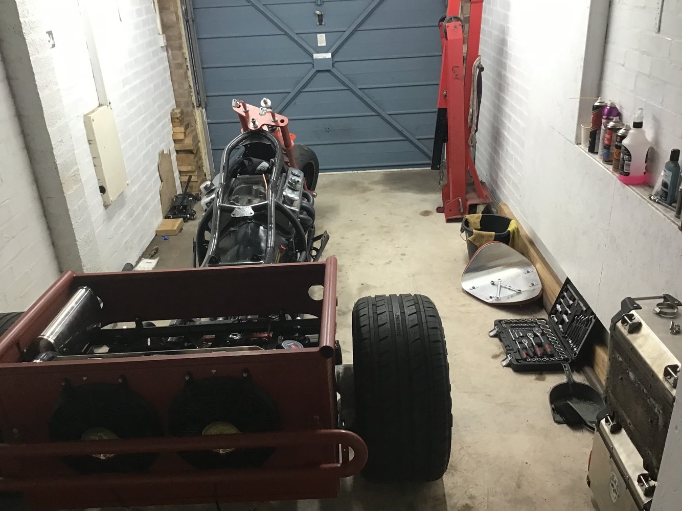

I spent a few hours bead rolling the cooling pipes, and fitting up the cooling system, rubber etc, as it will live from now on, hopefully no major glaring errors will appear as the next part of the puzzle gets added on.
I shall wrap some 1/8” rubber strip around the pipes where they pass through the alloy supply rackets.
