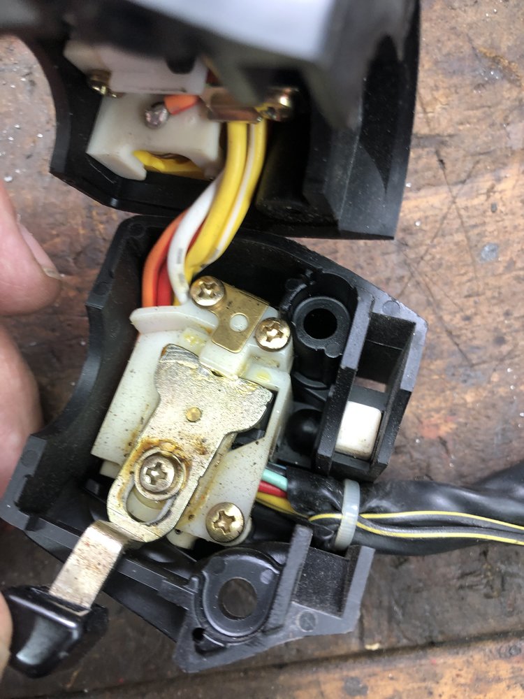

You used to see that a lot on trikes back in the 80'sBeer keg.

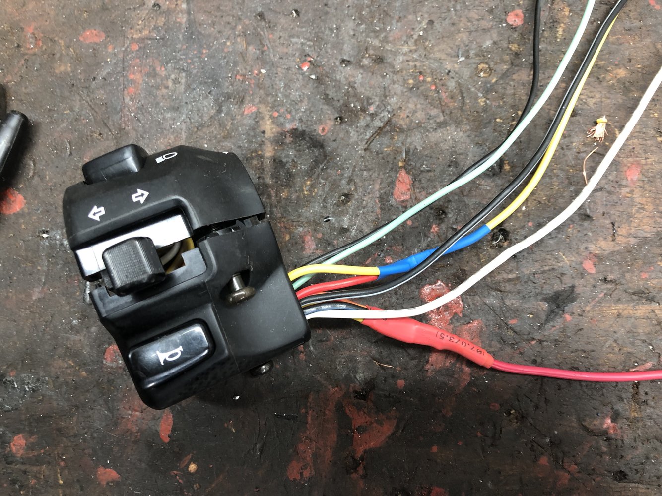

Push to cancel, but no idea if they were auto cancelling. The switch works the same as my Bulldog, and my old Bandit 1200. I looked everywhere to try and find some nice shiny alloy switches but everything seems to be black.The indicators are auto cancelling with manual (push) cancel on that? My old Yams have it, except the Jap import XJ maxim.
Triumph switchgear was aluminium.Push to cancel, but no idea if they were auto cancelling. The switch works the same as my Bulldog, and my old Bandit 1200. I looked everywhere to try and find some nice shiny alloy switches but everything seems to be black.

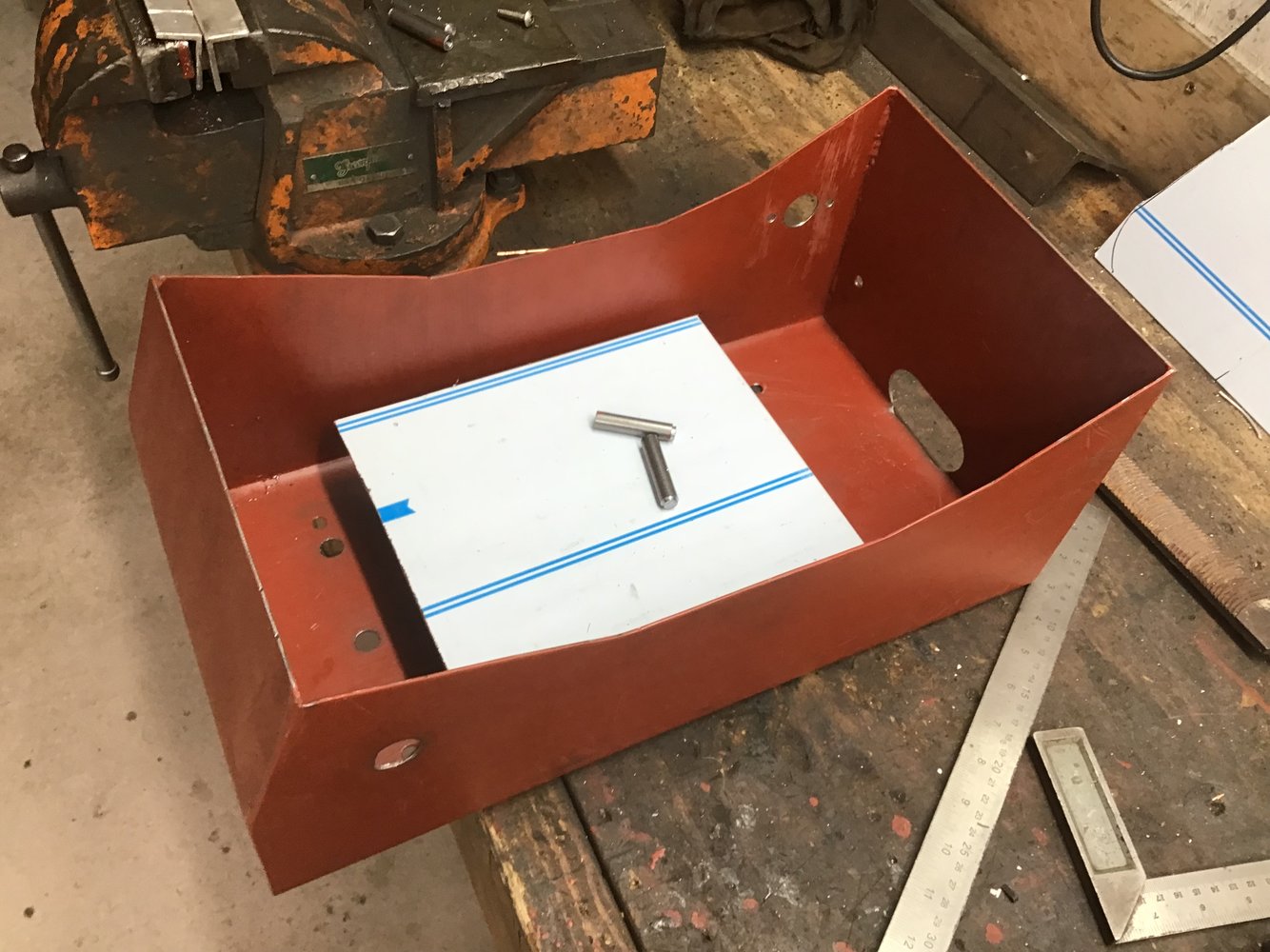

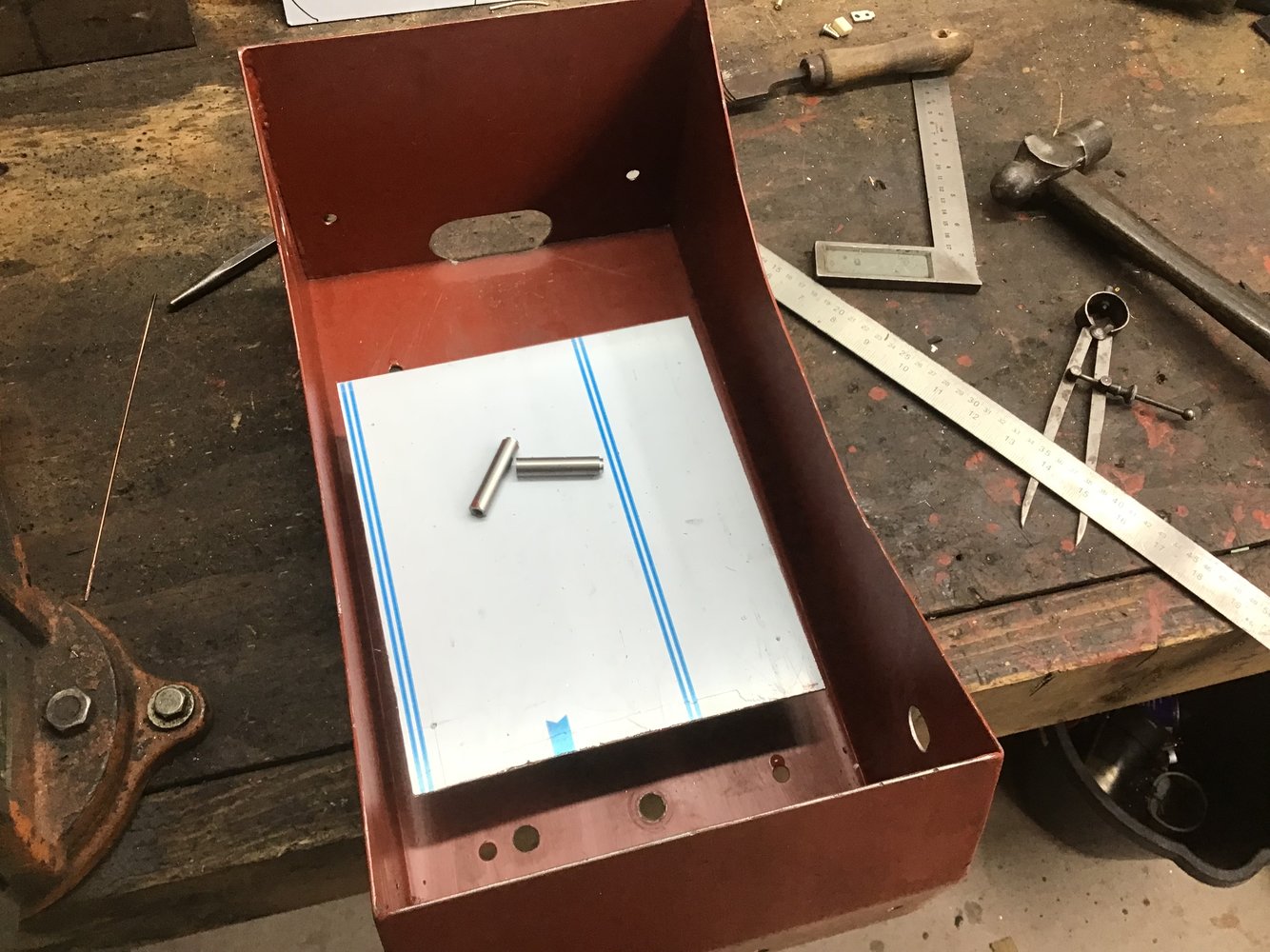

Glad to see your still getting out in the workshopNot actually done anything to speak of, but started making some alloy mounting plate today, to go inside the box under the passenger seat. It will bolt to the steel posts, that will be welded to the base of the box.
Fuse box, flasher, relays etc will mount to it, with electrical block connectors at each end for all wires to go into. The theory being the whole electrical shebang can be removed and worked on, on the bench. Rather than messing about trying to do it in an awkward place. Been there, done that, on everything I ever built….

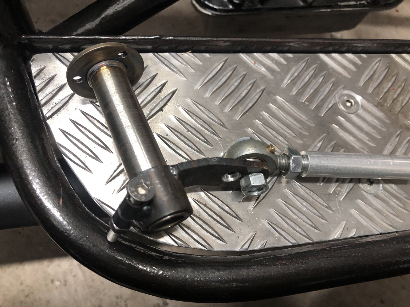

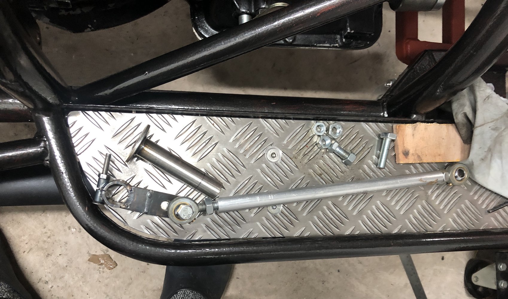

This as you know is all normal for a bespoke one off build. If it was easy everyone would be doing it!I’ve battled with apathy for a while, but managed to get myself into the shed and make a gear shift linkage. Everything was carefully measured and manufactured from scratch, and today I test fitted it just to double check everything is right before I clean it up and strike it off the ‘to do’ list.
Except it doesn’t work. It suddenly won’t move the gearbox end lever far enough to go through all the gears. No idea why, I measured and tested a dozen times.
I can cut and weld a longer arm on the front lever part, that should fix it, but I’m just getting sick of having to rescue every single task I do.
Measure 20 times, cut once, start again…… ad infinitum….
