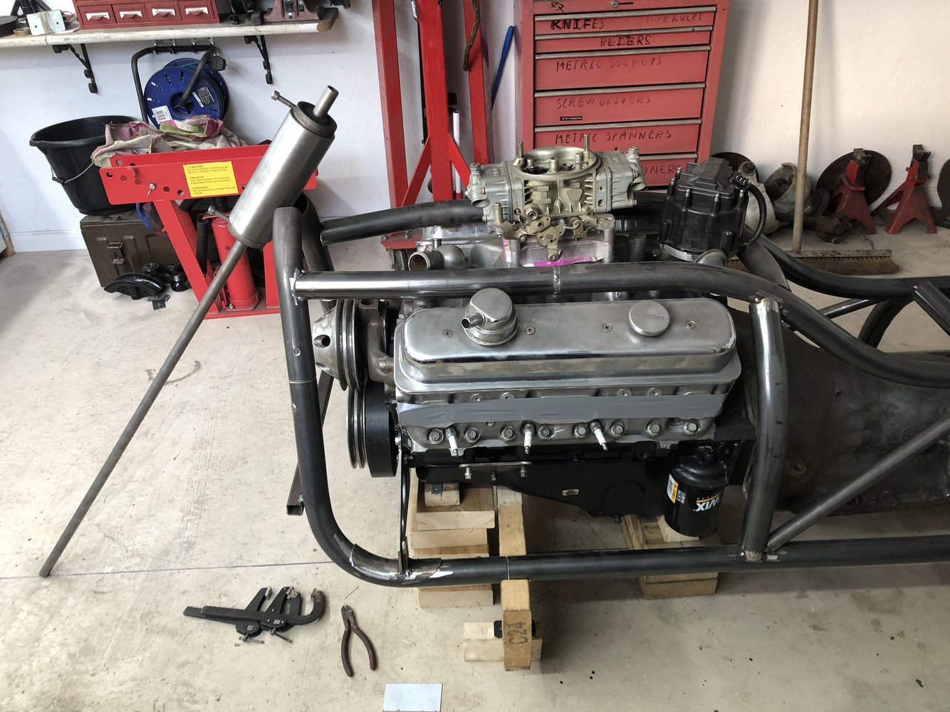

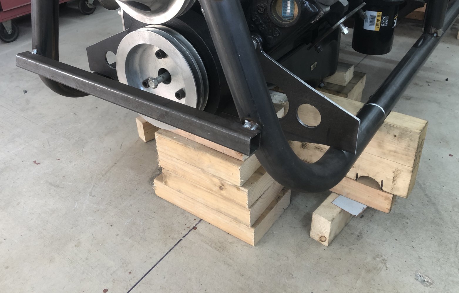

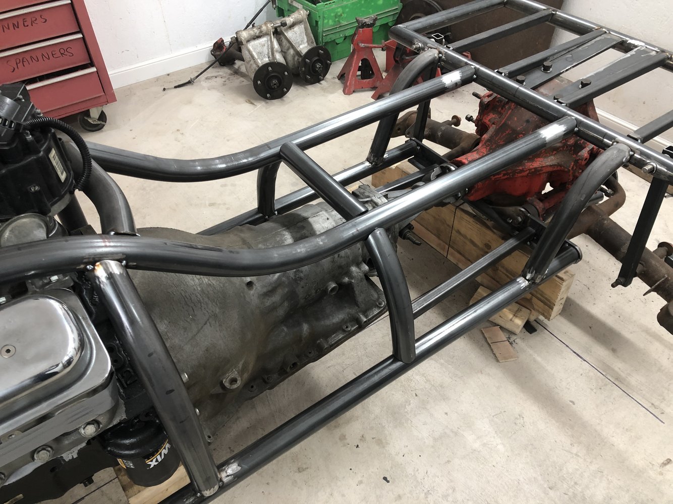

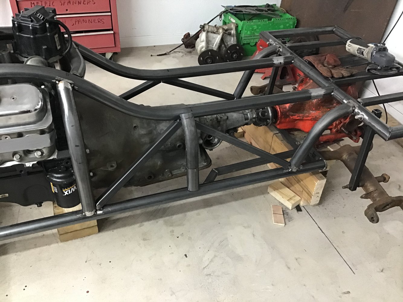

I’m kind of 50/50 over the square tube, but there will probably be some panelling over the rear half of the frame eventually. I’ll have a transmission cooler back there, maybe various other necessary mechanical odd and sods too.Like the top tube lines. But square tube is a bit marmite. Will the engine come out again?
I definitely needed an interesting project to get my brain back on track.Good to see your mojo returning.

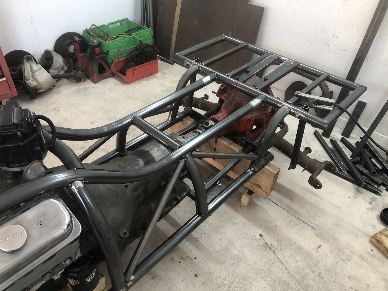

I did plan on fitting another round tube, instead of the square tubes, a bit like this mock-up. It needs torsional stiffness though, triangulation, to stop the whole thing winding up the rear half when/if I ever unleash 350 horsepower.Like the top tube lines. But square tube is a bit marmite. Will the engine come out again?

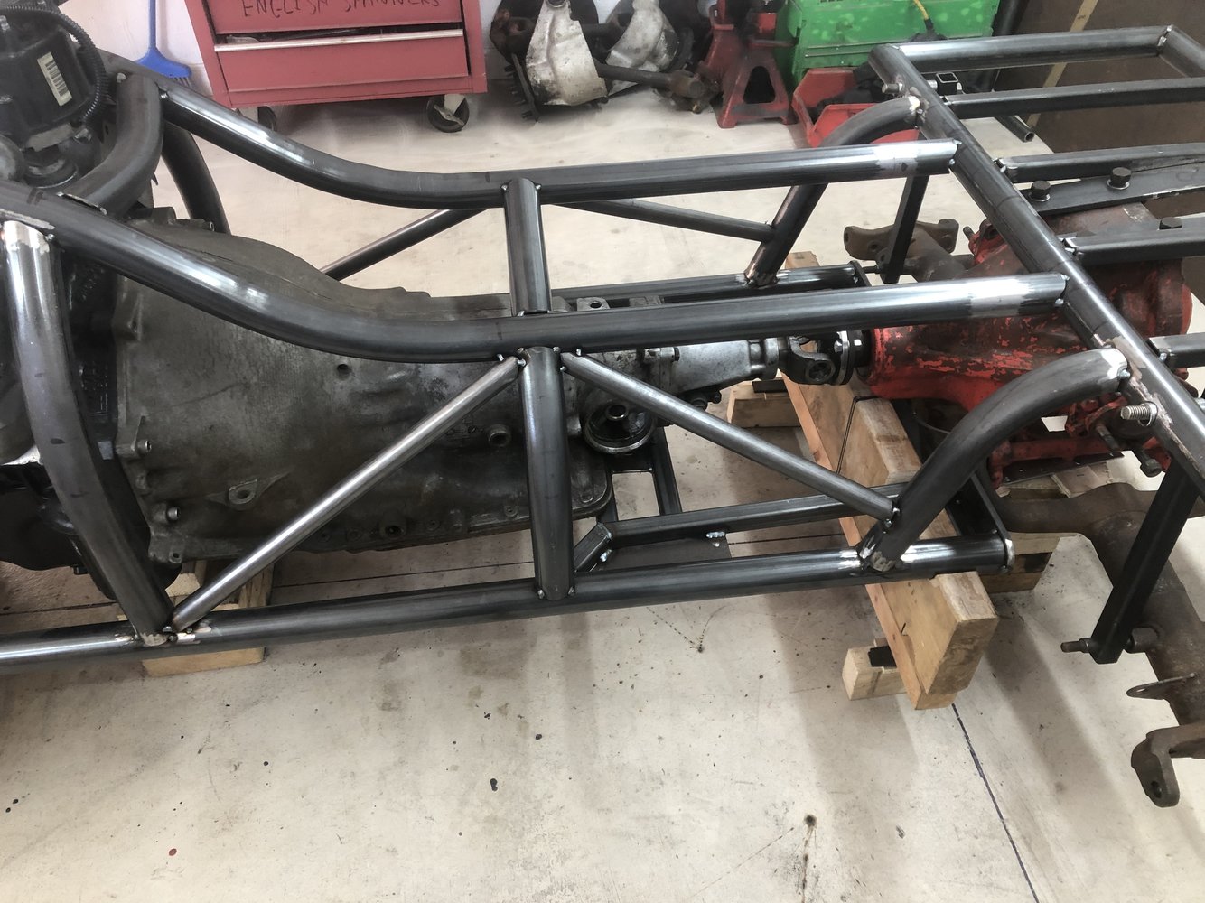

There is a slight angle in it as the Jag diff pinion is offset, so the motor is pushed across an inch at the rear, to line up, thus the U/J will always be ‘working‘ a bit.
big donut as a UJ. Not sure why
Gawd, I think my, possibly, 2° out of line joint is far closer to perfection than your average mass production, axle-strapped-to-leaf-springs, angle-varies-depending-on-how-much-junk-you-have-in-your-trunk, U/J installation.Gawd! I think I'm trying to teach my granny to suck eggs, but...
A single UJ (Hooke's joint) running at an angle isn't constant velocity: The output speed fluctuates at twice the input speed (worse as the angle gets bigger). It could start rattling a bit if it's coupled directly to the diff with nothing resilient in between. In a double UJ (like a conventional propshaft), if the joints are correctly aligned, the fluctuations cancel each other out and you get constant velocity transmission (provided the angles at each joint are equal - e.g. if the input and output shafts are parallel).
The rubber 'do-nut' joints suffer from pretty much the same thing, but being rubber, they damp out the torsional vibrations better.
Humblest apologies if you know this, but I didn't want to let it pass in case you didn't.

Sorry, no offence intended! - I suspected I might be trying to teach my grany to suck eggsGawd, I think my, possibly, 2° out of line joint is far closer to perfection than your average mass production, axle-strapped-to-leaf-springs, angle-varies-depending-on-how-much-junk-you-have-in-your-trunk, U/J installation.
No worries. Constructive criticism is always welcome. I generally make so many mistakes when I do anything, it’s good to have people watching my back.Sorry, no offence intended!
