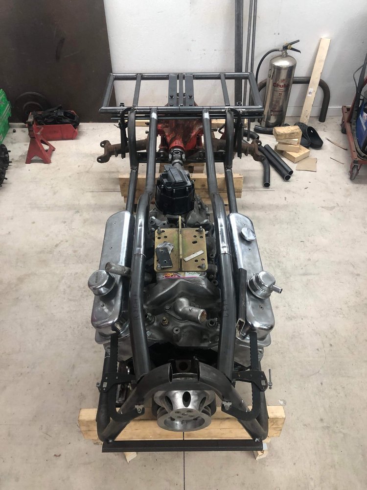

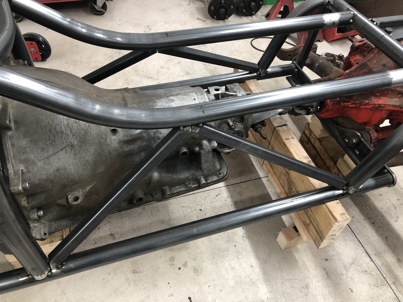

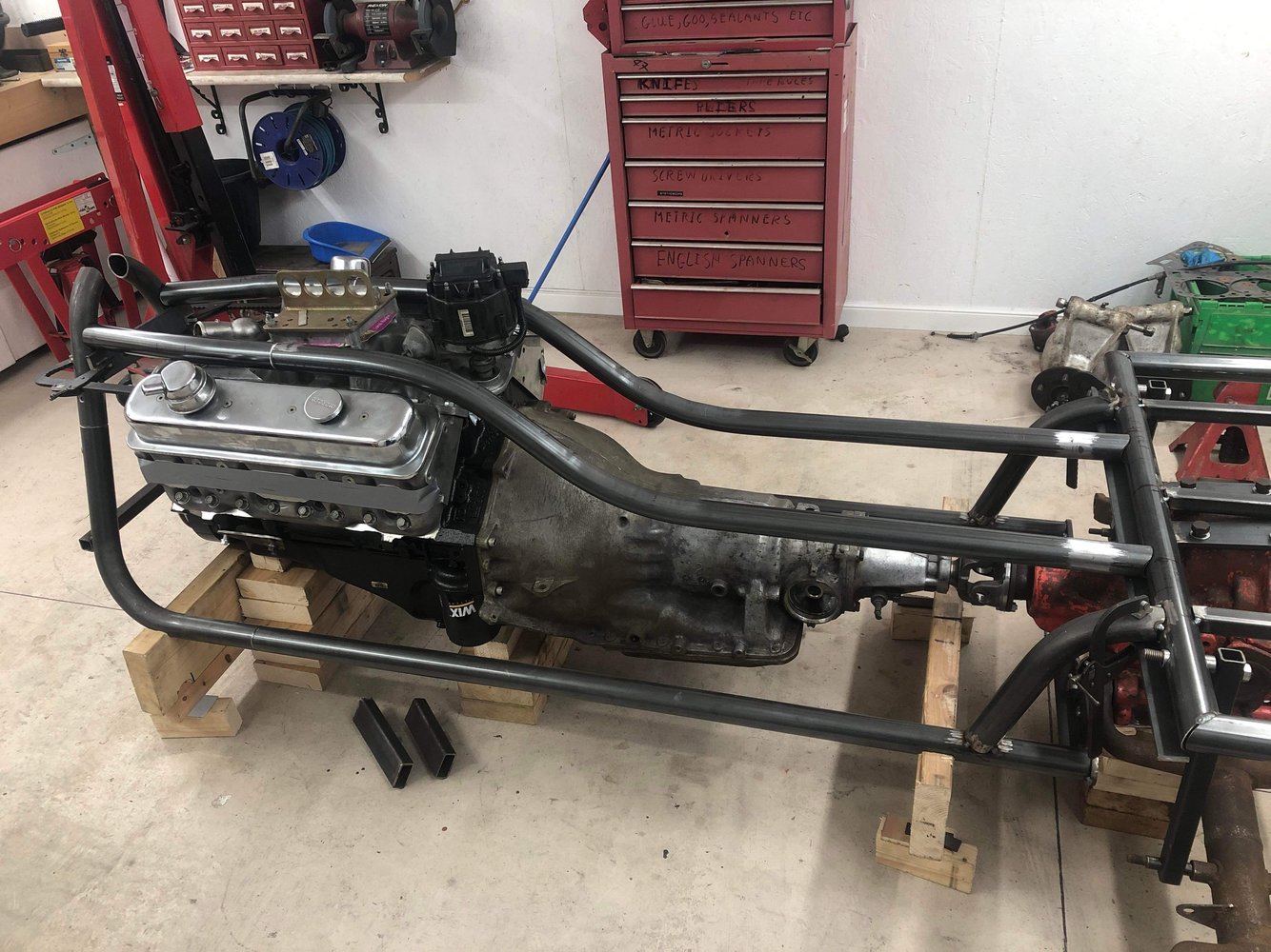

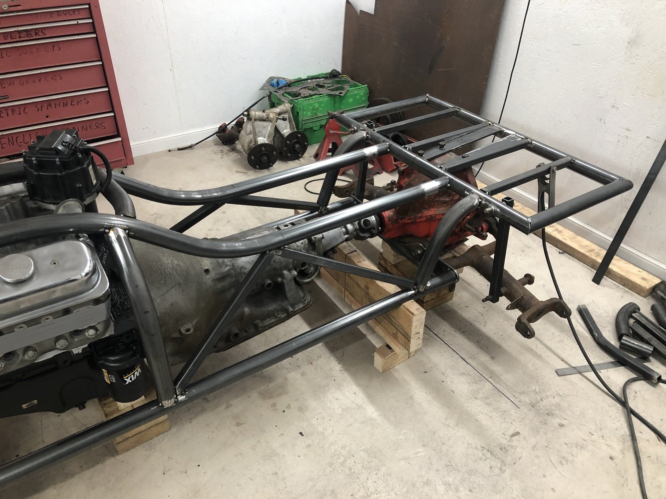

There doesn’t appear to be any shims or anything inside the lower brackets, they were bolted up tight on this one. If I need to do any alignment of the whole rear end I can probably shim the lower pivot spindles where they bolt to the back of my frame.I think the toe in is done on the lower inner arms mount, that why it advised never too remove them
You are correct about how they are used on lots of kit cars. The rear end is plenty strong enough, and the rear trailing arms don't do what you think they do on the original car. On the original car, the differential is mounted to a cage, and the cage is mounted to the car with rubber bushes. The trailing arms help locate the cage and rear suspension in the car and I believe were set up to provide some small passive rear wheel steering effect at speed with cornering loads. On most of the kit cars the diff is mounted directly to the chassis, so the trailing arms can't really be used. If they were used, they would cause the suspension to bind at larger displacements.There doesn’t appear to be any shims or anything inside the lower brackets, they were bolted up tight on this one. If I need to do any alignment of the whole rear end I can probably shim the lower pivot spindles where they bolt to the back of my frame.
There’s only 6 bolts holding the whole rear end on.
On the original car there are trailing arms running back to the each lower arm, but apparently they aren’t used on lots of kit cars, Cobras etc, they just rely on the strength of the lower swinging arm.
For your set up it will be fine, you'll never get all the power down in one big hitThere doesn’t appear to be any shims or anything inside the lower brackets, they were bolted up tight on this one. If I need to do any alignment of the whole rear end I can probably shim the lower pivot spindles where they bolt to the back of my frame.
Lack of balls would be the biggest problem with me getting the power to the ground John.For your set up it will be fine, you'll never get all the power down in one big hit
That’s something I have pointed out to people on hot rod forums before, that the trailing arms move the rubber mounted ‘cage’ in corners and invoke a certain of rear steer. Nobody believes me, because I’m not one of the ‘names’ in hot rod circles.You are correct about how they are used on lots of kit cars. The rear end is plenty strong enough, and the rear trailing arms don't do what you think they do on the original car. On the original car, the differential is mounted to a cage, and the cage is mounted to the car with rubber bushes. The trailing arms help locate the cage and rear suspension in the car and I believe were set up to provide some small passive rear wheel steering effect at speed with cornering loads. On most of the kit cars the diff is mounted directly to the chassis, so the trailing arms can't really be used. If they were used, they would cause the suspension to bind at larger displacements.

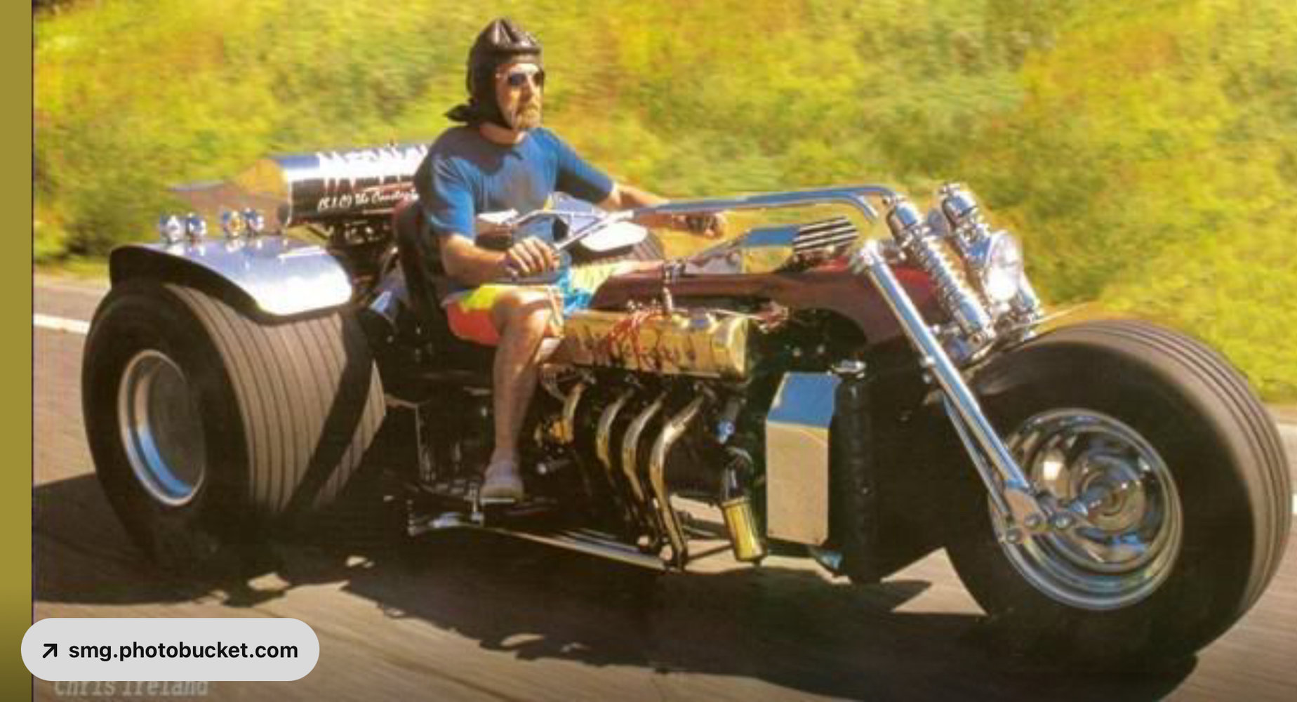

I came across a photo of a Desperate Dan trike yesterday that appeared to have a big donut as a UJ. Not sure why, but i’m not about to argue against the logic of one of this countries most prolific trike builders.Chris Ireland used to say something about a rubber donut joint on the CV for short trikes.
He always named his own builds, I think that one is Megalomaniac. There’s another called Captain P*n!s.I came across a photo of a Desperate Dan trike yesterday that appeared to have a big donut as a UJ. Not sure why, but i’m not about to argue against the logic of one of this countries most prolific trike builders.
(this wasn’t the trike with the donut)
Think he was cleaning a beach somewhere last I heard?He always named his own builds, I think that one is Megalomaniac. There’s another called Captain P*n!s.
I remember he mentioned having a Merlin engine he wanted to use for something. Shame he retired from it. Anyone know him?

I know of him, been on several forums together. He built a supercharged Indian to take to Bonneville, for land speed racing, using an engine he’s owned for decades, and had some adventures over there. Nowadays he just builds for himself.He always named his own builds, I think that one is Megalomaniac. There’s another called Captain P*n!s.

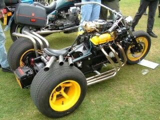

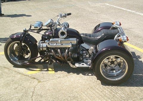

The first one is a 3 litre Essex Ford V6, and though it won trophies on a show field, I cant imagine it ever drove more than a few miles.One of these might be the one someone mentioned earlier from BSH?
