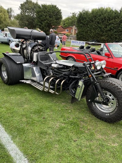

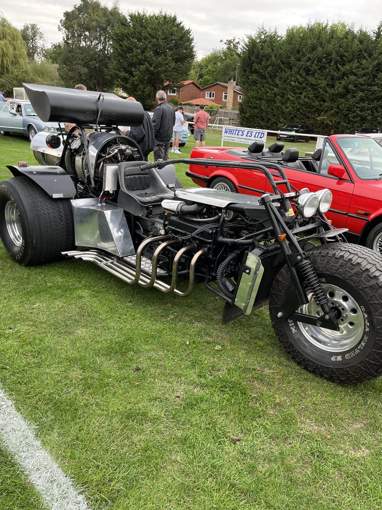

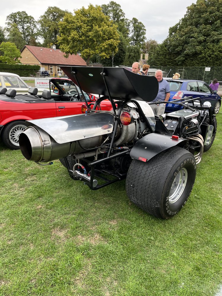

That was a Desperate Dan build quite a few years ago. Road legal too, amazingly.Forgot to upload these for you @Morrisman
And yep the jet engine works
View attachment 364913 View attachment 364914
It is indeed I drink with the chaps that built itThat was a Desperate Dan build quite a few years ago. Road legal too, amazingly.
Now that could be an interesting night out.It is indeed I drink with the chaps that built it
I've followed "Despo's" exploits and adventures for years, the straight 8 supercharged NSU motor, the supercharged Indian LSR racer to Bonneville trips etc. He'd be a hard act to follow.

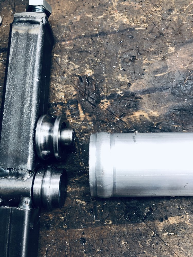

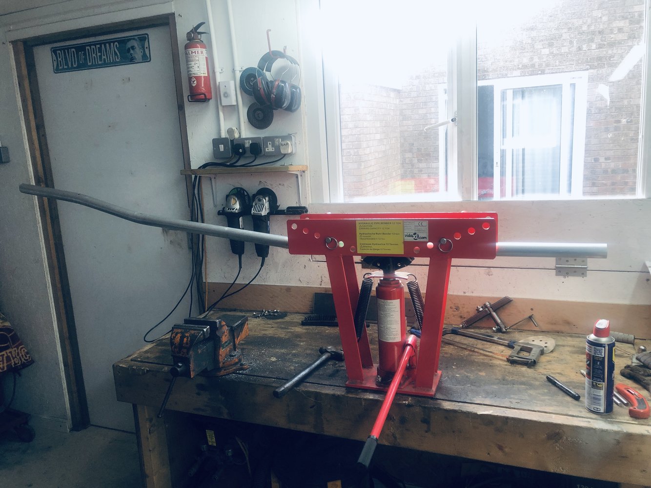

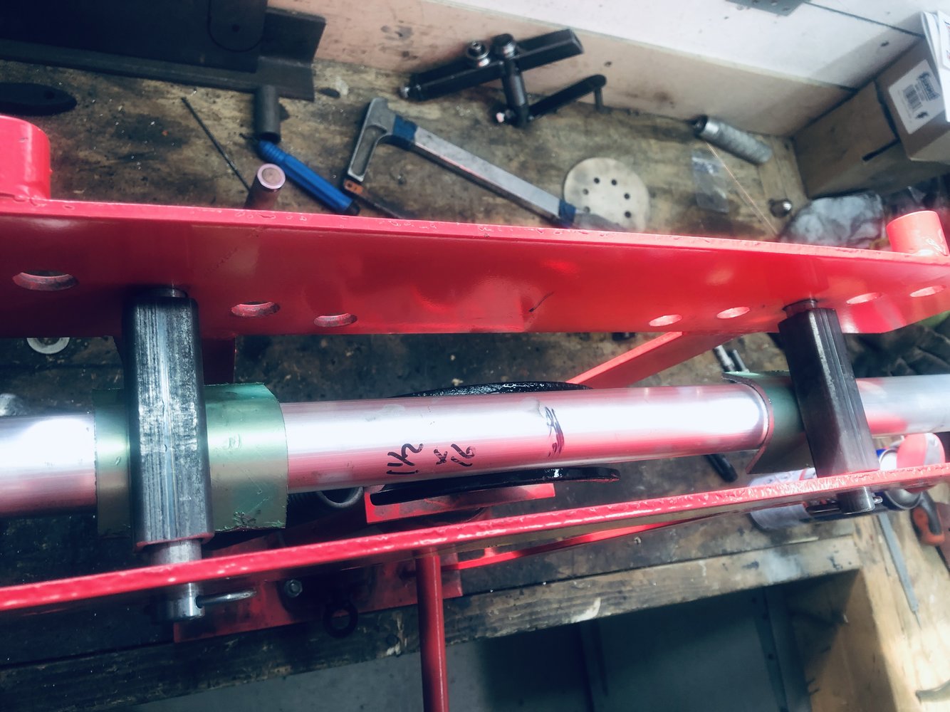

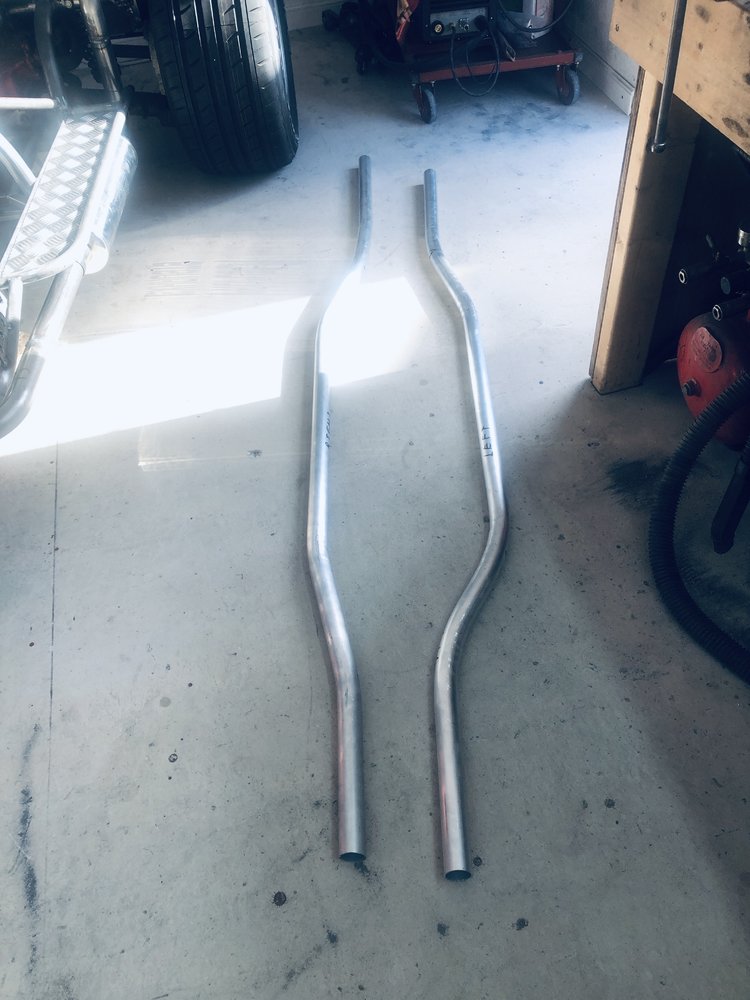

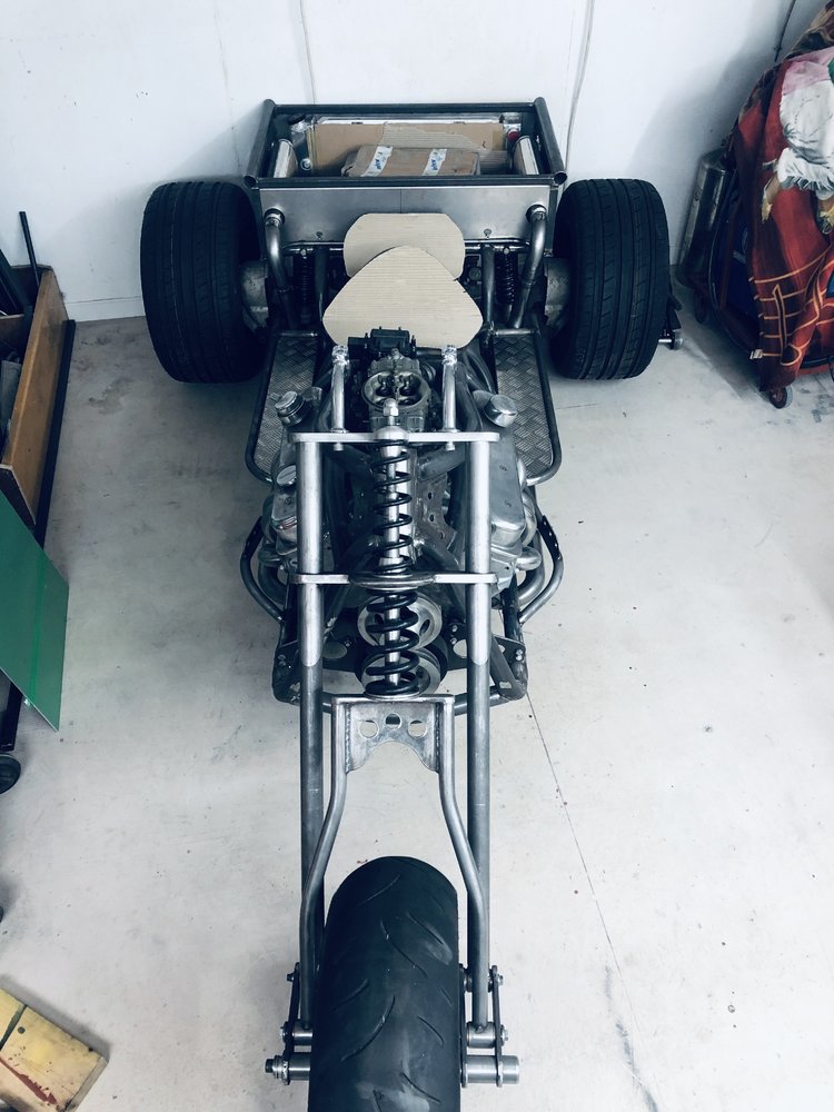

Water pipes?I broke out the tube crusher and played with the 1 1/2" alloy tube that arrived a couple of days ago. Managed to ruin one length by bending too much, but luckily i ordered 3 pieces, so now I have two that fit snugly around the various sumps, exhausts and filters etc underneath the frame. Sort of....
No, they're not meant to be symmetrical.
Yes, and a good point, I never mentioned what they are for.Water pipes?
Good work.
Don't worry, we guessedYes, and a good point, I never mentioned what they are for.![]()
I hope he is, my experience of plain tube ends has been distinctly warm and wet.You going to try and swage the ends too help the hoses stay on ?
Why silicone, ordinary ones are cheaper and last really well if you buy a recognised brand.I need to order a bunch of 90° silicon elbows, which won't be cheap, so I'll leave it a week to spread the financial load. The 3 x 2.5m lengths of tube came to nearly a ton.![]()
