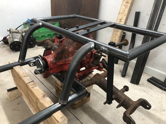

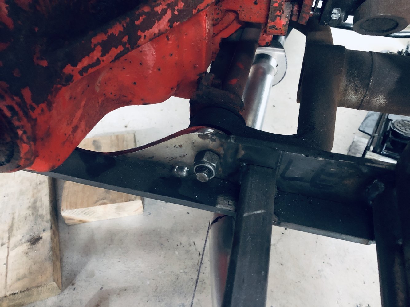

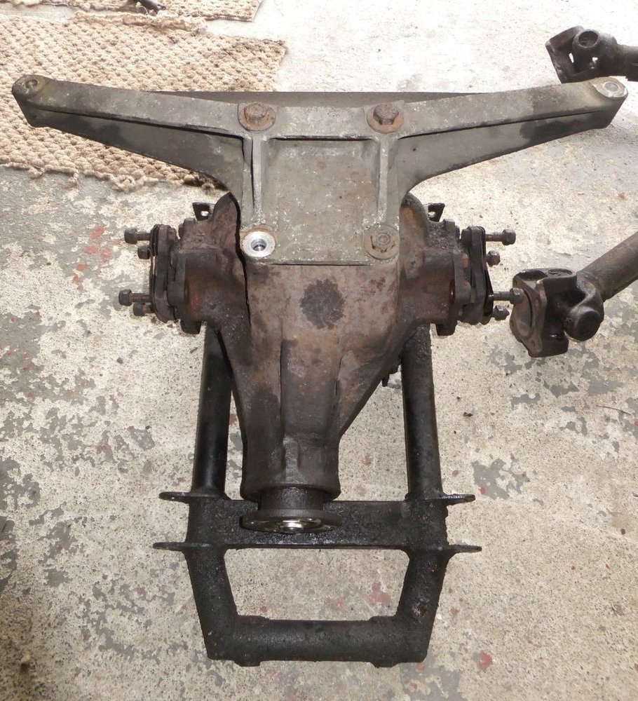

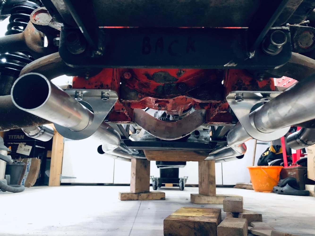

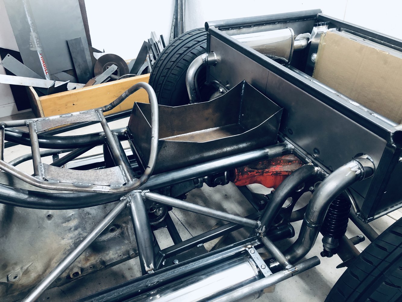

It depends how solidly the diff is mounted, bare minimum is a reaction plate bolted to the underside of the lower fulcrum points and firmly fixed to the chassis. Seen loads of badly installed solid mounted jag backends with axle tramp and too much flex, the lower radius arms were never designed to be unsupported in tramp.Dax had a neat rose jointed radius arm system sporting the correct geometry.
