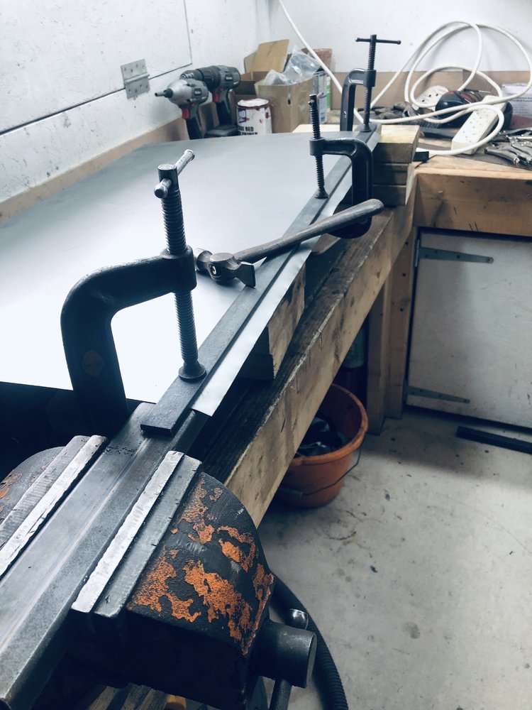

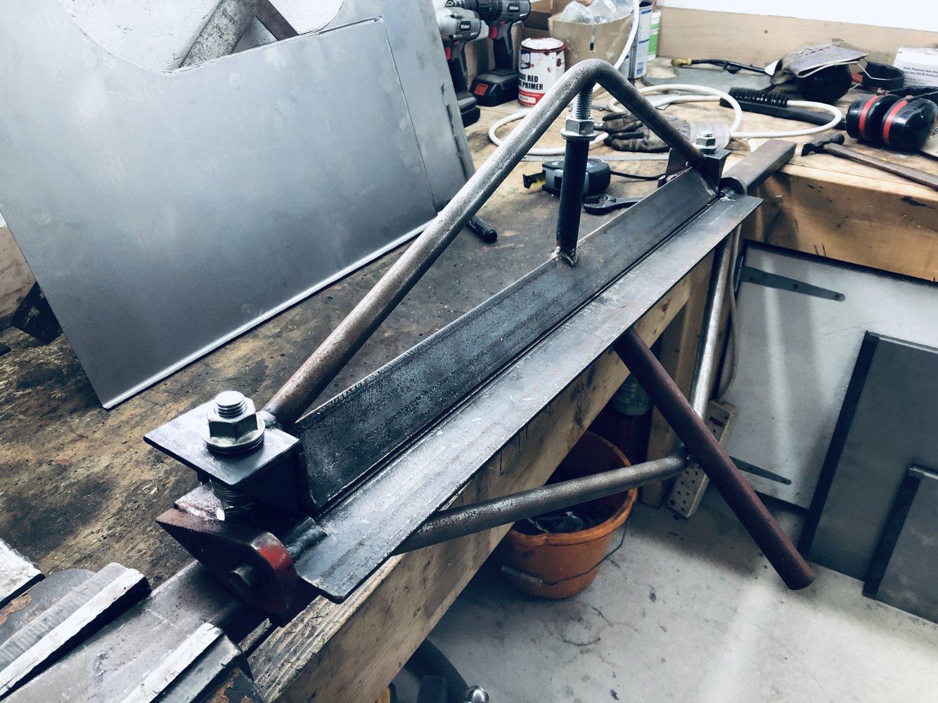

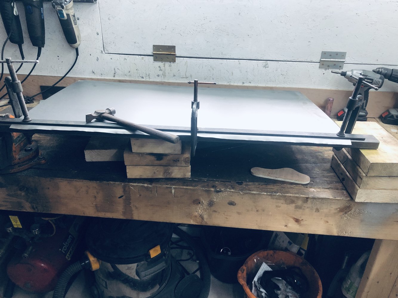

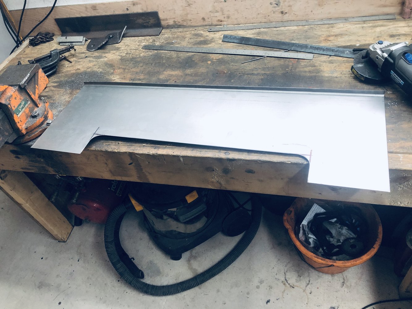

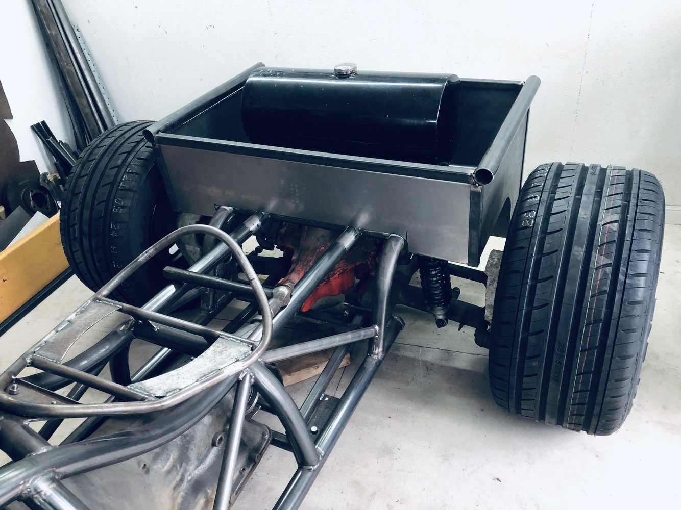

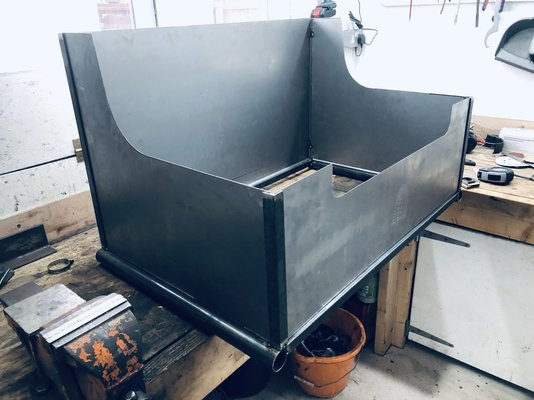

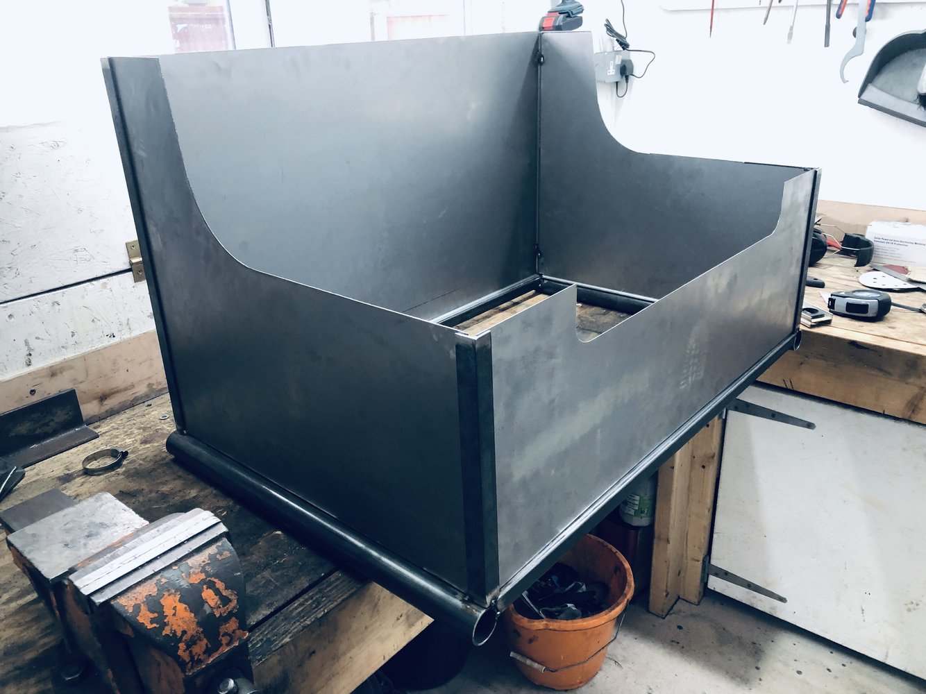

A bit of metal bashing the last few days, starting on the 'pickup bed'. My home made bender wasn't wide enough to bend the long pieces, so lengths of steel and a hammer were required.

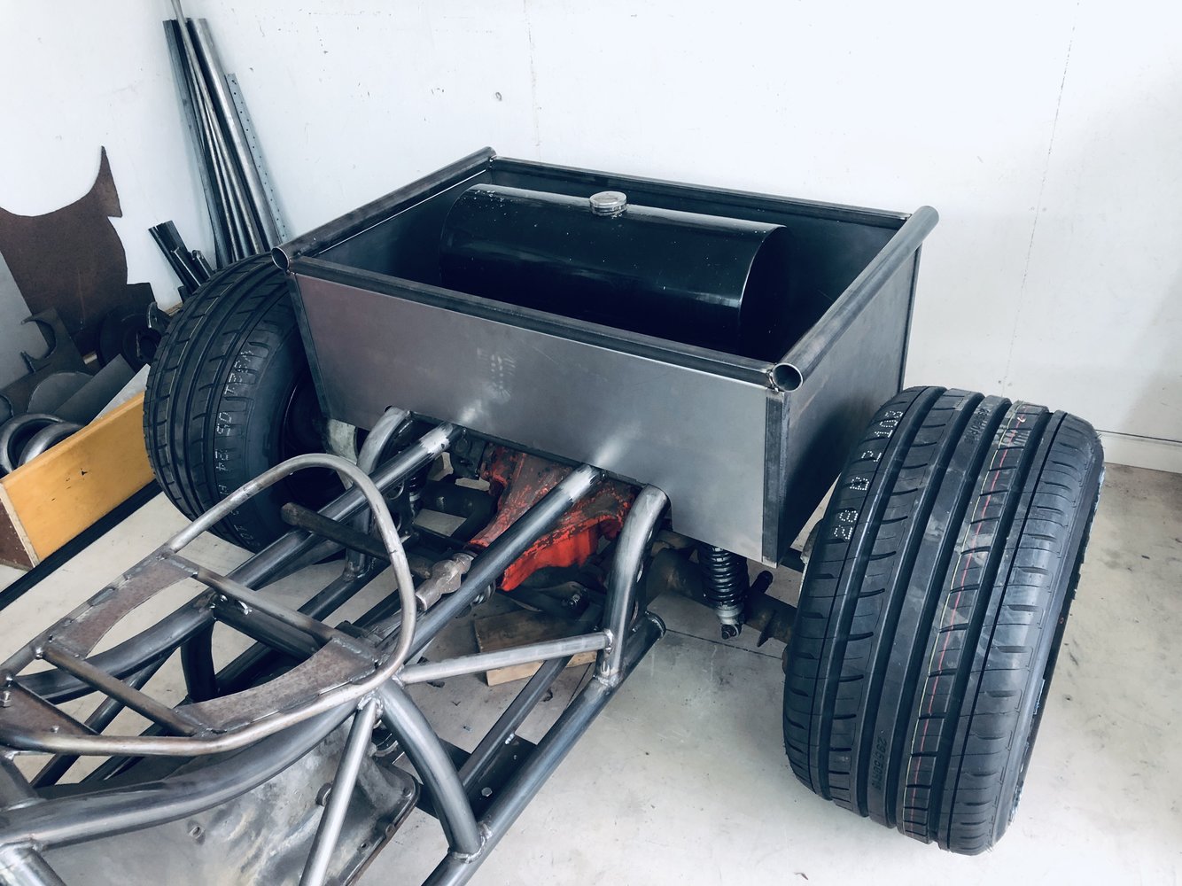

First fit the bed looked too high and prominent, so I cracked out the plasma cutter and trimmed 2" off the front lower edge, so it's dropped down. By the time mudguards are fitted, passenger seat, hi level exhausts, it should look more balanced in size.

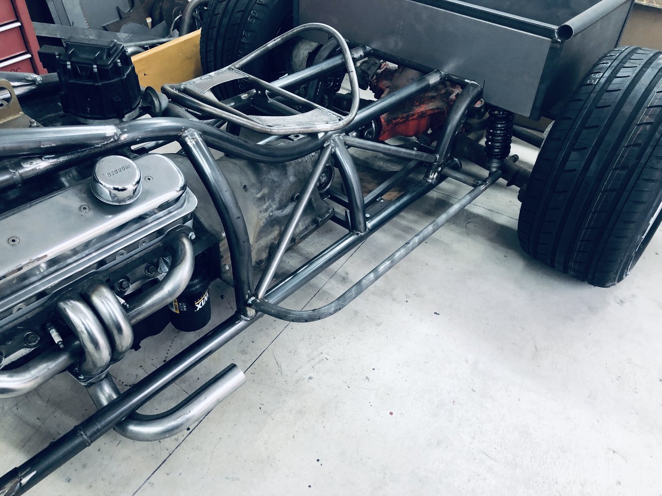

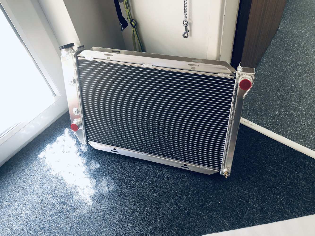

The radiator is going to be mounted out in the back of the bed, with two fans on the outside sucking the cool stuff through.

but as said it could easily be used as a secondary cooling aid, along with a fan, look at the way they do the trans cooler with the fans. If you vent the rear box correctly and duct cold air in from above i'm sure the big rad will suffice
