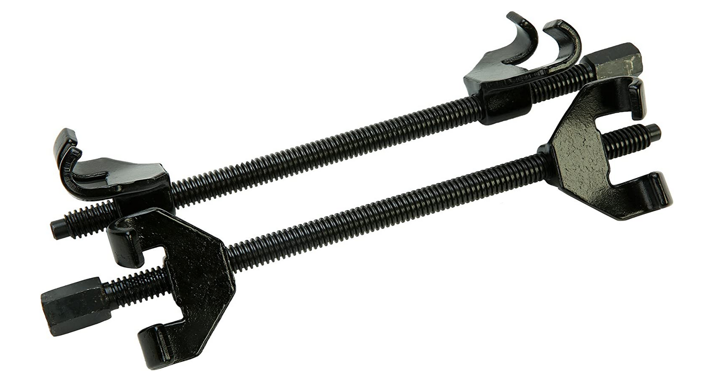

However, without appearing rude or ignorant, due to the know qualities and robustness of the coarse thread traditionally used on Hub Bearing Pullers and Coil Spring Compressor, for the same reasons, that's the thread I've decided to use, which I'm attempting to source.
They're no more or less robust than any other coarse thread unless they're trapezoidal or acme (and that's generally used more because the tips of normal profile can get flattened against the spring than anything). They're often not even particularly strong material they're just the right size for the job.
This is the misconception.
