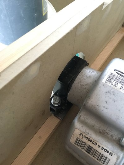

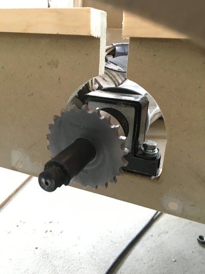

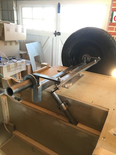

Couple of point to be aware of with the motor. In your post 15 the second pic, the device mounted to the right hand end of the motor (with the sticker on) is a brake. It need power to release and if you try applying power to just the motor without powering the brake (thin white wires) then the motor won't turn (may fry!). You can remove it (couple of screws) or if you use the control console from the scooter this should operate it. Also the motor/axle assembly should have a release leaver (usually red) that disengages the drive allowing a scooter to be wheeled without the drive stopping it. If you can keep this lever as it allows pushing of the unit. The axle unit is (or should be!) a differential unit an so will suffer the one will spinning while other does not drive. It is possible to "lock" the diff.
I used one of these drive units for my bead roller, hence locking the diff ! and red lever allows manual feeding when needed.

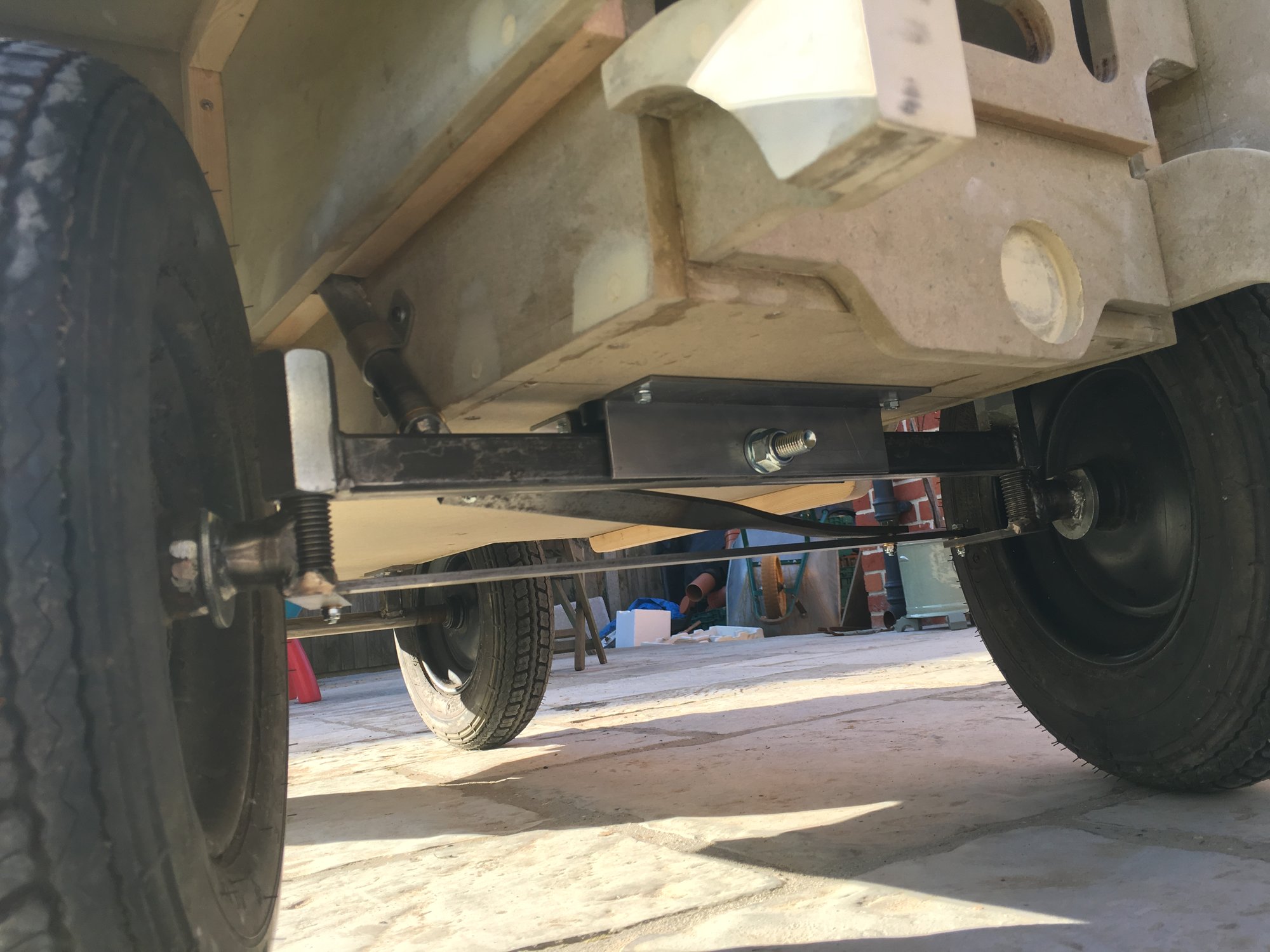

The rear axil, gear box and motor was from a disability scooter, at first using 2 X 12volt 17Ah batteries. Soon upgraded to 32ah.
Steering was real hoge poge of parts, go cart, mobility scoter and parts I made.

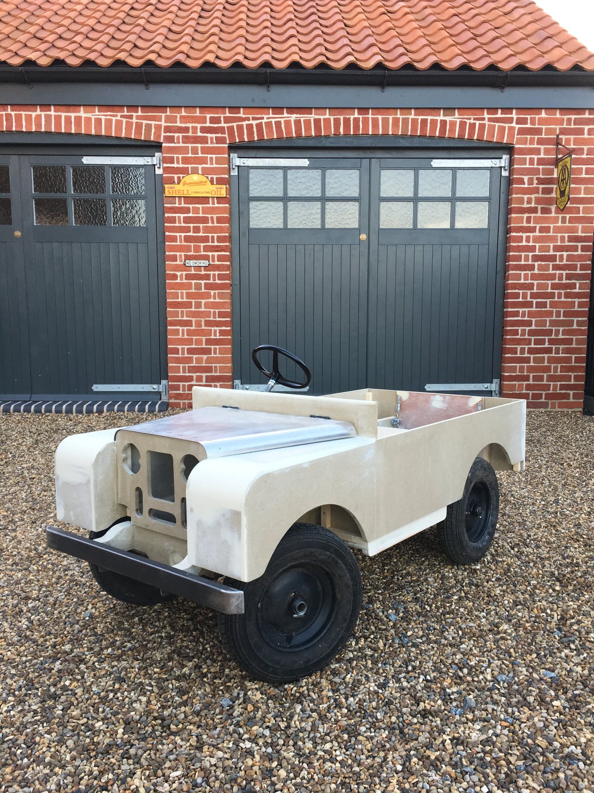

Sorry, I misread your initial post, thought you were talking from an aesthetic point of view. Now I understand, and yes good point. I forget that rather than a ‘scale model’ this is actually a kids toy. Saving grace is, the tailgate is secured by anti-luce pin so it’s quite difficult for little fingers to open, especially whilst moving, but I agree a potential exists with all pointy hooky things so better remove it...
I did. Just sold it before Christmas as the girls had outgrown it.
http://www.mig-welding.co.uk/forum/threads/painting-a-wooden-land-rover.46597/
Rest of the build is on the Toylander forum.
I bucked the trend and soaked the MR MDF with low viscosity epoxy boat builders resin before painting. It's very wet in the Pennines
Very nice build by the way
Cheers
Andy
Just had a quick run through your thread, looks a top job. How did you get on with the resin? Any particular brands to look for? Cheers
