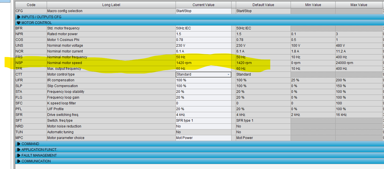

Yes it's in Standard mode. Here's aa link to t quick reference, it doesn't give all the parmeters but a lot of them.
Sounds really odd Pete - exactly half speed suggests something parameter wise but struggling to see what it might be! May of course just be faulty…Dial on the front. Yes I set FR1 to AIUI and FLo and FLoC set to No
Thanks for the help I've been sat here going through the manual a couple of times.
Ha ha well spotted!Right mystery solved, as expected it was a RTFM failure. The 50 was not a 50Hz but 50% of AiUi virtual reference frequency (percent of range from 10hz minimum to 50hz maximum range).
I figured this out after turning the dial down so the value was zero but the motor kept turning.

Another thing - I did put the parameters in for the 1.1kw motor then ran auto-tune but now the motor rattles and jumps about on the bench at about 25hz. It's fine low down and at rated speed it's just over a band of about 8-10hz it gets very rough.
I would spend more time looking into it but it works as is so there’s no point really.Yes will do mate, it’s under a pile of junk in my office at moment but I’ll dig it out tomorrowI reset the drive again with no effect, then set the controls to external and wired in a fwd switch and speed pot. Now the rough running is gone on my test motor plus I can watch the frequency ref. It also works on my re-wired TOS motor but it's a bit whistly I think it might be simply because the motor is over-sized.
