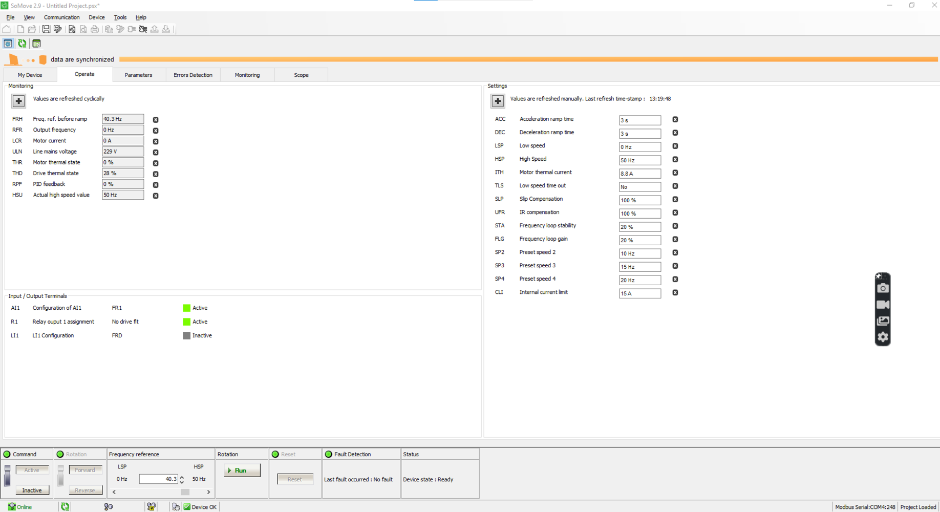

I reset the drive again with no effect, then set the controls to external and wired in a fwd switch and speed pot. Now the rough running is gone on my test motor plus I can watch the frequency ref. It also works on my re-wired TOS motor but it's a bit whistly I think it might be simply because the motor is over-sized.
I'm getting to like these altivar drives could you send me that lik to the interface chip please and I'll make up a programming cable
