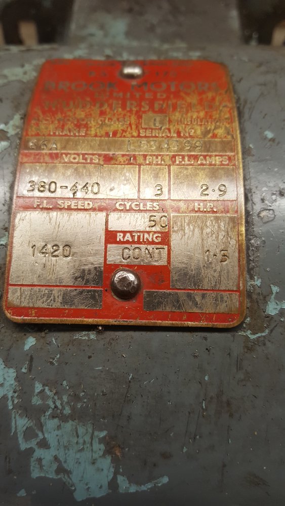

Well it needs digging out anyway so i will check the spec plateOnline search suggests a 1.5hp motor single voltage. Shame because the frame size looks very similar and the open frame matches.

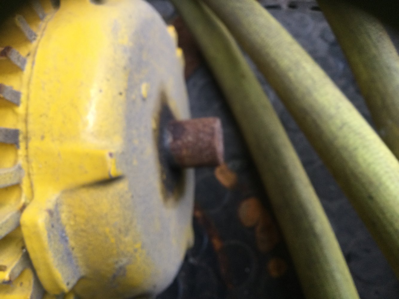

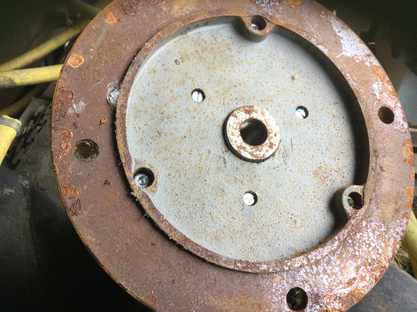

I appreciate it but no I will hold out for a 3hp.You called it right...1.5 hp with a 3/4 shaft,big lump of a motor though. Here if you need all the same.

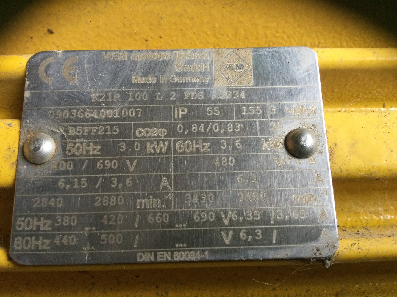

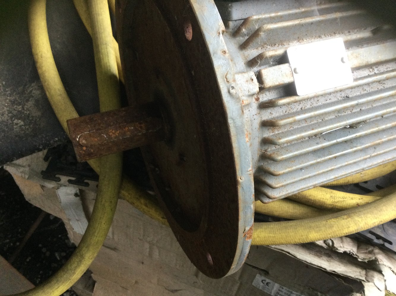

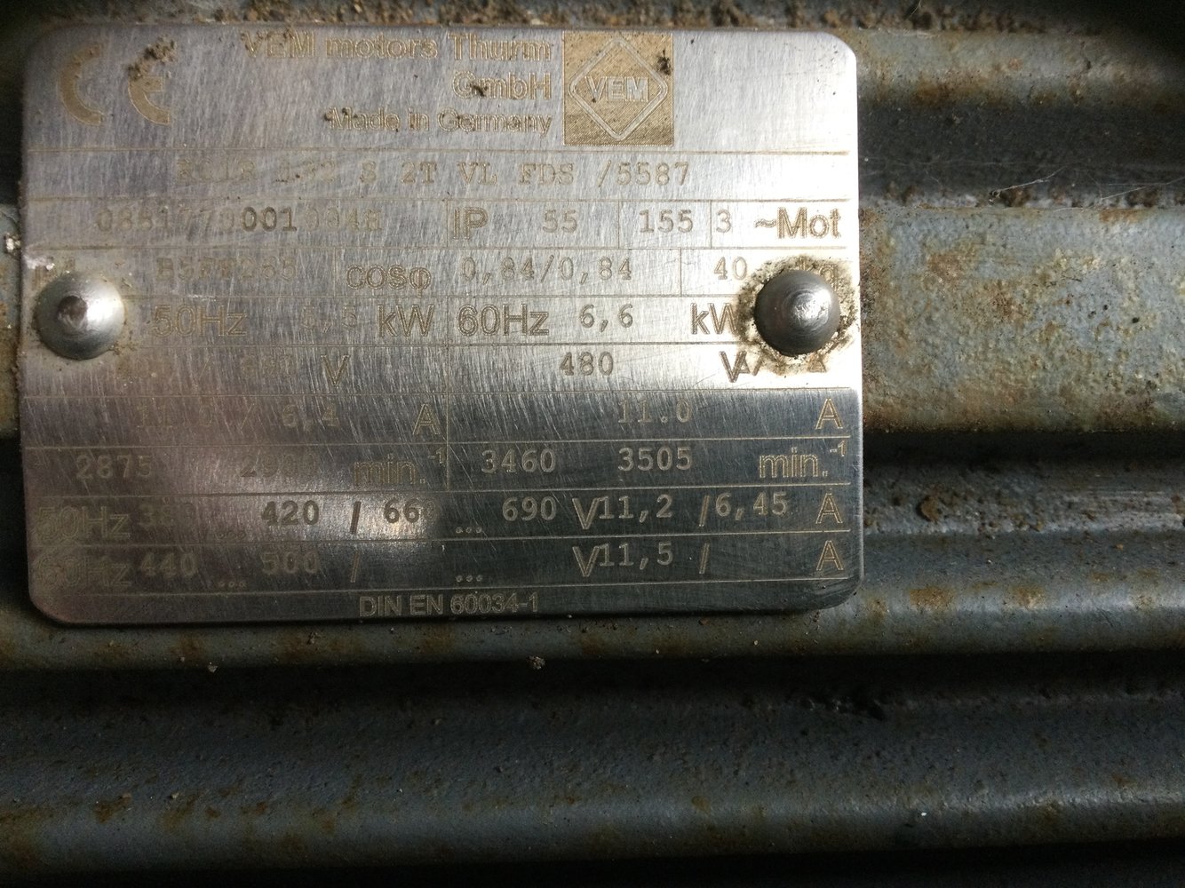

There are a couple of three phase motors here Pete.
Yellow one with a weird spline drive one end and a thread the other.
And a grey one, chunky looking 5.5kw beast.
Hmmm. Roofman, is yours a horizontal or dedicated vertical mill? Mine's the vertical so I must have been lucky to get one with a 2hp. I thought the horizontals had flange mounted motors?You called it right...1.5 hp with a 3/4 shaft,big lump of a motor though. Here if you need all the same.
no mate, this motor came off my Harrison 11" lathe when i converted to single phaseHmmm. Roofman, is yours a horizontal or dedicated vertical mill? Mine's the vertical so I must have been lucky to get one with a 2hp. I thought the horizontals had flange mounted motors?

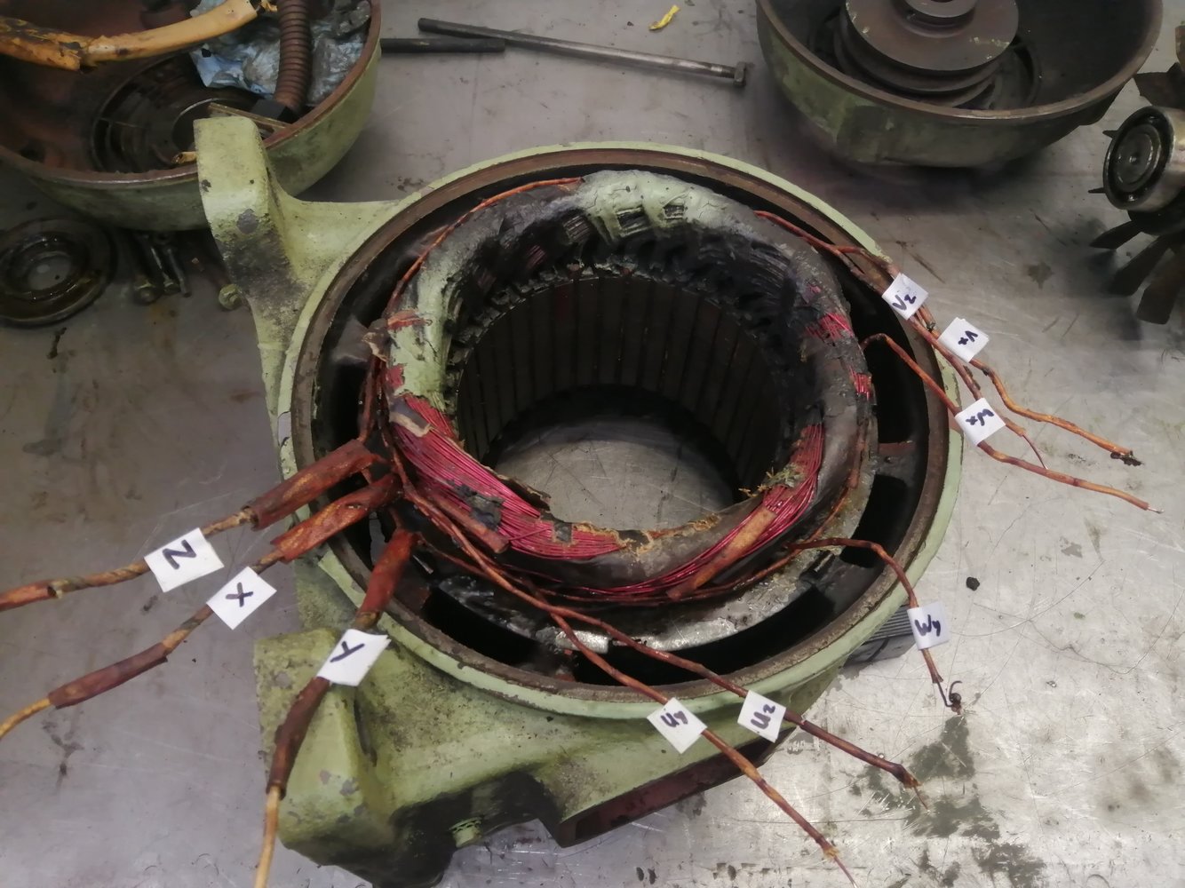

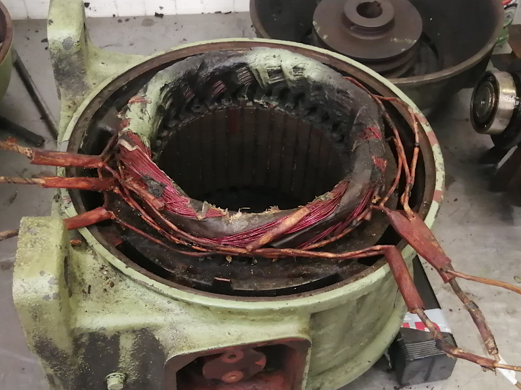

Yeah - who'd be a motor winderI bet that lot sent your head into a spin Pete - reading it certainly did mine !
