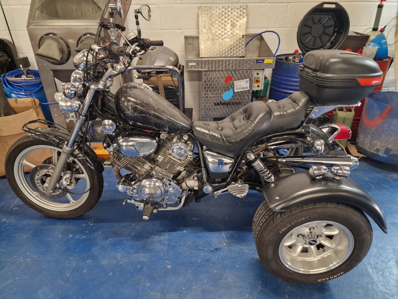

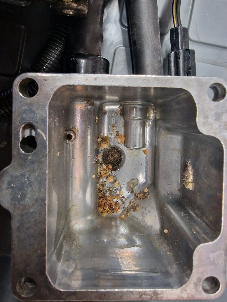

This rather hideous contraption's back. He bought it unseen on eBay from someone in North Yorkshire and last time it was in because the carbs were full of gunge.
This time it's in because the fuel tap let go and dumped a tankful on his drive. Considering the state of the rest of it I very much doubt this is the last I'll see of it.
I think it was standing for a long time before it was put back on the road. I couldn't make out what it was, started out like a waxy substance but as it dried it went crumbly, almost crystalline.
What's he been running it on, Weetabix?
That looks like something built on scrapheap challenge!This rather hideous contraption's back. He bought it unseen on eBay from someone in North Yorkshire and last time it was in because the carbs were full of gunge.
I don't think they took that much time over it.That looks like something built on scrapheap challenge!

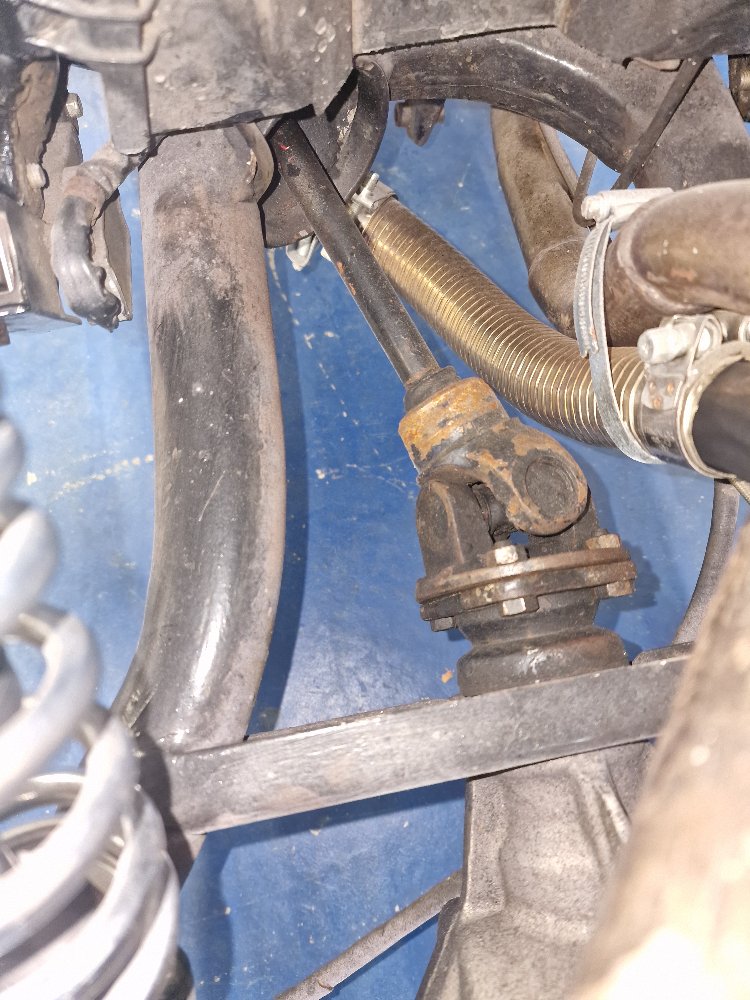

Not terribly far off that. It's got one of those horrible trike conversion kits, which put all the twisting forces from the rear axle on to the wrong bits of the frame.That looks like something built on scrapheap challenge!
The forces going through the individual pivot bearings must be huge as there's no provision at all for the frame or axle to tilt. So even a slight camber will load one or the other, add on cornering speed & any bumps and the bearings and tubes must take a right hammering.Not terribly far off that. It's got one of those horrible trike conversion kits, which put all the twisting forces from the rear axle on to the wrong bits of the frame.
Should have shortened one side of the axle to reduce the prop angle. Loads of those about too…Not terribly far off that. It's got one of those horrible trike conversion kits, which put all the twisting forces from the rear axle on to the wrong bits of the frame.
Looks like someone has used Petseal & it has failed, Its marketed as carbon fibre epoxy, It isnt its just cheap polyester resin with fibreglass strands in it. The clue is that the catalyst is methyl ethyl ketone peroxide. Epoxies do not use that. Snake oil.I think it was standing for a long time before it was put back on the road. I couldn't make out what it was, started out like a waxy substance but as it dried it went crumbly, almost crystalline.![]()
Yes, subjecting the bike frame to loads it was never designed for, really poor design IMHO. When I cut up and rebuilt my first trike, despite making the back end from triangulated straight tubes I then had to add cross bracing to the new bit as well as the bike frame - in front of the engine, under the seat etc. I found out when fitting the exhaust, it was hanging by the front when I leaned on the handlebars and saw the tip of the exhaust moving...The forces going through the individual pivot bearings must be huge as there's no provision at all for the frame or axle to tilt. So even a slight camber will load one or the other, add on cornering speed & any bumps and the bearings and tubes must take a right hammering.
