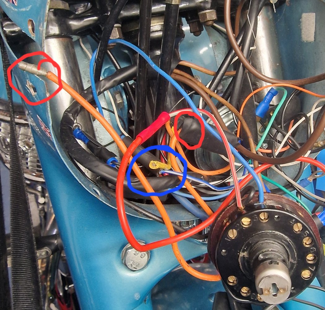

The connectors and replacement reg/rec arrived for the 3TA so the stator, reg/rec and battery wiring is sorted and all in the right place now. Which means I can move on to the wiring in the headlamp cowl and to the switch.
First thing is to work out what in the name of Temu has been done. That meant dismantling the headlamp cowl, which means disconnecting the brake cable, head tensioner etc.
Once in I confirmed that the stator feed dedicated to the lighting was just cut (circled in blue) and taped up doing nothing. Leaving aside the various link wires and feeds for a moment, power for the head and tail lights has been picked up from the battery/general supply via the orange wire into terminal 11 (topside of switch) with an external link to terminal 8 topside.
The upshot is that there's one stator output going via the reg/rec to provide DC to the battery for charging. The other feed which should provide a direct AC to the lighting circuit isn't connected to anything. I have no idea why that would be the case other than it wasn't covered in the 'Fischer Price My First Electrics' instructions.
In theory it's remove the erroneous extra orange wire and connect the yellow stator feed. The concern is what else up/down stream has been changed, disconnected, bodged that's going to appear when I do. What fun!
