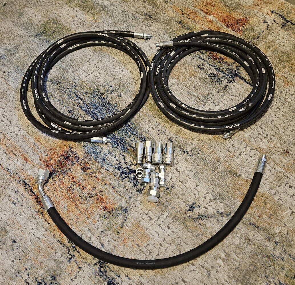

Hoses and fittings to hopefully get the bobcat skid steer auxiliary system working again, would highly recommend https://www.parquiponline.com/ great prices and arrived in under 24hrs!

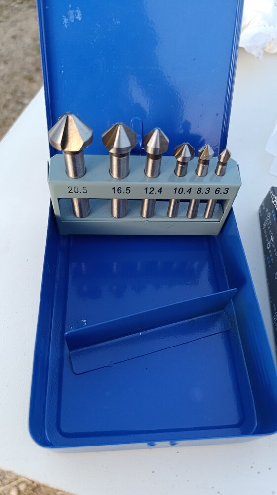

Champhering bits finally arrived
So I've had to test them

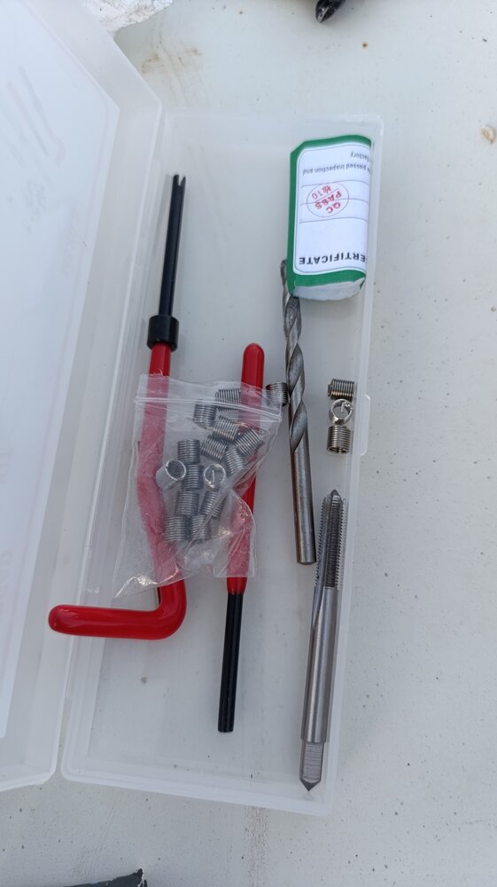

cheap Chinese M5 Helicoil set bought because @Kram said that they work fine even if not brand name.
Those were 7 euro only so I've ordered and tested.
And so far he wasn't wrong about.

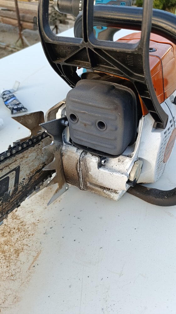

I've used them on my Stihl cylinder because the muffler kept to loosen up by itself.
The tap is a bit weird feeling but it works at least on aluminum.
The drill bit too it's kinda weird feeling (remember I'm a machinist I might feel better those difference than normal people).
It cuts but feels pretty rigid, it will not allow mistakes for sure, it'll snap for sure.
The inserts worked fine, the tail snapped easily as supposed to, they wound fine, but I've sensed the friction while tightening them up.
Tried both my usual technic and the advised one by Kram and honestly they both work the same.
I think it's just another example of "there are many good ways to do the same thing"
The champhering bits feel a little dull but might be an advantage
